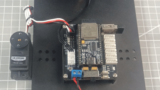

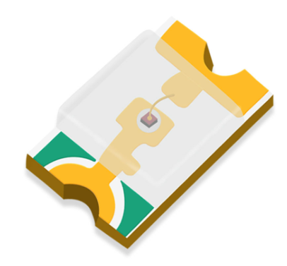

The LED module is a common human-machine interface component in embedded systems and development boards. It is primarily used for status indication, information feedback, and control signaling. Typical applications include system debugging, visualizing operational status, and providing feedback for specific control commands.
The LEDs on the servo controller and the main control board use a common-anode design: the anode is connected to a 3.3V power supply through a current-limiting resistor, while the cathode is connected to a GPIO pin of the main controller. When the GPIO outputs a high level (3.3V), the LED turns off; when it outputs a low level (0V), the LED turns on.

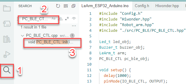

(2) Locate the corresponding example project file in the Arduino project folder provided in the same directory as the documentation.
(3) Open the project and select the appropriate board model, as shown in the image below.
(4) First, click “Verify” (Compile), then click “Upload”. Once the upload is complete, the output window at the bottom of the Arduino software should display a message similar to the one below, indicating that the program has been successfully uploaded.

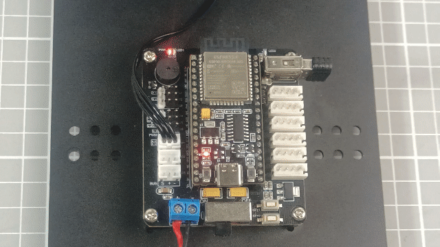

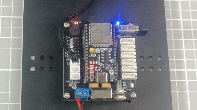

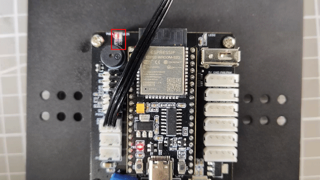

5.1.5 Program Outcome
After the robotic arm is powered on and initialized, the LED1 indicator on the controller blinks periodically at a frequency of 1 Hz, indicating normal operation.

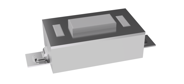

The onboard button is a standard human-machine interface component widely used in embedded systems and development boards. It plays a crucial role in receiving user input and controlling system behavior. Common applications include system wake-up, hardware reset, and triggering specific operation sequences.

  • Due to the time constant of capacitor charging and discharging, it’s generally considered that full charge/discharge is achieved after several cycles. In practical terms, this occurs on the order of seconds. Since the main function samples the pin voltage every 50 ms, the effect of capacitor voltage fluctuations during sampling can be safely ignored.
  • In this example, ADC sampling is handled separately from the main program, within the button_control_callback function. This function is periodically invoked by a timer interrupt and will not be elaborated on here.

5.3.5 Program Outcome
After the robotic arm is powered on, pressing the Key1 button once will cause the buzzer to beep once.

5.4 Serial Bus Servo Instructions
5.4.1 Project Overview
In this lesson, we will control the bus servo to rotate continuously in a loop.
5.4.2 Program Procedure
5.4.3 Module Introduction
A bus servo, also known as a serial bus smart servo, can be considered an advanced version of a digital servo. It typically uses a single-wire UART (serial) communication interface, meaning that both data transmission and reception are handled through a single wire.
In a standard UART setup, two wires are used: one for transmitting (TX) and one for receiving (RX), allowing full-duplex communication. However, in a single-wire UART configuration, a single line alternates between sending and receiving data. When not transmitting, the line remains in receive mode. During transmission, the receive function is temporarily disabled.
To achieve this on the servo controller, a Double Pole Double Throw (DPDT) switch is used to convert the standard two-wire UART into a single-wire UART. The TX and RX lines are connected to the communication line through a logic circuit.
  • When idle (not transmitting), the controller outputs a low signal to the switch’s enable pin. This connects RX to the communication line and disconnects TX.
  • When transmitting data, the controller outputs a high signal to the enable pin. The logic circuit then connects TX to the communication line and disconnects RX.
The bus servo communication protocol used in this example is compatible with all bus servo models from our company. For details on the protocol format, please refer to the document titled Bus Servo Communication Protocol located in the same folder as this manual.
5.4.4 Program Download
Source Code
(1) Connect the main control board to the computer using a USB cable.
5.4.5 Program Outcome
After the robotic arm is powered on, serial bus servo 1 will rotate.

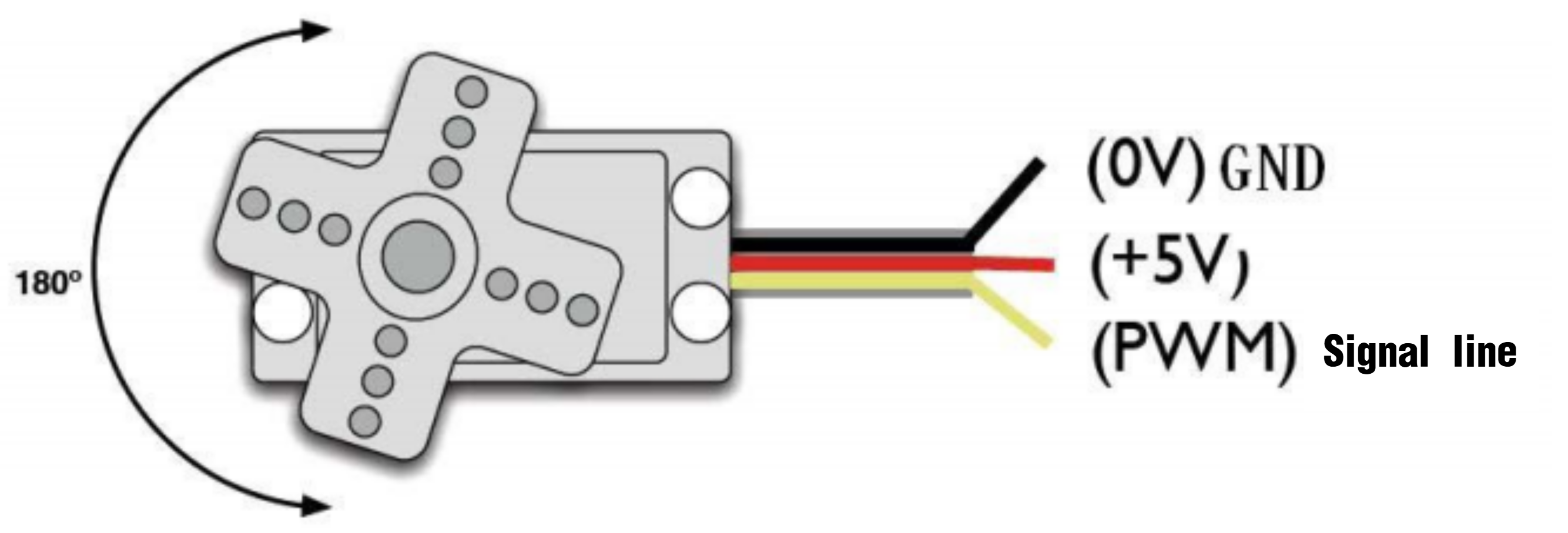

A standard PWM servo has three control wires: power, ground, and signal.
A periodic positive pulse signal is input through the signal line. The low-level duration of this signal should be between 5 ms and 20 ms.
To maintain the servo’s position, an analog PWM servo requires a continuous periodic PWM signal. If the signal is lost, the servo will stop holding its position and cease providing torque.
A digital PWM servo does not require a continuous PWM waveform for operation. Instead, it focuses on the width of a single high-level pulse, and the duration of the low-level portion is not strictly defined. This means you can select any frequency within the servo’s supported control frequency range as the working frequency, and then determine the PWM cycle accordingly.
Within each cycle, a high-level signal is applied starting at a specific time and lasting for a duration equal to the desired pulse width. For the remainder of the cycle, the signal stays low. The servo will rotate to the position corresponding to the pulse width.
Based on this principle, a single timer or task can be used to control multiple servos simultaneously.
(1) During the time allocated to a specific servo, the timer/task outputs a high-level signal of the target pulse width.
(2) Outside of that window, the timer/task outputs a low-level signal to that servo and does not perform further operations.

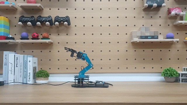

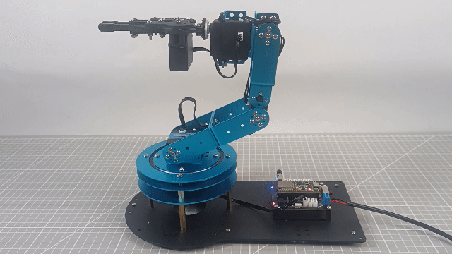

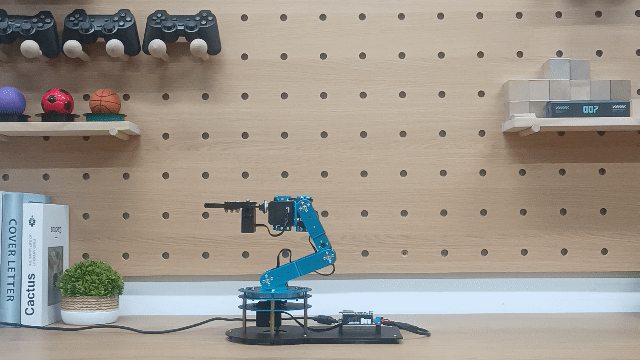

Once powered on, the robotic arm’s No. 1 PWM servo continuously oscillates, driving the gripper to open and close in a repeated cycle.

  • The servo’s control angle ranges from 0° to 180°, corresponding to a pulse width range of 500 µs to 2500 µs. These values can be mapped to each other.
  • A smaller servo angle results in the gripper closing more; a larger angle causes it to open further.

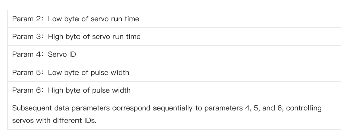

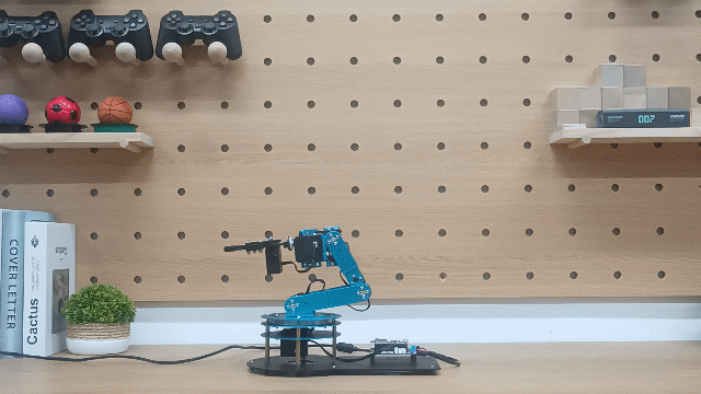

After powering on the robotic arm, action groups 30 and 31 are written to the Flash memory and executed in a continuous loop.

(2) Define the data format required for downloading action groups to Flash.
  * Array content of a single action frame (一个动作帧的数组内容)
  * Number of servos to control: frame[0] (控制的舵机数量frame[0])
  * Execution time: frame[1] + (frame[2] << 8) (运行时间frame[1] + frame[2] << 8)
  * Servo ID: frame[3 + i * 3] (舵机IDframe[3 + i * 3])
  * Servo pulse width: frame[4 + i * 3] + (frame[5 + i * 3] << 8) (舵机脉宽frame[4 + i * 3] + frame[5 + i * 3] << 8)
  * 0 - action frame execution failed; 1 - action frame executed successfully (0-动作帧运行失败 1-动作帧运行完成)

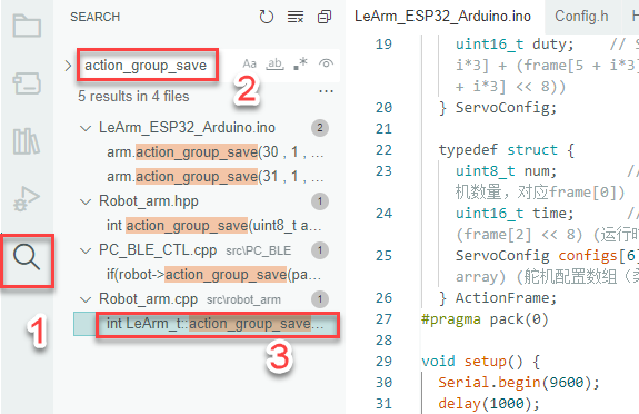

This function is defined in src/robot_arm/Robot_arm.cpp. You can find its definition by searching for action_group_save.

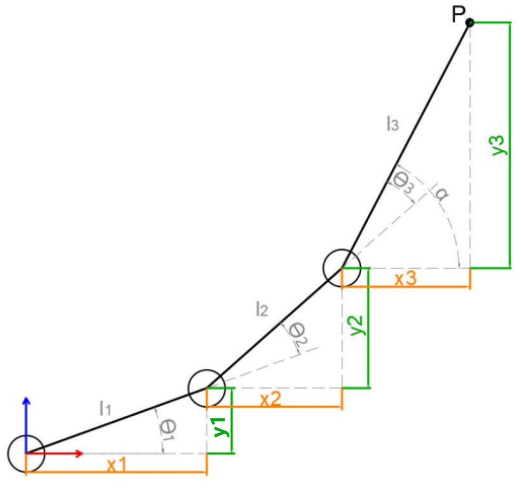

In this lesson, the program uses kinematic algorithms to control the robotic arm to move in a loop among predefined 3D coordinates, achieving vertical up-and-down motion of the end effector as well as three-point cyclic movement.
5.7.2 Program Procedure
5.7.3 Kinematics Algorithm Analysis (Based on Geometric Method)

Model Analysis:
To simplify the model, we remove the base pan-tilt and the end-effector, focusing only on the core structure of the robotic arm.
From the diagram, the coordinates of the robotic arm’s endpoint P(x, y) are composed of three segments:
(1) x = x₁ + x₂ + x₃,
(2) y = y₁ + y₂ + y₃
In the diagram, θ₁, θ₂, and θ₃ are the servo angles we need to solve for, and α is the angle between the gripper and the horizontal plane.
From the geometry, it’s clear that the top-down angle of the gripper is: α α= θ₁ + θ₂ + θ₃
Based on this relationship, we can derive the following equations:

(1) Vertical Movement of the Robotic Arm: After powering on, the robotic arm’s end effector moves vertically between two fixed points—one above the other.
(2) Fixed-Point Movement of the Robotic Arm: After powering on, the robotic arm cycles between three predefined points arranged in an inverted triangle pattern.

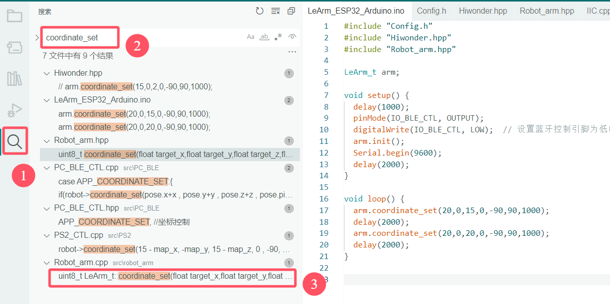

(4) The coordinate_set() function is implemented in the file src/robot_arm/Robot_arm.cpp. You can locate it by searching for coordinate_set in the project.

After powering on the robotic arm, connect the wireless controller and press the “MODE” button to select the digital mode (indicated by a single green light). You can then control the robotic arm’s gripper opening and closing using the “Triangle” and “Cross” buttons.

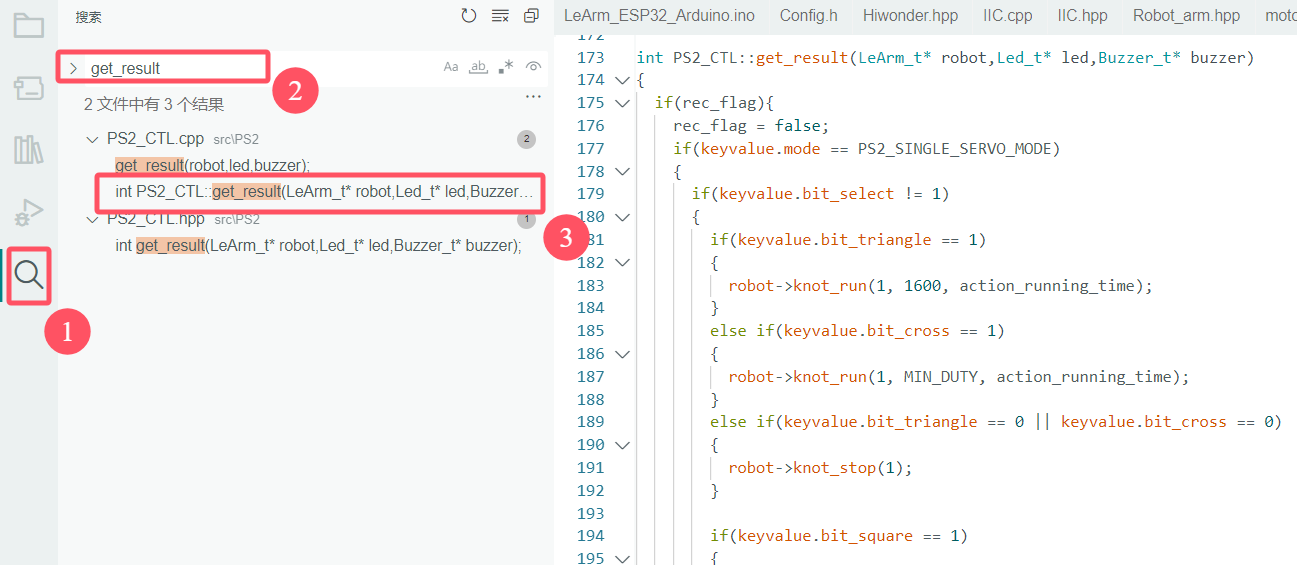

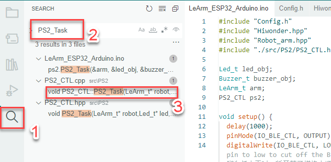

(5) The wireless controller task function PS2_Task() is defined in the PS2_CTL.cpp file. You can locate it by searching for PS2_Task in the project.
(6) The function begins by setting the LED indicator according to the current control mode. It then receives wireless controller data through the receive_msg() function. Afterward, the get_result() function evaluates the current state of the wireless controller buttons and commands the robotic arm to execute the corresponding actions.
void PS2_CTL::PS2_Task(LeArm_t* robot,Led_t* led,Buzzer_t* buzzer)

In this section, we will focus on the get_result() function, which implements the logic for mapping wireless controller button inputs to robotic arm control.
You can locate its implementation by searching for get_result in the codebase.
(2) The function follows the program flow below:
① Check whether a complete data packet has been received. If so, continue execution; otherwise, exit the function.

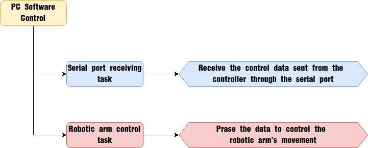

(2) Initialize each object, with the serial object for receiving host computer commands set to Serial.
  arm.init();
  led_obj.init(IO_LED);
  buzzer_obj.init(IO_BUZZER);
  Serial.begin(9600);
  delay(2000);
  pc_ble_obj.init(0);
(3) In the loop function, run the host command parsing task.
void loop() {
  pc_ble_obj.PC_BLE_Task(&arm , &led_obj , &buzzer_obj);
(4) The initialization function for the host control object is defined in the PC_BLE_CTL.cpp file. You can locate it by searching for PC_BLE_CTL::init.
The program flow is as follows:
① Based on the input parameter, if it is 0, set to host computer control; otherwise, set to Bluetooth control.
② Initialize the coordinate system parameters of the robotic arm.

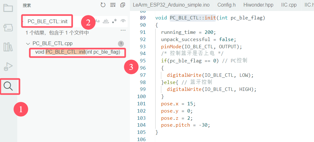

void PC_BLE_CTL::init(int pc_ble_flag)
  running_time = 200;
  unpack_successful = false;
  pinMode(IO_BLE_CTL, OUTPUT);
  /* Control whether Bluetooth is powered on (控制蓝牙是否上电)  */
  if(pc_ble_flag == 0) // PC control (PC控制)
    digitalWrite(IO_BLE_CTL, LOW);
  }else{ // Bluetooth control (蓝牙控制)
    digitalWrite(IO_BLE_CTL, HIGH);
  pose.x = 15;
  pose.y = 0;
  pose.z = 2;
  pose.pitch = -30;

      case APP_MULT_SERVO_MOVE:{
          servos_count = packet.buffer[0];
          running_time = MERGE_HL(packet.buffer[2], packet.buffer[1]);
          for (uint8_t i = 0; i < servos_count; i++)
              set_id = packet.buffer[3 + i * 3];
              set_duty = MERGE_HL(packet.buffer[5 + i * 3], packet.buffer[4 + i * 3]);
              robot->knot_run(set_id, set_duty, running_time);
          status = APP_FUNC_NULL;
      }break;

(6) Upon receiving a host command frame of type APP_MULT_SERVO_MOVE for controlling single or multiple servo pulse widths, position control can be applied to one or more servos.
(7) According to the LeArm PC & APP Communication Protocol, the data parameters for this command type are clearly defined. Additionally, the robotic arm does not need to send a response for this command.
(8) The program reads the command frame data stored in the array member packet.buffer, extracted by the unpack function. According to the host protocol data format, it further analyzes the number of servos to be controlled and the motion duration.

5.10 App Control Program Overview
5.10.1 Project Overview
This lesson mainly explains the program for controlling the robotic arm via the app.
5.10.2 Program Procedure
5.10.3 App Introduction
In this lesson, we’ll use LeArm AI’s dedicated app — Wonderbot — to control the robotic arm based on the function icons.
Before beginning, please make sure you’ve completed 2. Remote Control -> 2.2 App Control, so you’re familiar with how to use the function icons in the app interface.
5.10.4 Program Download
Source Code
5.10.5 Program Outcome
Once powered on, the robotic arm can be controlled via the app to operate servos, manage coordinate-based movements, and execute preset action groups.

The PC software and mobile app share a unified communication protocol, and their processing logic is largely similar. Therefore, this section focuses only on the differences.
  running_time = 200;
  pose.x = 15;
  pose.y = 0;
  pose.z = 2;
  pose.pitch = -30;
(5) Within the Bluetooth control task function (for the upper computer):
① First, the unpack function parses the data received via the serial port. When the unpack_successful flag is set to true, it indicates that a complete set of control data has been received.
      }break;
