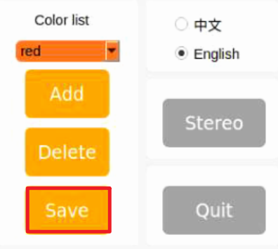

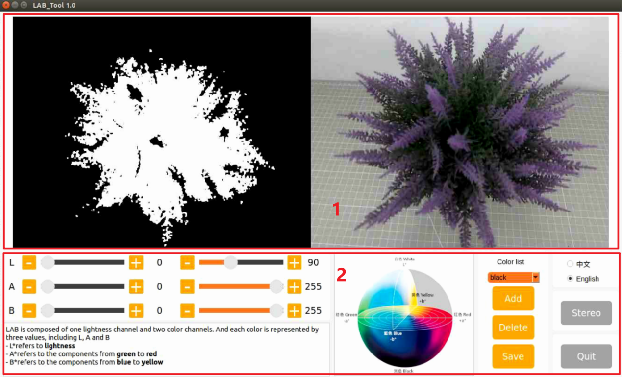

5.1.2 LAB TOOL Interface Layout Instruction
(1) Image display area: the left displays the processed image and the right is the raw image.
If the transmitted image does not display normally, it’s the issue of camera connection. In this case, you need to examine if the wiring is connected properly or reconnect it.
(2) Recognition adjustment area: adjust the color threshold. The function of each button refer to the following table:
Icon Function instruction
The sliders L, A and B are used respectively to adjust the values of the corresponding L, A and B components of the image. The sliders on the left are the "min" value for each component while the slider on the right are the "max" value for each component.
Add recognizable color.
Close LAB TOOL.

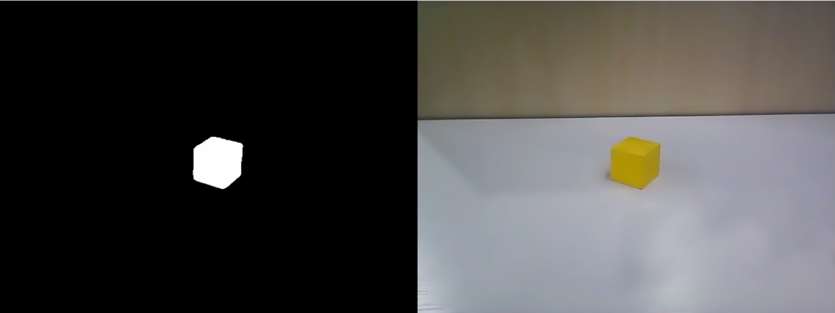

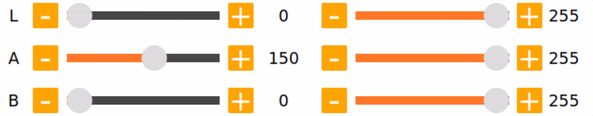

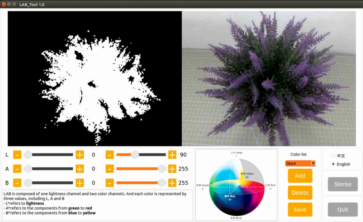

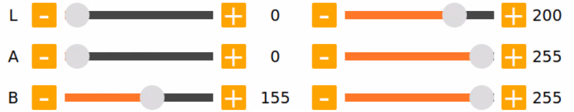

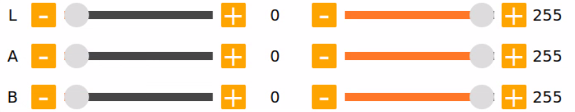

5.1.3 Adjust Color Threshold
(1) Open LAN tool. Choose the color in the color drop-down list of color recognition area. Take a color “red” as example.

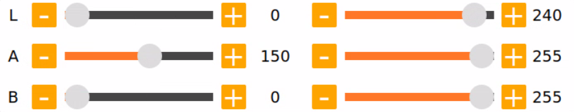

(2) Adjust the “min” values of L, A and B components to “0”, the “max” values to “225”.

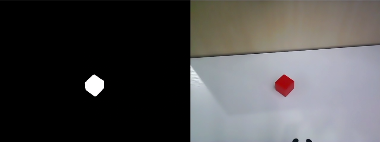

(3) Place the target within the camera’s field of view. Adjust the values of L, A and B component towards the interval representing the target recognition color according to the LAB color space distribution chart.

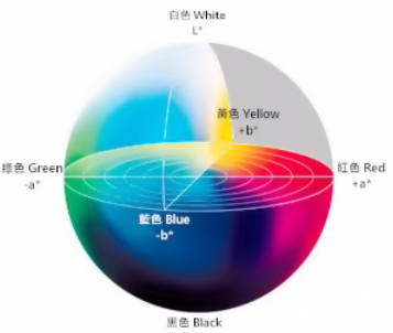

(4) Adjust the L and B components according to your surroundings. If the red color is light, increase the “min” value of the L component; if it is dark, decrease the “max” value of the component. If the red color tends to be warm, increase the “min” value of the B component; if it tends to be cool, decrease the “max” value of the B component.
L 0~255 Black-white (-L~+L)
A 0~255 green-red(-a ~ +a)
B 0~255 Blue-yellow(-b ~ +b)

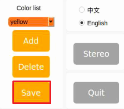

(5) Click “Save” button in adjustment area to save the adjustment parameters.

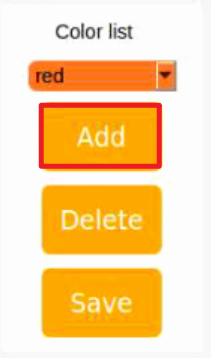

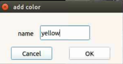

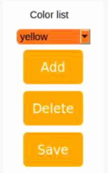

5.1.4 Add New Color
(1) Open LAB tool and click on “Add” button.
(2) Fill in the “name” column with the color name, and click the “OK” button.
(3) Choose the added color in the color drop-down menu.
(4) Place the target within the camera’s field of view, and adjust the threshold by dragging the L, A, and B component sliders until the area of the colored object within the left screen turns white, while the other areas turn black.
The adjustment method of color threshold refers to “5.1.3 Adjust Color Threshold”.
(5) Click “Save” button in recognition adjustment area to save the adjustment parameters of color threshold.

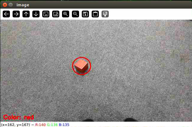

5.2.3 Program Outcome
After the game starts, please ensure that there are no other objects containing recognized colors within the field of view of the camera to avoid affecting the implementation effect.
After the game starts, place the target object within the field of view of the camera. When recognizing the target object, it will be circled up in the same color and the color name will be printed in the lower-left corner of the screen. The program supports red, blue and green object recognition.

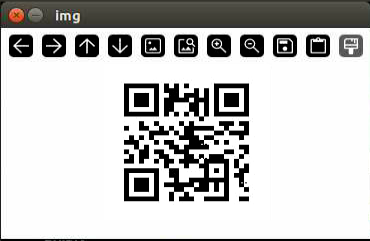

After start the program, it’s necessary to enter characters in the terminal to generate the QR code. Take the input of “ubuntu” as example.
Press “Enter” to display a QR code image containing the input data.
(5) Next, press the “ESC” key or “q” key to exit the QR code interface.

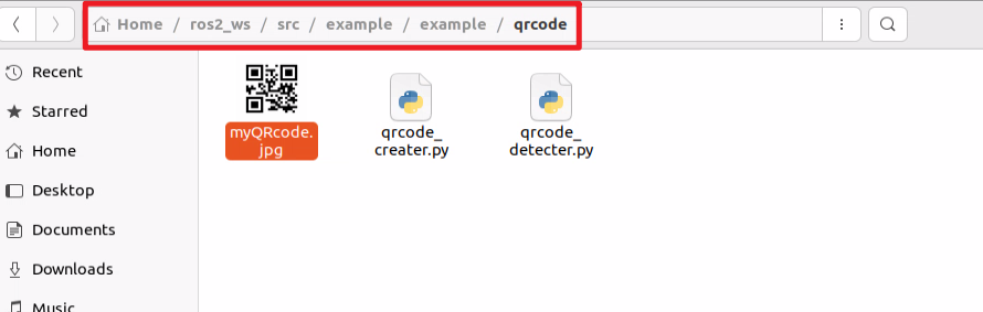

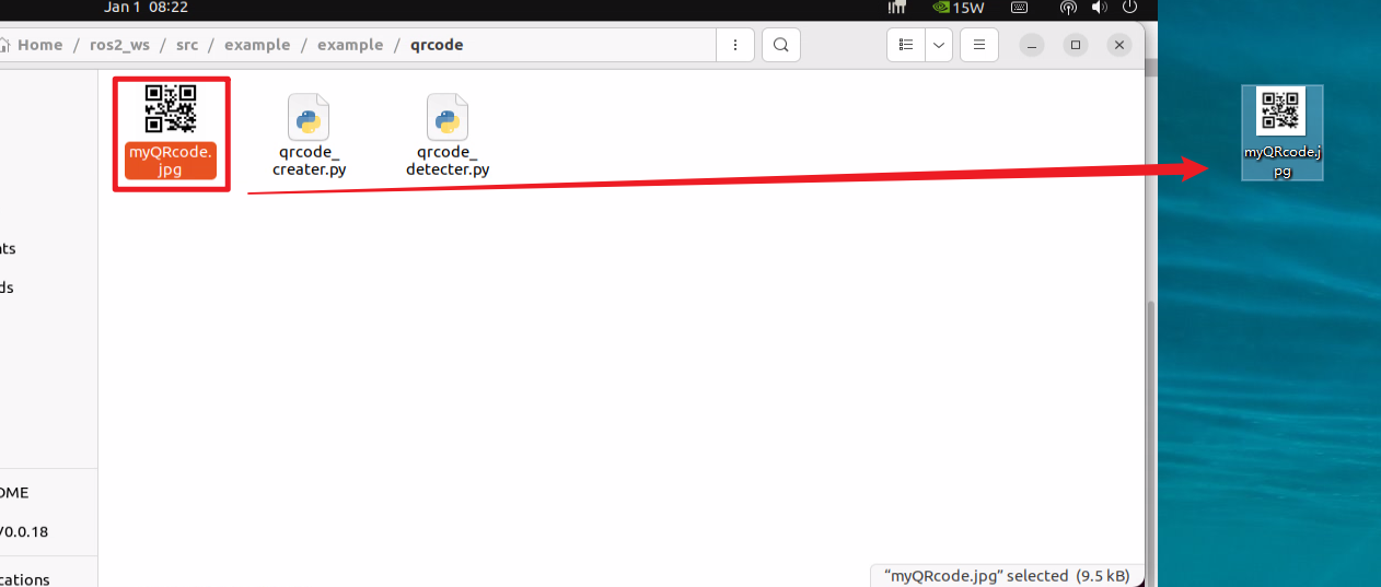

(6) When you return to the command-line terminal and see the prompt shown in the image below, it means the QR code has been successfully saved.
(7) Click on the taskbar on the left side of the system interface, open the file manager, and navigate to the directory highlighted in the red box in the image below. There, you’ll find the generated QR code saved to the host system.
(8) Use the NoMachine tool to drag and drop the image onto your PC desktop. From there, you can print it or transfer it to your mobile phone’s photo gallery.

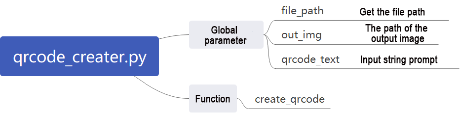

  • Program Analysis
Source Code
The source code of this program is located at: /home/ubuntu/ros2_ws/src/example/example/qrcode/qrcode_creater.py
  • Creating QR Code Utility Object
Using the qrcode module to create the necessary object and setting various parameters for the QR code.

  • Generating QR Code
Using the add_data and make functions to retrieve and fill data, and then using the make_image function to generate the image.
	# Add data(添加数据)
    qr.add_data(data)
    # Fill data(填充数据)
    qr.make(fit=True)
    # Generate image(生成图片)
The first parameter fill_color=(0, 0, 0) is the fill color of the image, which is black in this case.
The second parameter back_color=(255, 255, 255) is the background color of the image, which is white in this case.
  • Displaying Image
Converting the color space of the image using the cvtColor function, and then displaying it on the window using the imshow function.
        cv2.imshow('img', opencv_img)
        k = cv2.waitKey(1)
        if k != -1:
  • Saving Image
Using the imwrite function to store the generated QR code image and printing relevant information.
The first parameter file_name is the storage path of the image.
The second parameter opencv_img is the image to be stored.

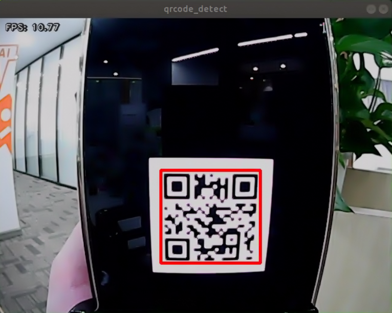

5.3.2 QR Code Recognition
In the previous section, we created a QR code. In this section, we’ll perform content recognition on the QR code.
  • Recognition Process
Firstly, create an instance object for QR code detection, and pass in the required network structure and model weight files for detection.
Then, obtain the camera’s feedback image and perform detection.
Finally, once the QR code is recognized, it will be framed, and the content of the QR code will be printed.
The source code for this program is located at: /home/ubuntu/ros2_ws/src/example/example/qrcode/qrcode_detecter.py
  • QR Code Recognition Steps
When entering commands, it is necessary to strictly distinguish between uppercase and lowercase letters, and you can use the “Tab” key to complete keywords.
(1) Start the robot and connect it to the remote control software NoMachine.
(2) Click on on the system desktop to start the ROS2 command line terminal.
(3) Enter the command to disable the automatic startup service of the app:
(5) Enter the command to start the camera node:
(6) Open a new ROS2 command line terminal, enter the command to switch to the program directory, and start the QR code recognition program:
cd ~/ros2_ws/src/example/example/qrcode && python3 qrcode_detecter.py
To close this game, press “Ctrl+C” in the terminal interface. If closing fails, please try again repeatedly.
  • Program Outcome
After starting the game, it will recognize the QR code images appearing in the feedback screen, mark them with a red box, and print out the content of the QR code.

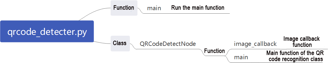

  • Program Analysis
Source Code
The source code of this program is saved in /home/ubuntu/ros2_ws/src/example/example/qrcode/qrcode_creater.py
  • Main Function
Initialize the QRCodeDetectNode and set the node name as qrcode_detect. Wait for the ROS node to close, and if it closes, unregister the current node.

  • QRCodeDetectNode Class
Initialize the node and define parameters, then start the self.main function.
(1) Parameters:
self.running: Whether the detection is enabled
self.model_path: Model path
self.image_queue: Image queue
self.image_sub: Subscription to read camera feedback images
self.qcd: Initialization of the QR code detection

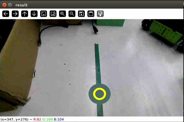

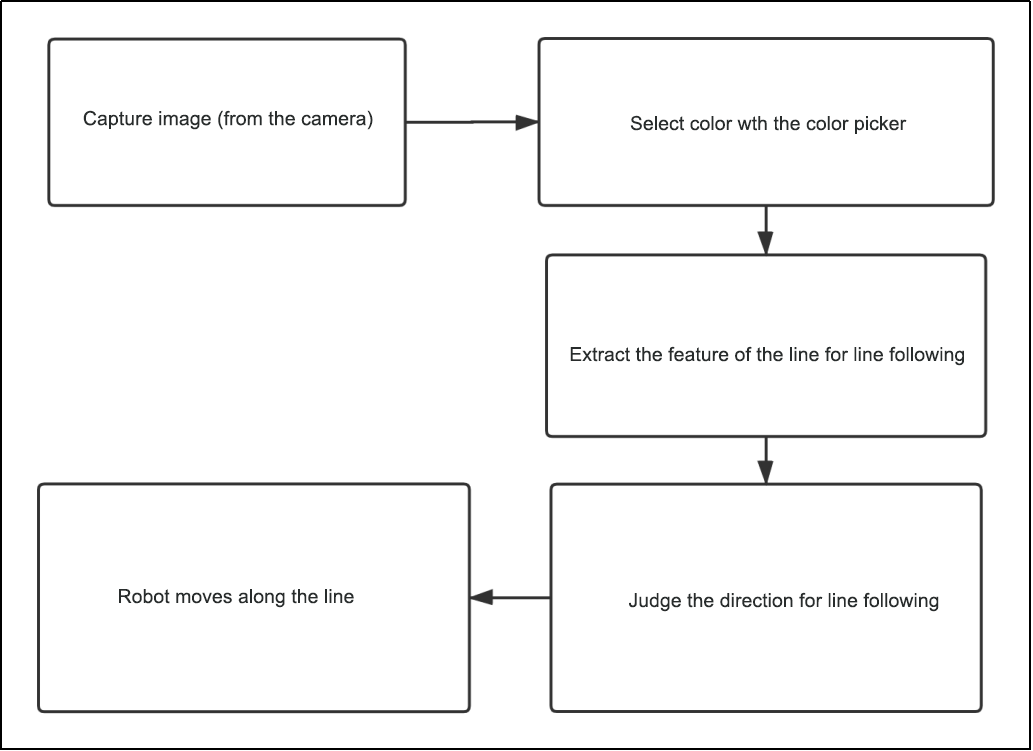

5.4 Autonomous Line Following
5.4.1 Recognition Procedure
First, obtain the RGB image from the camera and resize it. Apply Gaussian blur to the image and convert the color space from RGB to Lab.
Then, perform color recognition on the objects in the circle using color thresholding. Apply masking to parts of the image. (Masking is used to globally or locally mask the processed image using selected images, graphics, or objects).
Afterward, perform opening and closing operations on the object images. Finally, outline the largest object with a circle.
Opening operation: First, erode the image and then dilate it. Purpose: Used to eliminate small objects, smooth the shape boundary, and not change its area. It can remove small grain noise and break the adhesion between objects.
Erosion: Eliminate the boundary points of the object, causing the boundary to shrink inward, and can remove objects smaller than the structural element.
Dilation: Expand the boundary points of the object, merge all background points in contact with the object into the object, and expand the boundary outward.
Finally, feedback the recognition results on the feedback screen.
5.4.2 Autonomous Line Following Operation
(2) Click on on the system desktop to start the command line terminal.
(4) Run the command to enable the camera node
(5) Create a new command line terminal, enter the command to navigate to the program directory, and start the line-following game:
(6) Then, in the current command line terminal, enter the command to navigate to the program directory and start the line-following game:
(7) Click on the position of the line in the image to select the corresponding color of the track line, and you can start line following by color picking.
(8) If you need to close this function, you need to return to the command line terminal and enter the command to stop it.

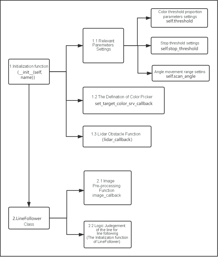

5.4.3 Program Analysis
Source Code
  • Launch Analysis
The program file corresponding to this section of the course document is located at: /home/ubuntu/ros2_ws/src/app/launch/line_following_node.launch.py
  • Read the Storage Path
    if compiled == 'True':
Use get_package_share_directory to obtain the package path.
  • Launch
        IncludeLaunchDescription(
            condition=IfCondition(debug),
controller_launch: Start motion control launch.
depth_camera_launch: Start depth camera launch.
lidar_launch: Start lidar launch.
line_following_node: Start line following node.
        Node(
            package='app',
            executable='line_following',
            output='screen',

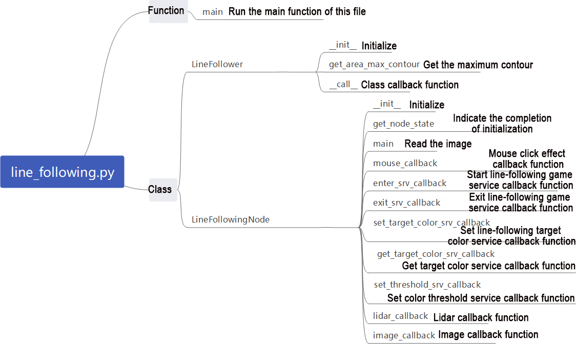

  • Source Code Analysis
The program file corresponding to this section of the course document is located at: /home/ubuntu/ros2_ws/src/app/app/line_following.py
It’s necessary to back up the original program file before making any modification to the program. You’re forbidden to modify the original source code file to avoid causing robot malfunctions that may be irreparable due to incorrect parameter modifications!
Then, the color picker object is defined (used in the gameplay to pick colors), along with the setting of additional Lidar obstacle avoidance functionality. Next is the implementation of the LineFollower class, which mainly includes functions for image preprocessing and logic for line following.
(1) Function:
① Main:
389
390
391
392
393
def main():
    node = LineFollowingNode('line_following')
    rclpy.spin(node)
    node.destroy_node()
    rclpy.shutdown()
Initiate line following node.

            if k != -1:
            if self.debug and not self.set_above:
                self.set_above = True
        rclpy.shutdown()
Read the image and use the mouse to pick colors.
  • mouse_callback:
175
176
177
178
179
180
181
182
            msg = SetPoint.Request()
                msg.data.x = x / self.image_width
                msg.data.y = y / self.image_height
Mouse color picking callback function, obtains the pixel coordinates of the current mouse position.
  • enter_srv_callback:
184
185
186
187
188
189
190
191
192
193
194
195
196
197
198
199
200
201
202
203
204
        with self.lock:
            self.color = ''
            self.stop = False
            self.is_running = False
            self.color_picker = None
            self.follower = None
            self.threshold = 0.5
            self.empty = 0
            if self.image_sub is None:
                self.image_sub = self.create_subscription(Image, '/depth_cam/rgb/image_raw', self.image_callback, 1)  # Subscribe to the camera(摄像头订阅)
            if self.lidar_sub is None:
                self.lidar_sub = self.create_subscription(LaserScan, '/scan_raw', self.lidar_callback, qos)  # Subscribe to Lidar data(订阅雷达数据)
            set_servo_position(self.joints_pub, 1, ((10, 300), (5, 500), (4, 210), (3, 40), (2, 665), (1, 500)))
        response.success = True
        response.message = "enter"
        return response
Enter autonomous line-following service, read data from the camera and lidar, and initialize actions.
  • exit_srv_callback:
206
207
208
209
210
211
212
213
214
215
216
217
218
219
220
221
222
223
224
225
226
                self.image_sub = None
                self.lidar_sub = None
        except Exception as e:
        with self.lock:
        response.message = "exit"
        return response
Exit autonomous line-following service, close various reading nodes, reset PID, and stop line following.
set_target_color_srv_callback:
228
229
230
231
232
233
234
235
236
237
238
239
240
241
        with self.lock:
            self.use_color_picker = True
            if x == -1 and y == -1:
        return response
Set line-following color service.
  • get_target_color_srv_callback:
243
244
245
246
247
248
249
250
251
252
    def get_target_color_srv_callback(self, request, response):
        self.get_logger().info('\033[1;32m%s\033[0m' % "get_target_color")
        response.success = False
        response.message = "get_target_color"
        with self.lock:
            if self.follower is not None:
                rgb = self.follower.target_rgb
                response.message = "{},{},{}".format(int(rgb[0]), int(rgb[1]), int(rgb[2]))
        return response
Set up autonomous line-following gameplay.
  • set_threshold_srv_callback:
254
255
256
257
258
259
260
261
262
263
        with self.lock:
            self.is_running = request.data
            self.empty = 0
            if not self.is_running:
        return response
Set color threshold service.
  • lidar_callback:
282
283
284
285
286
287
288
289
290
291
292
293
294
295
296
297
298
299
300
301
302
303
304
305
306
307
308
309
310
311
312
313
314
315
316
        # Data size= scanning angle/ the increased angle per scan(数据大小 = 扫描角度/每扫描一次增加的角度)
        if self.lidar_type != 'G4':
            left_ranges = lidar_data.ranges[:max_index]  # Left data(左半边数据)
            right_ranges = lidar_data.ranges[::-1][:max_index]  # Right data(右半边数据)
        elif self.lidar_type == 'G4':
            left_ranges = lidar_data.ranges[min_index:max_index][::-1]  # Left data(左半边数据)
            right_ranges = lidar_data.ranges[::-1][min_index:max_index][::-1]  # The right data(右半边数据)
        # Get data according to settings(根据设定取数据)
        angle = self.scan_angle / 2
        # Take the nearest distance left and right(取左右最近的距离)
                self.stop = True
                self.count += 1
                if self.count > 5:
                    self.count = 0
                    self.stop = False
Lidar callback function, reorganizes and collates the data read, and determines whether to stop moving forward.
  • image_callback:
318
319
320
321
322
323
324
325
326
327
328
329
330
331
332
333
334
335
336
337
338
339
340
341
342
343
344
345
346
347
348
349
350
351
352
353
354
355
356
357
358
359
360
361
362
363
364
365
366
367
368
369
370
371
372
373
374
375
376
377
378
379
380
381
382
383
384
385
386
387
        result_image = np.copy(rgb_image)  #  The image used to display the result(显示结果用的画面)
        with self.lock:
            if self.use_color_picker:
                # Color picker and line recognition are exclusive. If there is color picker, start picking(颜色拾取器和识别巡线互斥, 如果拾取器存在就开始拾取)
                if self.color_picker is not None: # 拾取器存在(color picker exists)
                        if target_color is not None:
                            self.follower = LineFollower(target_color, self)
                    twist = Twist()
                    twist.linear.x = 0.15
                            result_image, deflection_angle = self.follower(rgb_image, result_image, self.threshold)
                            if deflection_angle is not None and self.is_running and not self.stop:
                                self.pid.update(deflection_angle)
                                if self.machine_type == 'JetRover_Acker':
                                    steering_angle = common.set_range(-self.pid.output, -math.radians(150/1000*240), math.radians(150/1000*240))
                                    if steering_angle != 0:
                                        R = 0.213/math.tan(steering_angle)
                                    twist.angular.z = common.set_range(-self.pid.output, -1.0, 1.0)
                            elif self.stop:
                                self.pid.clear()
                twist = Twist()
                if self.color in common.range_rgb:
                    self.follower = LineFollower([None, common.range_rgb[self.color]], self)
                    result_image, deflection_angle = self.follower(rgb_image, result_image, self.threshold, self.lab_data['lab'][self.camera_type][self.color], False)
                    elif self.stop:
                        self.pid.clear()
        if self.debug:
            if self.image_queue.full():
                # If the queue is full, discard the oldest image(如果队列已满,丢弃最旧的图像)
                self.image_queue.get()
            self.image_queue.put(result_image)
            self.result_publisher.publish(self.bridge.cv2_to_imgmsg(result_image, "rgb8"))
Camera callback function, invokes the color picker based on the read data, and moves the robot according to the recognized line using PID control.
