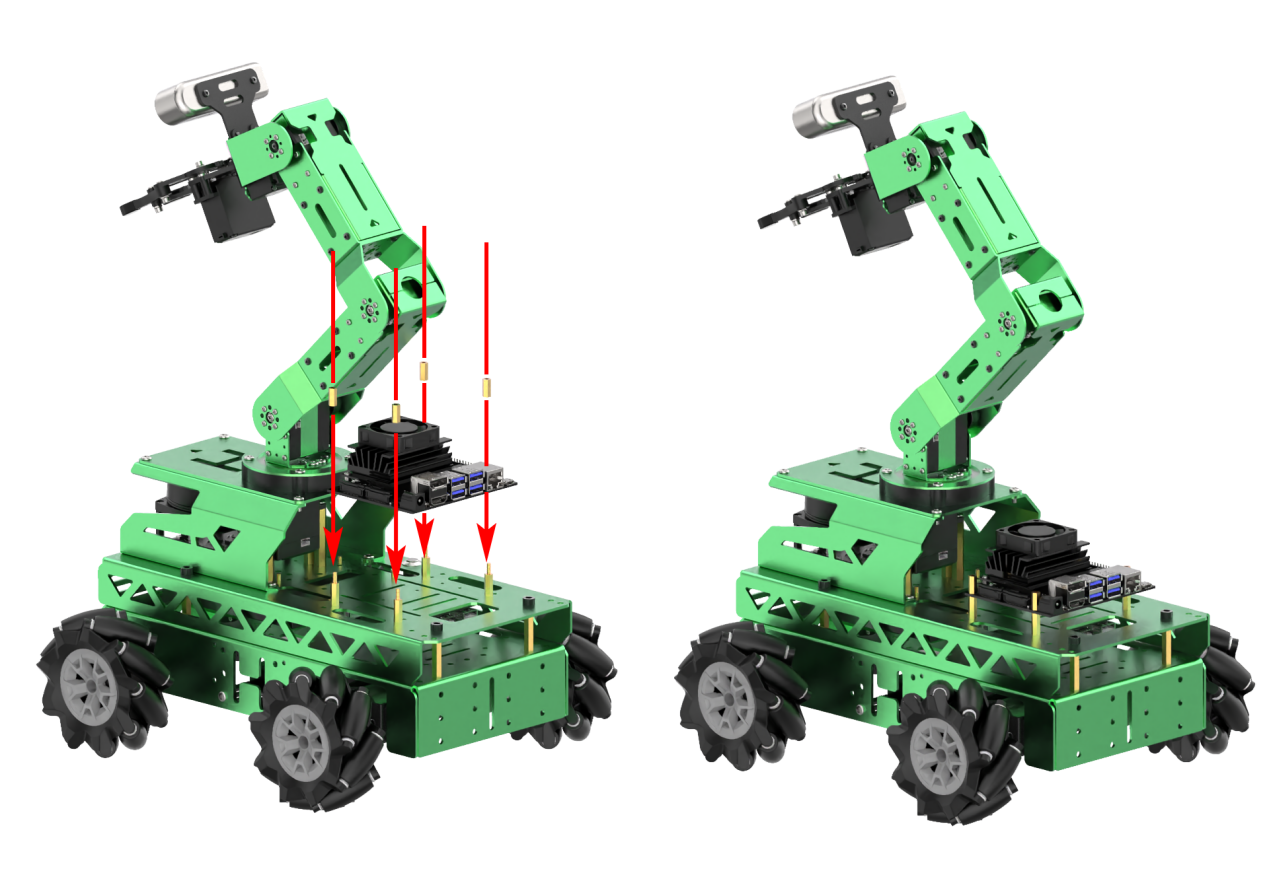

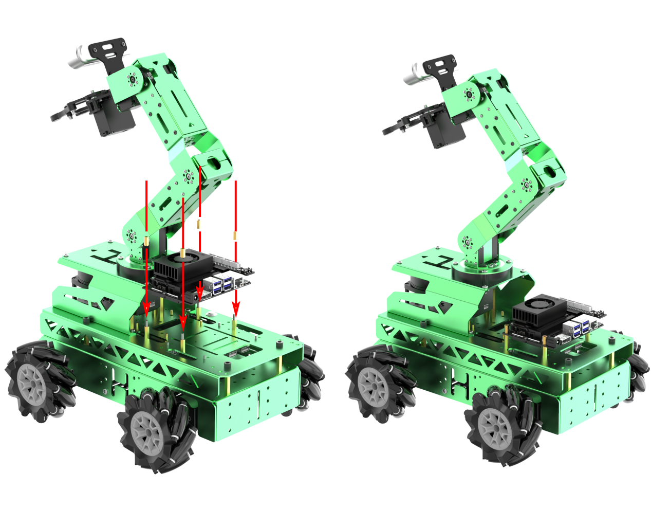

1.2.1 Depth Camera and Robot Arm Installation

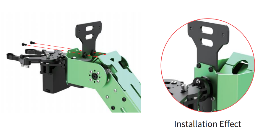

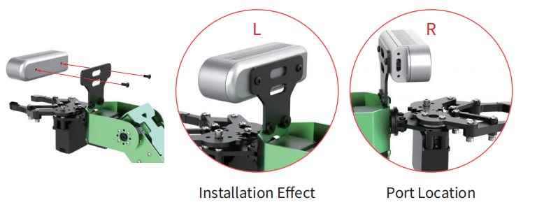

  • Camera Bracket Installation

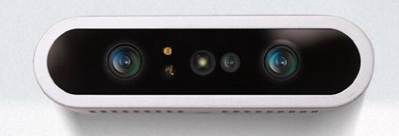

(1) Fix 3D depth camera bracket to robot arm using M3*6 round-head machine screw.
(2) Mount 3D depth camera to camera bracket with M3*6 round-head machine screw.
The port of 3D depth camera is on robot’s right side.

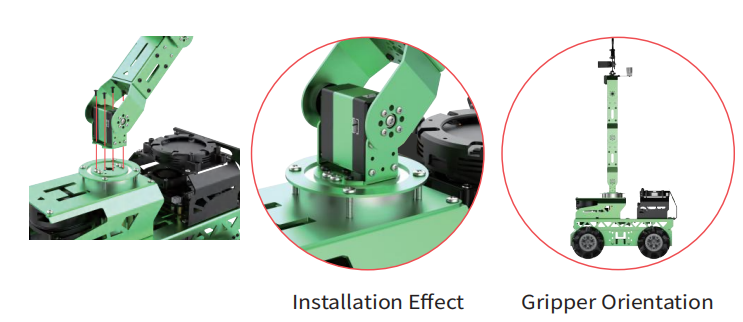

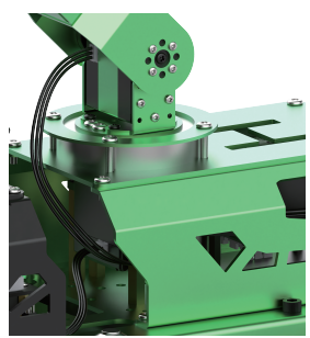

(3) Attach robot arm to the pan-tilt with M3*6 round-head machine screw.
The gripper should face towards the front of the car.
(4) Connect the wire of pan-tilt servo to the servo on U-shaped bracket.
(5) Connect camera cable to USB port of 3D depth camera. Then pass the cable through bracket as pictured. Finally, connect it to port 2 on Jetson Nano board.
For specific wiring instruction, refer to 1.2.4 Wiring Instructions.

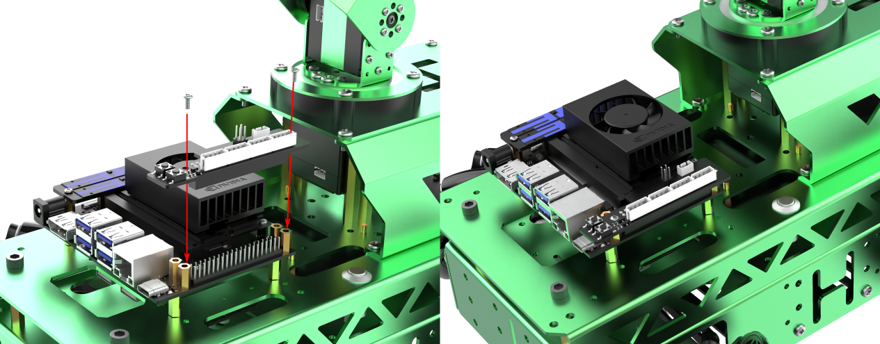

1.2.2 Main Control Board Installation

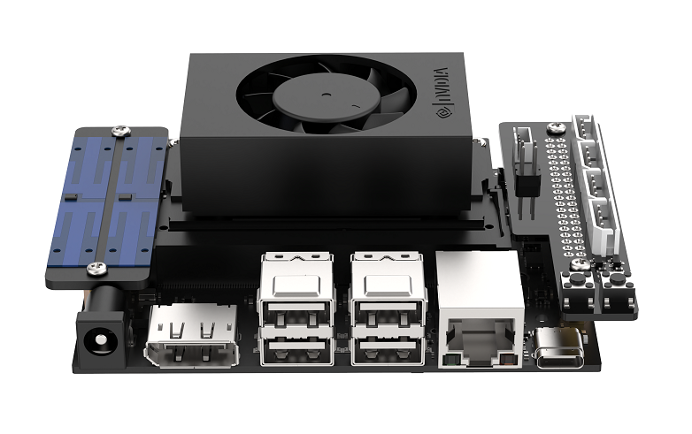

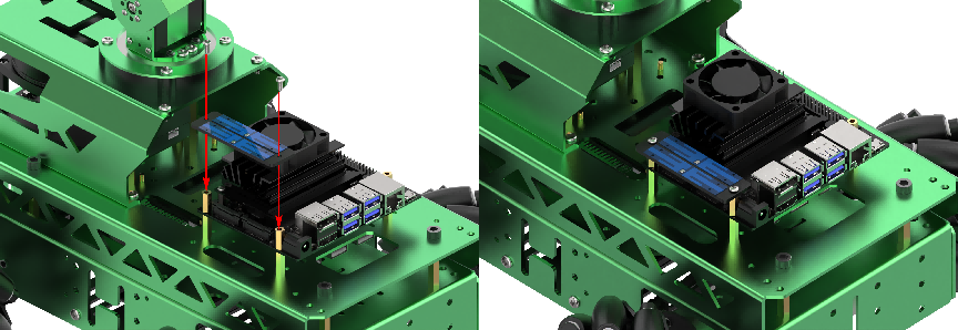

  • Jetson Nano Control Board
(1) Mount the control board onto the robot with M2.5*12 double-pass copper columns.
(2) Fix the antennas with M2.5*6 round-head machine screws.
(3) Fix the expansion board with M2.5*6 round-head machine screws.
  • Jetson Orin Nano/Jetson Orin NX Control Board

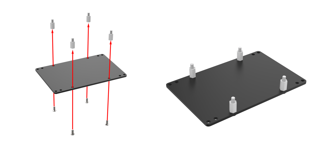

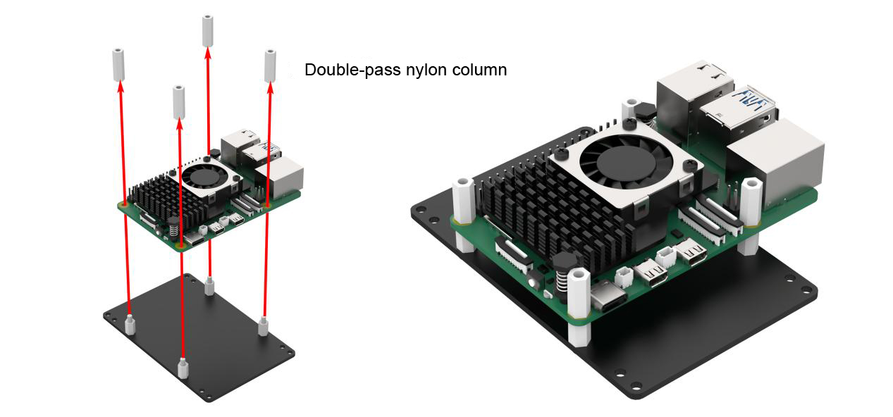

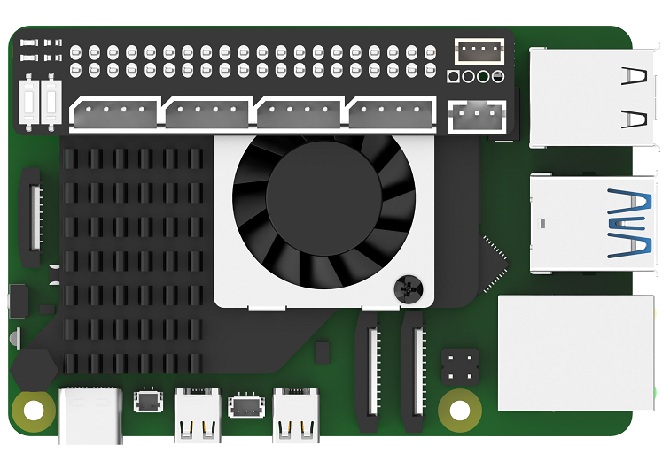

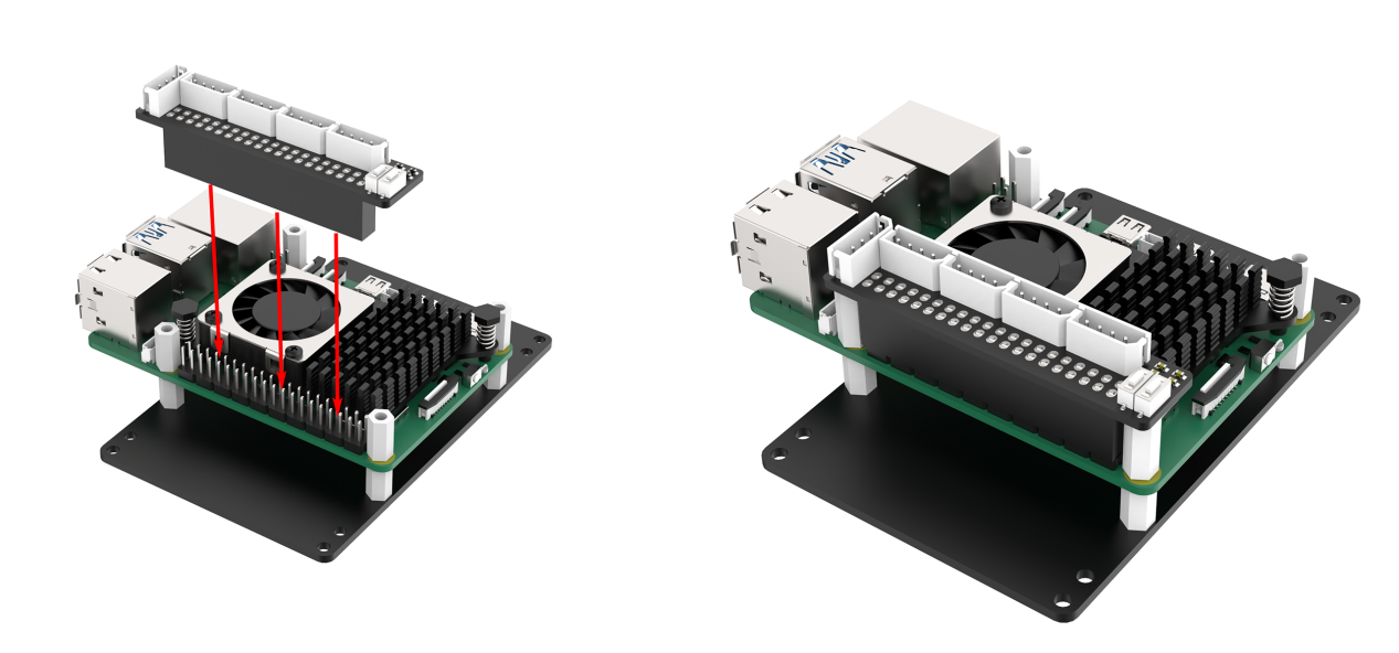

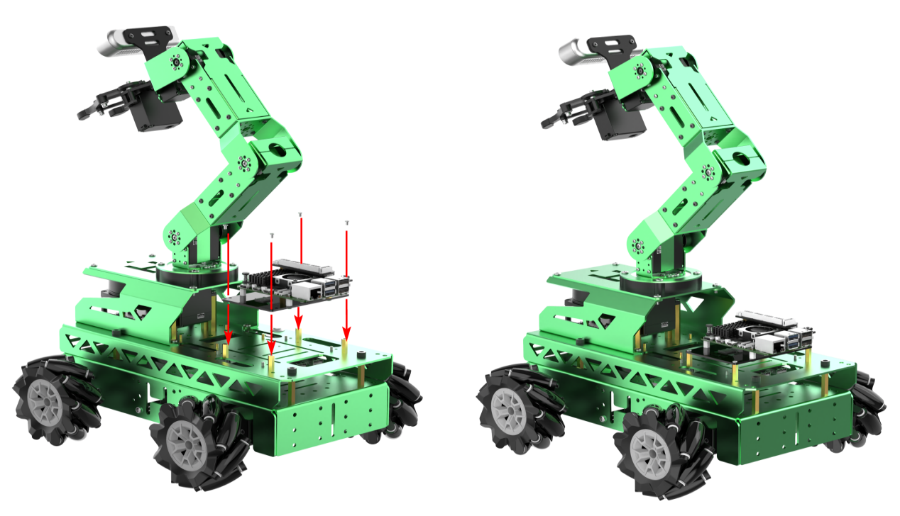

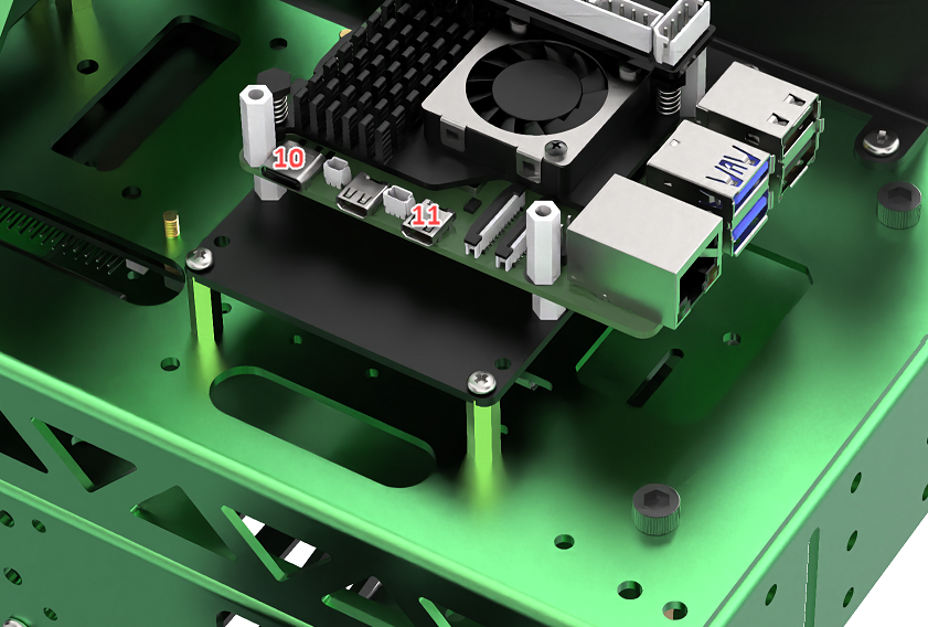

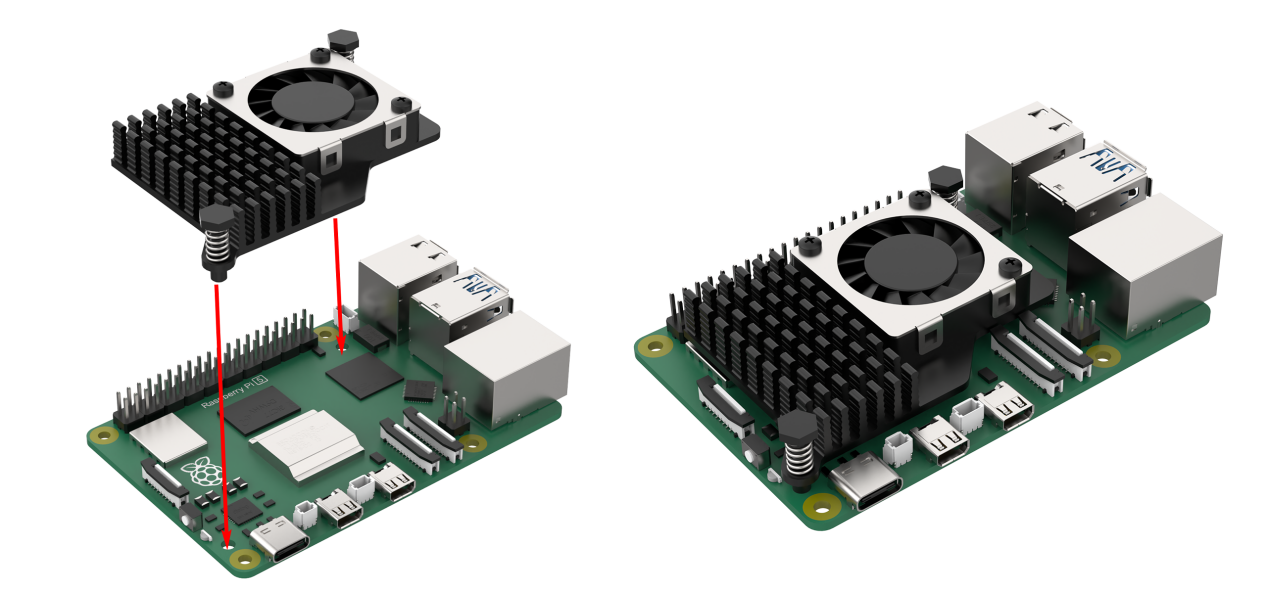

  • Raspberry Pi5 Control Board
(1) Secure the four M2.55+6 single-pass nylon columns to the adapter plate using M2.56 round head screws.
(2) Press down firmly on the push-type screw of the heat sink to mount it on the main board.
(3) Attach the main board to the adapter plate using double-pass nylon columns.
(4) Insert the expansion board into the pins of Raspberry Pi 5.
(5) Attach the adapter plate onto the robot with M2.5*6 round-head screws.

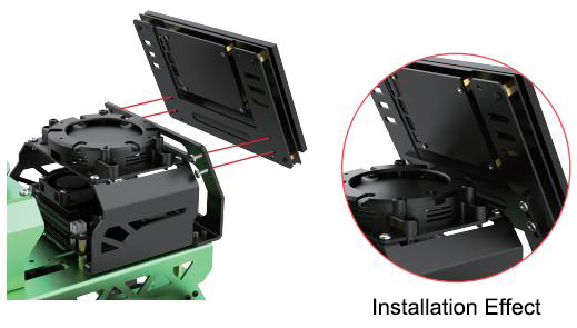

1.2.3 LCD Screen Installation
  • 7-inch LCD Screen Setup

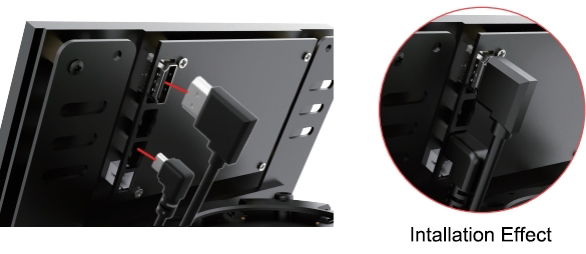

(1) Install 7-inch LCD screen to columns with M4*6 round-head machine screws.

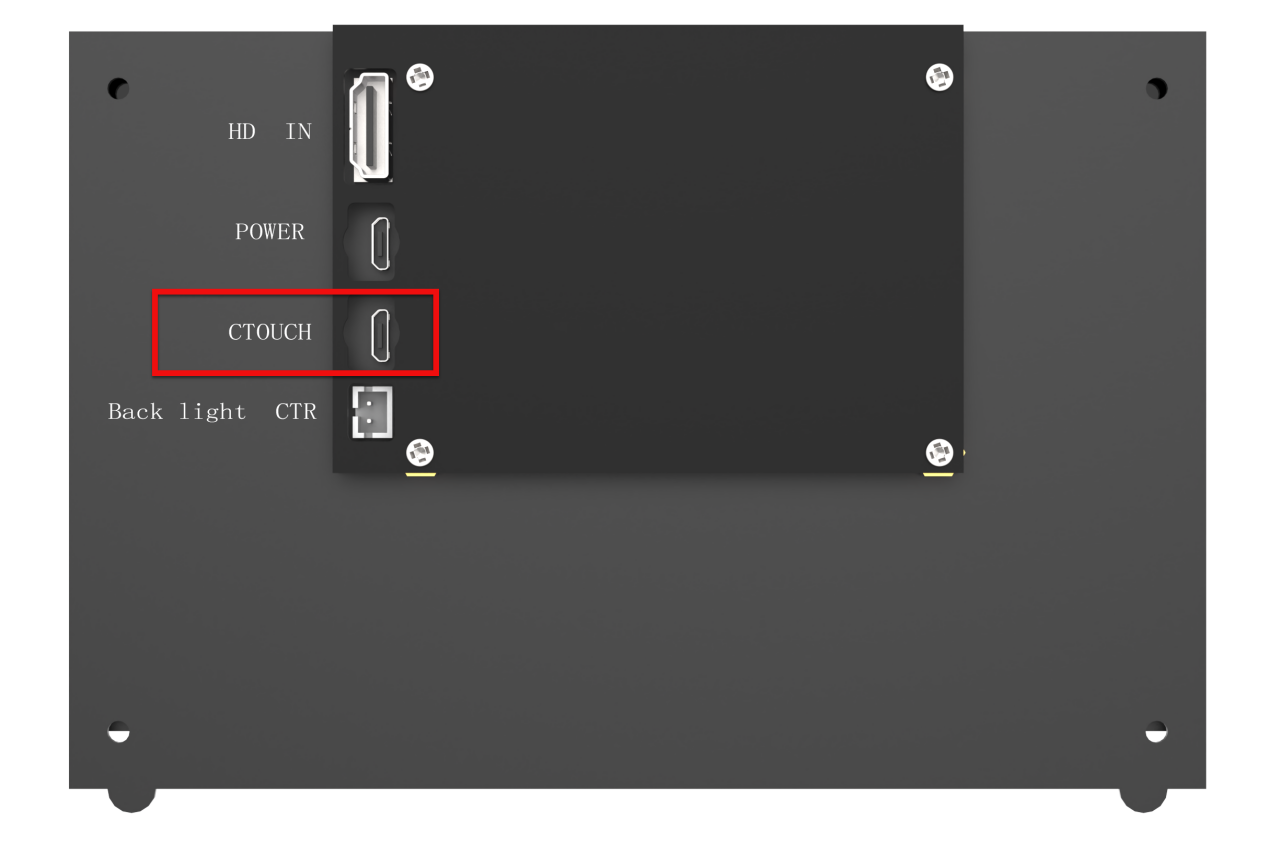

(2) Connect HDMI cable to HDMI interface on the 7-inch LCD screen, and connect power cable to CTOUCH port.
7-inch LCD screen doesn’t support touch control if the cable is not connected to CTOUCH port.

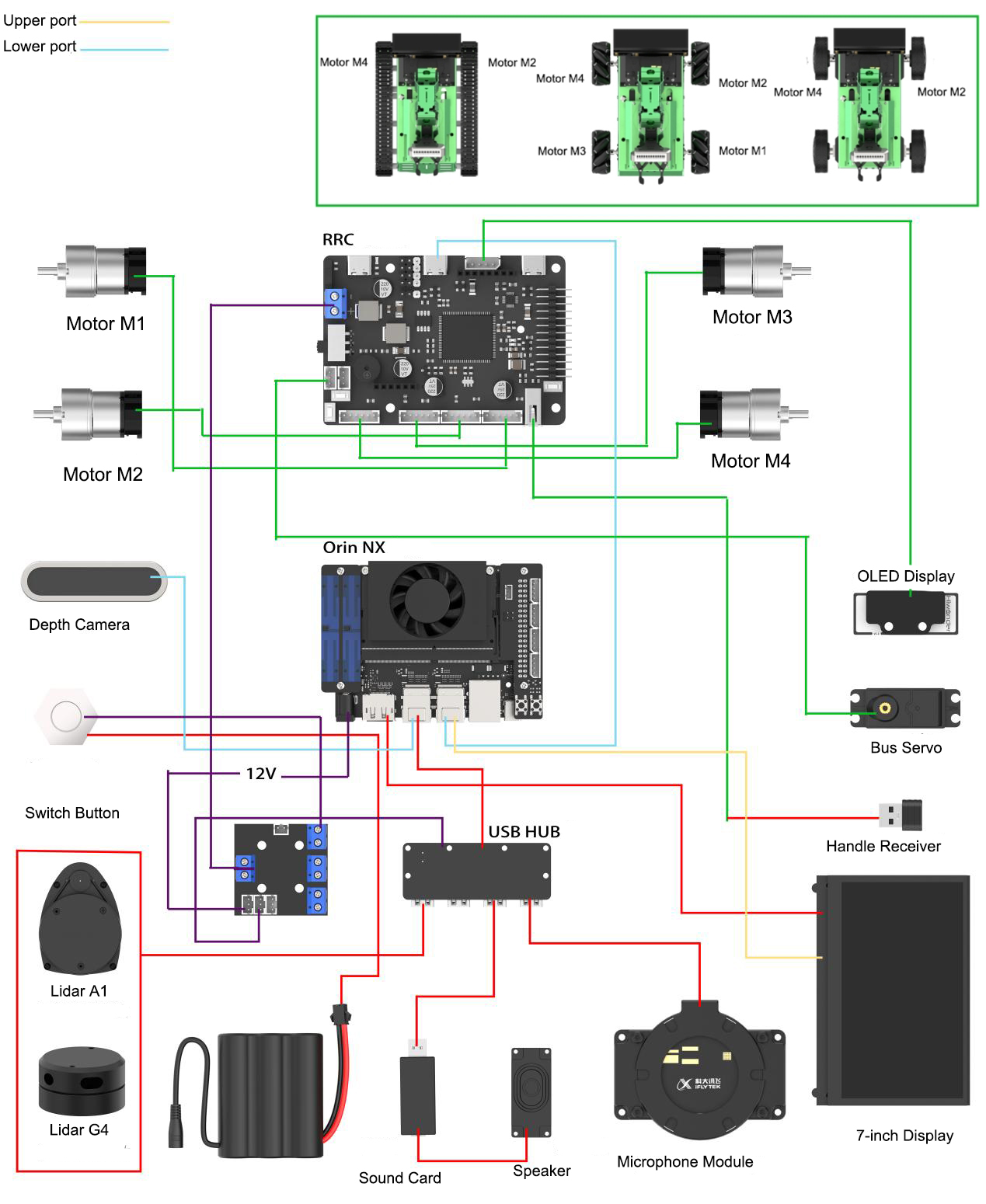

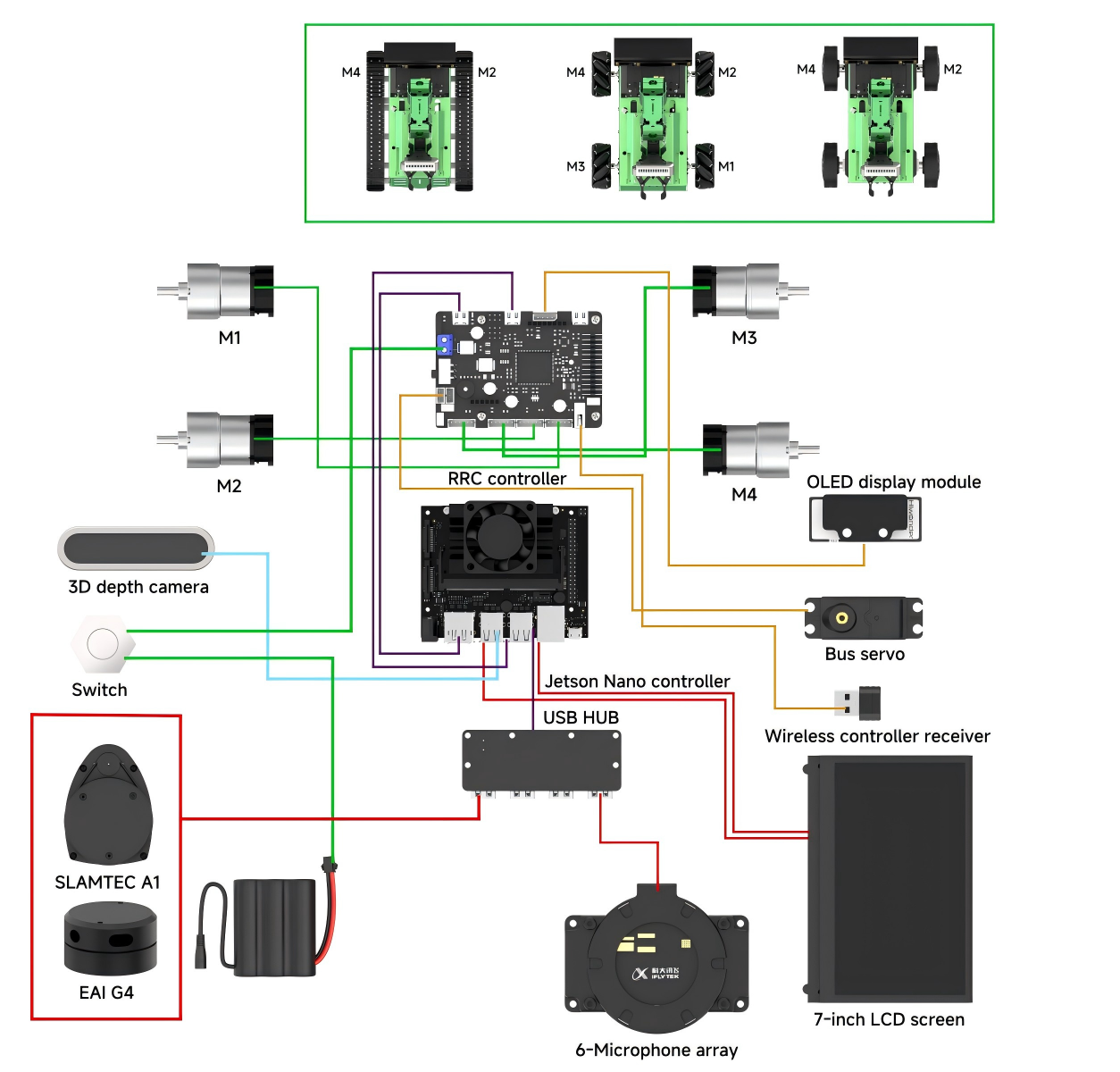

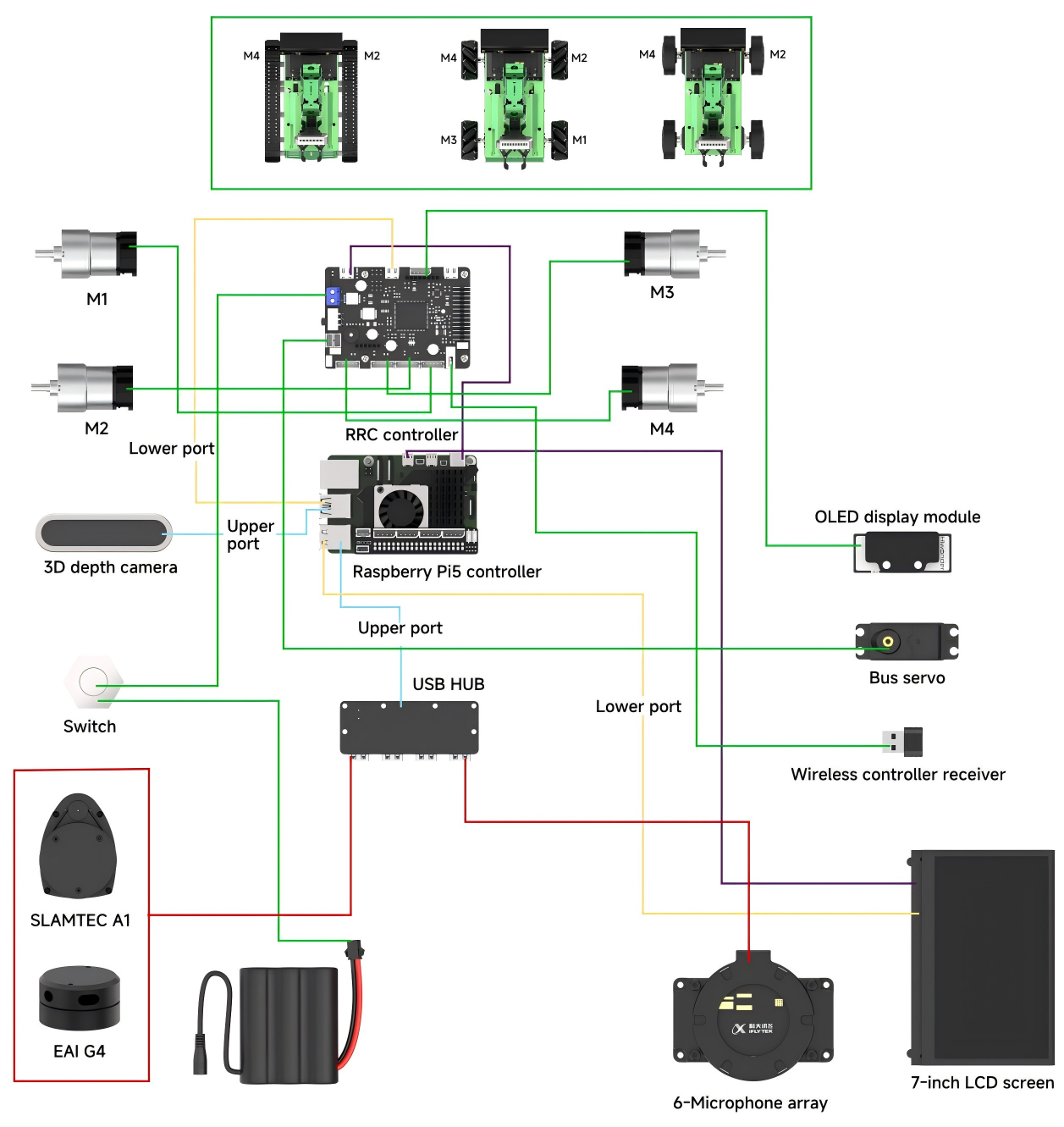

Upon receiving the robot, it is necessary to follow the wiring tutorials below to connect the control board. Each accessory must be properly connected to its corresponding port; otherwise, the robot’s functions will not work properly.

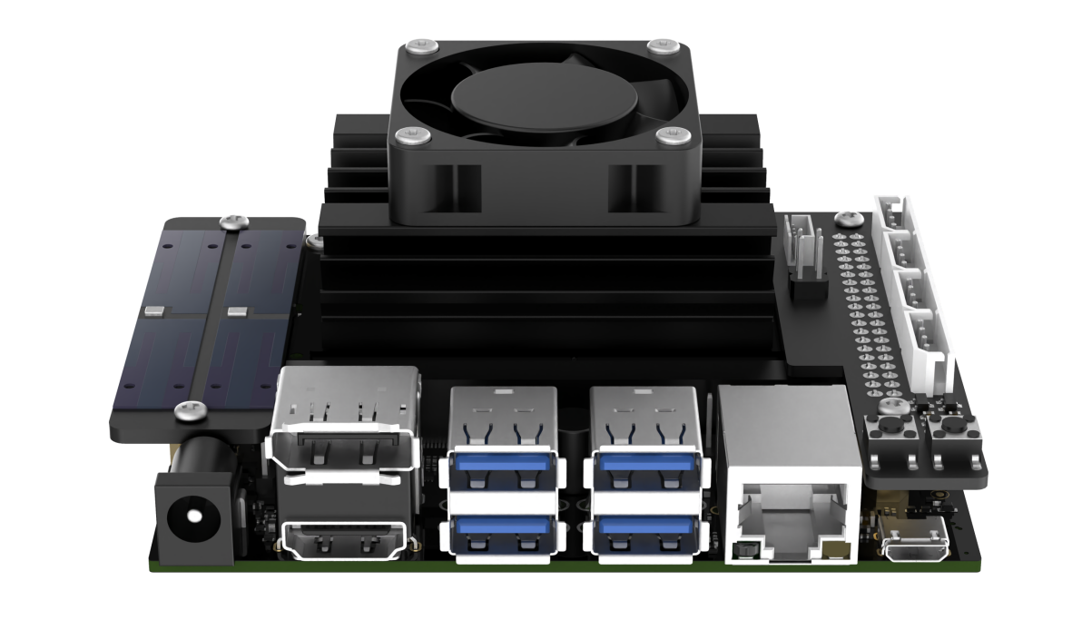

  • Jetson Nano Controller Wiring
Please refer to the table below and connect each accessory to its corresponding port on Jetson Nano board. If any of the listed accessories are not included in your kit, please ignore the corresponding port number.
NO. Name
1 Jetson Nano board supply interface (DC round head cable)
2 Display HDMI interface
3 Depth camera port
4 USB hub Communication interface

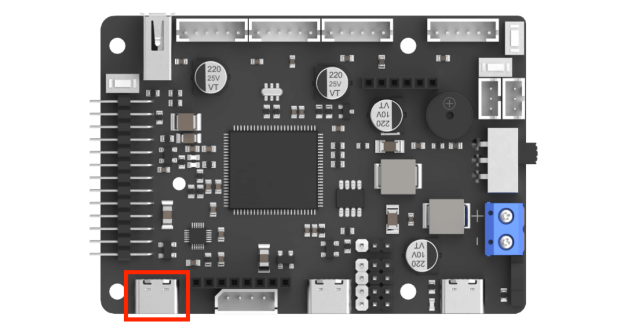

5 STM32 controller
6 Display power supply port
7 Lidar port
8 Reserved custom expansion interface
9 Reserved custom expansion port

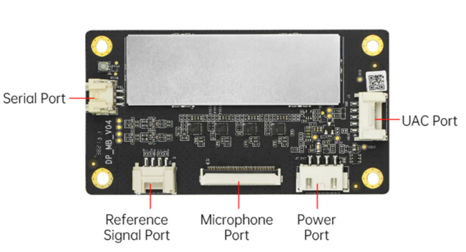

10 Microphone array module (For developer kit and ultimate kit only)

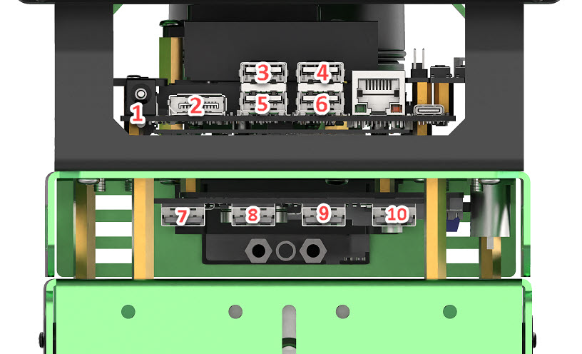

  • Jetson Orin Nano/Orin NX Controller Wiring
Please refer to the table below and connect each accessory to its corresponding port on Jetson Orin Nano board and USB hub. If any of the listed accessories are not included in your kit, please ignore the corresponding port number.
NO. Name
1 Power supply port of Jetson Orin Nano (DC round head cable)
2 DP interface of 7-inch display
3 Depth camera interface
4 USB hub communication interface
5 STM32 controller communication cable
6 Display Power Supply Interface
7 Lidar port

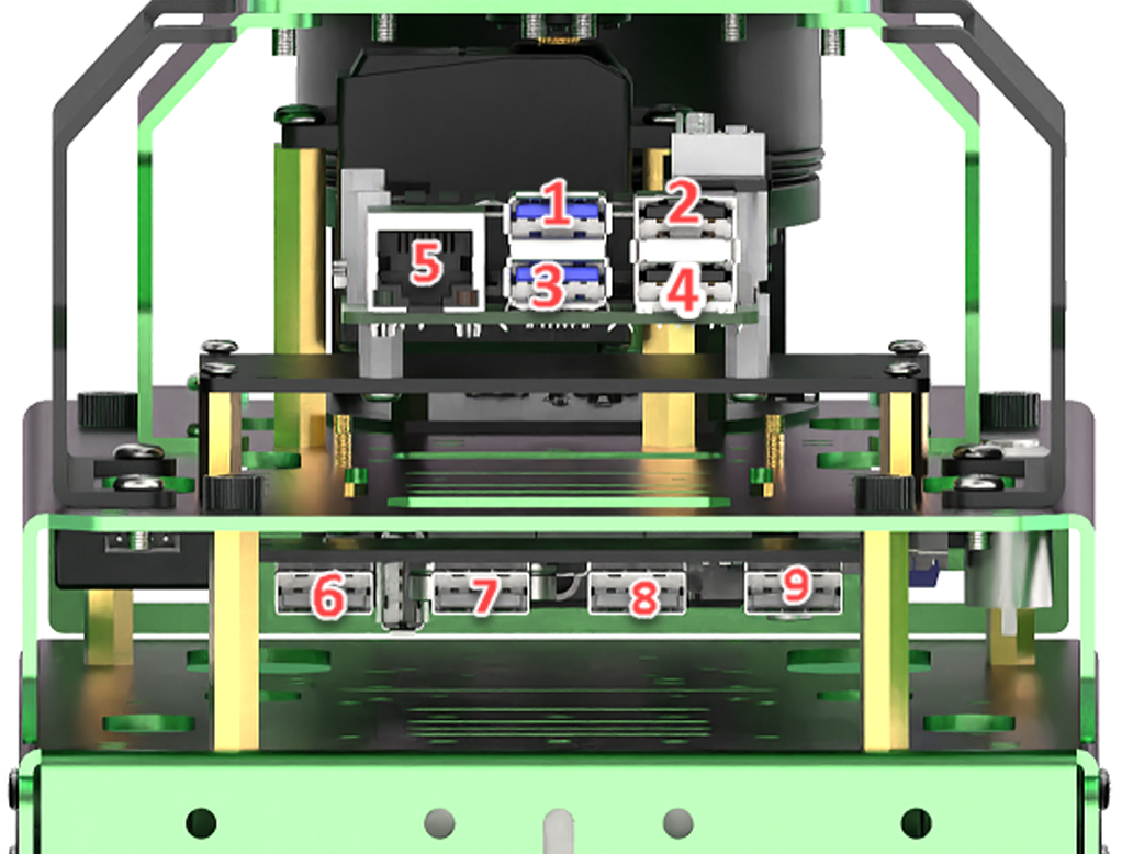

  • Raspberry Pi 5 Controller Wiring
Please refer to the table below and connect each accessory to its corresponding port on Raspberry Pi 5 board and USB hub. If any of the listed accessories are not included in your kit, please ignore the corresponding port number.
NO. Name
1 Depth camera port
2 USB hub Communication Interface
3 STM32 controller communication cable
4 7-inch LCD display power cable (not included in the standard kit)
5 Ethernet interface
6 Lidar port
7 Reserved custom interface
8 Reserved custom expansion port
9 Microphone array module (not included in the standard and advanced kits)
NO. Name
10 Power supply for ROS main controller (Raspberry Pi)
11 Micro HDMI interface (connect to the HDMI interface of the 7-inch LCD display)

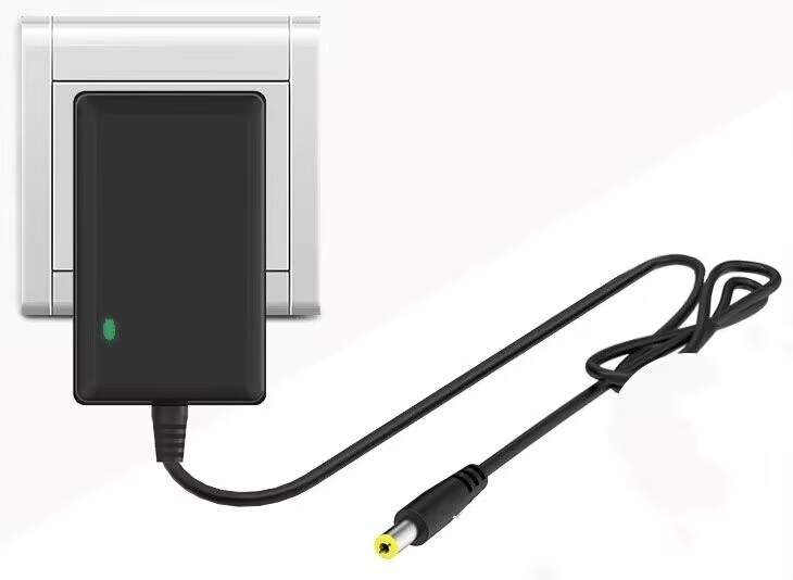

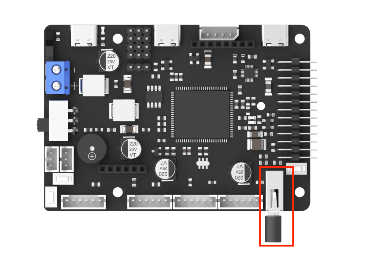

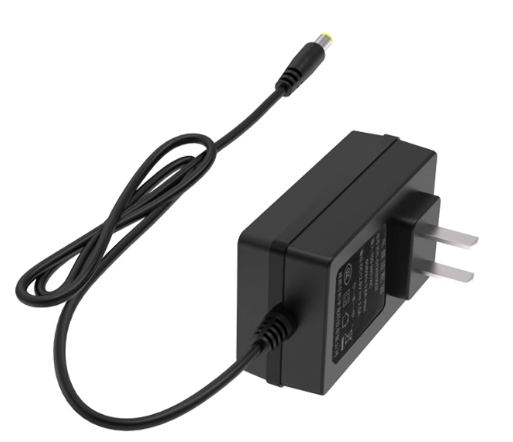

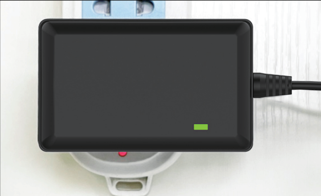

(1) Charge battery with the provided charger. Turn off the switch on the power supply board and never use it while charging
(2) Indicator on charger changes green when it connects to battery but not plugged into a power outlet. Indicator turns green after the battery is fully charged.

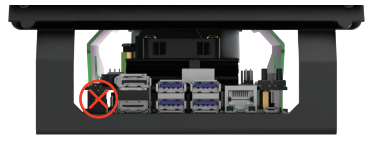

(3) Do not directly connect the charger to DC power port of Jetson Nano board, otherwise the board will be burned.
(4) Unplug charger in time to avoid overcharging.
(5) If battery voltage drops below 10V, the buzzer will sound an alarm. Please charge the battery promptly.
(6) In case robot won’t be used in a long period of time, please fully charge battery first, then disconnect battery wires.
(7) Always keep battery in cool and dry environment, otherwise battery lifespan gets shortened. Never intentionally hit, throw or step on your Lipo battery.
(8) Avoid using the battery in environments with strong static electricity or a strong magnetic field, as this may damage the safety protection device of the battery.
(9) Do not plug the battery into a power outlet, and do not use metal objects to connect the positive and negative poles of the battery.
(10) If robot won’t be used in a long period of time, please fully charge battery.
(11) It is strictly prohibited to modify, weld, or convert battery charger or Lipo battery.
(12) Keep battery away from high temperature and liquid to prevent overheating, fire and damp, which result in function decline.
Please strictly follow the guide. Our company is not responsible for any product damage, economic losses and accident caused by improper use.

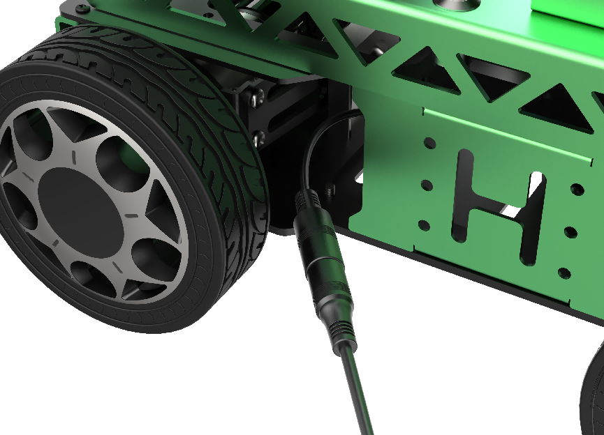

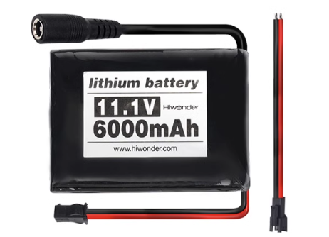

(1) Take out the DC connector of the lithium battery from the side or bottom. Connect the charger to charge the battery.
Mecanum/Tank chassis Charging Port diagram
Ackerman chassis charging port diagram
(2) Users can view the charging status by observing the indicator on the charger. The red light indicates that the battery is charging, while the green indicates that the charging is complete.
After the charging is complete, please promptly unplug the charger to avoid overcharging.

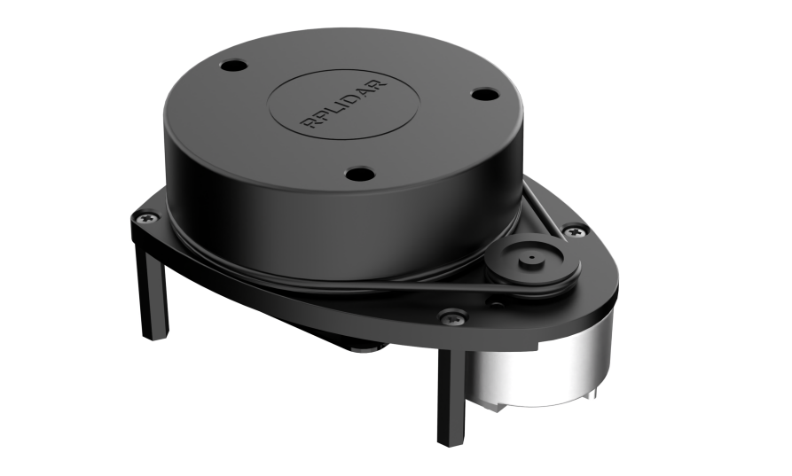

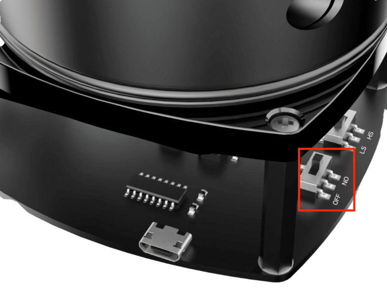

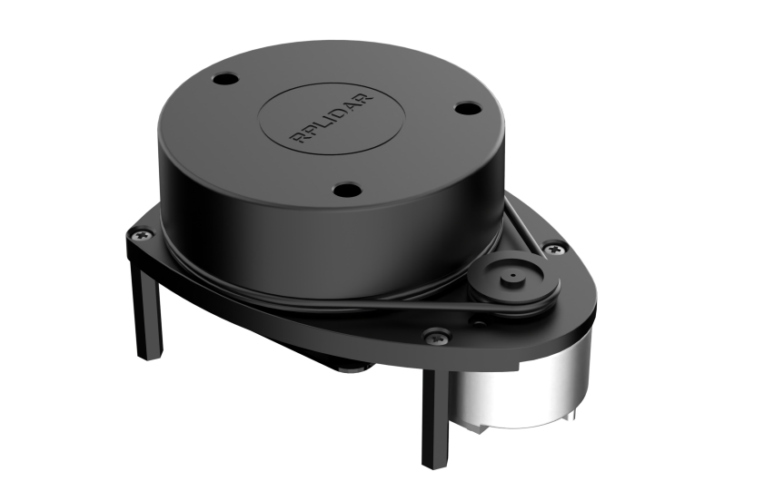

(2) In terms of Lidar, different Lidar models also have different performances when starting up. The left image below is A1 Lidar and the right is the G4 Lidar:
If you choose the ultimate kit with Lidar G4, the Lidar will spin for a few rounds, then stop until the robot boots up successfully.
For other robot kits with Lidar A1, you need to push the switch to the “ON” side. The Lidar will continue to rotate after a short period of time after being turned on.

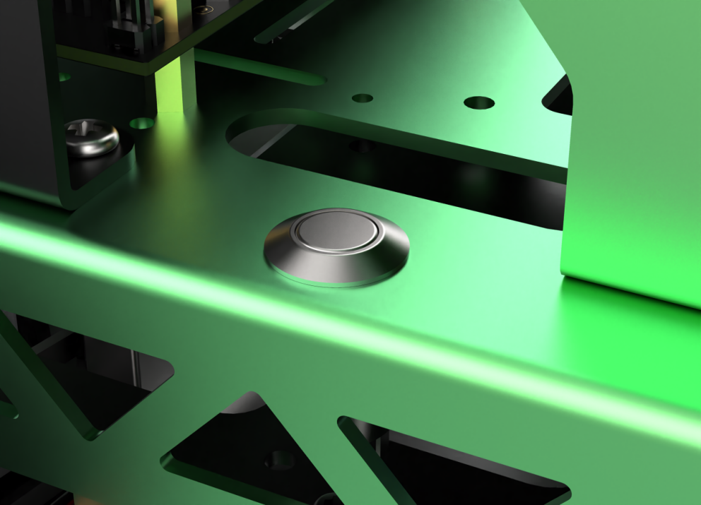

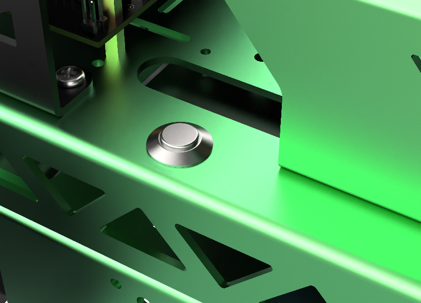

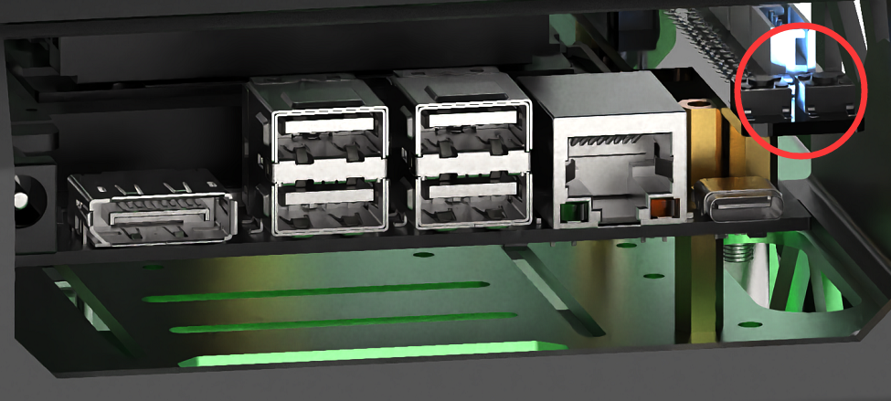

(1) Press the switch at right side of the robot.

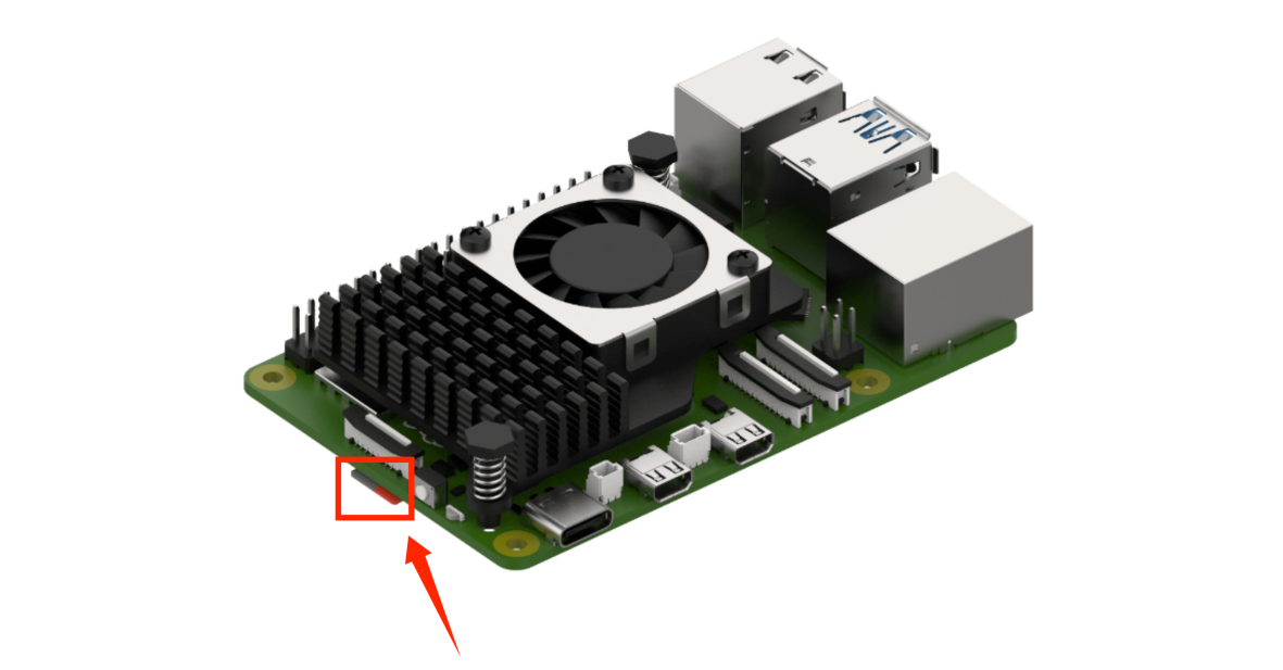

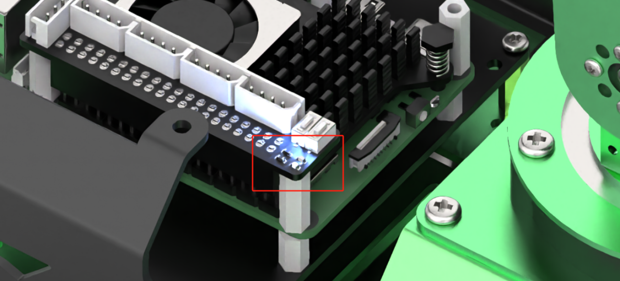

(2) The blue LED1 on the expansion board will light up and keep blinking. At this moment, only the network configuration service is enabled, but ROS and other services have not yet completed this process. Wait for a short “Beep” from the buzzer to indicate that the device has started.
The LED indicator for Jetson Nano, Jetson Orin Nano and Jetson Orin NX versions is as pictured:
The LED indicator for Raspberry Pi5 version is as pictured:

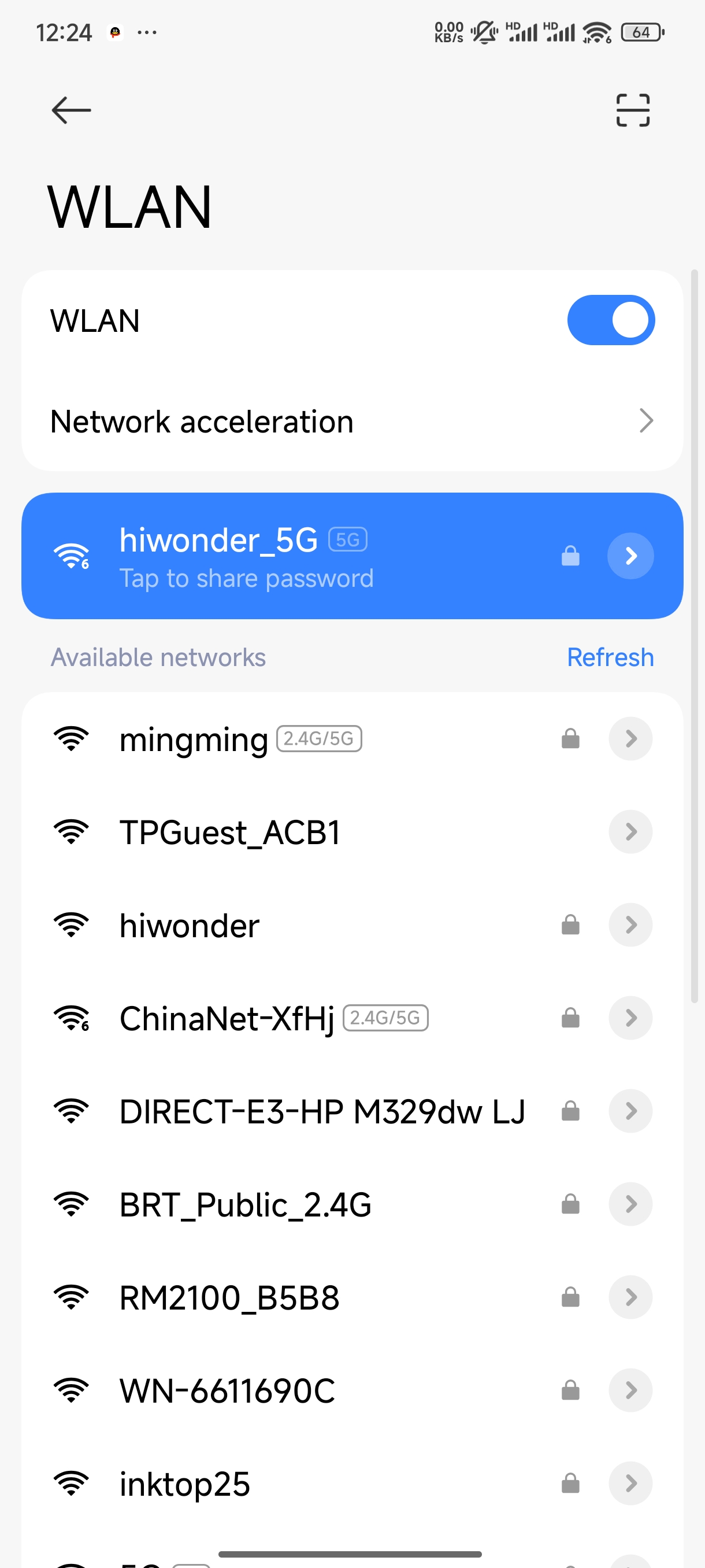

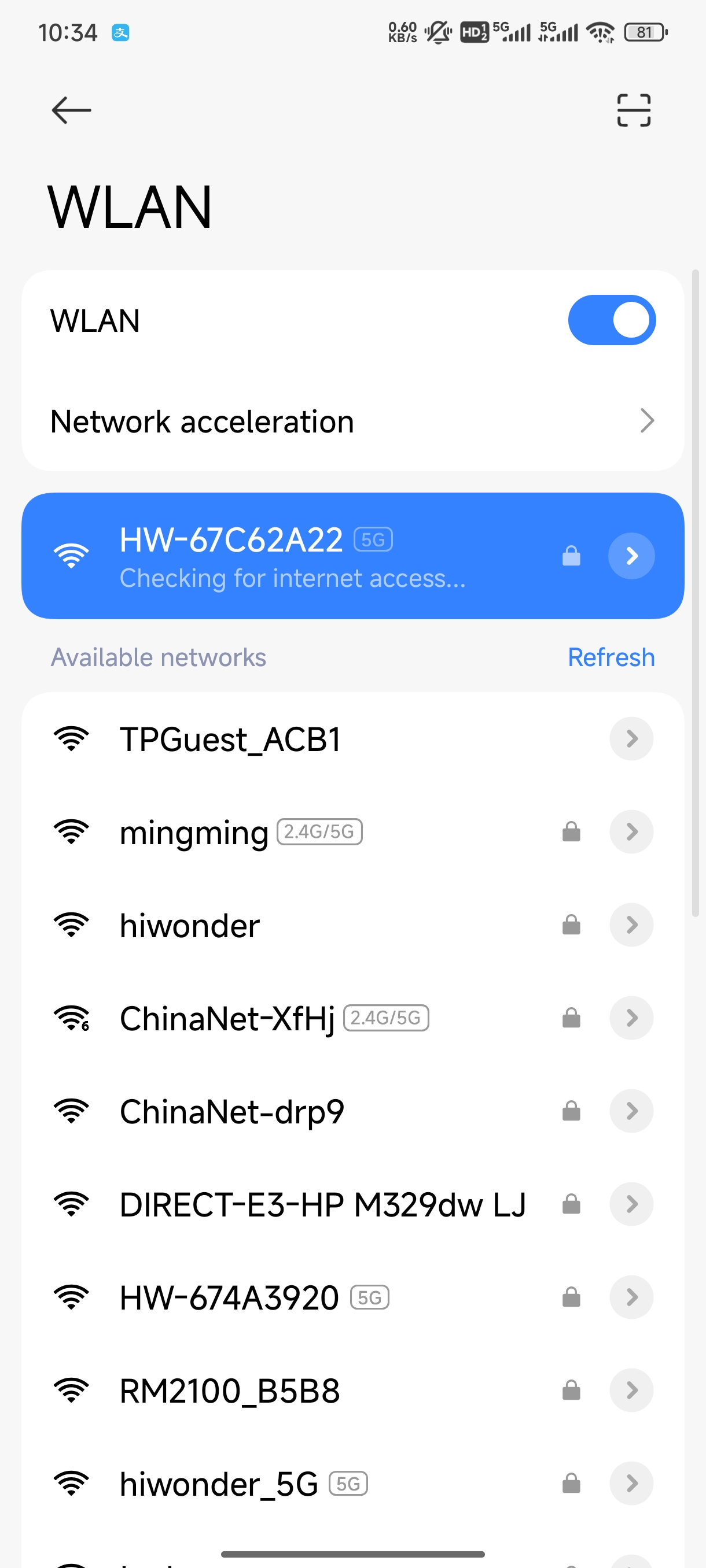

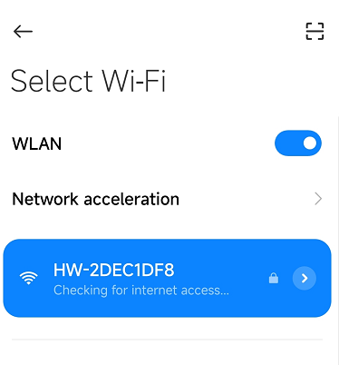

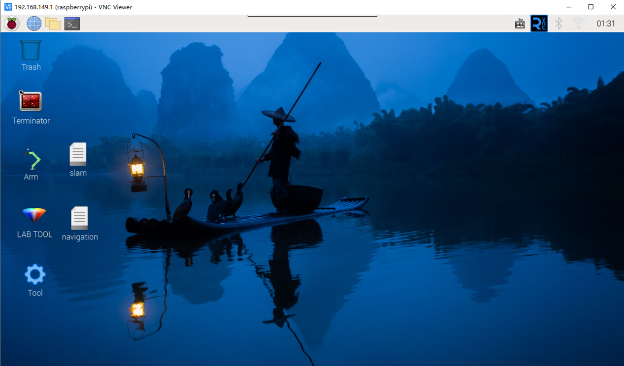

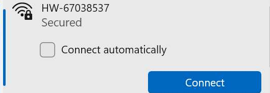

(3) After robot boots up successfully, robot is default to AP direct connection mode and generates a WiFi starting with “HW”. The initial WiFi password is “hiwonder”.
  • WiFi Troubleshooting
If you cannot find the generated WIFI, please troubleshoot from the following:
  • Follow above three steps in “Robot Startup State & Testing Instruction” for troubleshooting.
  • If the LED1 on expansion board is flashing blue and keeps on, it may be set to LAN mode. In this case, please press and hold the Key1 button for 5-10 seconds. If LED1 starts flashing, indicating that a WI-Fi starting with “HW” is generated.

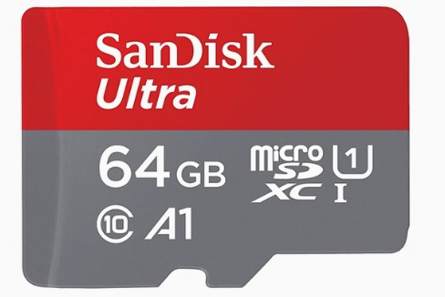

  • If the KEY1 button doesn’t start flashing after the above operation, SD card or SSD may not be detected, try re-inserting the SD card or SSD.
  • If the LED1 on expansion board always remains on after re-inserting the SD card or SSD, it may indicate an issue with the SD card or SSD.
  • If you have completed all five steps above and the issue persists, it may lie with Raspberry Pi board or Jetson board. Please reach out to our support team via email at support@hiwonder.com for further assistance.

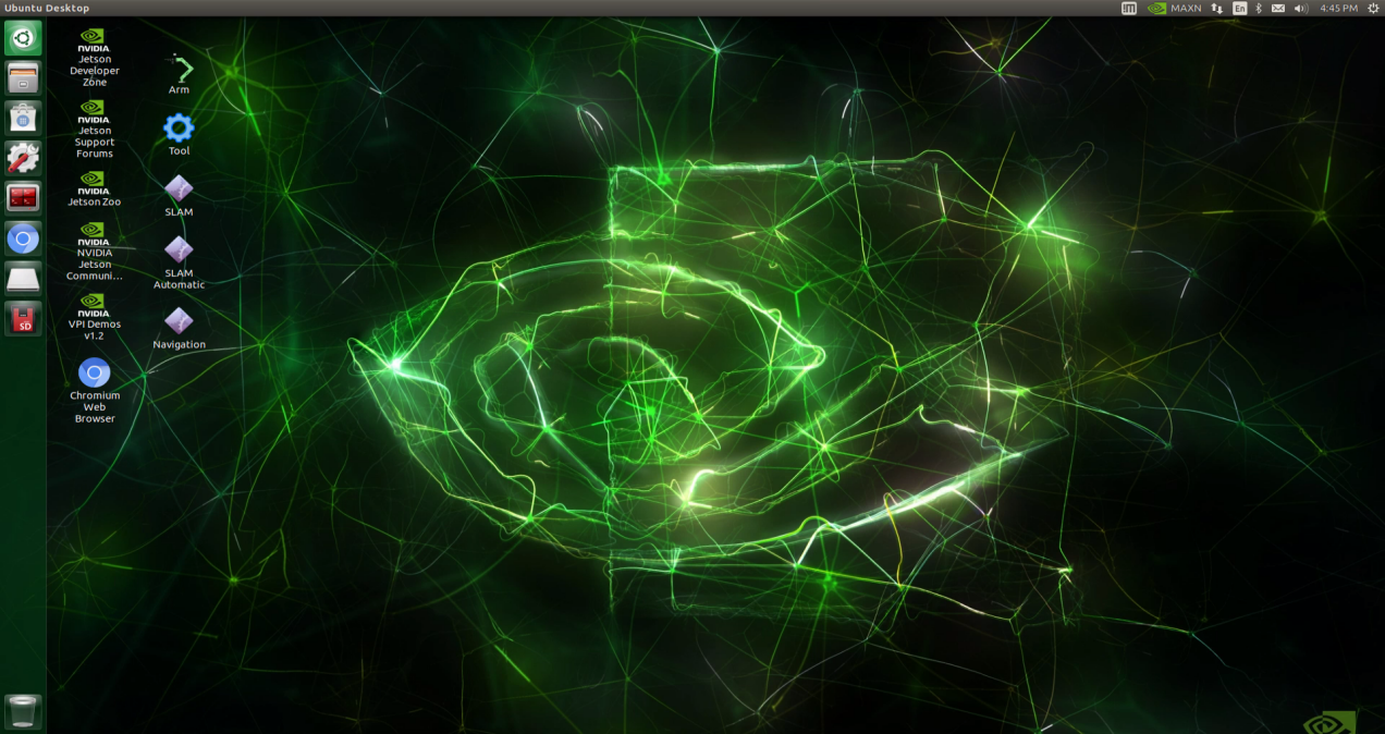

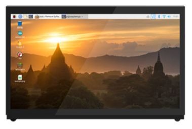

(4) After the 7-inch display is installed, it will display the system image after the robot starts up. If you’re the user of advanced kit or ultimate kit, you will also hear a “I’m ready” broadcast.

Lidar Observe the rotation status Lidar model: (1) Lidar G4: Upon initial startup, it will rotate for a few rounds, then stop. After the robot startup is complete, it resumes rotating. (2) Lidar A1: it will keep rotating after a brief wait following startup.

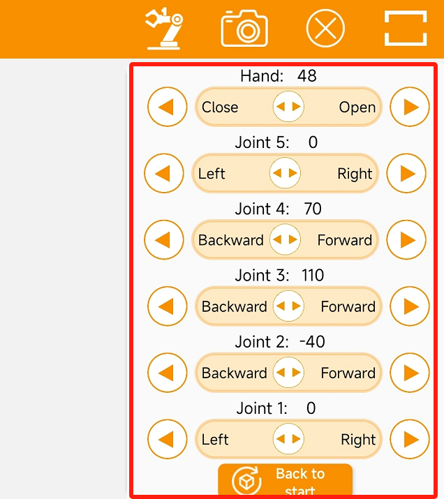

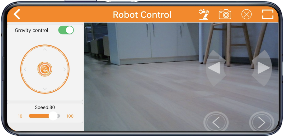

Depth camera + robotic arm (1) Connect to the robot via app. (2) Open "Robot Control" to view the live camera feed from the depth camera. (3) Swipe the screen to simultaneously control the servo on the pan-tilt. (4) Slide the robot arm control buttons for controlling each joint's servo. Display the live camera feed and rotate.

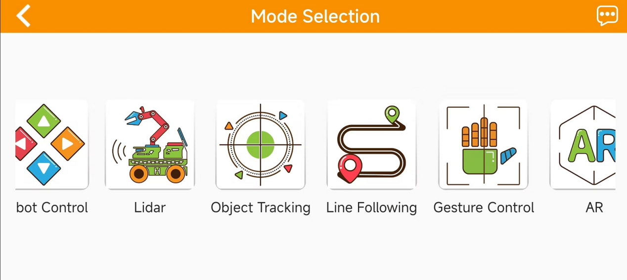

1.5 APP Control
Users can control the robot via the app WonderAi, and experience the AI vision features. This section will elaborate the operation instructions for each function in the app.
If you have purchased the robot kit without Jetson or Raspberry Pi board, please first go through the content from 1.6 Development Environment Setup and configurationto 1.6.7 Robot Version Configuration Tool Instruction.
1.5.1 APP Installation
  • Please ensure all permissions are granted for the APP, otherwise certain app functions may be affected or unavailable.
  • Turn on location and Wi-Fi before using the APP.

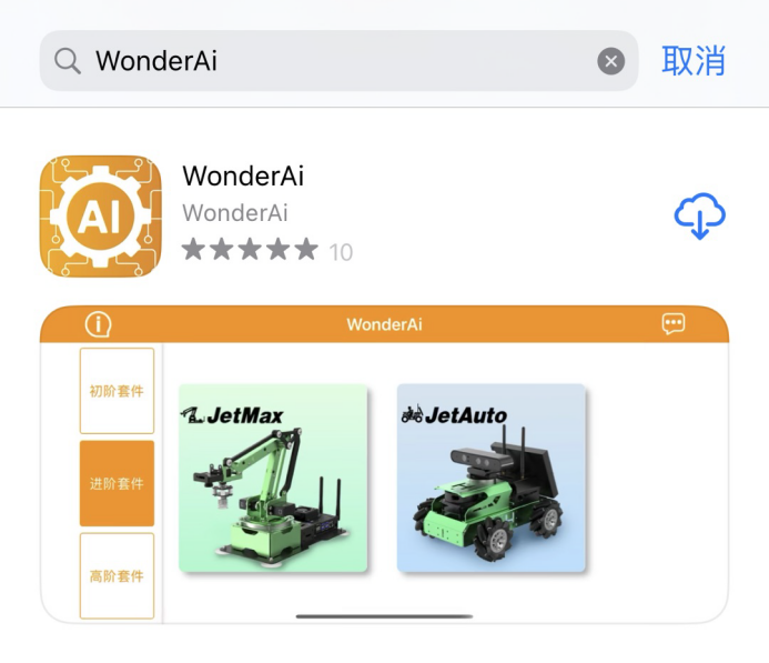

(1) APP Installation Pack (Android): WonderAi
(2) APP Installation Pack (iOS): WonderAi

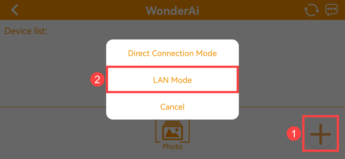

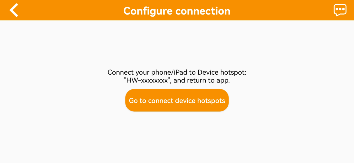

1.5.2 Connection Mode Introduction

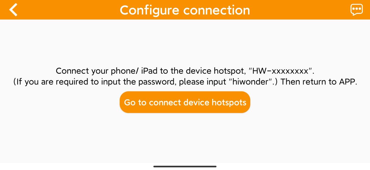

There are two network modes, including AP direct connection mode and STA LAN mode.
(1) AP direct connection mode: Jetson Nano generates a WiFi which can be connected by phones. This WiFi has no internet access.
(2) STA LAN mode: Jetson Nano actively connects to specific WiFi. You can access Internet in this mode.
The default connection mode is AP direct connection mode. Whether you choose AP direct connection mode or STA LAN mode, robot performs the same.
It is recommended to experience robot games under Direct Connection Mode.
1.5.3 Direct Connection Setup
iOS system requires version 11.0 or above, and Android system requires 5.0 or above.
Special attention for Android users: Please ensure all permissions are granted for the APP, otherwise certain app functions may be affected or unavailable.

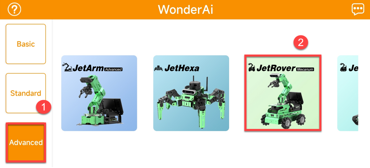

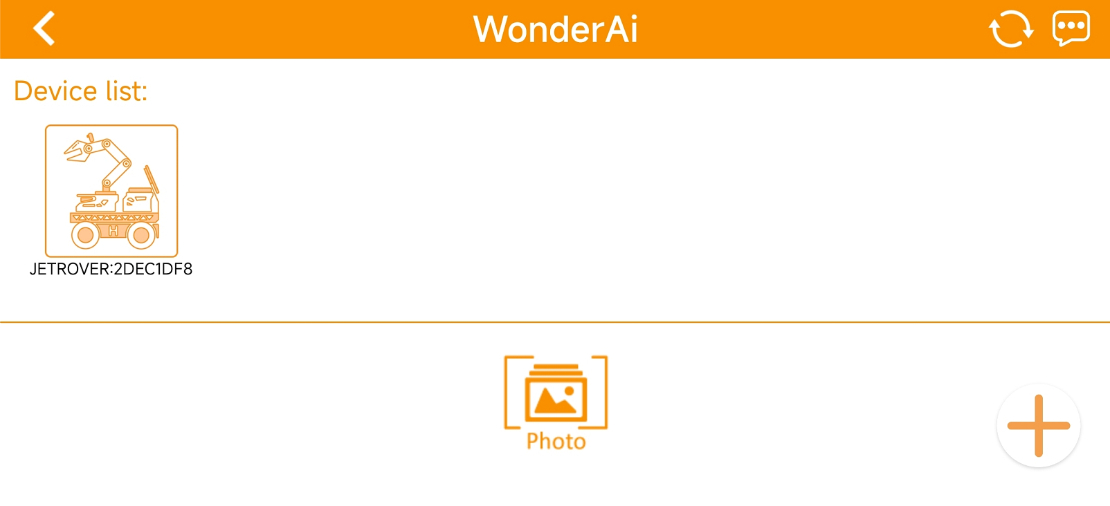

This section will take the app of Android system to control JetRover mecanum version as an example. The same operations apply to iOS system.

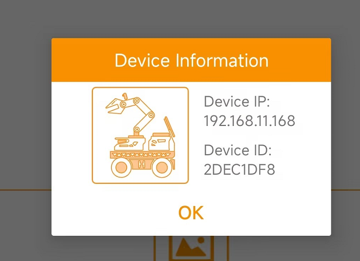

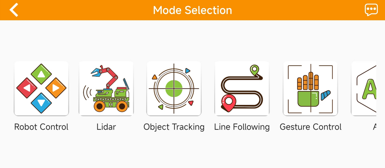

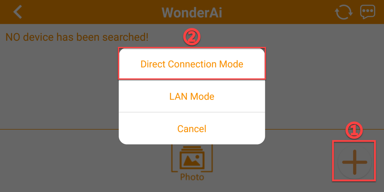

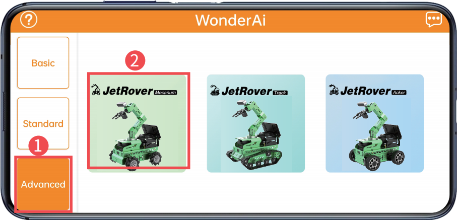

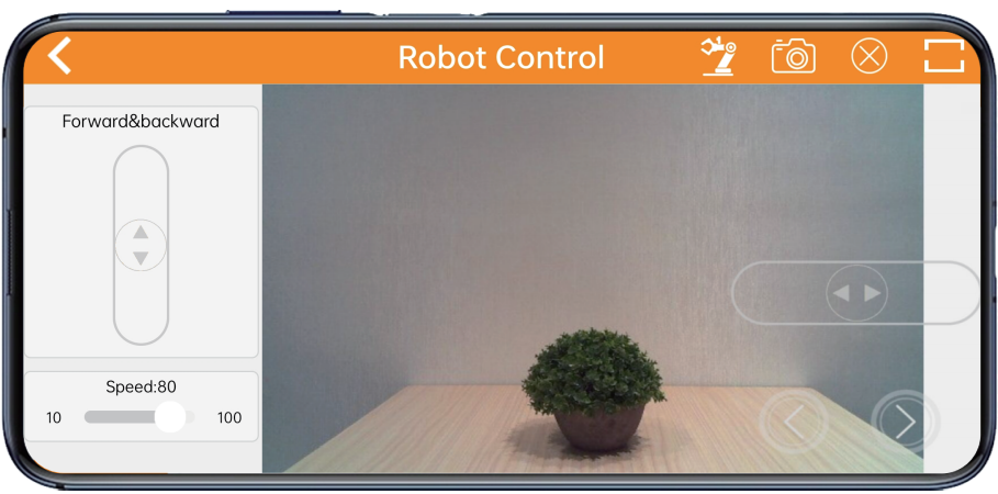

(1) Open “WonderAi” APP, then tap “Advanced” → “JetRover(Mecanum)” in sequence.
“JetRover (Track)” for tank chassis version, and “JetRover(Acker)” for Ackerman chassis version.
(2) Click “+” button, and select “Direct Connection Mode”.
(3) Click “Go to connect device hotspots” to join the WiFi generated by JetRover.
(4) The device WiFi starts with “HW” and the password is “hiwonder”.
For iOS user, please do not return back to the APP until the WiFi icon appears above, otherwise JetRover cannot be searched. If JetRover cannot be searched, please click to refresh.
(5) Return to the APP, and click the robotic icon to enter home interface.
If you are informed of “No Internet Connection. Whether to keep connection”, just select “Keep Connection”.
(6) After clicking on the robot icon, the mode selection interface is as pictured:

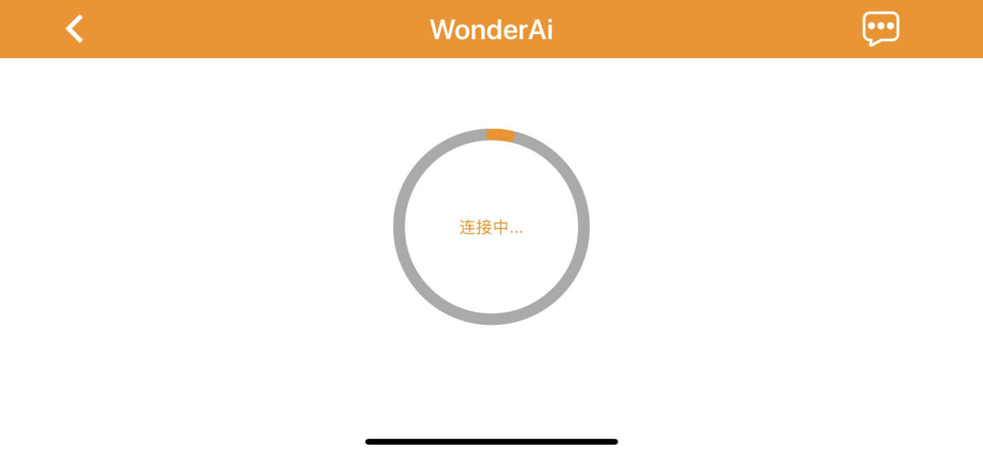

1.5.4 LAN Mode Connection
(1) Firstly, join 5G network, for example “Hiwonder_5G”. (The router supporting dual-frequency will distinguish the Wi-Fi name by default under the situation that 2.4 G and 5G are separated. For example, Wi-Fi “Hiwonder” is 2.4 frequency band while “Hiwonder_5G” is 5G frequency band)
(2) After connection, open WonderAi. Then click “Advanced” → “JetRover (Mecanum)” in sequence.
(3) Click “+” button at the lower right corner, then select LAN Mode.

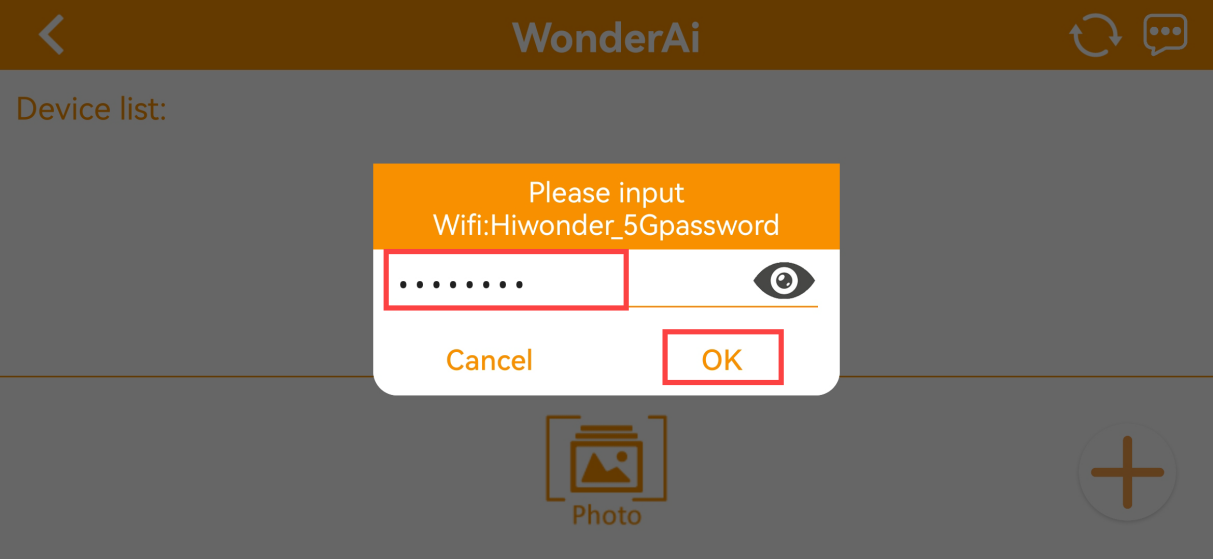

(4) Continue, enter the Wi-Fi password. Having entered the password, click “OK”. Please ensure the password you enter is correct.
(5) Click “Go to connect device hotspots”.
(6) Join the WiFi starting with HW, and input the password “hiwonder”. After connection, return back to the APP interface.
(7) At this point, WonderAi APP is connecting to the robot.
(8) After a while, the robotic icon will show up. And at the same time, LED1 on the expansion board will light up.
(9) By long pressing the robotic icon, you can check the IP address and ID.
(10) Input this IP address in the search bar on remote desktop software. Then you can enter the robot system desktop. For how to operate, please refer to 1.6 Development Environment Setup and configuration.

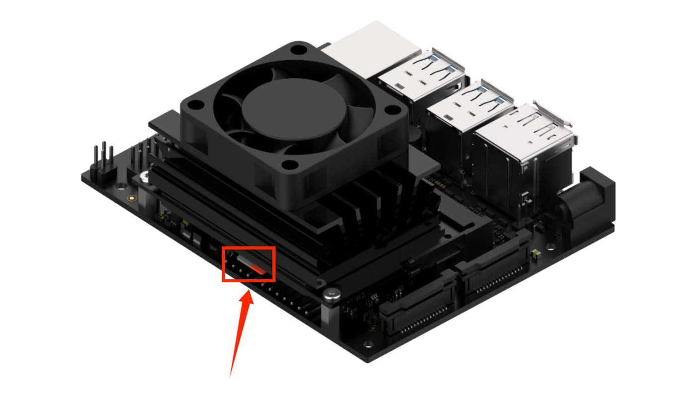

(11) If you want switch back to Direct Connect Mode, press KEY1 button on Jetson Nano expansion board until blue LED flashes, which means the current mode is Direct Connect Mode.
1.5.5 APP Control Functions
There are 6 games on APP, including robot control, lidar, object tracking, Intelligent patrolling, gesture control, and AR.
The brief instruction for each game is shown in the table below:
Icon Game Instruction
Robot Control Control the movement of the robot.
Lidar There are three lidar functions, including avoid obstacle, lidar following and lidar guarding.
Object Tracking Select the color for the target, allowing the robot to track the target.
Line Following Pave the line, choose the line color as the recognizable color and the robot will move along the line.
Gesture Control Control the robot's movement through the movement trajectory of the palm such as, forward and backward, left and right turns, left and right translations (mecanum chassis only)

  • Mecanum/Tank Chassis Version Interface
Tap “Remote Control” in the game selection interface to enter the operation interface. The interface is as follow:
(1) The buttons on the left, from top to bottom, are gravity control button, robot’s movement control and speed adjustment slider.
(2) The middle is the live camera feed (you can swipe the screen to rotate the camera’s pan-tilt).
(3) The buttons on the right, from top to bottom, are left and right turn control buttons and pan-tilt rotation control buttons.
(4) The icons in the top menu bar are respectively for robotic arm control, screenshot, close menu bar, switch to full-screen mode (this function is usually used with wireless controller).
  • Ackerman Chassis Version Interface
(1) The buttons on the left from top to bottom are forward and backward, speed adjustment.
(4) The icons in the top menu bar are respectively for robotic arm control, screenshot, close menu bar, switch to full-screen mode (this function is usually used with PS2 wireless handle).
  • Robotic Arm Control Interface
(5) Tap to display the control panel for each servo of the robotic arm. It allows the robot to be controlled

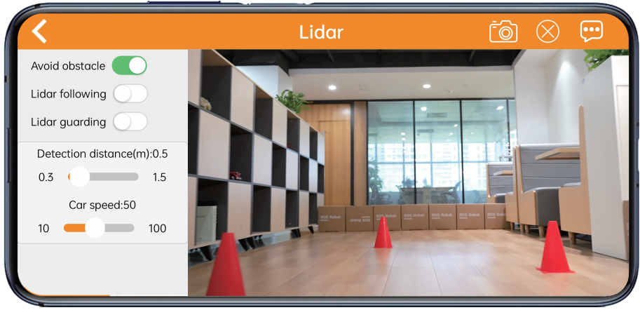

1.5.7 Lidar Functions
  • Before starting the game, please place the robot on a flat surface to ensure an enough space for the operation.
  • In “Avoid obstacle” and “Lidar following”, the robot has a detection range of a 90 degrees sector in front.
  • JetRover Ackerman chassis version does not support “Lidar guarding” function.
  • The obstacle height must be greater than the car body.
  • Avoid Obstacle
When detecting the obstacle, the robot will turn automatically to avoid the obstacle.
  • Lidar Following
When detecting the obstacle, the robot will adjust its posture to keep a certain distance between it and the obstacle.
  • Lidar Guarding
After the game starts, JetRover will adjust its body to face the obstacle when detecting the obstacle.

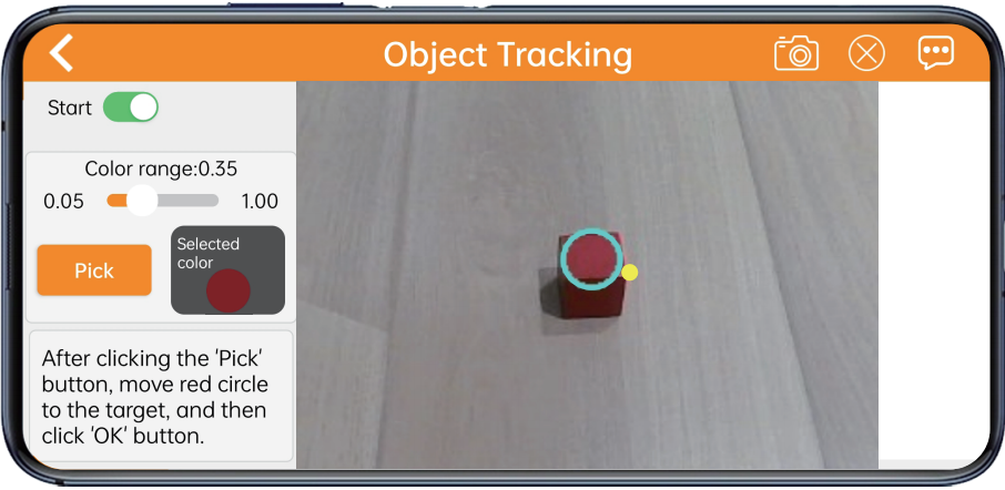

1.5.8 Target Tracking Function
  • Place the object and the robot on the same surface, and move the object in a translational manner to achieve a better performance.
  • Choose a moderate color range, not too large or too small. If the range is too large, it may include colors outside the target; if too small, the target may be easily lost. Additionally, do not allow objects with colors similar to the target to appear in the camera view.

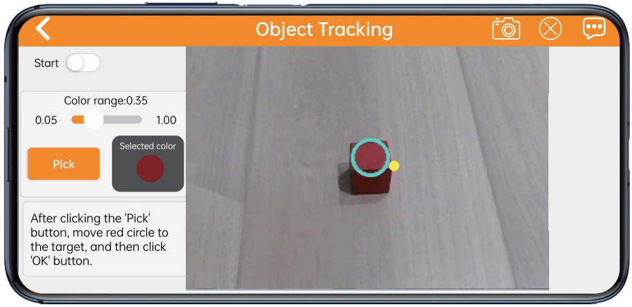

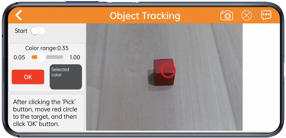

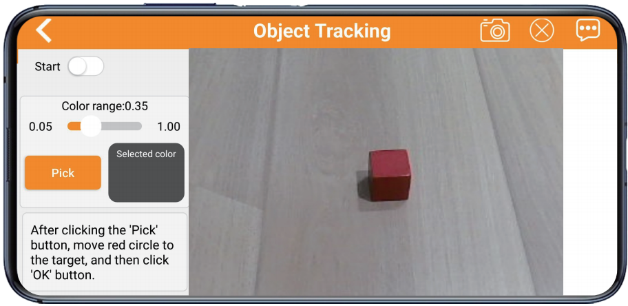

(1) Tap “Object tracking” in the game selection interface to access its operation interface. Here, we use a red block for demonstration. Tap “Pick” button.
(2) Firstly, click “pick”, then drag the red circle on the camera returned image to the target to extract the color.
(3) After clicking “OK”, the “selected color” box will display the color.
(4) Click “Start” button. When moving the target object, JetRover will move following the object.

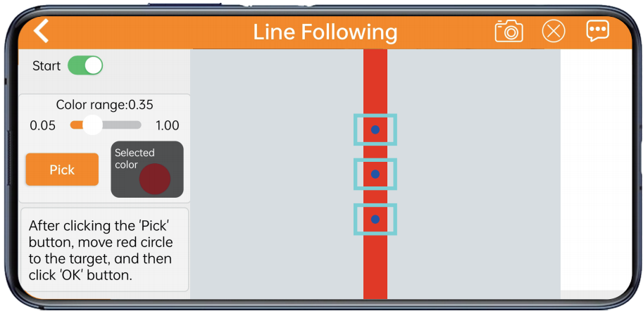

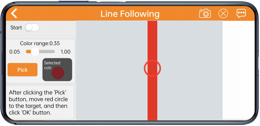

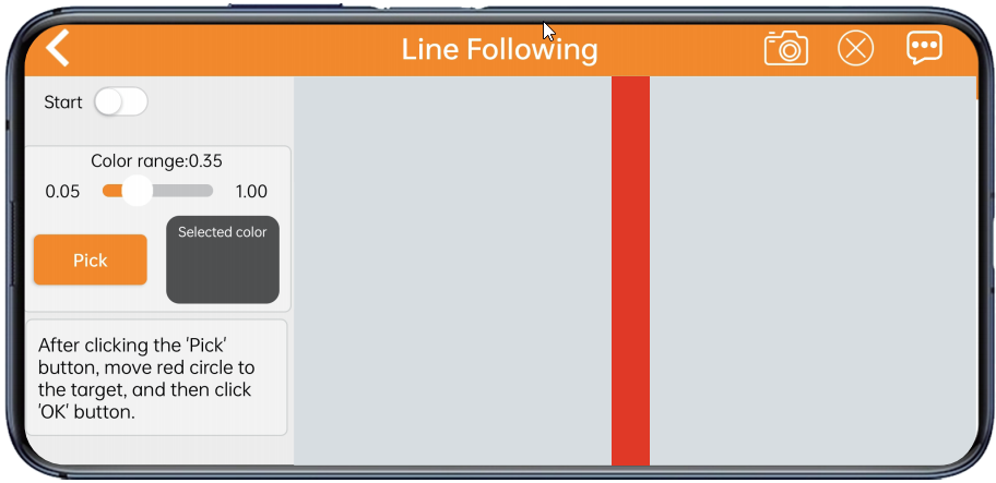

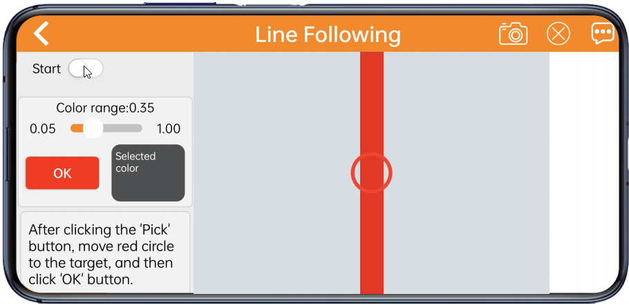

1.5.9 Line Following Function
  • Before starting the game, please pave the track using a tape and place the robot on the track.
  • The color picking range should not be moderate. If the range is too large, the color outside the target will also be selected. If the range is too small, it will be easy to lost the target. Additionally, please do not have any objects in the camera’s field of view that are similar in color to the target.
(1) Click “Line Following” on the mode selection screen to enter the operation interface. A red tape is used as a line for demonstration. Tap “Pick” button to pick the line color.
(2) Drag the red circle on the camera returned image to the path to pick the color, then click “Pick color”.
(3) Next click “Confirm” button. The color you pick will display at the right box.
(4) Lastly, click “Start” button, then the robot will move along the path.

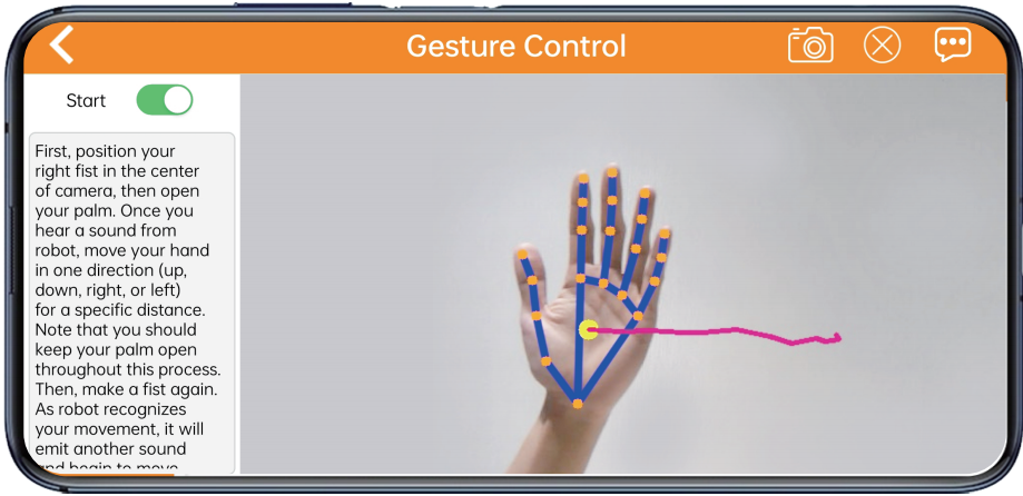

1.5.10 Gesture Control Function
  • This game supports the right hand.
  • During the recognition, it is necessary to appear the entire palm within the camera’s field of view.
  • Please move the hand at a moderate speed, do not too fast.
(1) Click “Gesture Control” at the mode selection interface to enter the operation interface of this game.
(2) Click “Start” and follow the instructions for this game. Once the gesture movement trajectory is recognized, the robot will move accordingly.

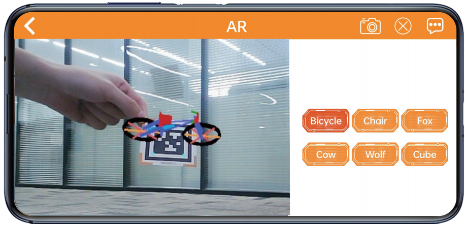

1.5.11 AR Function
Place a random tag within the camera’s field of view and select any 3D image option on the right. Take “bicycle” in here. The three-dimensional image of a bicycle will be displayed at the location of the tag.

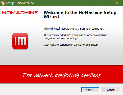

1.6.2 NoMachine Installation
This tool is applicable to Jetson controller versions.

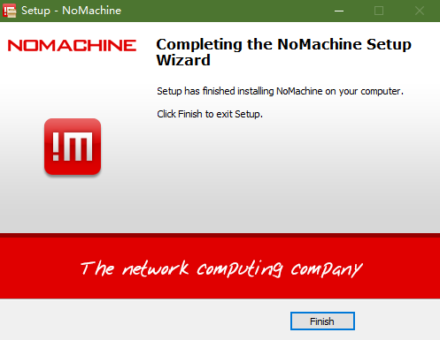

(1) Enter the same directory as this document to open the installation package nomachine_8.4.2_10_x64 in the folder Appendix -> 2. Remote Connection Tool.
(2) Click “Next”.
(3) Then click “I accept the agreement” in the prompt box, and set the “Language” as “English”, then click “Next”.
(4) Remain the default installation path. Click “Next”.
(5) Click “Yes” to restart the computer (Please do not skip this step).

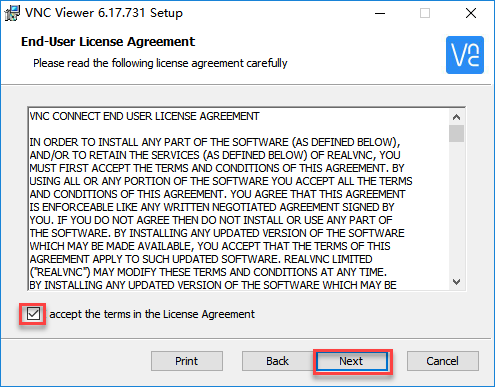

1.6.3 VNC Installation
This tool is applicable to Raspberry Pi 5 version.
Enter the same directory as this document to open the installation package “VNC-Viewer-6.17.731-Windows” in the folder “Appendix -> 2. Remote Connection Tool”. In the pop-up dialog box, select ‘English’ as the installation language and click the ‘OK’ button.
(1) Click “Next”.
(2) Then click “I accept the agreement” in the prompt box, and continue.
(3) Click “Install”.
(4) Click “Finish” to complete the installation.
(5) Once VNC is connected, simply click-on to access it.

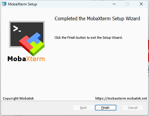

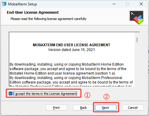

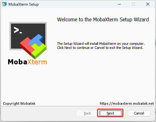

1.6.4 MobaXterm Installation
This tool is applicable to any robot version.
(1) Locate the MobaXterm installation package in this folder ‘2.Appendix->2. Remote Connection Tool’.
(2) Click “Next”.
(3) Then click “I accept the agreement” in the prompt box, and click “Next”.
(4) Keep the default installation position,and click “Next”.
(5) Click “Install”.

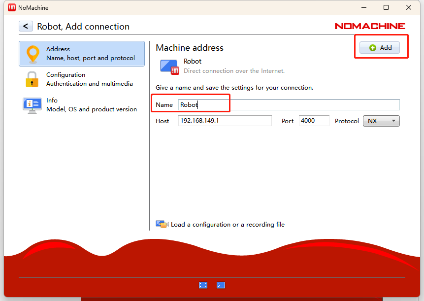

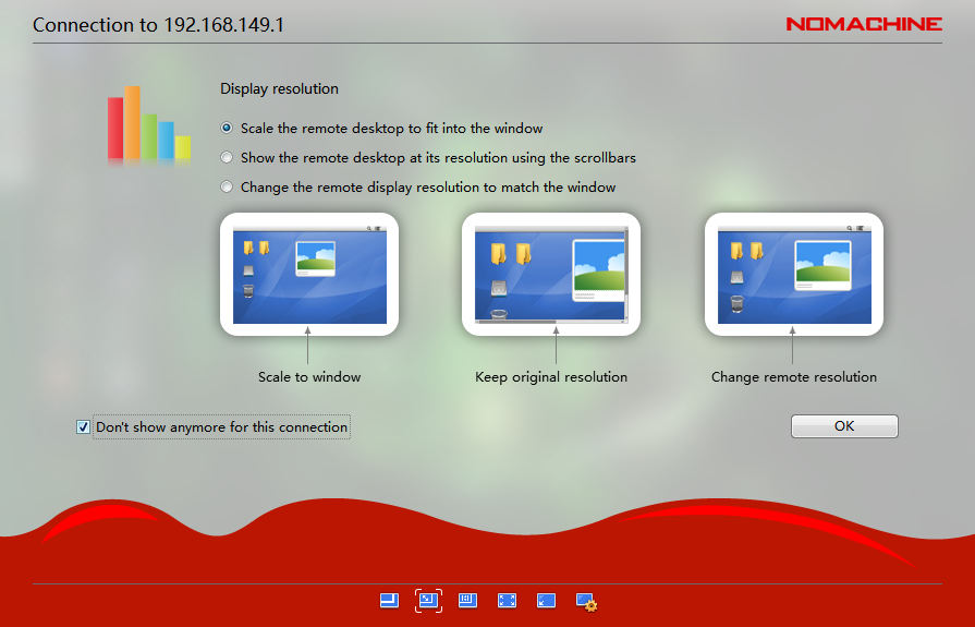

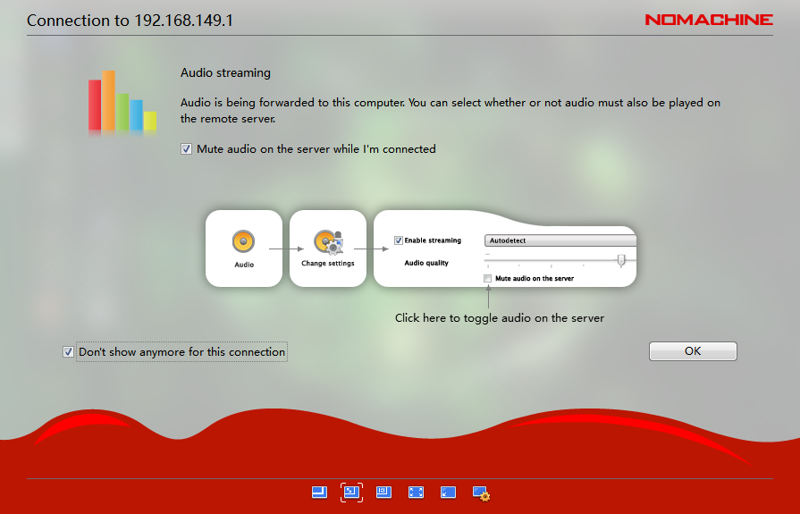

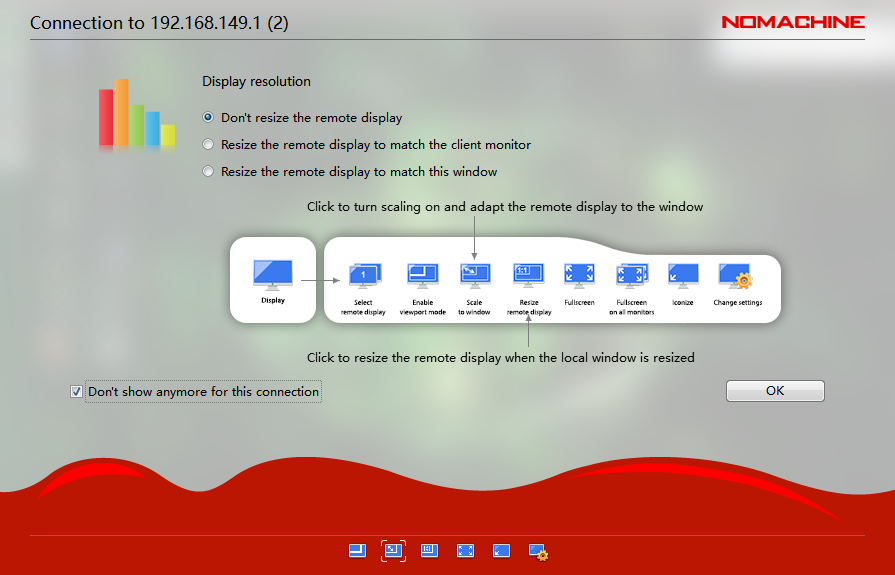

  • Establish Connection via NoMachine
(1) The robot is set to AP direct connection mode by default. After booting up successfully, it will create a hotspot starting with “HW”. As the picture shown below, the connection password is “hiwonder”.

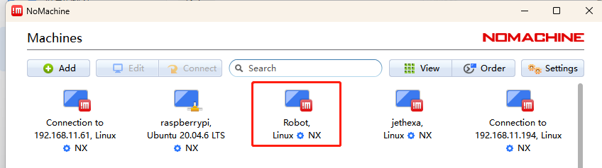

(2) Open NoMachine, input the IP address “192.168.149.1” in the search bar in AP mode, and click “Configure connection to new host 192.168.149.1”.
(3) After opening, follow these steps: click on Address -> Name, enter “robot” -> Host, enter “192.168.149.1” -> click Add.
(4) Double click on “Robot” to open it.

(6) Check the “Save this password” box, then click the Login button. Below will take “Jetson Nano” version as an example:
(7) Afterwards, you will see the remote desktop of the Jetson Nano open up.
  • Establish Connection via VNC
(1) Search for and connect to the hotspot starting with “HW”, as shown in the following figure. The password for the connection is hiwonder.
(2) Next, open VNC software. In the VNC Viewer, enter the IP address “192.168.149.1” in the search bar in AP mode, and press Enter. If you receive a security warning, click ‘Continue’
(3) Wait for the connection window to pop up, then enter the following in order: Username -> Password -> Click ‘Remember password’ -> Click ‘OK’:
Username: pi Password: raspberrypi
(4) Once connected, the Raspberry Pi’s remote desktop will appear as shown in the image below.

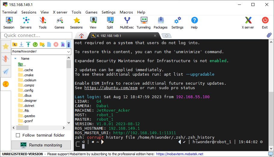

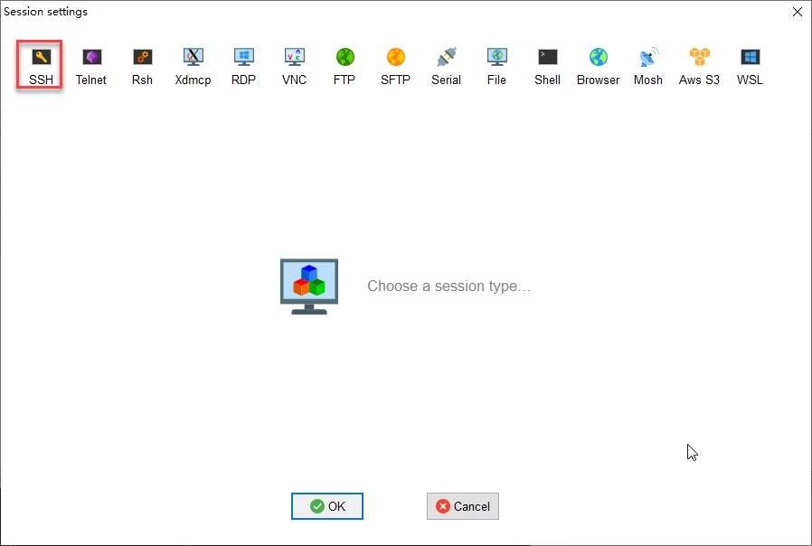

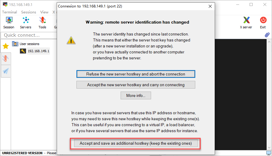

  • Establish Connection via MobaXterm
This section takes “AP Direct Connection” as an example to illustrate. The same operation method is applicable to LAN mode. You just need to change the IP address.

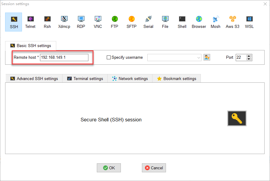

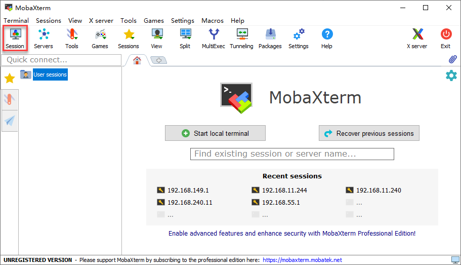

(1) In the main interface, click “Session” on the top right corner to create a session. In the session interface, enter the recorded Raspberry Pi 5 IP address “192.168.149.1”, and then click “OK”.
(2) Choose SSH.
(3) Enter the fixed IP address in AP direction connection mode:
192.168.149.1
(4) As pictured, you need to select the third option.
(5) The interface will prompt users to enter the login as and password. It is necessary to fill in the username and password based on the control board version (Below will take Jetson Nano version as an example):
Initial configuration for Jetson Nano board: username: hiwonder, password: hiwonder
Initial configuration for Jetson Orin Nano board: username: ubuntu, password: ubuntu
Initial configuration for Jetson Orin NX board: username: ubuntu, password: ubuntu
Initial configuration for Raspberry Pi 5 board: username: pi, password: raspberrypi
  • The username must be entered in lowercase mode. Even if the username includes uppercase letters during setup, it must be entered in lowercase when logging in.
  • The username will be visually displayed. After entering it, press Enter to proceed to the password input.
  • The password will not be visually displayed. After entering the password, press Enter to log in.
(6) When the input password is correct, you will get access to the system. The system interface is as pictured:

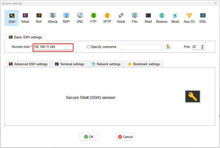

(1) In the main interface, click “Session” on the top right corner to create a session. In the session interface, enter the recorded robot IP address “192.168.11.134”, and then click “OK”.
(2) Choose SSH.
(3) Enter the IP address obtained in LAN mode: 192.168.11.134

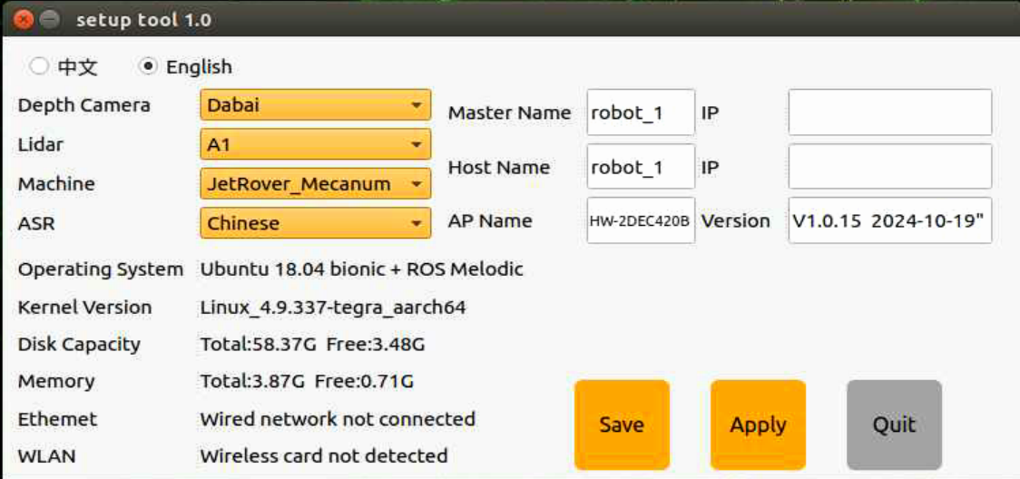

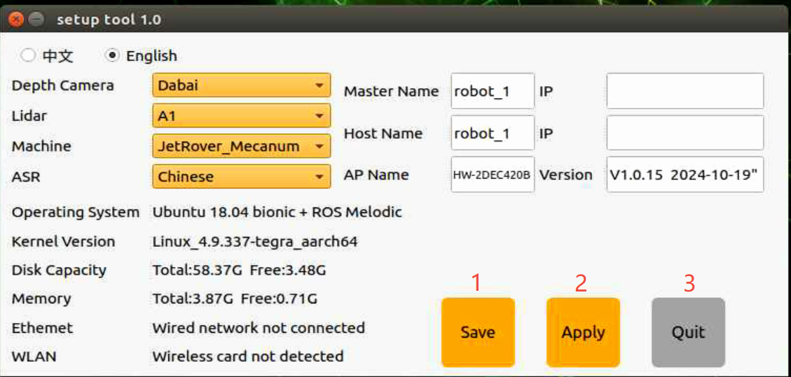

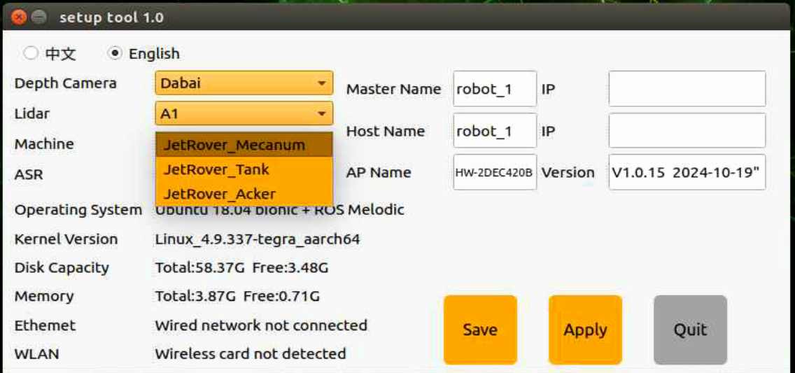

This section will introduce the robot system’s built-in version configuration tool, which allows switching between different chassis configurations, Lidar types, camera models, and Chinese/English voice settings.
It is applicable to the following users:
(1) Users who have purchased a robot kit without control board.
(2) Users who have re-flashed the system image.
(3) Users who have replaced other accessories supported by the system, such as switching from a Mecanum wheel chassis to a tracked chassis.
For users who have purchased a complete robot kit with control board, they only need to be aware of the content and do not need to take action. Before learning how to use the tool, you can first confirm the system version configuration based on the control board model you purchased.
  • Tool Introduction and Usage
(1) Use the NoMachine remote desktop connection tool to connect to the robot. For specific connection methods, refer to section Remote Device Connection.
(2) Once connected to the remote desktop, double-click on or for robot system configuration.
(3) In the interface, select the desired robot type options, as shown in the red-boxed area in the following image.
(4) Users can check your order information to obtain the hardware version. It typically needs to configure the following areas in the tool: Depth Camera, Lidar, Machine, ASR. Please refer to the table below. Keep the other options at their default settings and avoid incorrect operation to prevent issues!
Option Configuration
Depth camera Dabai/usb_cam
Lidar A1/A2/G4/S2L/LD14P
Machine JetRover_Mecanum, JetRover_Acker, JetRover_Tank
ASR Chinese/English
(5) For instance, if you need to switch the machine type from Ackerman version to Mecanum version.
(6) After selecting, click Save -> Apply -> Quit in sequence. It is crucial to follow this order to successfully switch the chassis type.
(7) Wait for the robot body to emit a “beep” sound, indicating that the chassis type switch was successful.

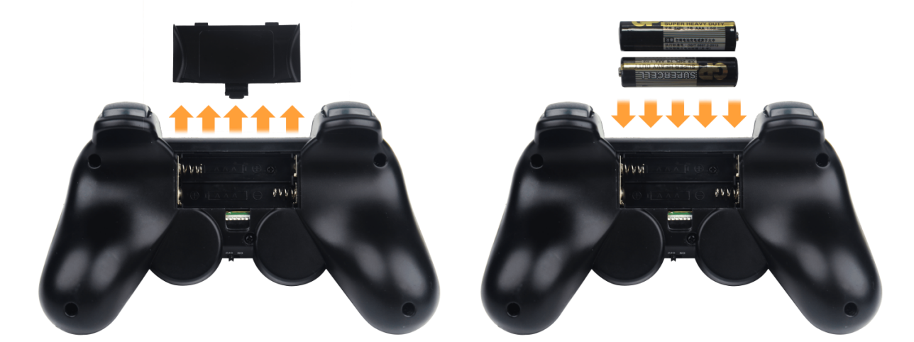

(1) Please first confirm if the handle receiver is already plugged in before starting the robot. Ignore this step if it is already plugged in. (the USB handle receiver has already been inserted into the robot during installing)
(2) When installing the batteries, please distinguish the positive and negative poles of the battery.

Before powering on the robot, it is necessary to ensure that the touch screen is already installed and connected.
The power cable of the touch screen needs to connect to the C-Touch interface, otherwise, the touch functionality is ineffective.

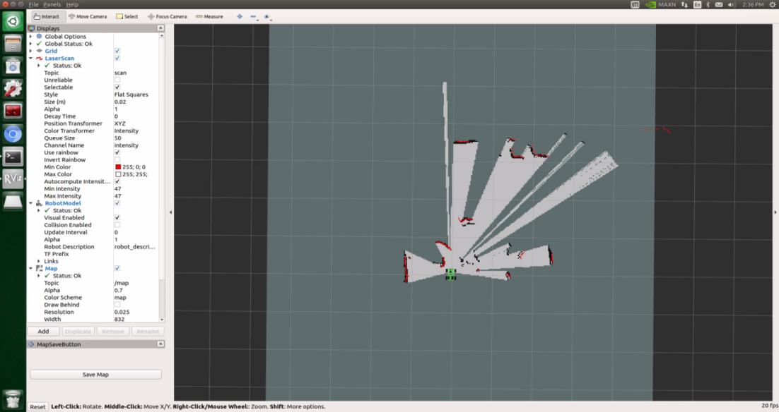

  • ROS1 Mapping
  • This section is applicable to Jetson Nano controller

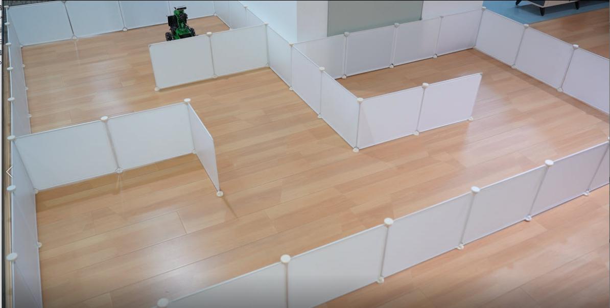

  • In this mode, it’s necessary to set up a closed space beforehand on a flat surface. If obstacles are placed, their height should be at least above the radar’s horizontal position.
(1) Place the robot inside the constructed space.
(2) Click on the screen desktop. Open

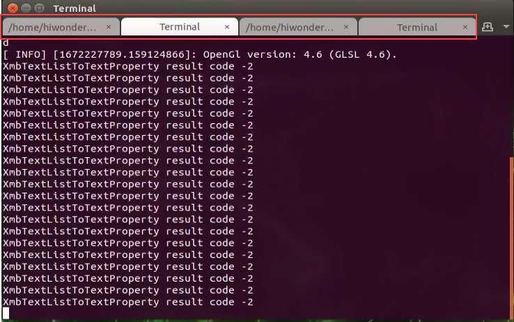

(3) At this time, Several terminals will be opened to run the program simultaneously. Wait for a while at this point.
(4) When you see the below interface, it indicated that the function is enabled successfully.
(5) Now, let’s use control the robot to map using the wireless handle. The function instruction for each button is as follow:
When using the handling, keep the distance from the robot not too far to avoid disconnection.

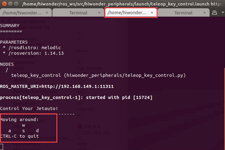

You can also choose to control the robot using the keyboard, but it’s not recommended here. Keyboard control will be introduced in later courses. If you prefer keyboard control, you’ll need to connect to the remote desktop and modify the terminal to enable keyboard control.
For the remote system desktop connection, please refer to “1.6 Development Environment Setup and configuration”.
The button instruction for keyboard control is as follow:
Buttons Function Instruction
W Move forward Short press to this button to forward status. Robot will keep moving forward.
S Move backward Short press to this button to backward status. Robot will keep moving backward.
A Turn left Long press to interrupt moving forward or backward and make a counter-clockwise turn to the left in place
D Turn right Long press to interrupt moving forward or backward and make a right turn.
When the “W” or “S” key is pressed, the robot will continue moving forward or backward respectively. When the “A” or “D” key is pressed, the robot will interrupt the forward or backward motion and rotate counterclockwise or clockwise in place respectively. When the “A” or “D” key is released, the rotation will stop, and the robot will remain stationary.
Regardless of whether it’s a tank robot or a wheeled robot, using keyboard control cannot make the robot perform lateral movement.

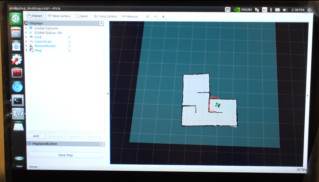

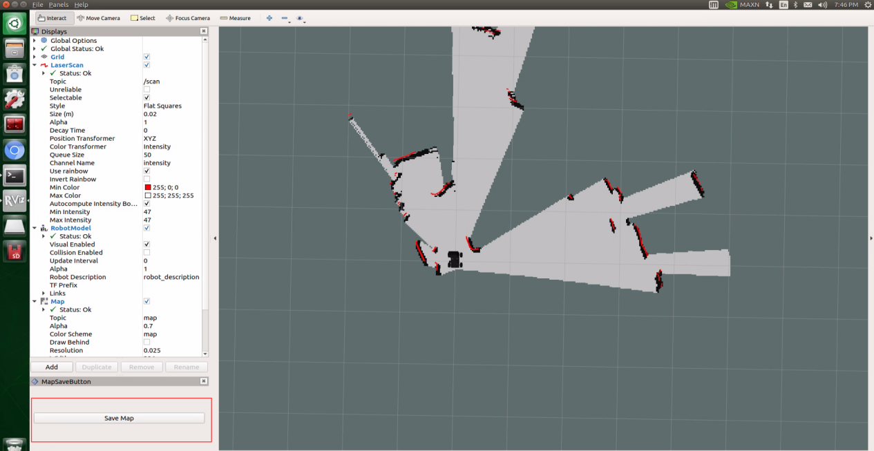

(6) After the movement is complete, press the save button in the bottom left corner, and the robot will save the completed map.
The standard for a completed map is as follow:
(7) After the mapping is complete, if you want to close this function, click interface and tap.

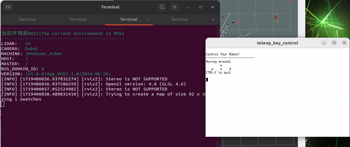

  • ROS2 Mapping
  • This section is applicable to Jetson Orin Nano/Jetson Orin NX and Raspberry Pi 5.
(2) Click on the screen desktop. Open the SLAM icon.

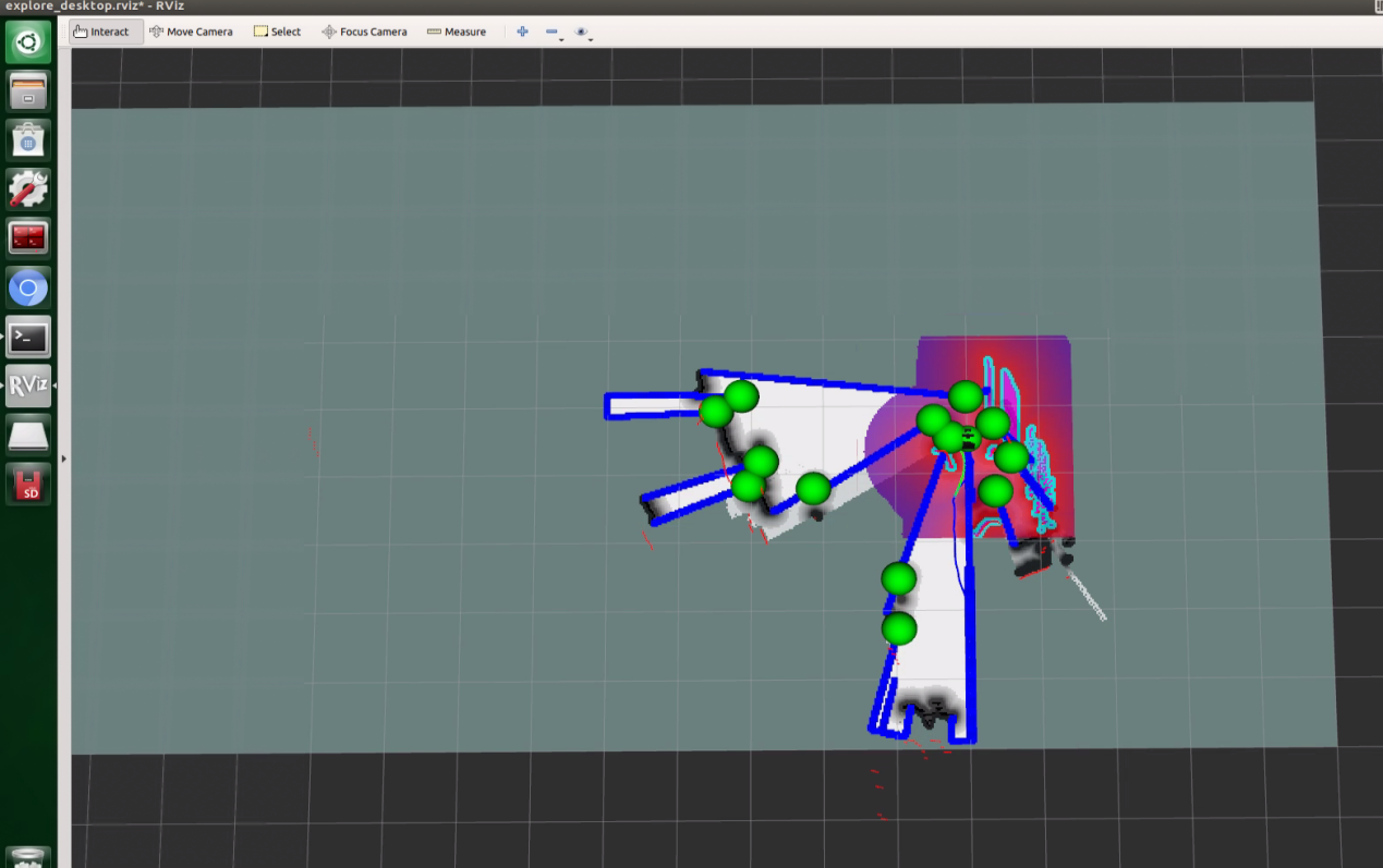

1.8.3 Autonomous Mapping
  • This functionality is only applicable to the Jetson Nano controller.
  • Once this function is enabled, JetRover will directly start to move. In this case, it requires you to place the robot on a flat surface.
  • In this mode, users need to set up a closed space in advance, preferably on a flat surface. If obstacles are set inside the space, the minimum height of the obstacle must be higher than the horizontal position of the Lidar. The robot can stop after completing autonomous mapping in the closed space.
(1) Click the SLAM Automatic to start the autonomous mapping.
(2) After opening, the program will automatically run the program in terminal. When the below interface shows up, it indicates that the interface is enabled successfully.
(3) After successful startup, the robot will begin to move autonomously and map its surroundings.
(4) When the robot completes autonomous mapping in this closed space, it will stop and automatically save the map.

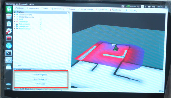

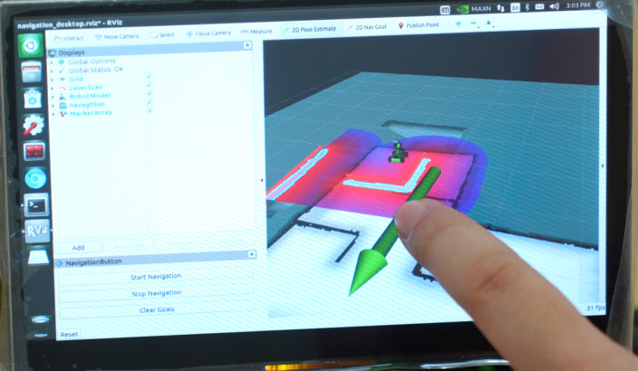

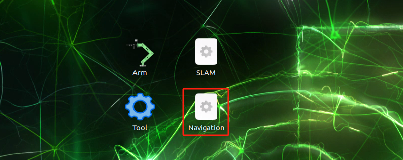

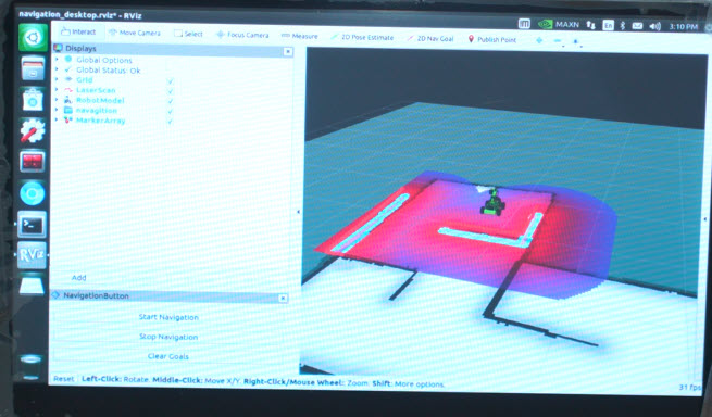

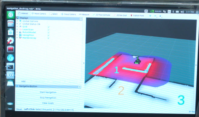

(1) Start the robot. Click the Navigation icon to experience the quick navigation function.
(2) After opening, the terminal will run the program. When you see the following interface, it indicates that the opening was successful.
(3) In the manual bar, “2D Pose Estimate” is used to set the initial position of JetRover, “2D Nav Goal” is used to set a target point and “Publish Point” is used to set multiple target points.
(4) Click on to select one point by clicking the map interface as the target destination. If you press and drag with the mouse, you can also select the orientation of the robot after it reaches the target point. After the selection is complete, the robot will automatically generate a route and move to the target point. (Note: changes the initial position of the robot on the map and is the target point for single-point navigation).
(5) Clickand press the left mouse at a certain point on the map to set it as the destination point. If you need to perform multi-point navigation, please follow the same operation steps to set multiple destination points.
You need to click “Publish Point” once before setting each destination point.
(6) After setting the destination point, click “Start Navigation” in the bottom left corner to start navigation. During navigation, the robot will automatically avoid obstacles. If need to stop navigation, click “Stop Navigation”, and then robot will stop after reaching the destination point.
For example, in the multi-point navigation shown in the above figure, marked as 1, 2 and 3 on the map (take three marks as example). If the robot is traveling between marks 1 and 2, and when you press “Stop Navigation”, it will stop moving after reaching mark 2.
(7) If clicking “Clear Goals”, all marks will be cleared.

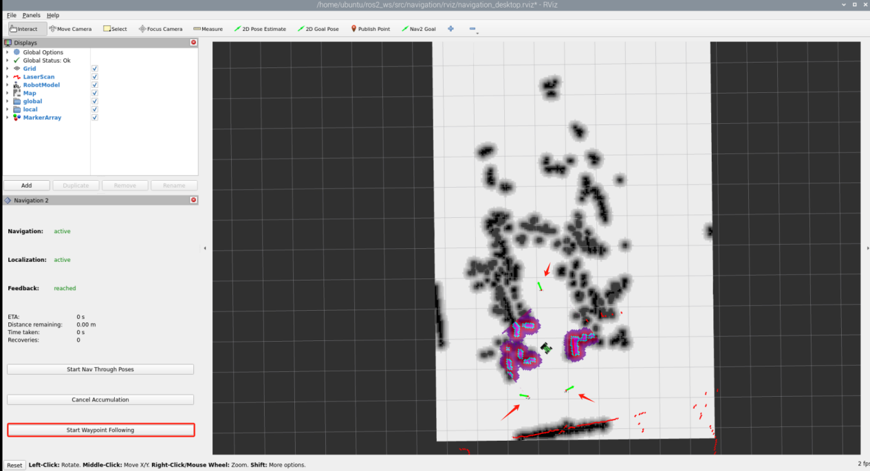

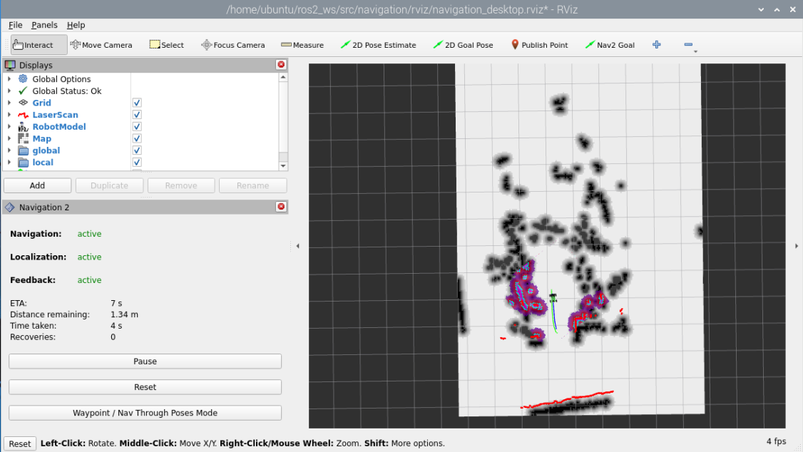

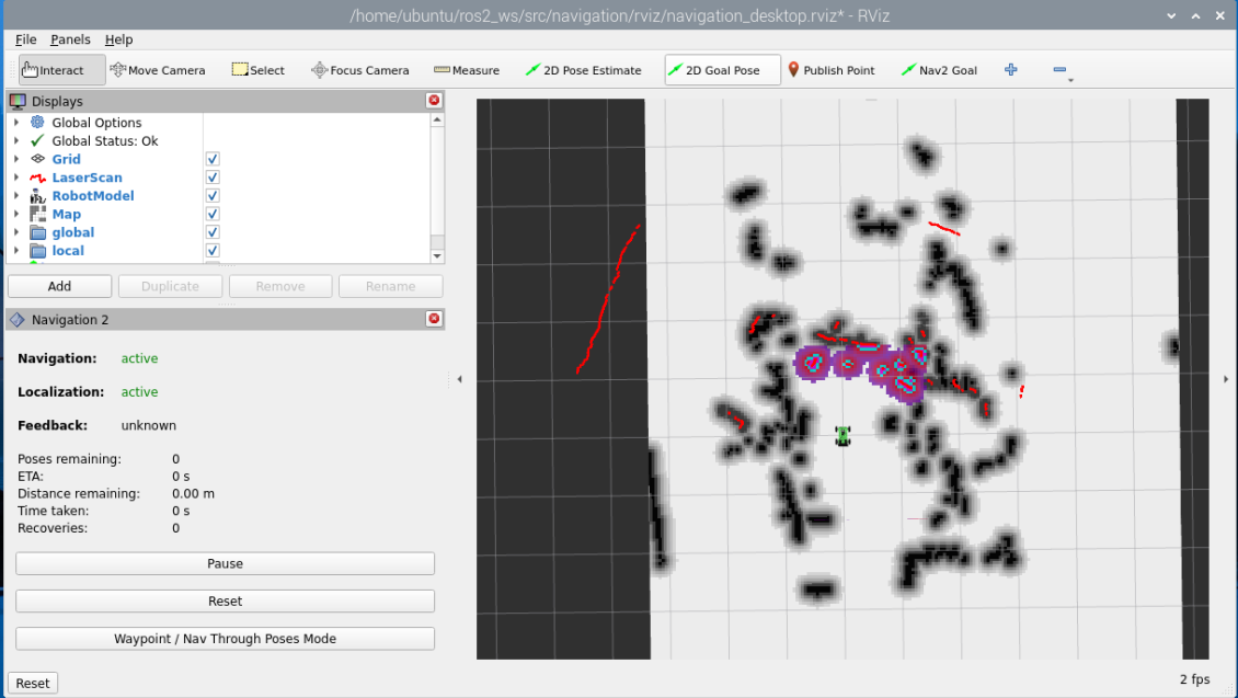

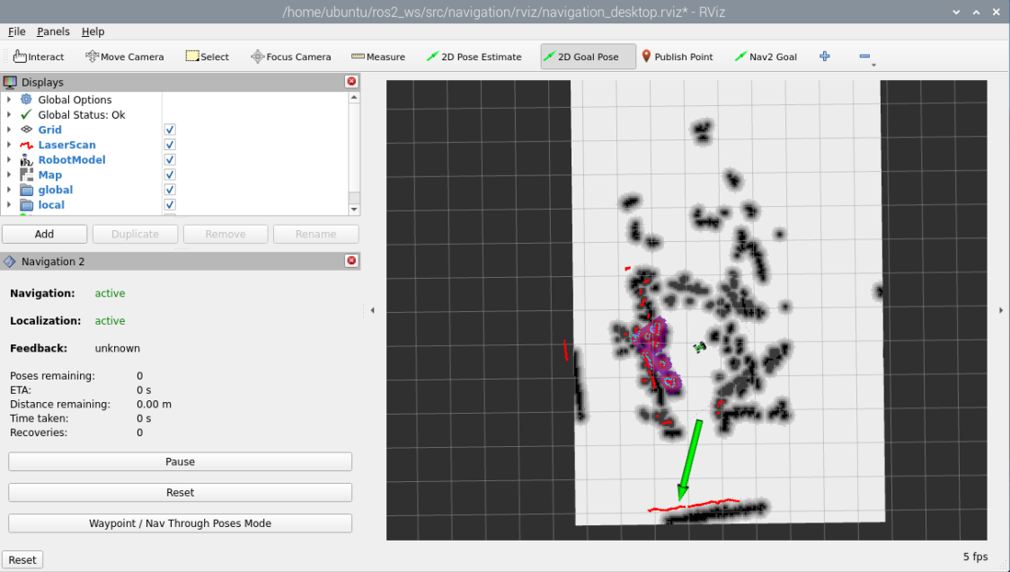

  • ROS2 Autonomous Navigation
This section is only applicable to Jetson Orin Nano, Jetson Orin NX and Raspberry Pi 5 controllers.

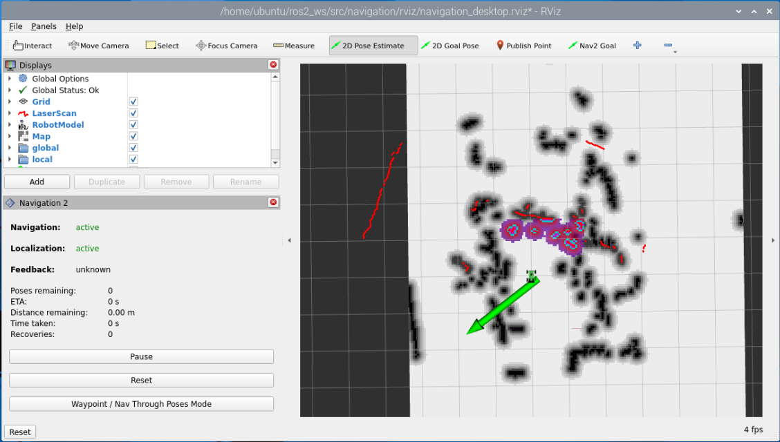

(3) In the manual bar, “2D Pose Estimate” is used to set the initial position of the robot, “2D Nav Goal” is used to set a target point and “Publish Point” is used to set multiple target points, “Nav2 Goal” is used to set more complex navigation targets, such as specifying a target point, a target pose or a target field.
(4) changes the initial position of the robot on the map and mark the robot’s actual position.
(5) Click on to select one point by clicking the map interface as the target destination. If you press and drag with the mouse, you can also select the orientation of the robot after it reaches the target point.
(6) Click in the bottom left corner to enable multiple-point navigation. Then click to set a target point. Hold and drag that point to select the target point direction.
You need to click “Nav2 Goal” once before setting each destination point.
(7) After setting the destination point, click “Start Nav Through Navigation” in the bottom left corner to start navigation. During navigation, the robot will automatically avoid obstacles.

1.9.1 Hardware System Wiring Diagram
The hardware connection system diagram of the robot based in the mini STM32 controller is shown below. The specific model and ROS controller may vary, and the detailed instructions will be provided in the following content.
  • Jetson Nano Controller Version
  • Jetson Orin Nano Controller Version
  • Jetson Orin NX Controller Version
  • Raspberry Pi 5 Controller Version

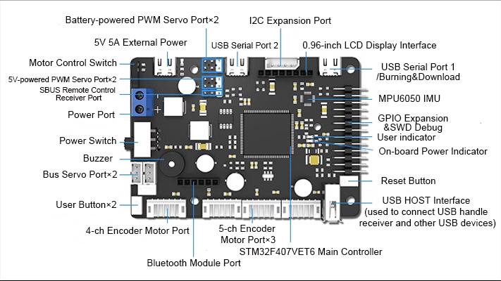

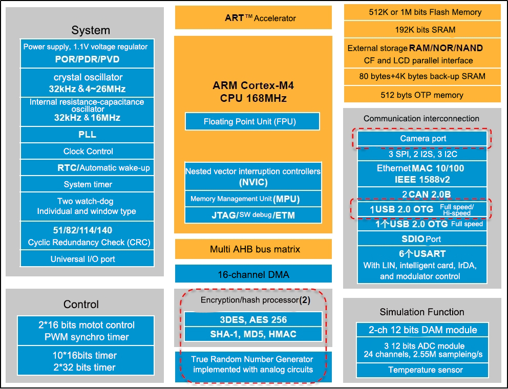

  • STM32 Controller
The robot’s electronic control system uses a mini STM32 controller (hereafter referred to as the STM32 controller) as the low-level motion controller. It connects multiple DC encoder reduction motors and has a built-in IMU accelerometer and gyroscope sensor. This setup enables the control of the robot’s chassis movement and sensor data collection.
The controller uses the STM32F407VET6 as the main controller, which features ARM’s Cortex-M4 core, a 168 MHz main frequency, 512K of on-chip FLASH, 192K of on-chip SRAM, and integrates FPU and DSP instructions. The system block diagram of the STM32F40x/41x series is shown below:
The resource layout on the front side of the control board is shown in the diagram below:
The control board also provides a schematic diagram, feature an SWD debugging interface, supports USB serial port program download, and enables STM32 programming for secondary development. It offers onboard resources and peripheral example code for users to learn and use conveniently.

The 11.1V 6000mAh Lithium battery is tailored for the robot, with a charging voltage of 12.6V. It features overcharge protection, overcurrent protection, over-discharge protection, and short-circuit protection.
Please use the special charger provided in the kit to charge the robot. Users can view the charging status by observing the indicator on the charger. The red light indicates that the battery is charging, while the green indicates that the charging is complete. (Green light when idle, red light when charging, and green light when fully charged)

  • Jetson Nano Version
The robot utilizes Jetson Nano as its ROS controller, consisting of the Jetson Nano board and Jetson expansion board. The motherboard is a compact yet powerful computer capable of running the mainstream deep learning frameworks, providing the computational power required for most artificial intelligence projects.
The expansion board features connections for LEDs and buttons, enabling users to monitor network status through LED flashes and switch network modes using the button. It also includes reserved GPIO and I2C interfaces. The mainboard is installed with the Ubuntu18.04 system, and establishes the ROS Melodic environment for robot operations. Additionally, the ROS2 Humble environment is deployed within a Docker container.

  • Raspberry Pi5 Version
The robot uses a Raspberry Pi 5 as its ROS main controller, which includes the Raspberry Pi 5 controller and a mini expansion board. The controller is a compact yet powerful computer capable of running major deep learning. The mini expansion board adds functionality with LEDs and buttons, allowing users to monitor network status via LED indicators and switch network modes using a mobile phone. It also features reserved GPIO and I2C interfaces for additional expansion.
The controller operates with the Raspberry Pi Debian12 official system and has a ROS2 environment set up in Docker.
Overall, the mini expansion board for the Raspberry Pi 5 is stable, energy-efficient, and highly expandable, capable of supporting mainstream deep learning frameworks and meeting the computational needs of most AI applications.

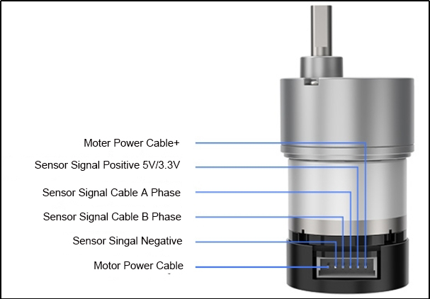

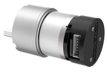

1.9.5 Hall Encoder DC Gear Motor
The Hall speed encoder is a speed measurement module that uses a Hall sensor encoder with a robust magnetic disk, and generates AB two-phase output pulse signals. In this setup, the motor operates at 12V, and the diagram below illustrates the motor used in the robot, along with their pin configurations.

JetRover uses the Dabai DCW binocular structured light depth camera. The depth image resolution can reach up to 1920×1080@5/10fps, with an average power consumption of less than 1.2W. The terminal only requires a USB2.0 interface to obtain high-precision 3D depth information for backend usage, enabling the robot to perform functions such as perception, obstacle avoidance, and navigation.
On the robot, it is primarily used to implement functions like OpenCV and can also be utilized for deep learning and KCF object tracking, among other visual applications.

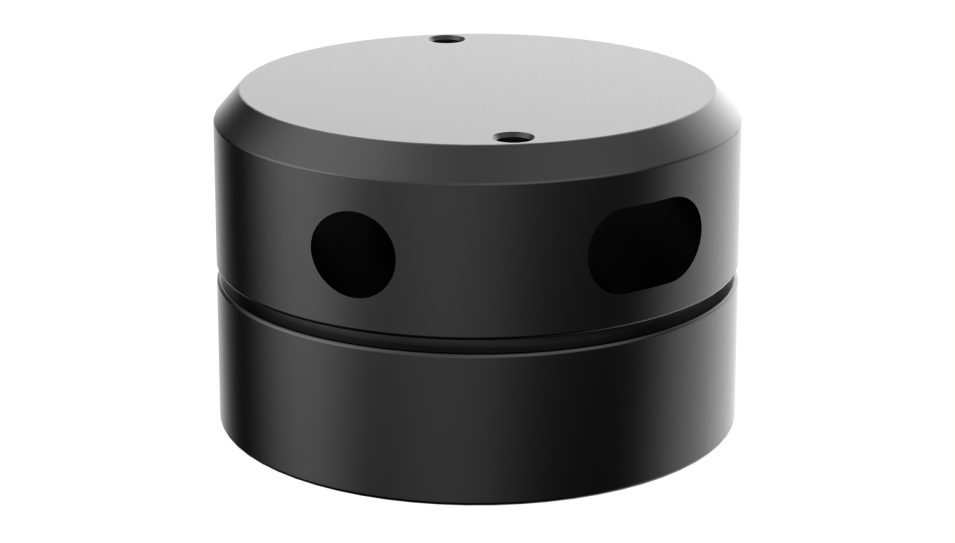

1.9.7 Lidar
Lidar utilizes laser technology to accurately pinpoint the locations. Its applications extend to various scenarios, including the field of robotics, enabling functions such as Lidar obstacle avoidance, following, SLAM mapping, and navigation.
This robot is compatible with different Lidar models, including A1 Lidar and G4 Lidar. Users can choose Lidar versions according to your requirement. Below are listed two types of Lidar:

This robot uses the R818 noise reduction board and a ring-shaped six-way microphone array, which features a planar distribution structure composed of six microphones. It is a system that samples and processes the spatial characteristics of the sound field. It can perform sound source localization, suppress background noise, interference, reverberation, and echo, and achieve 360° equivalent sound reception.
The noise reduction board can suppress background noise, interference, reverberation, and echoes, as shown in the image below:
  • 7-inch LCD Screen
The system desktop shown in image is for demonstration purpose only, please rely on the actual product for accuracy.
The 7-inch LCD screen is optional hardware with both display and touch functionalities. In addition to directly display the robot’s system desktop, it allows for a quick experience of mapping and navigation function by touching icons on the desktop.

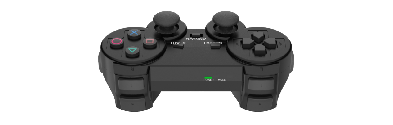

  • PS2 Wireless Controller
The STM32 control board has USB PS2 wireless handle receiver connected, allowing chassis movement control through a PS2 controller.
The handle receiver is connected to the position highlighted in the below red box:

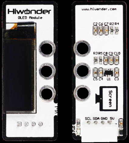

  • OLED Display Module
The OLED display module mainly uses 0.91-inch blue light OLED screen, featuring a viewing range, fast respond, stable graphics, high brightness and high resolution. Its driver chip is the SSD1306, and by controlling this chip, we can manage the content displayed on OLED module. It is used on robot for displaying WIFI name and voltage information.

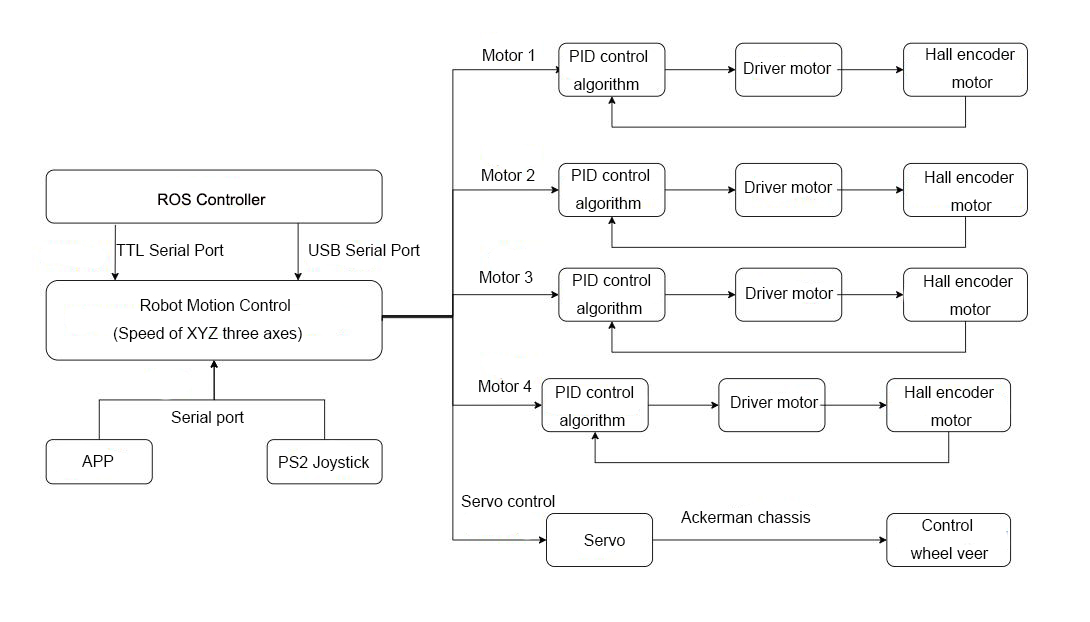

1.10.1 ROS Main Control Hardware Connection

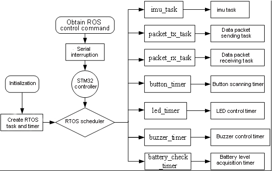

The standard connection method requires a power cable and a USB serial cable to communicate with the ROS main controller via the onboard USB serial port. The STM32 requires a power supply of 9-24V, and the ROS main controllers (Jetson Nano and Raspberry Pi 5) can be directly connected to the STM32’s power output port (5V) for power supply through the STM32 power input. The Jetson Orin Nano/Jetson Orin NX requires a 12V power supply.
1.10.2 ROS Serial Port Communication

The STM32 controller is used as the robot underlying motion controller for running STM32 code. The robot chassis has already been burned with corresponding code for direct usage.
It supports ISP code updates through the USB serial port and can also be updated or debugged through the SWD interface. As the underlying chassis driver board for the robot, it is primarily responsible for the tasks such as motor PID control, encoder and IMU data acquisition, RGB light control, etc. Various control methods are supported, including PS2 wireless control, app control, and remote control via an RC transmitter. Additionally, it communicates through a serial port with the ROS base layer’s chassis control node, receiving target vector velocities from the basic layer and sending the real-time speed, IMU data, and battery voltage data calculated by the odometry. To enhance these functionalities, STM32 controller utilizes the FreeRTOS embedded operating system for software design.

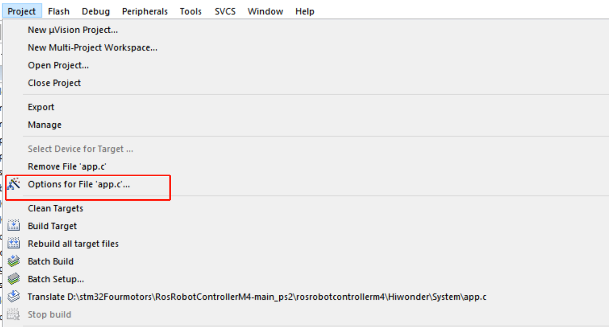

(1) In the Keil5 interface, Click the “Project” in the menu bar, and then click the “Options for File ‘app.c’” button.
(2) Click the “Output” option, check the three red-marked options below, and then click “OK”.

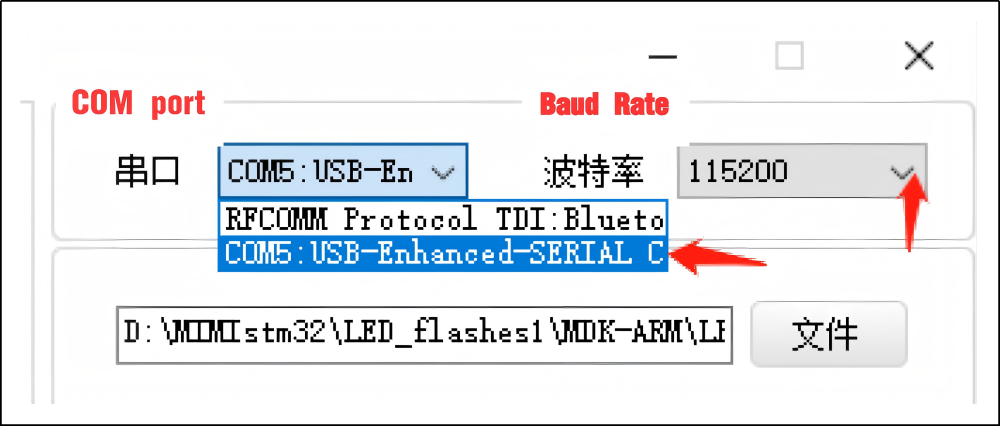

Open the ATK-XISP software, select the correct serial port (Port) in the software, for example, COM22 (which is recognized as starting with USB), and then set the baud rate (bps) to 115200:

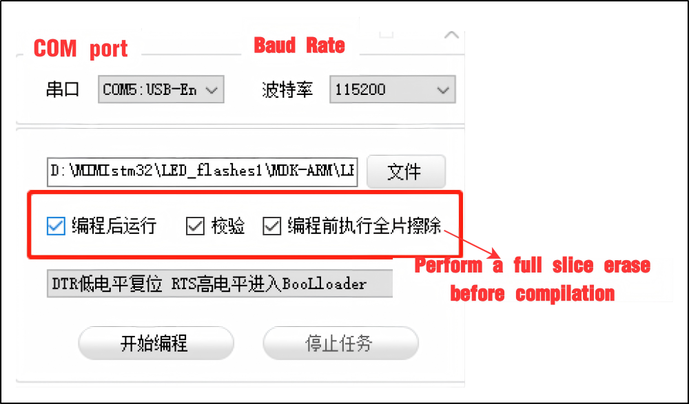

In the software interface, select “Run After Programming,” “Verify,” and “Perform Full Chip Erase Before Programming,” as shown in the image below:
Then choose the following option:

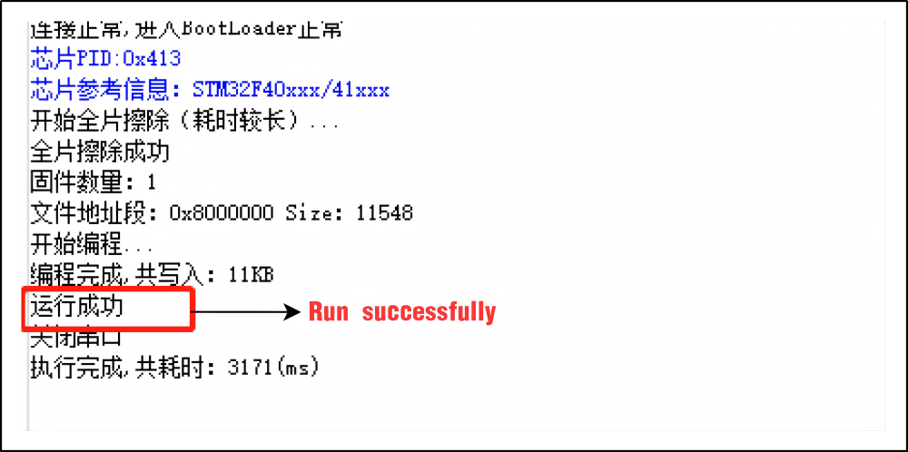

(3) Software Flashing
In the ATK-XISP software interface, click the button within the red box in the image below, and then select the hex file that needs to be flashed.
Click the “Start Programming” button to flash the generated hex file onto the STM32 main control board:
The following prompt indicates that the flashing process is complete.

(1) Remove the SD card from Jetson Nano or Raspberry Pi 5, and remove the solid-state drive from Jetson Orin Nano or Jetson Orin NX.
Jetson Nano
Raspberry Pi5
