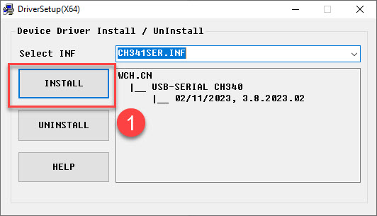

Please ensure the CH341 serial driver is installed on your computer as it may effect the connection and usage of the Microbit controller in the following steps.
If it is already installed, you can skip this section.

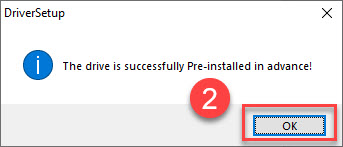

(1) Locate the “ch341ser.exe” serial port driver installer from the “Serial Driver Software” folder, and open it.
(2) Click the “Install” button. Wait a moment for the installation success message to appear.

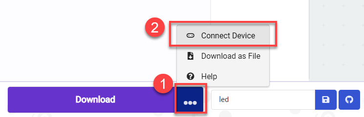

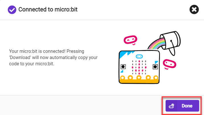

(2) For initial device connection, it is necessary to pair the device first. Upon connection, the browser will remember the connected device. Click “…” next to “Download” button to select “Connect Device” from the options.

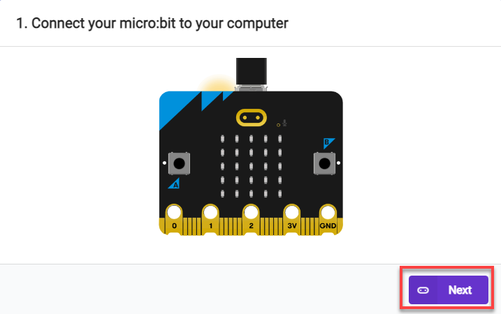

(3) In the pop-up window, click “Next” to continue.
(4) Click “Pair” and select the device for connection in the pop-up window.
(5) Once the device is successfully connected, click “Download” to download the program. During the download process, the yellow LED near the USB port of micro:bit will blink rapidly and continuously. At this point, please do not disconnect or move the cable to avoid download failure.
(6) When the download is complete, the indicator will stop flashing and remain steadily lit. Meanwhile, a download completion message will appear on the programming interface

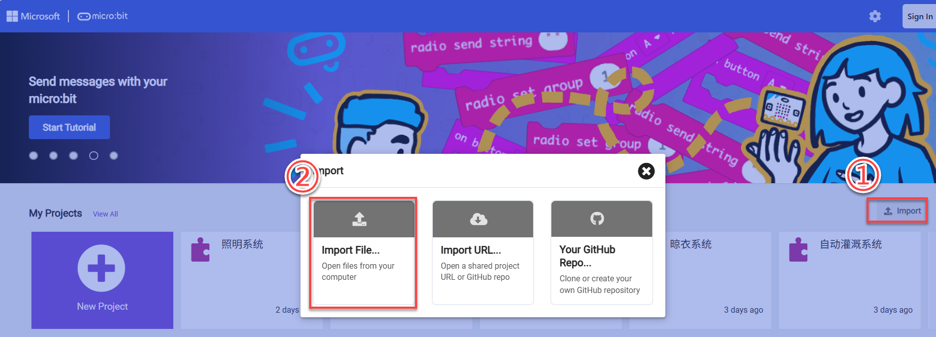

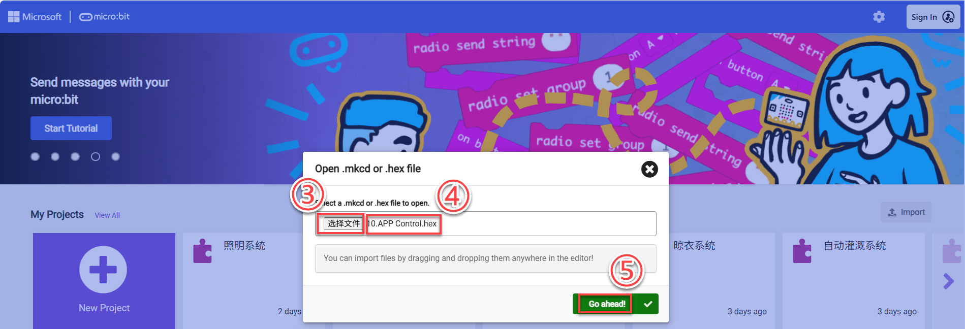

(1) Connect the micro:bit to your computer using a USB cable. Then open the online MakeCode programming page, click “Import” and select “Import file.”
(2) Then click “Choose File,” select the code file to be added, and click “Continue” to import the code into the online compiler.

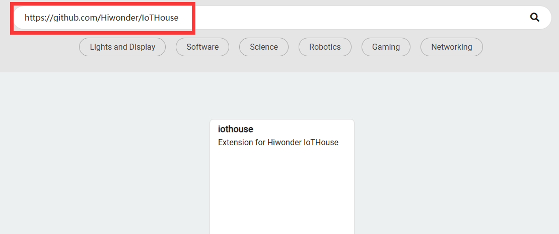

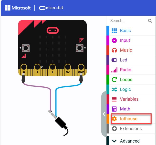

(1) On the main interface, click on “Extension” in the left section.
(2) In the pop-up window, enter the extension package address: https://github.com/Hiwonder/IoTHouse

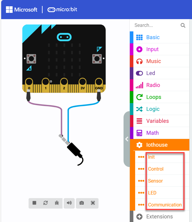

Then click on the search icon or press “Enter”. You can search for the package. Finally, click on “iothouse” to successfully add it.
Once added, the interface will automatically return to the programming screen. After loading is complete, you will see that the programming panel has successfully loaded the newly added extension package. Click on the “iothouse” tab to expand and view its contents.
