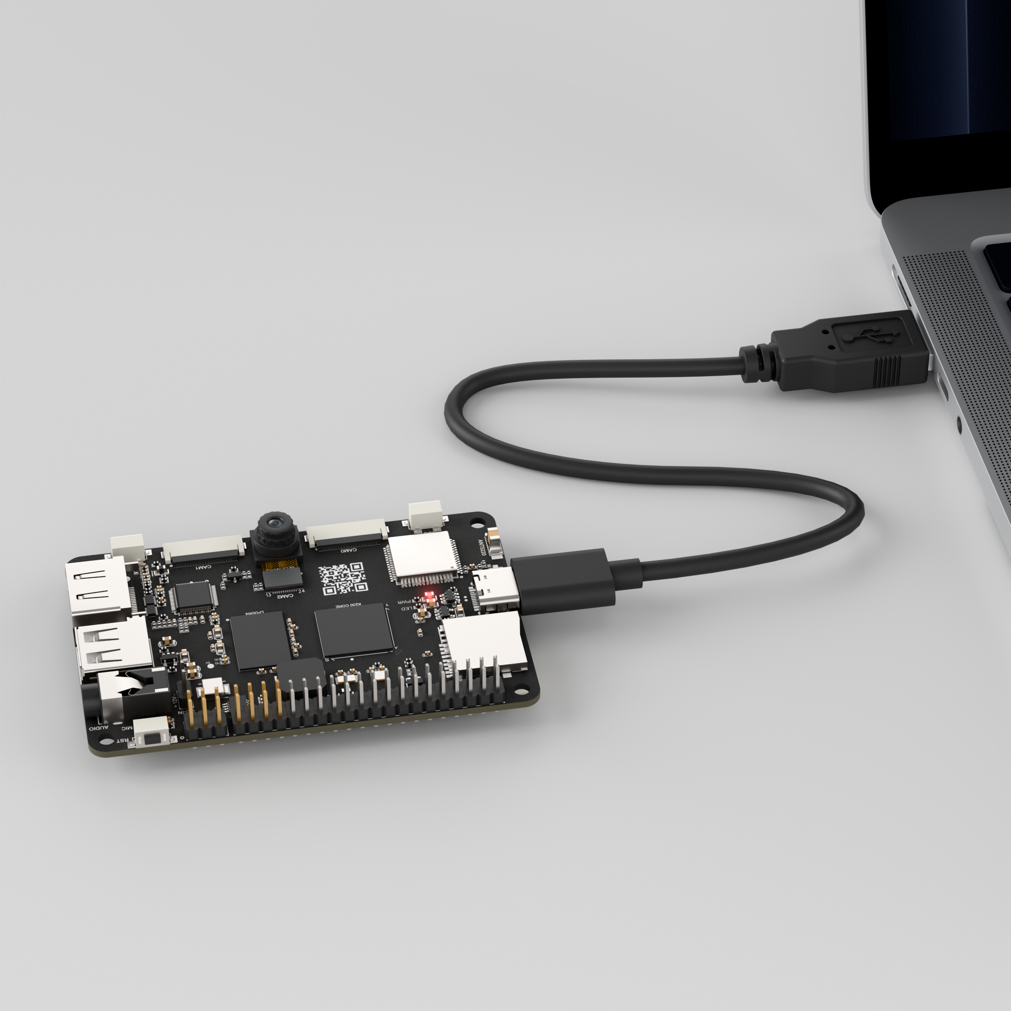

  1. Connect the K230 development board to your PC using a Type-C data cable, as shown below:

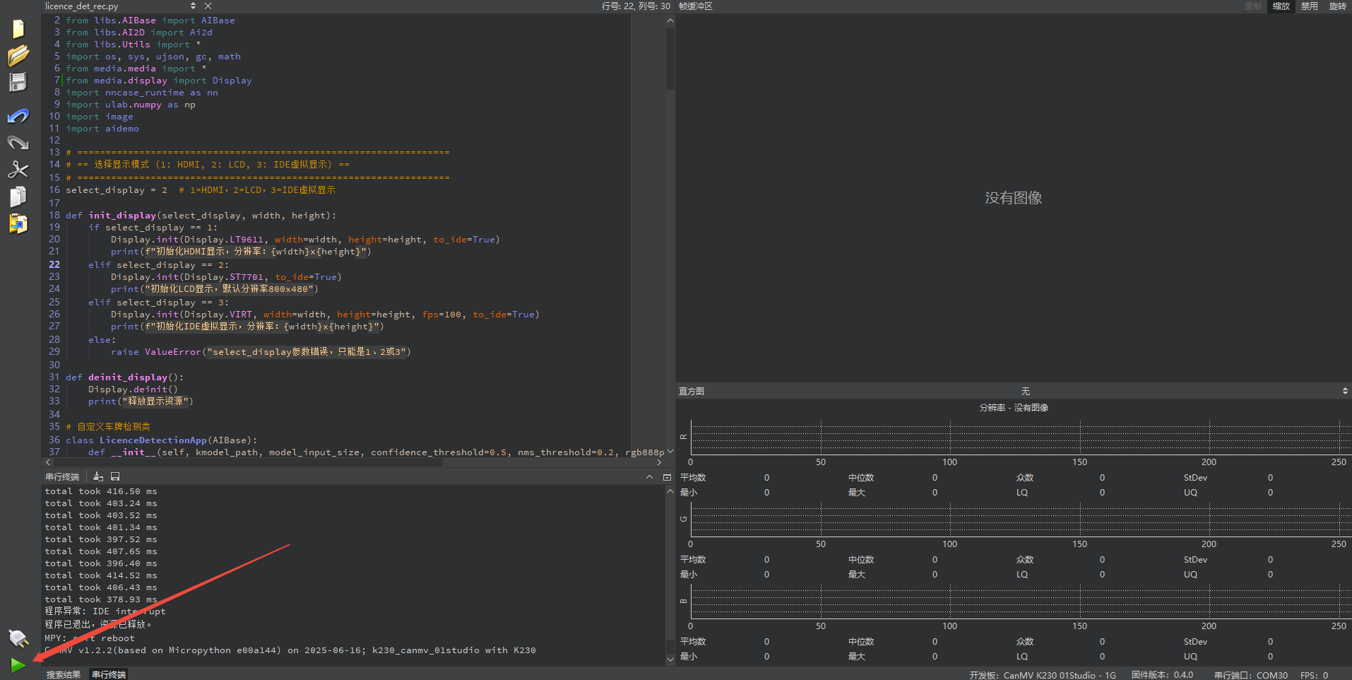

After connecting, drag the program touch.py into the CanMV IDE K230 code editor area, then click the run button in the lower left corner to run the program online, as shown below:
Programs run using this method will be lost after disconnecting or powering off, and will not be saved on the development board.

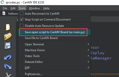

Offline Execution:
  1. After connecting, drag the program touch.py into the CanMV IDE K230 code editor area, click Tools in the toolbar, and select Save open script to CanMV Board (as main.py), as shown below:
  1. Click Yes.
  1. Once the file is written, click OK to confirm and complete saving the MicroPython file to the K230 development board.
With this method, the K230 development board will automatically run the MicroPython file upon power-up without connection, enabling offline execution.

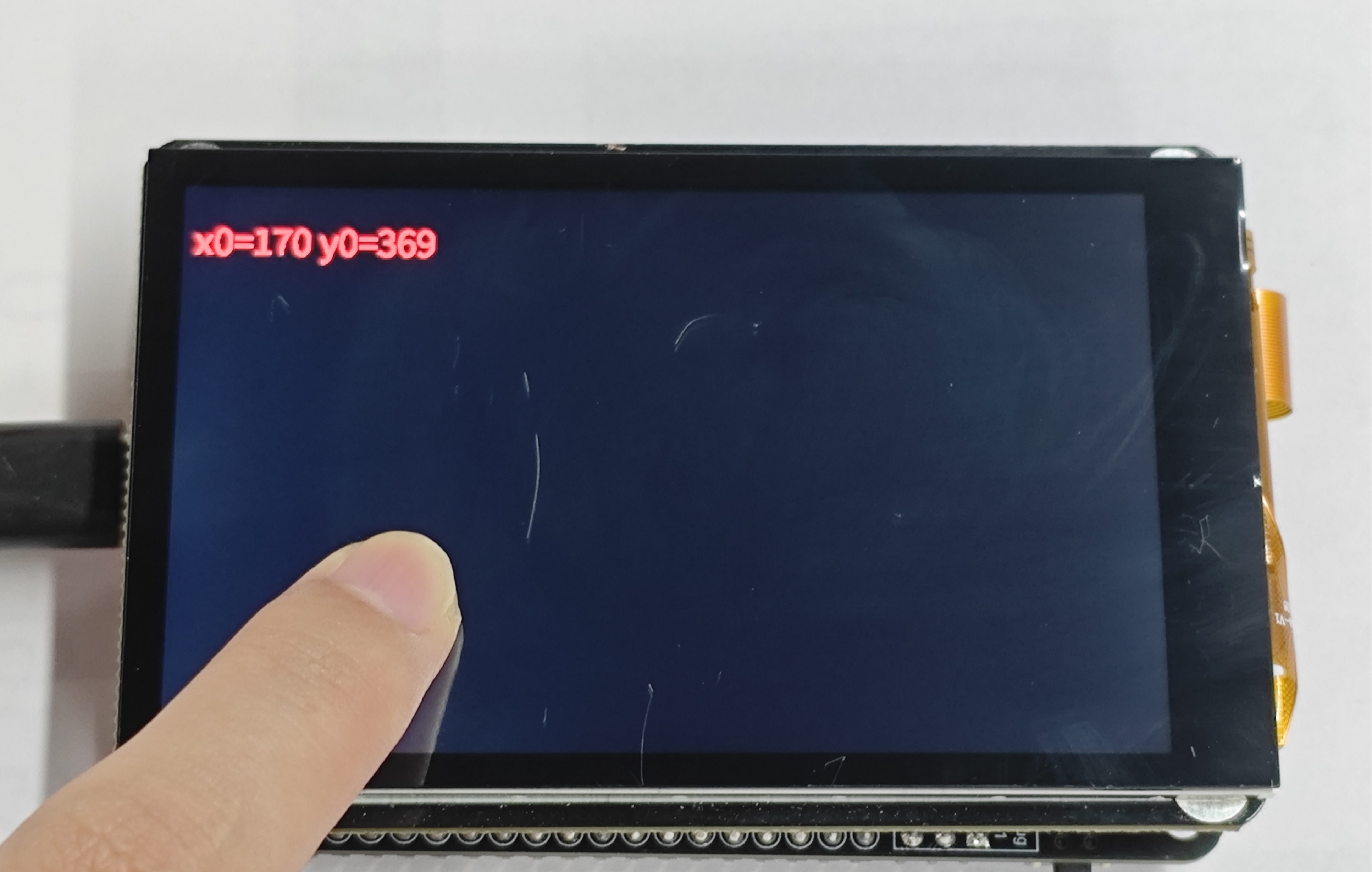

When you touch the LCD screen on the K230 development board with your finger, the corresponding touch coordinates appear on the LCD screen, and the IDE simultaneously prints the coordinates.

  1. Click Yes.

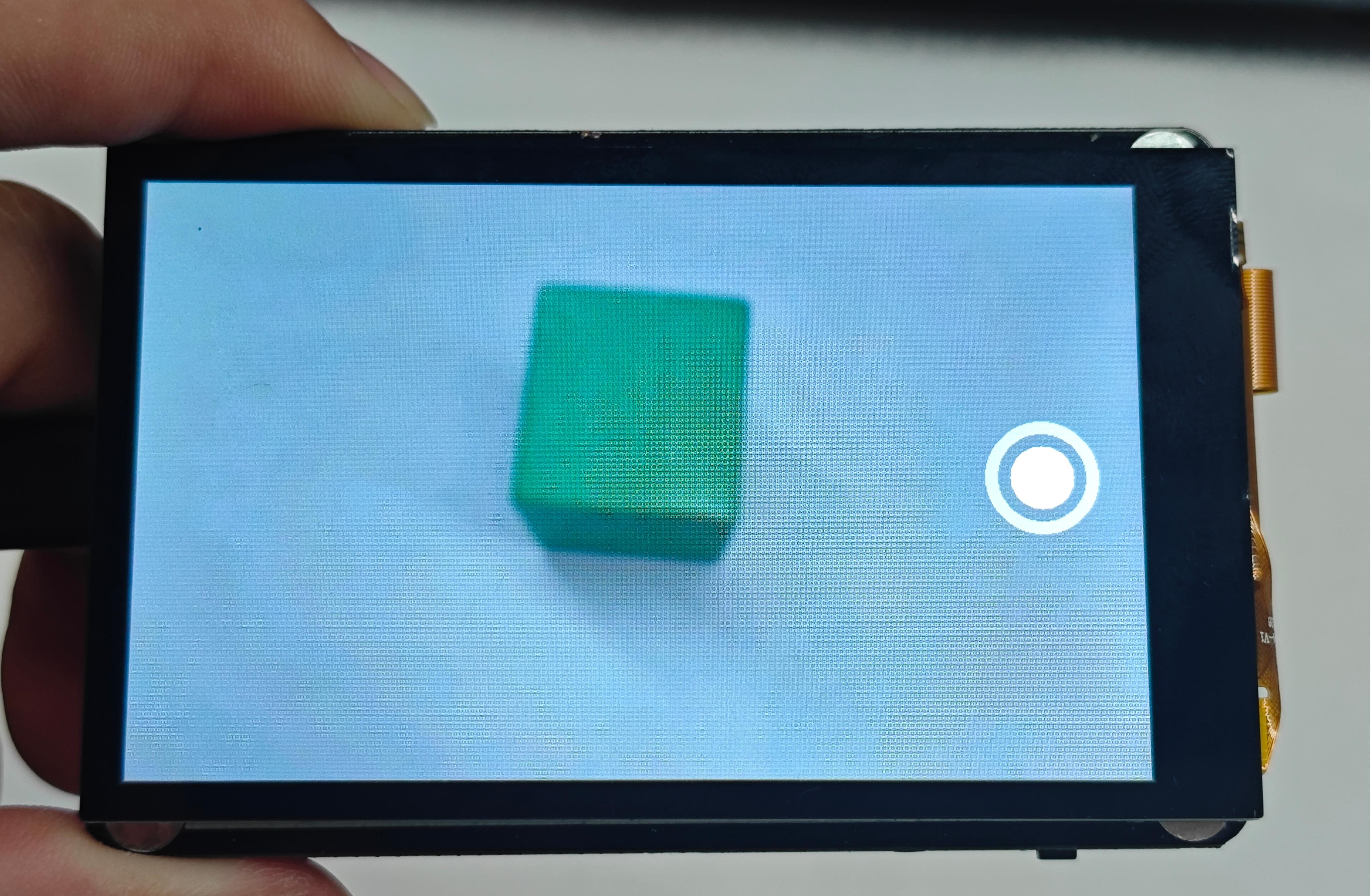

7.3.4 Program Outcome
After clicking the capture button on the screen, the K230 calls the camera to capture the current scene. The captured image is then converted and saved as a picture.

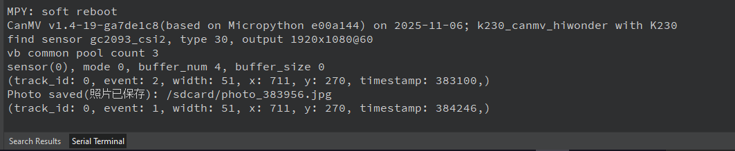

    p = tp.read(1)
    if p != ():
        print(p)
        x, y, event = p[0].x, p[0].y, p[0].event

            print("Photo saved:", filename)

  1. img = sensor.snapshot() captures a frame of live camera feed.
  2. img.draw_circle() draws the capture button on screen.
  3. p = tp.read(1) reads touch points.
  4. print(p) prints touch point coordinates in IDE terminal.
  5. x, y, event = p[0].x, p[0].y, p[0].event assigns the obtained touch coordinates.
  6. Determines if the capture button on screen was touched based on touch point, and saves the photo to SD card.
  7. Display.show_image(img) refreshes the canvas content to the screen.
