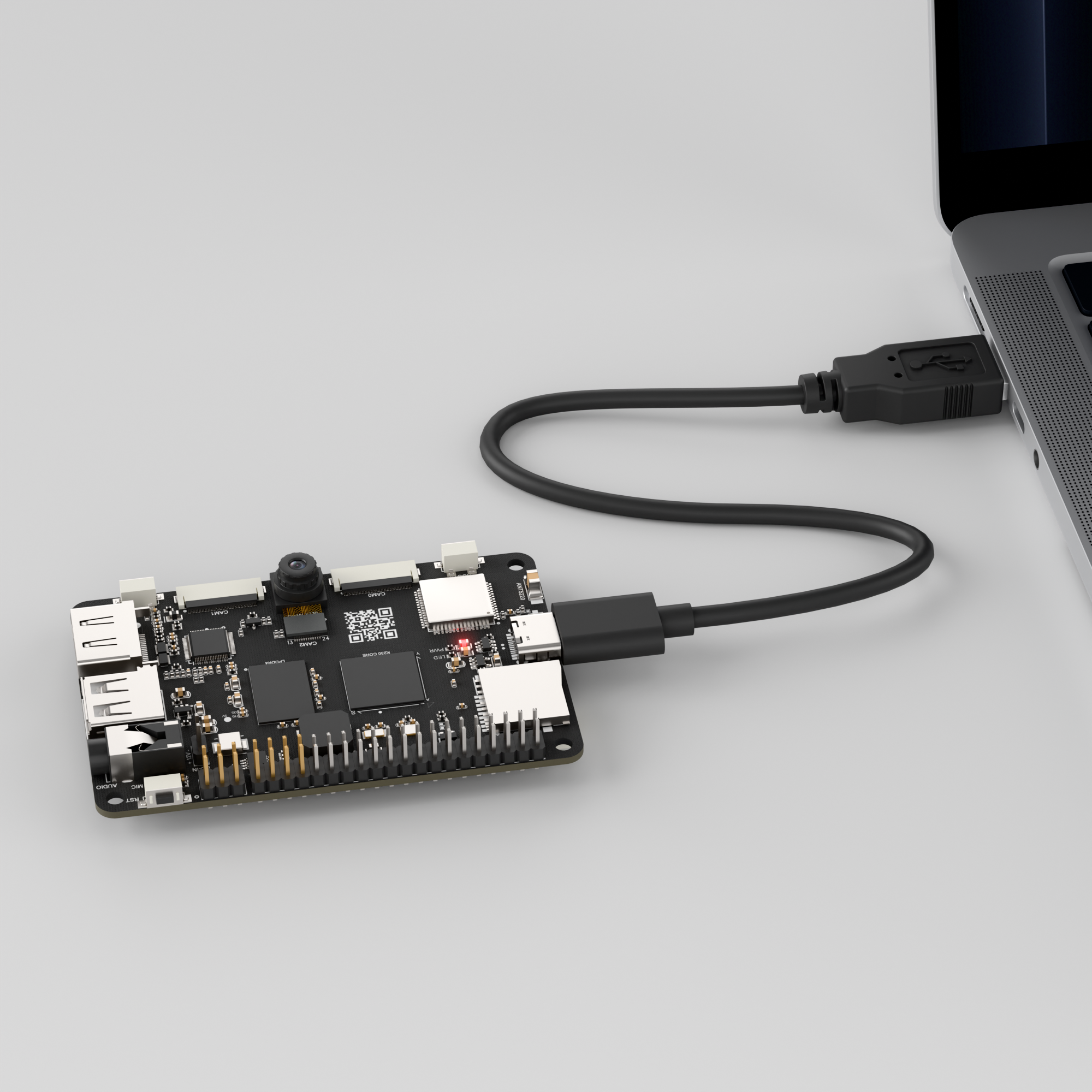

  1. Connect the K230 board to your PC using a Type-C data cable, as shown below:
  2. Double-click to open CanMV IDE K230.
  3. Click the connection button in the lower left corner.
  4. When connection is successful, the lower left corner of CanMV IDE will display the icon shown below.
  5. If connection takes more than 10 seconds, it has failed. Click the Cancel button, and a dialog box will appear. Click OK and recheck the connection.
Connection Failure Causes and Solutions:
  • Cable is not a data cable: Some Type-C cables are charging-only cables without data transfer capability. Please use a Type-C cable with data transfer functionality. The factory-supplied cable is a Type-C data cable.
  • Other K230 firmware was flashed: Re-flash the factory firmware, then reconnect.

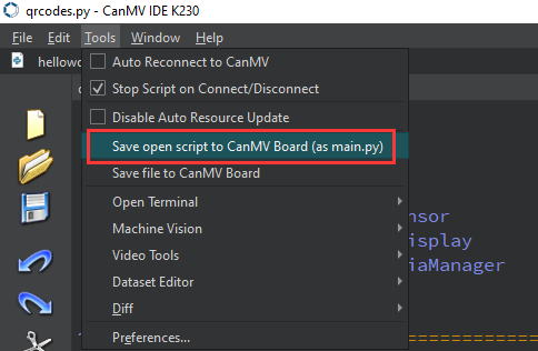

Offline Execution:
  1. After connecting, drag the program Sensor.py into the CanMV IDE K230 code editor, click Tools in the toolbar, and select Save open script to CanMV Board (as main.py), as shown below:
  1. Then click Yes.
  1. Once the file is written, click OK to confirm and complete saving the MicroPython file to the K230 development board.
With this method, the K230 development board will automatically run the MicroPython file upon power-up without connection, enabling offline execution.

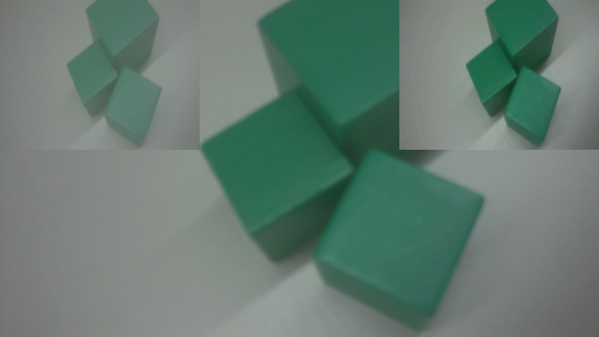

3.1.4 Program Outcome
The same camera feed is simultaneously sent to three display areas on the HDMI screen in three different resolutions/formats for real-time comparison.

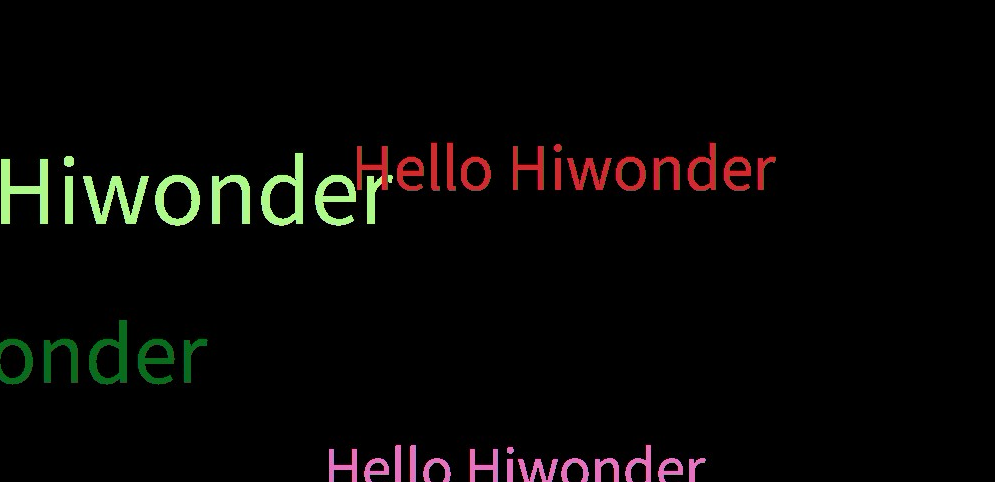

3.2.4 Program Outcome
On the screen, ten “Hello Hiwonder” strings appear every second, with their size, color, and position completely random. This creates a colorful, continuously flickering, dynamic text kaleidoscope effect.

  • Main Loop
        # --- Step 3: Main loop for drawing and display ---
            # Clear the canvas for redrawing
            img.clear()
            # Draw 10 colorful strings at random positions on the canvas
            for i in range(10):
                x = (urandom.getrandbits(11) % img.width())
                y = (urandom.getrandbits(11) % img.height())
                r = (urandom.getrandbits(8))
                g = (urandom.getrandbits(8))
                b = (urandom.getrandbits(8))
                size = (urandom.getrandbits(30) % 64) + 32
                # Call advanced drawing function to render strings
                img.draw_string_advanced(x, y, size, "Hello Hiwonder", color=(r, g, b))
            # Display the rendered image on the screen
            Display.show_image(img)
            os.exitpoint()
  1. img.clear(): Completely clears the memory canvas before each frame is drawn.
  2. urandom.getrandbits(): Generates high-quality random numbers to determine string position (x, y), color (r, g, b), and size, creating unpredictable dynamics.
  3. img.draw_string_advanced(): Performs the actual drawing operation on the memory canvas img.
  4. Display.show_image(img): It pushes or refreshes the fully drawn image in the memory canvas img onto the physical screen in a single operation. This “draw in memory first, then display at once” mechanism is called double buffering and helps prevent screen tearing and flickering.
  5. time.sleep(1): Pauses the program for one second. This controls the animation frame rate, which is 1 FPS here, allowing each frame to be clearly observed.

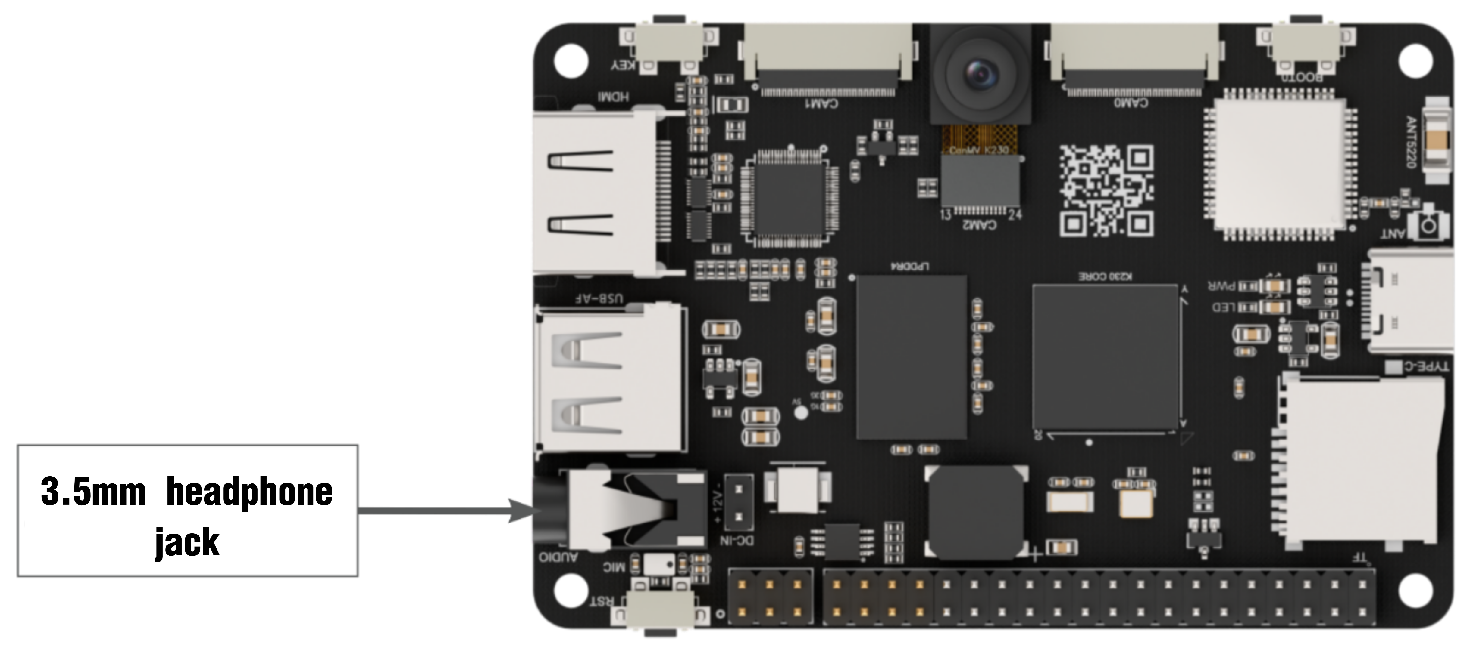

  • Hardware Introduction
Hiwonder does not provide a built-in audio output device, so please prepare your own. For external speakers, connect them to the 3.5-millimeter headphone jack as shown in the figure below.

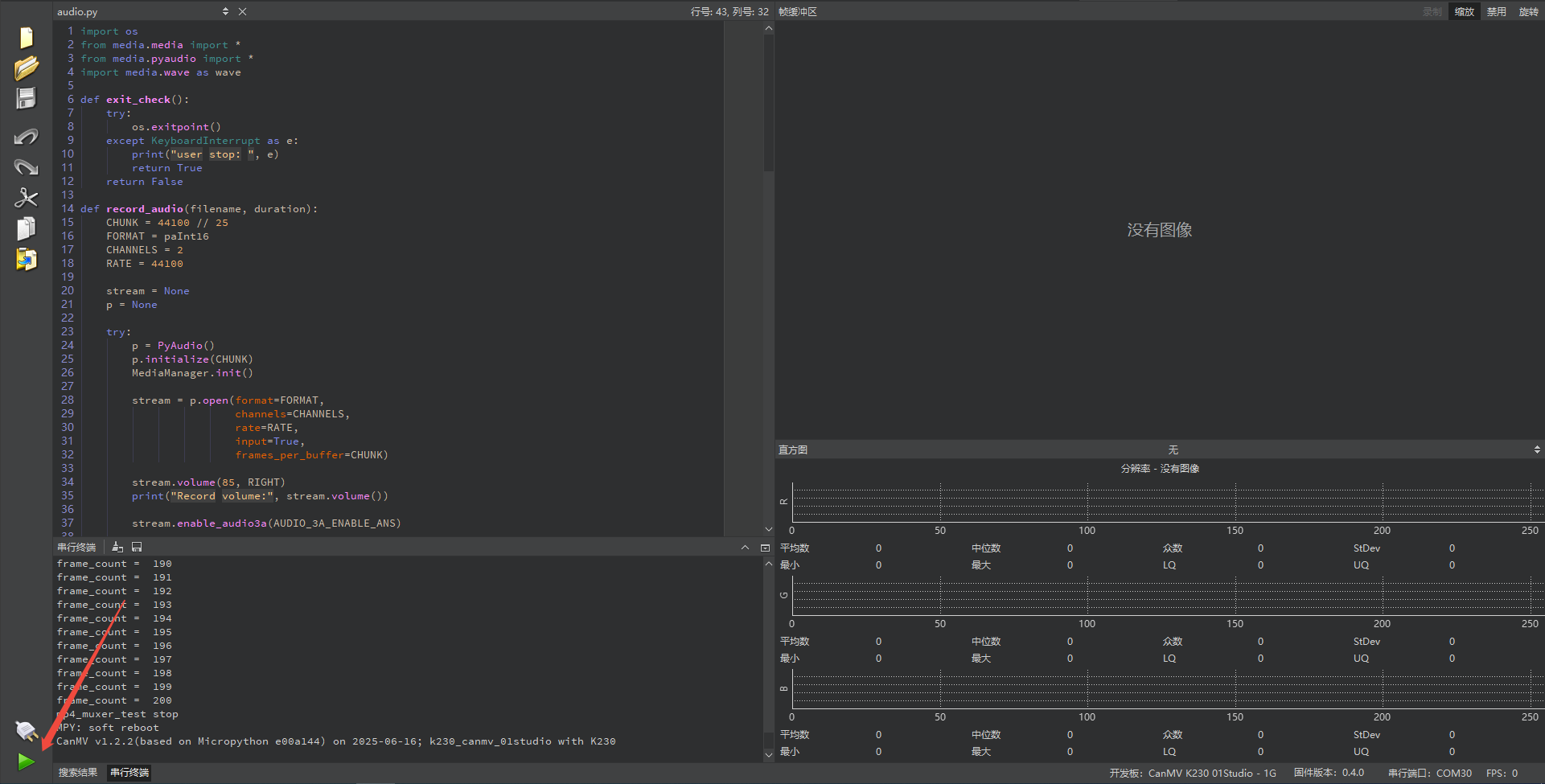

After connecting, drag the program audio.py into the CanMV IDE K230 code editor, then click the run button in the lower left corner to execute the program online, as shown below:
Programs run using this method will be lost after disconnecting or powering off, and will not be saved on the development board.

  1. Connect the K230 development board to your PC using a Type-C data cable, as shown below:
  1. If connection takes more than 10 seconds, it has failed. Click the Cancel button, and a dialog box will appear. Click OK and recheck the connection.

Online Execution:
After connecting, drag the program Video_Recording.py into the CanMV IDE K230 code editor, then click the run button in the lower left corner to execute the program online, as shown below:
Offline Execution:
  1. After connecting, drag the program audio.py from the same directory into the CanMV IDE K230 code editor, click Tools in the toolbar, and select Save open script to CanMV Board (as main.py), as shown below:
  1. Then click Yes.
3.4.4 Program Outcome
This lesson consists of two combined programs, where Video_Recording.py is the video recording program and Video_play.py is the video playback program.
Download the Video_Recording.py program. The program will start automatically and record a 5-second MP4 file (200 frames), which is then saved automatically. Next, download the Video_play.py program. When started, it will automatically play back the recorded MP4 file, and the program ends after playback completes.

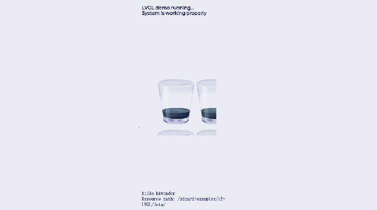

3.5.4 Program Outcome
Run the program on the K230 platform to display English text and dynamic animations in the LVGL graphical interface.

  • Initialize LVGL
def lvgl_init(display_width, display_height):
    """Initialize LVGL"""
    global disp_img1, disp_img2
    lv.init()
    disp_drv = lv.disp_create(display_width, display_height)
    disp_drv.set_flush_cb(disp_drv_flush_cb)
    disp_img1 = image.Image(display_width, display_height, image.ARGB8888)
    disp_img2 = image.Image(display_width, display_height, image.ARGB8888)
    disp_drv.set_draw_buffers(disp_img1.bytearray(), disp_img2.bytearray(),
                             disp_img1.size(), lv.DISP_RENDER_MODE.DIRECT)
Initialize LVGL and configure double buffering, create the display driver using disp_create(), and register the rendering callback with set_flush_cb().

  • User Interface Function
def user_gui_init():
    """Initialize user interface"""
    print("\n=== Loading resources ===")
    if not verify_resources():
        print("Warning: Some resource files are missing, UI may be incomplete")
    # Load fonts
    font_montserrat = load_resource("font/montserrat-16.fnt", "font")
    font_simsun = load_resource("font/lv_font_simsun_16_cjk.fnt", "font")
    # Create text labels
    if font_montserrat:
        ltr_label = lv.label(lv.scr_act())
        ltr_label.set_text("LVGL demo running...\nSystem is working properly")
        ltr_label.set_style_text_font(font_montserrat, 0)
        ltr_label.set_width(300)
        ltr_label.align(lv.ALIGN.TOP_MID, 0, 20)
    if font_simsun:
        cz_label = lv.label(lv.scr_act())
        cz_label.set_style_text_font(font_simsun, 0)
        cz_label.set_text("hello hiwonder\nResource path: " + RESOURCE_PATH)
        cz_label.set_width(300)
        cz_label.align(lv.ALIGN.BOTTOM_MID, 0, -20)
Load font resources, create text labels, and initialize animation widgets.
