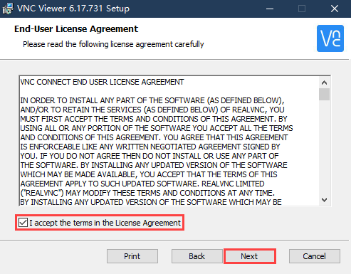

(3) Tick “I accept the terms in the License Agreement”. Then click “Next”.

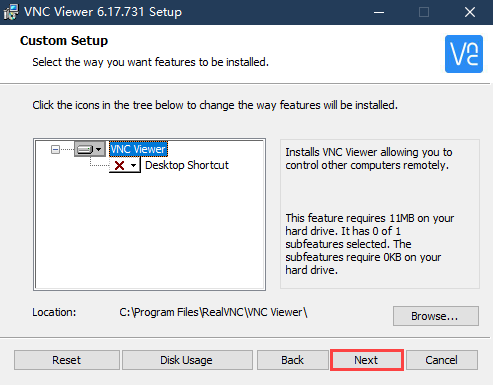

(4) Remain default location where the software is installed. Click “Next” to proceed next interface. Then directly click “Install”.

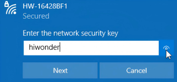

(1) After turning Robot on successfully, the default mode is AP direct connection mode. Robot generates a WiFi starting with HW. Connect your computer to this WiFi.
(2) Input password. The password is “hiwonder”.

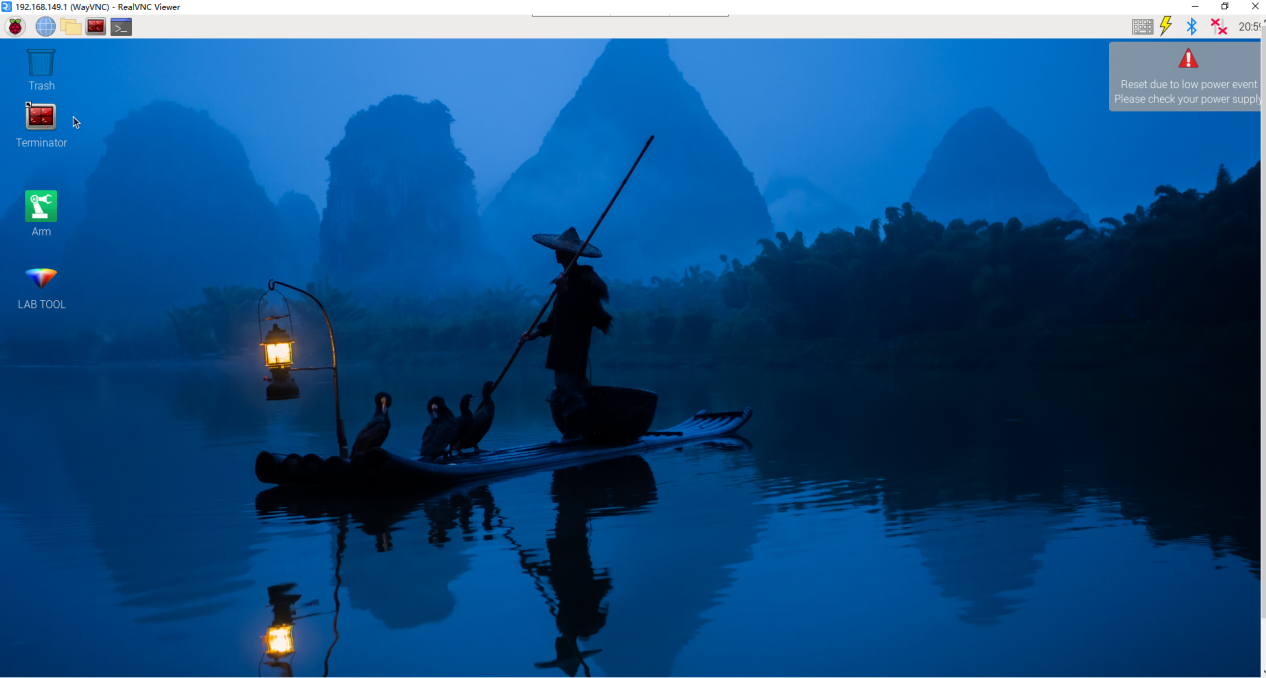

(3) After connection, open VNC Viewer. Input the default IP address of Raspberry Pi, 192.168.149.1, and then press Enter. If you receive security warning, select “Continue”.
(4) Input username and password. (Username: pi Password: raspberrypi). Click “OK” to enter Raspberry Pi desktop.
(5) The desktop is as pictured. If black screen occurs or only cursor leaves on the screen, restart Raspberry Pi.

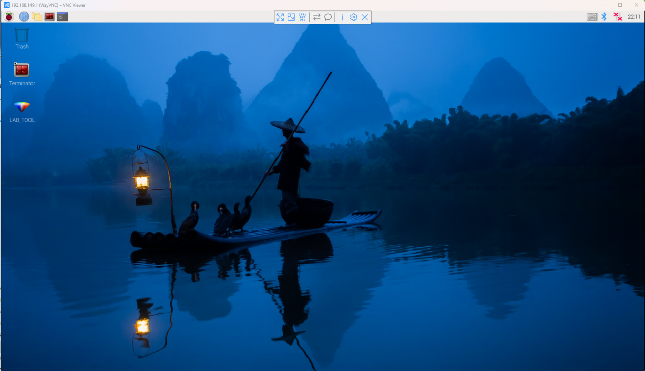

The desktop is as pictured after connecting Robot through VNC successfully.

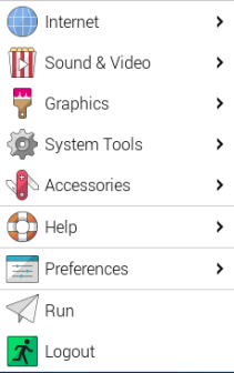

Application menu. Click to select different applications.
