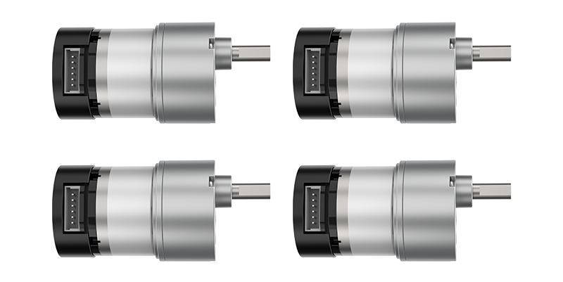

| 4 | 8V encoder motors | 4 | ![]() |

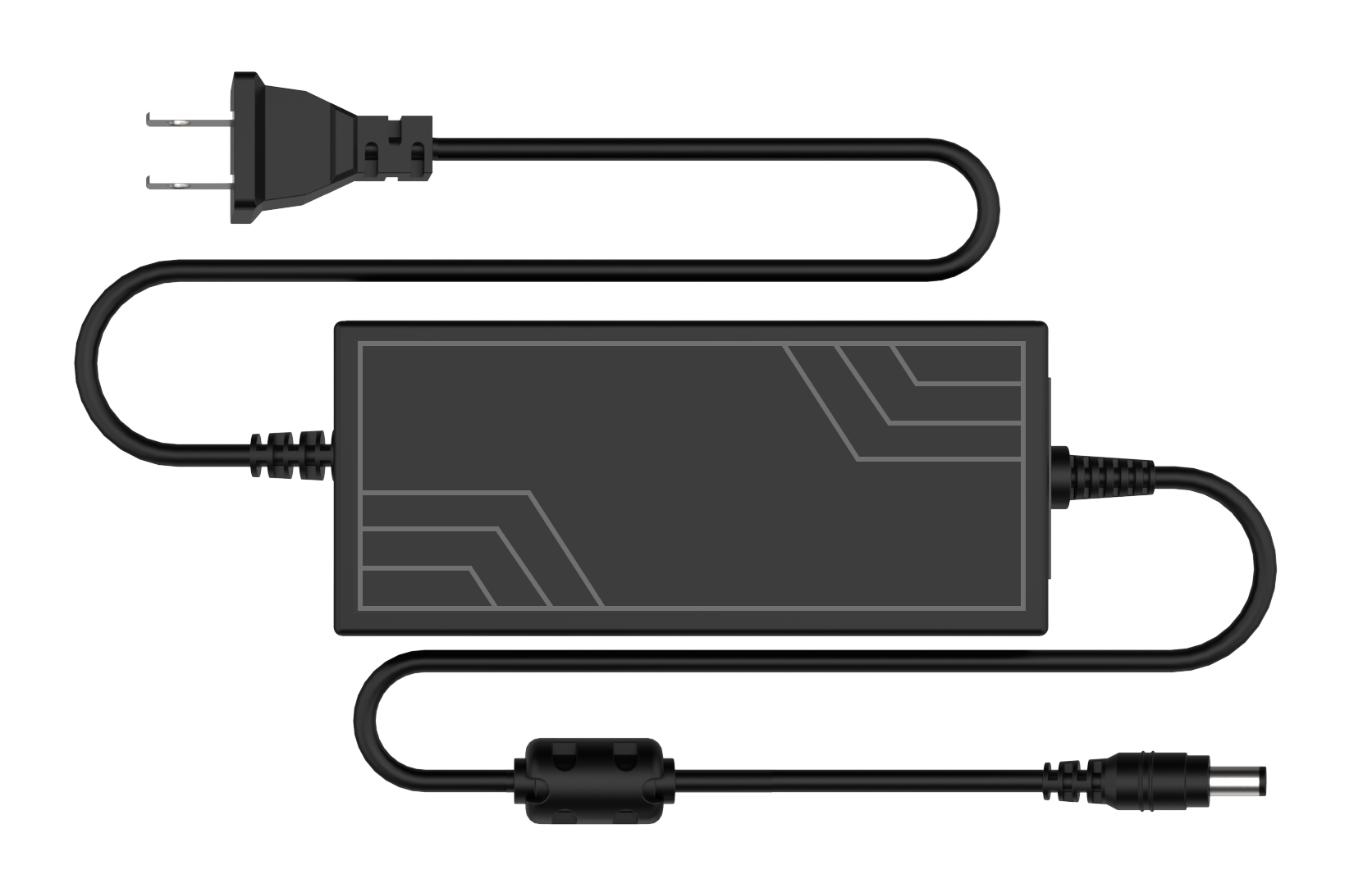

| 6 | 8.4V 2A battery charger | 1 | ![]() |

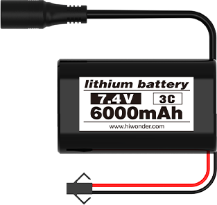

| 7 | 7.4V 6000mAh 3C Lipo battery | 1 | ![]() |

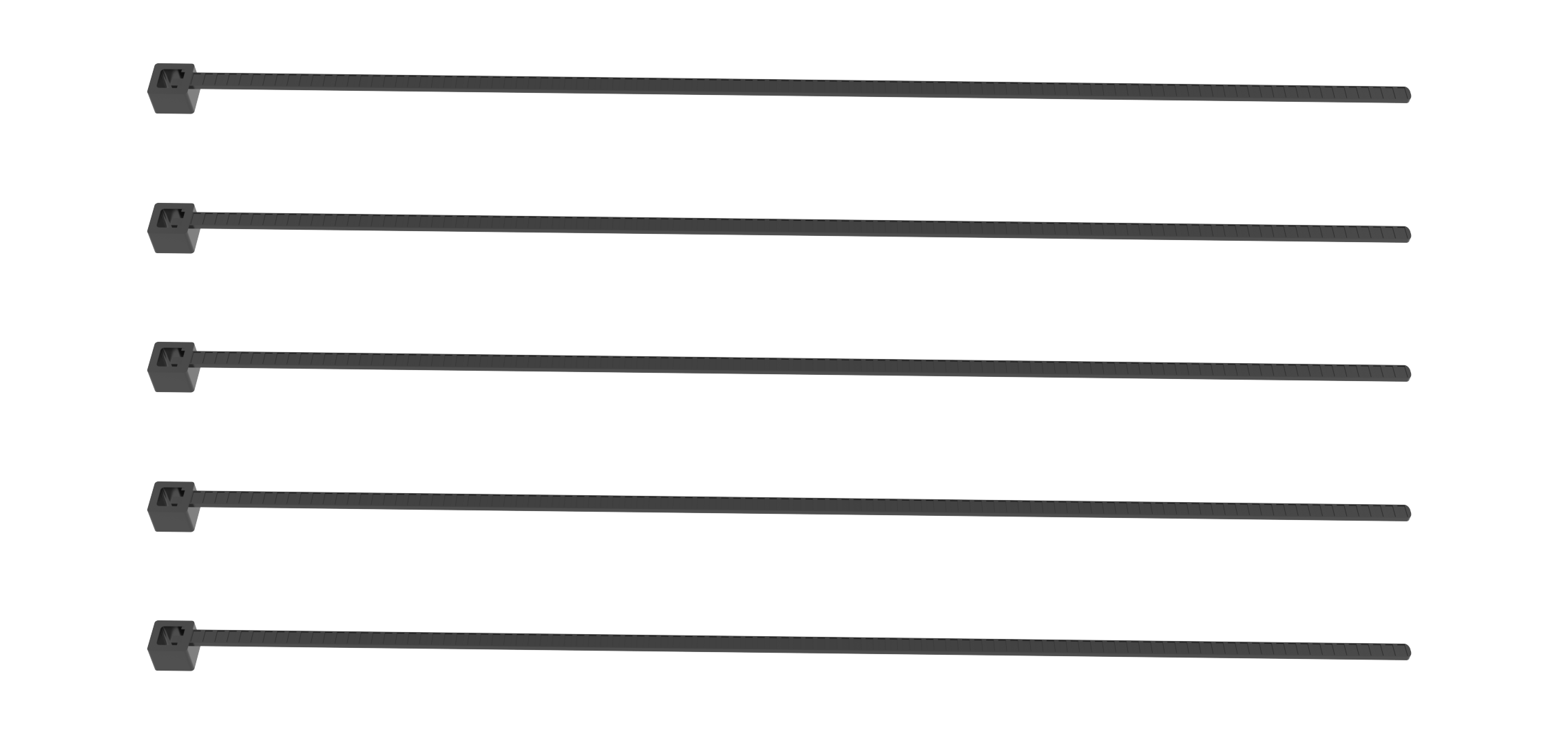

| 15 | Cable tie | 5 | ![]() |

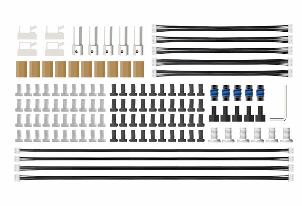

| 20 | Accessory bag (M3*6 Black round head screw*40 M4*6 Headless hexagon screw*5 M3*8 Round head screw*6 M4*6 Round head screw*40 M4*8 Double-pass Copper Column*10 M4*5+6 Single-pass nylon column*5 30cm 4pin wire*2 15cm 4pin wire*5 30cm 3pin wire*2 M4 Hexagonal Coupling*5 2mm Hexagon Socket Key*1 Wire Fixation Clamp*4 ) |
1 | ![]() |

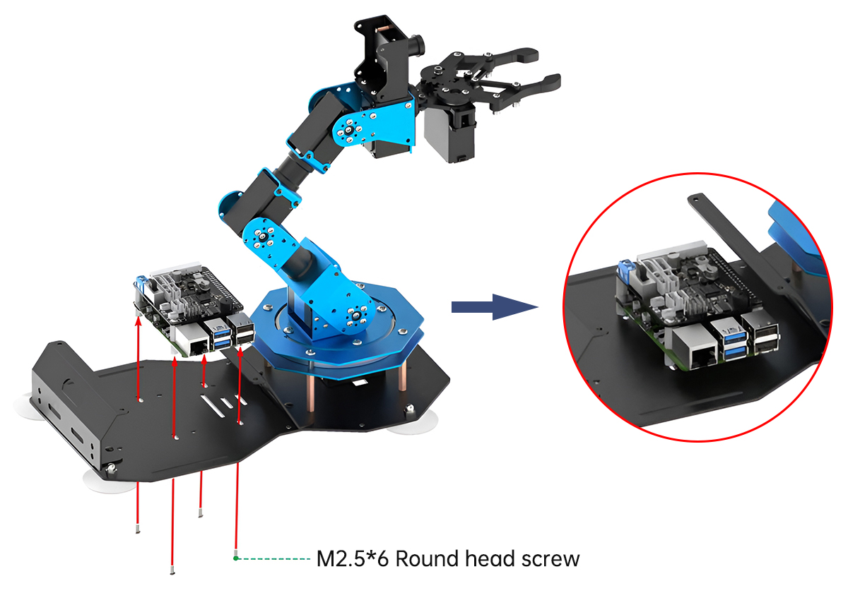

For the users with their own Raspberry Pi board, refer to the content in “1.3.2 Raspberry Pi Aassembly”

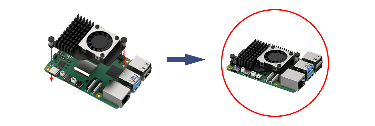

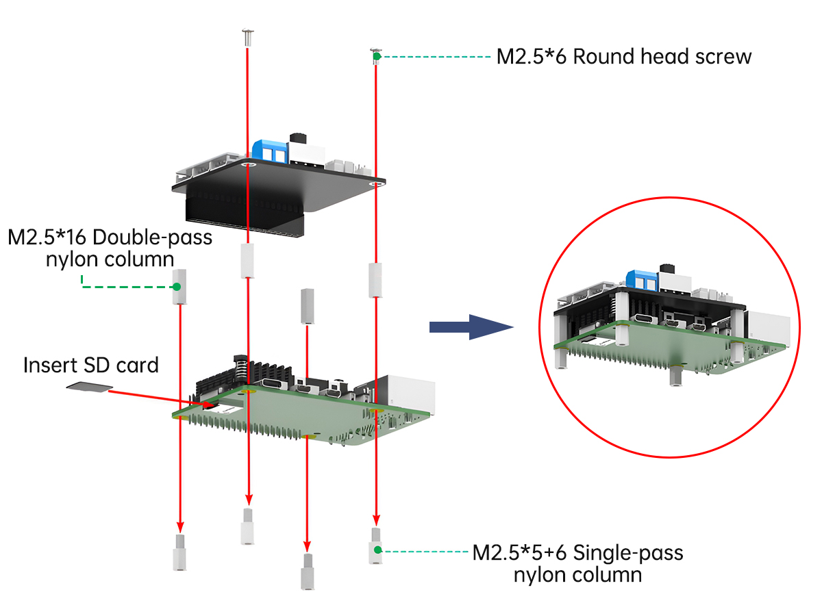

1.3.1 Raspberry Pi Assembly (Applicable for kits without Raspberry Pi)
Step 1
Step 2
Step 3
Step 4
Step 5
Step 6

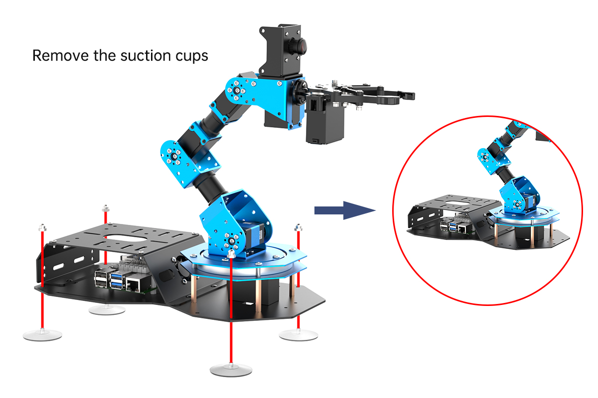

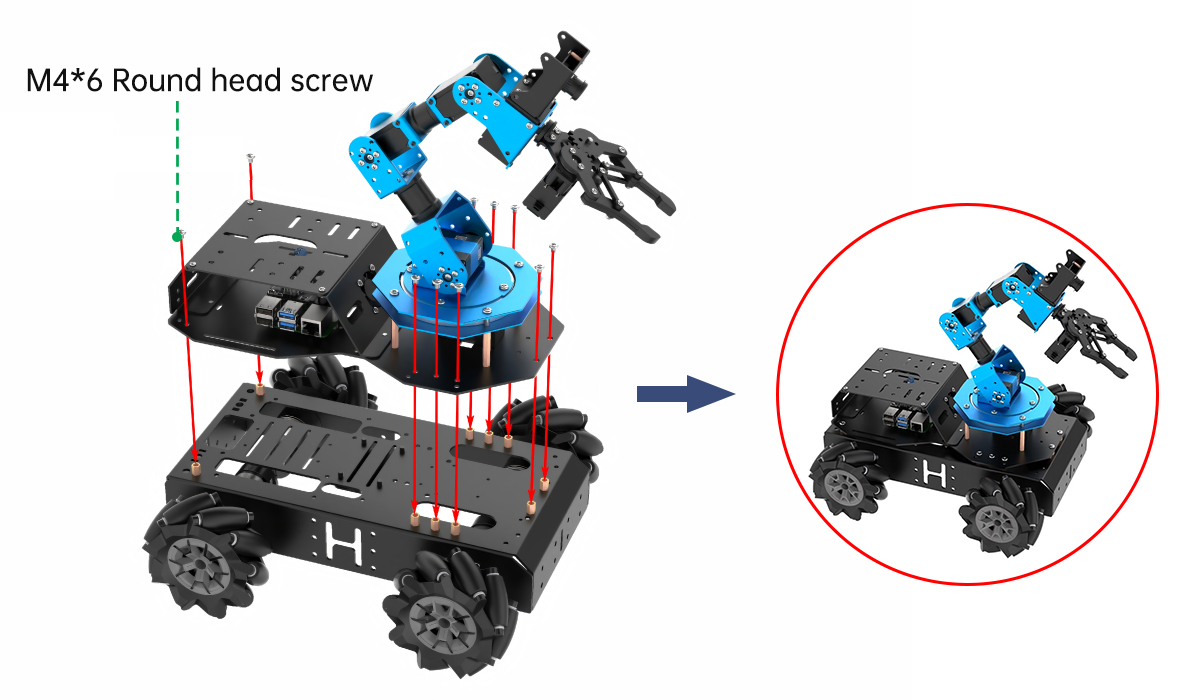

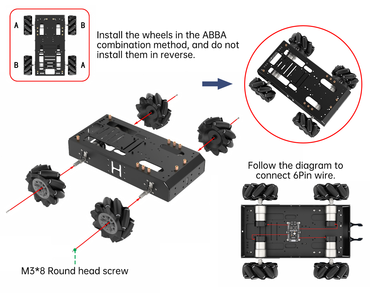

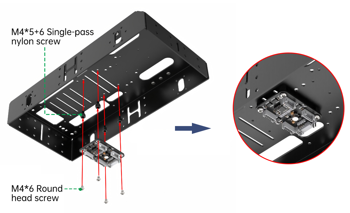

1.3.2 Robot Assembly
Step 1
Step 2
Step 3
Step 4
Step 5
Step 6
Step 7
Step 8
Step 9
Step 10

Charging
(1) Take out charger and insert its cable to the battery cable.
(2) Waiting for the charging to complete. The indicator light of charger turns green when the charger is powered on; Red light is to indicate charging. The duration of charging is about 1.5h. When the indicator turns green from red, it means charging is complete. Please unplug the charger as soon as possible after charging.

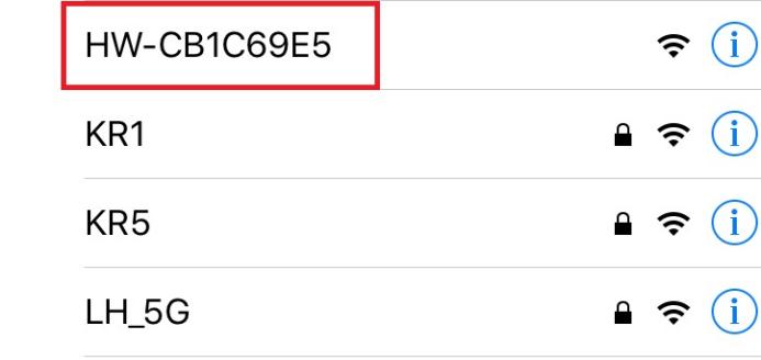

(2) After turning on, Raspberry Pi will be in an AP direct connection mode by default and launch a Wi-Fi hotspot starting with “HW”.
