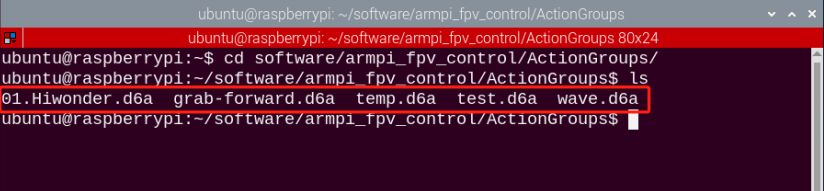

The action group files are stored in the path “/home/ubuntu/software/armpi_fpv_control/ActionGroups”. There are three built-in action groups by default.

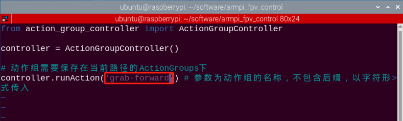

(6) Here calls the “grab-forward” as the example. Replace “pick” with “grab-forward” within the parentheses.
The action name must be the same as the name actually stored, otherwise it may cause failure to action calling.

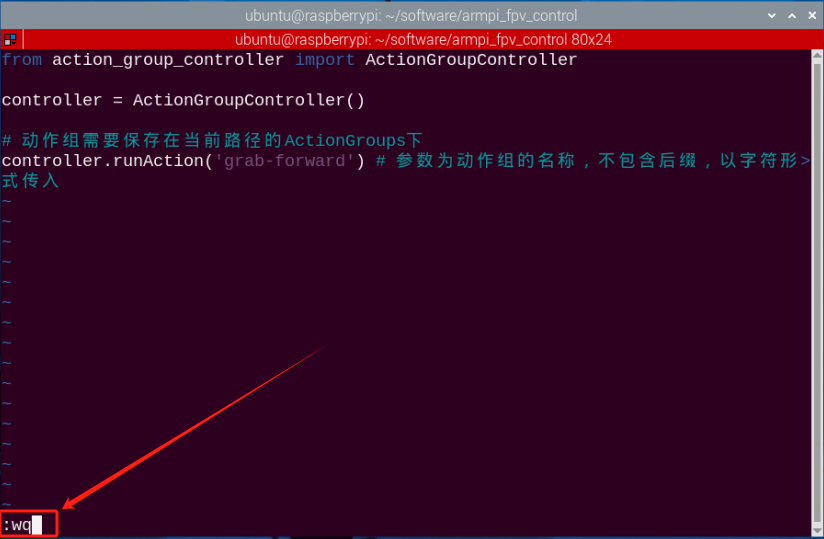

(7) Press “Esc” to exit editing mode. Then press “:wq” again to save and exit.
:wq

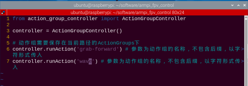

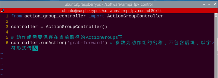

(2) Then copy the “controller.runAction()” function. The parameters in the function must be the same as the name of the saved action file, otherwise it cannot be executed.
(3) Select the function in line 6 with the mouse. Press the “Y” key twice, and then press the “P” key to copy the above function to the next line.
(4) Change the parameters in the function to “wave”, and then save and exit. And enter the command “python3 control_demo.py” again and press Enter.

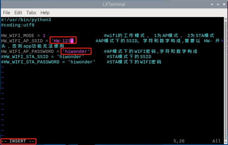

(3) Use the vim editor to open the Wi-Fi configuration file, enter the command, and press Enter.
sudo vim hiwonder_wifi_conf.py

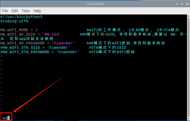

(4) Enter the “i” key on the keyboard to enter the editing mode.
(5) After the modification is completed, press the “Esc” key to exit the editing mode. Enter “:wq” again to save and exit.
:wq
(6) Entering the command will restart the device in order for the WI-FI configuration file to take effect. This step cannot be skipped!
sudo reboo

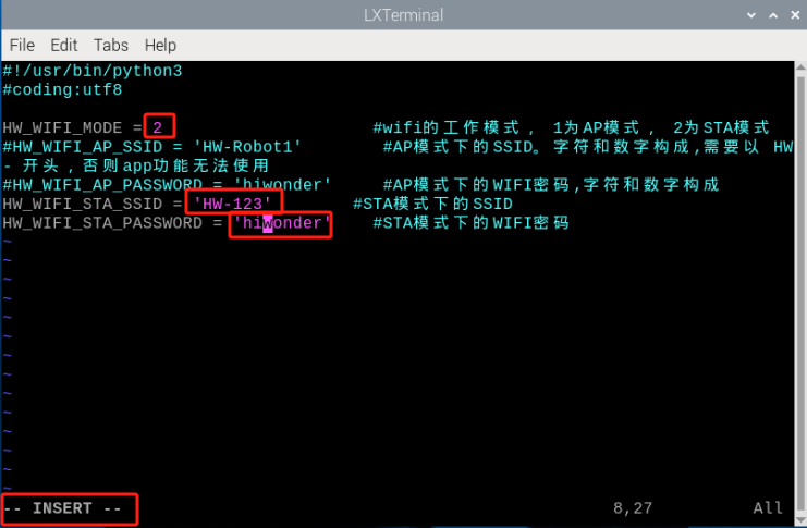

(4) Press the “i” key to enter the editing mode. Modify the code of Wi-Fi name and password as pictured:
(5) Set the slave device’s network mode to “2”, which corresponds to LAN mode. “HW-123” and “hiwonder” are the Wi-Fi name and password of the host, which can be checked in section “10.2.3 Operation steps->Check Host.”
(6) After the modification is completed, press the “Esc” key to exit the editing mode. Enter “:wq” again to save and exit.
:wq
(7) Entering the command will restart the device in order for the WI-FI configuration file to take effect. This step cannot be skipped!
sudo reboot

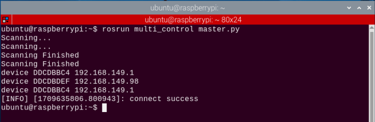

(5) Open a new terminal and type the command, then press “Enter” to control the robotic arm. Once successfully entered, it will display the IDs of the host and slave as shown in the figure below:
rosrun multi_control master.py
Press “Ctrl+C” to close the program.
