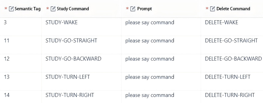

The default firmware within the voice recognition module has 4 preset command words that can be modify by voice, as shown below:
