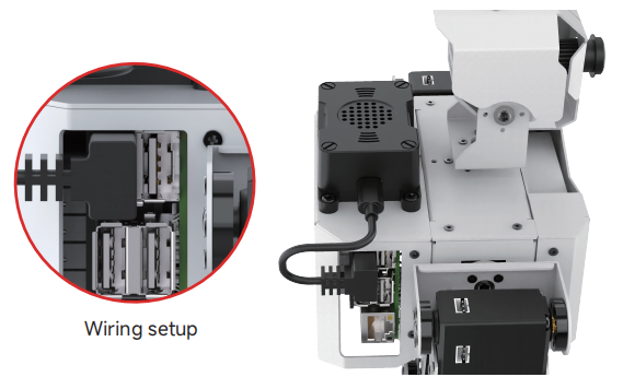

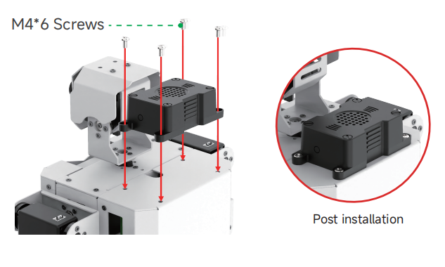

(1) Secure the WonderEcho Pro to the back of TonyPi using M4*6 screws, making sure to align it in the correct orientation.
(2) Connect the module to the robot’s USB port using a Type-C cable.

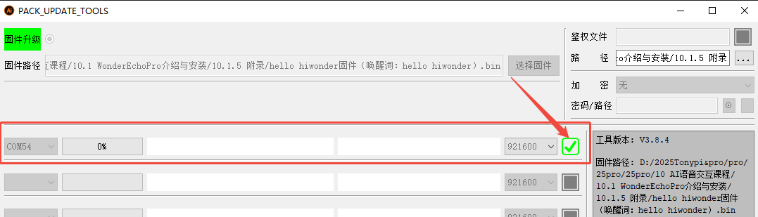

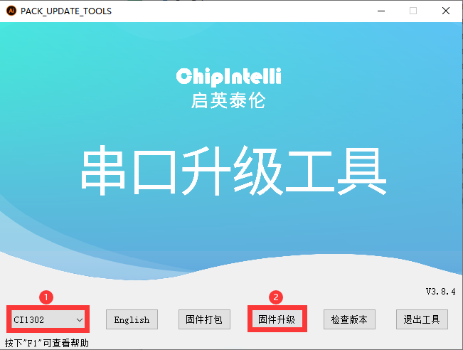

(2) Open the file “PACK_UPDATE_TOOL.exe” located in Firmware Flashing Tool. Select the “CI1302” chip and click “Firmware Upgrade”.
For this example, we will use the “hello hiwonder firmware” (Wake word: “hello hiwonder”).
(3) Select the firmware by locating the “hello hiwonder firmware (Wake word: hello hiwonder).bin” file under the Appendix path.
(4) Identify the correct COM port and select it.

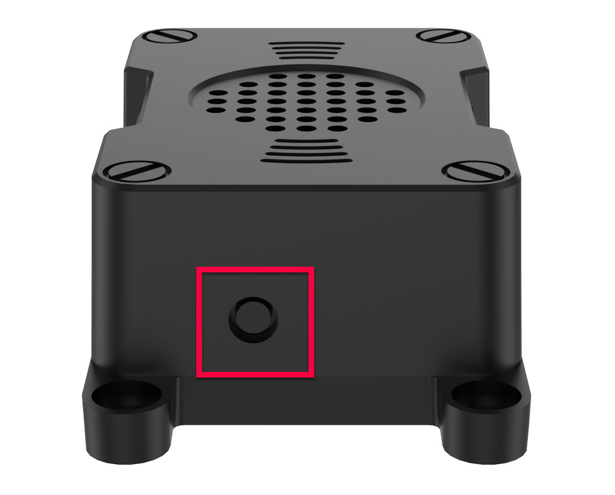

(5) Press the RST button on the WonderEcho Pro to initiate the flashing process. Wait for the process to complete successfully.

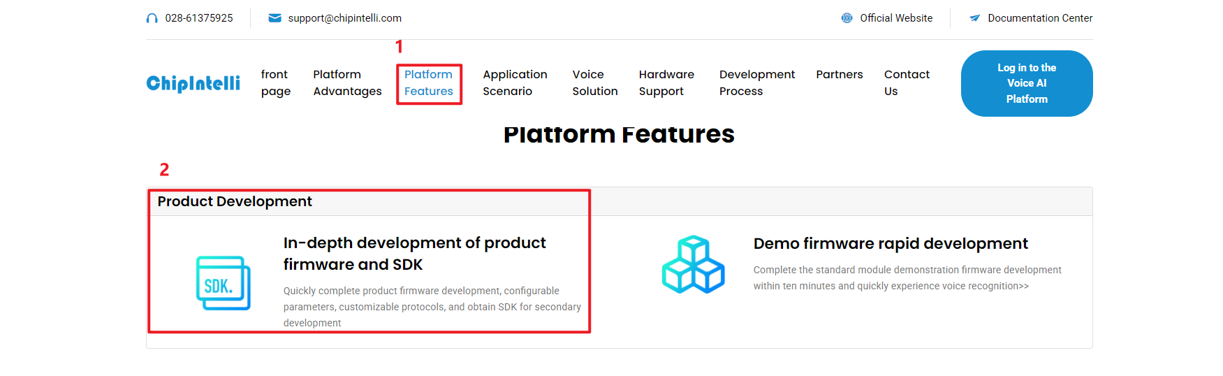

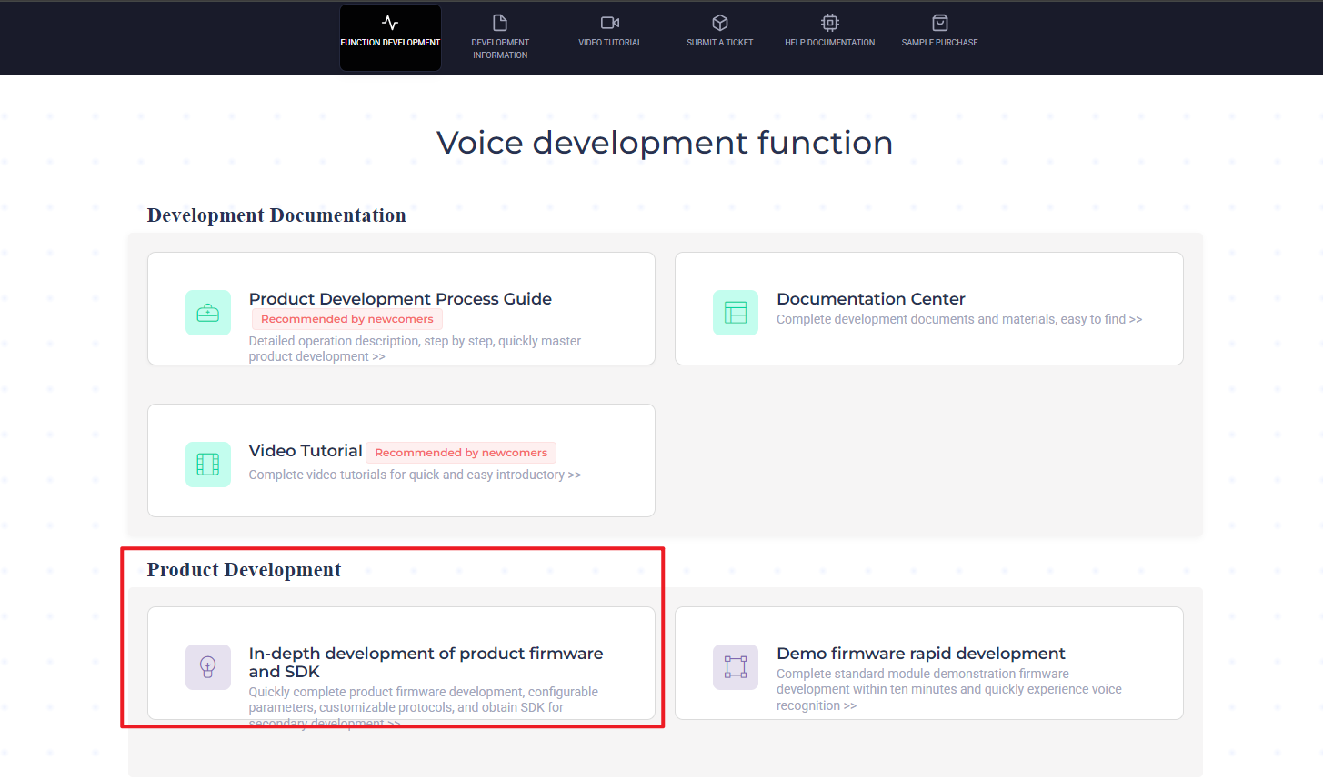

(1) Open the official firmware creation website: https://aiplatform.chipintelli.com/home/index.html; The platform interface is in Chinese. If needed, use your browser’s translation feature to switch to English for easier navigation.
(2) First, visit the ChipIntelli Voice AI Platform by clicking on “Platform Features” in the top menu, and then select “In-depth development of Product Firmware & SDK” under the Product Development section.
(3) You will be prompted to log in. (Note: Currently, registration is only available for mainland China mobile numbers. For international users, we provide a shared account: Username: 18033085495 Password: hiwonder)
After successfully logging in, click “In-depth development of Product Firmware & SDK” again to access the development section.

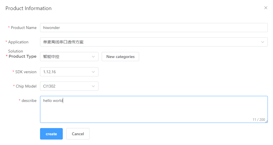

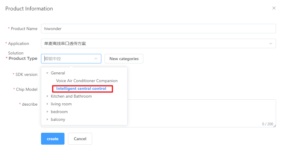

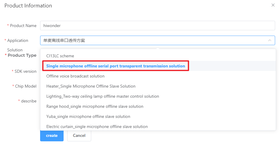

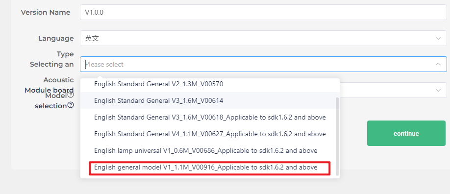

(4) To create a new product, click the option in the left sidebar. You will be asked to provide a Product Name and a Description, both of which can be customized. For the other fields, follow the options shown in the red box. Specifically, choose Product Type: 通用 (General) → 智能中控 (Smart Central Control). After completing these steps, click Create.

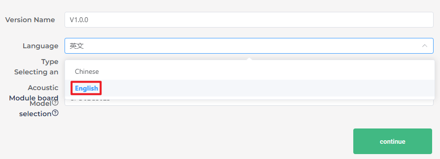

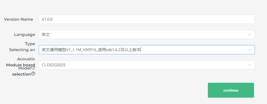

(5) Next, you will need to set the project language. Since we are configuring for English voice recognition, select English under Language Type. If you were configuring for Chinese recognition, you would select Chinese for both Voice Type and Acoustic Model. Once you’ve selected the appropriate options, click Continue to proceed.

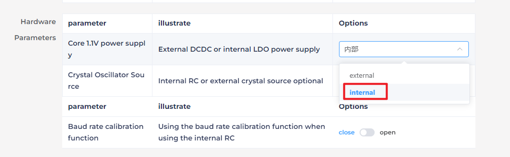

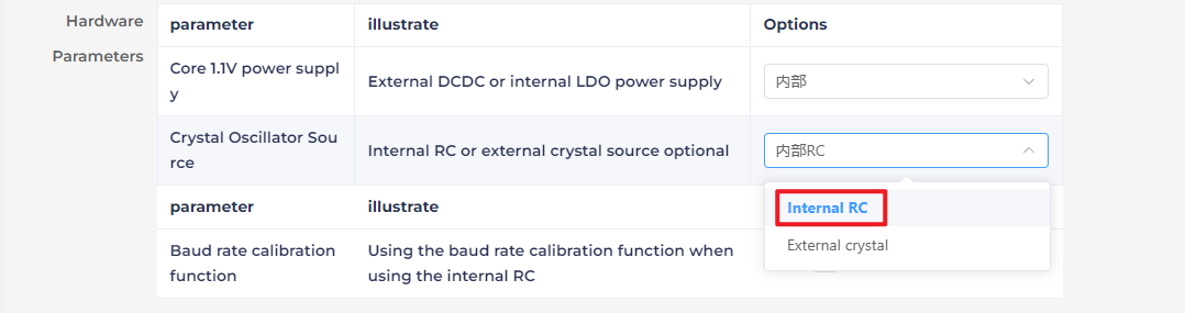

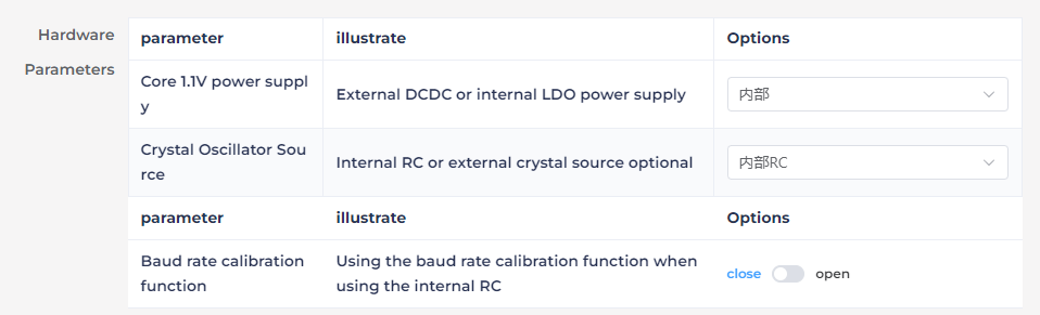

(6) In the firmware configuration interface, you will make some important changes to the settings. Start by enabling the Echo Cancellation feature under Algorithm Settings.

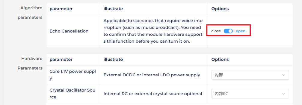

(7) Under Hardware Settings, set the oscillator source to Internal RC and disable the Baud Rate Calibration function.

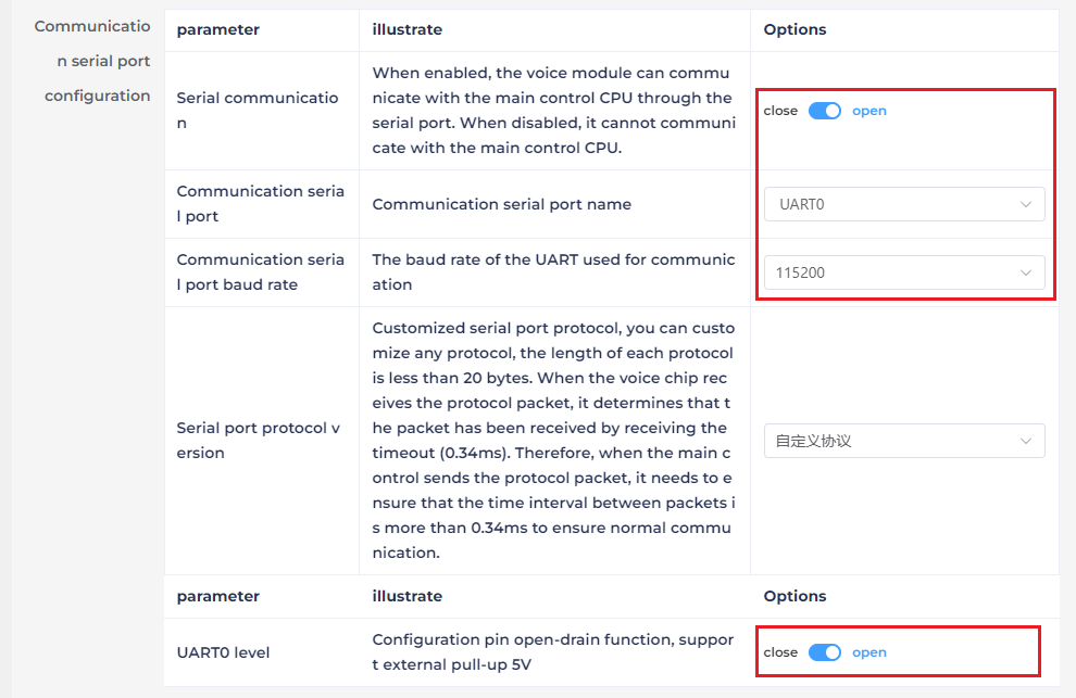

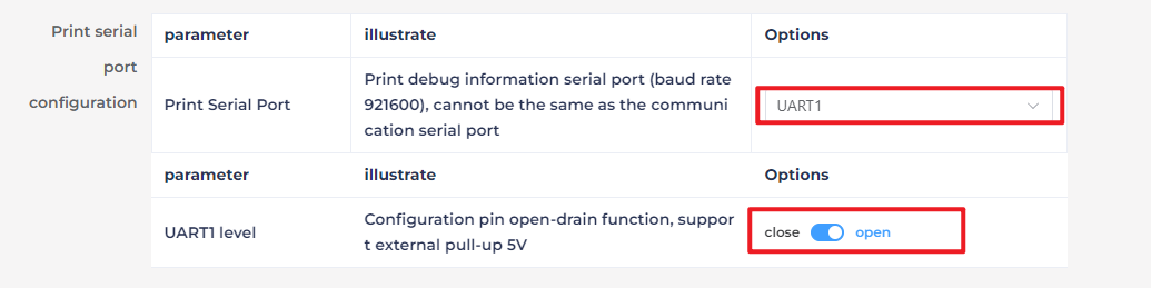

(8) In the UART Print Settings, configure UART1 to Open-Drain Mode, supporting external 5V pull-up.
(9) For Communication UART Settings, set the Baud Rate to 115200 and configure UART0 to Open-Drain Mode, also supporting external 5V pull-up. After adjusting these settings, click Continue to move forward.

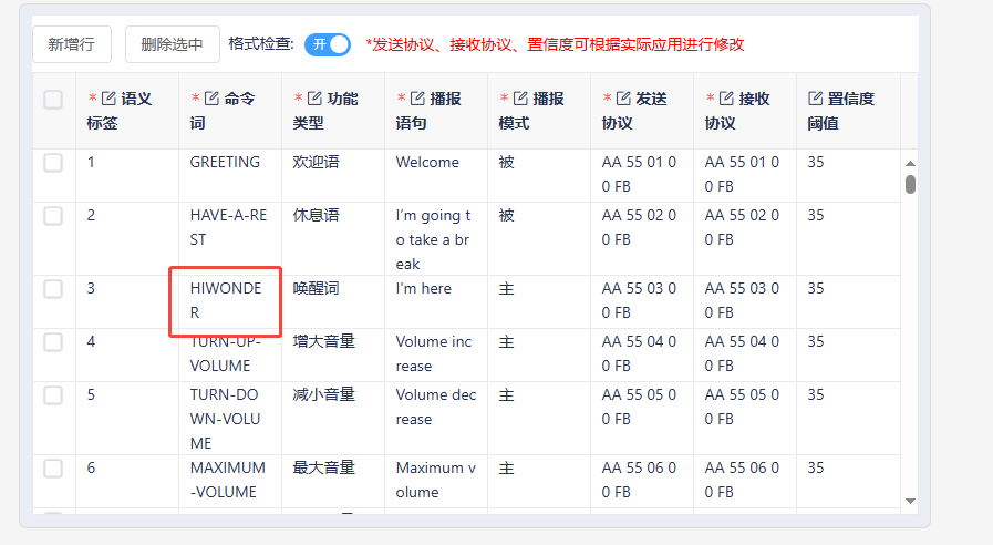

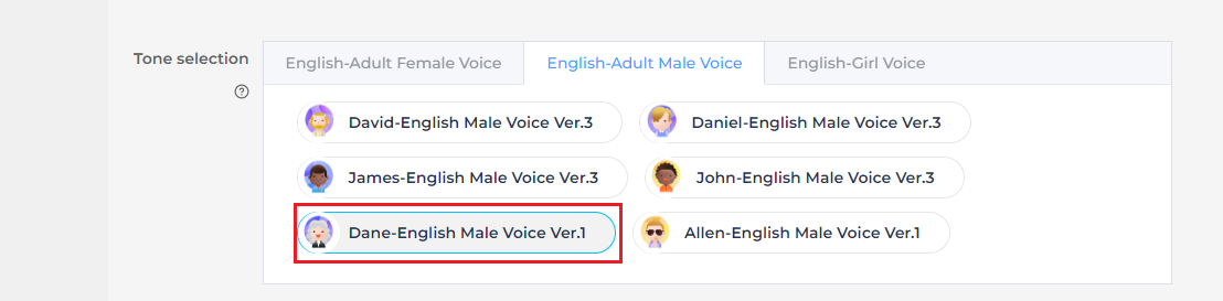

(10) The next step involves configuring the command words. You will need to choose a voice output for the wake-up command. For this example, select “Dane – English Male Voice” as the output voice. (If you’re using Chinese as the language, you may choose the voice option “Chengcheng – Standard Boy Ver.1”. The selection between Chinese and English voices is determined by the language settings configured in Step 5.)

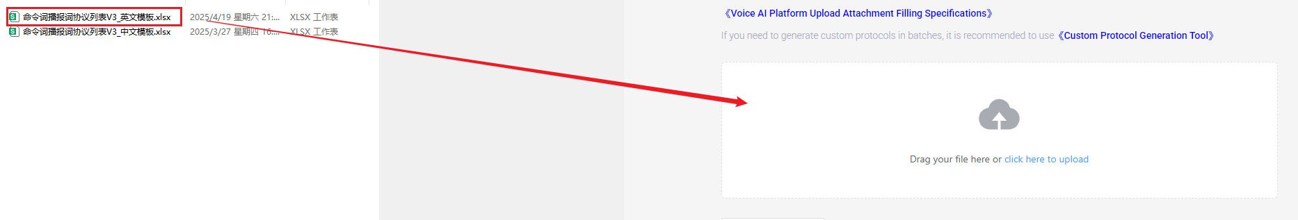

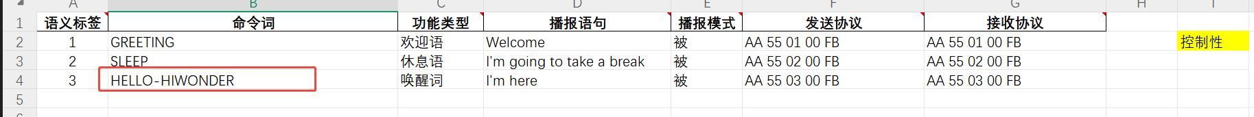

(11) Next, upload the command word configuration file. Navigate to the folder Wake Word Protocol List and locate the spreadsheet titled Command Phrase and Playback Protocol List V3 – English Template. Simply drag and drop the file into the upload area on the webpage.

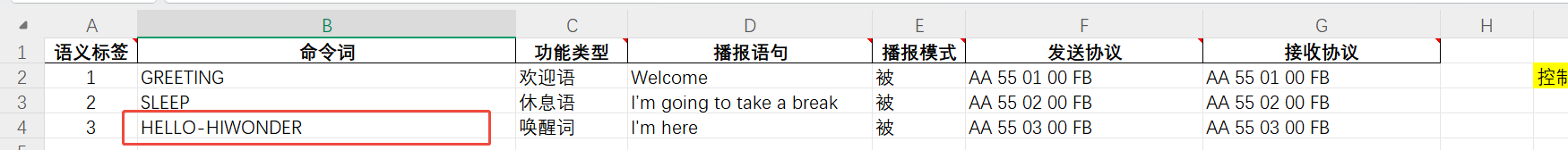

If you wish to change the wake word, open the spreadsheet and replace the default wake word HIWONDER with your preferred word. Keep in mind that the English version of the firmware only supports English wake words, and mixed-language wake words are not allowed. Additionally, English wake words must be written in uppercase letters to function properly.
(12) After uploading the file, you will see the command data populated in the table below.

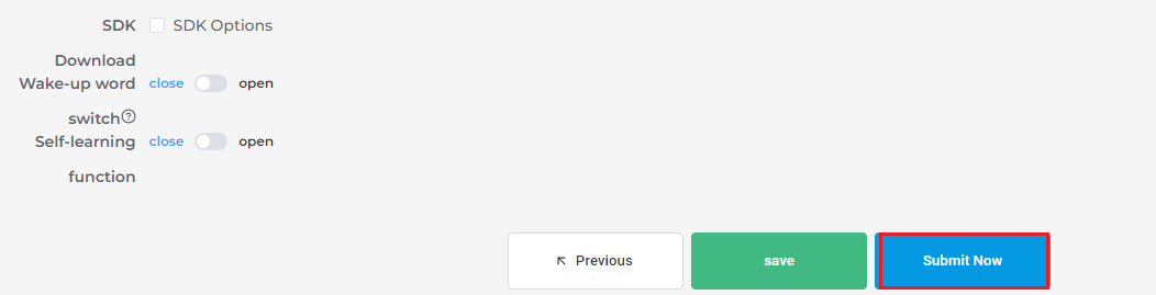

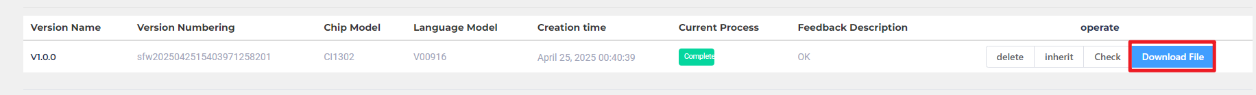

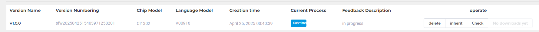

(13) Click “Submit” and wait a few minutes for the firmware generation process to complete. Once finished, click “Download” to obtain your customized firmware.

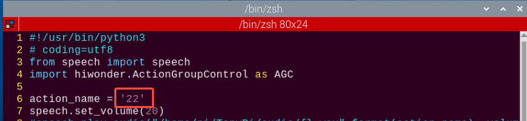

(4) Locate the code section in the area highlighted in the image.
(5) Press the “i” key to enter edit mode. Modify the action group name at this location to match the action group from the “ActionGroups” file. For example, change it to “22.d6ac,” as shown in the image.
(6) Once the modification is complete, press the “Esc” key. Then, type the following command (note that a colon “:” precedes the “wq”) and press Enter to save the changes:
:wq
(7) Afterward, repeat the steps outlined in this document to run the program. This will execute Action Group 22 and its corresponding music, reflecting the changes you’ve made.

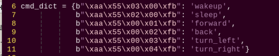

  • Define the protocol for sending and receiving keywords
cmd_dict = {b"\xaa\x55\x03\x00\xfb": 'wakeup',
            b"\xaa\x55\x02\x00\xfb": 'sleep',
            b"\xaa\x55\x00\x01\xfb": 'forward',
            b"\xaa\x55\x00\x02\xfb": 'back',
            b"\xaa\x55\x00\x03\xfb": 'turn_left',
            b"\xaa\x55\x00\x04\xfb": 'turn_right'}

            res = wonderecho.detect()
            if res != b'':
                if res in cmd_dict:
                    if cmd_dict[res] == 'wakeup':
                        speech.play_audio(os.path.join(audio_path, 'wakeup.wav'))
                        print('wakeup')
                    elif cmd_dict[res] == 'sleep':
                        speech.play_audio(os.path.join(audio_path, 'dong.wav'))
                        print('sleep')
                    elif cmd_dict[res] == 'forward':
                        speech.play_audio(os.path.join(audio_path, 'ok.wav'))
                        AGC.runActionGroup('go_forward', 2 , True)
                        print('forward')
                    elif cmd_dict[res] == 'back':
                        AGC.runActionGroup('back', 2 , True)
                        print('back')
                    elif cmd_dict[res] == 'turn_left':
                        AGC.runActionGroup('turn_left', 2 , True)
                        print('turn_left')
                    elif cmd_dict[res] == 'turn_right':
                        AGC.runActionGroup('turn_right', 2 , True)
                        print('turn_right')
