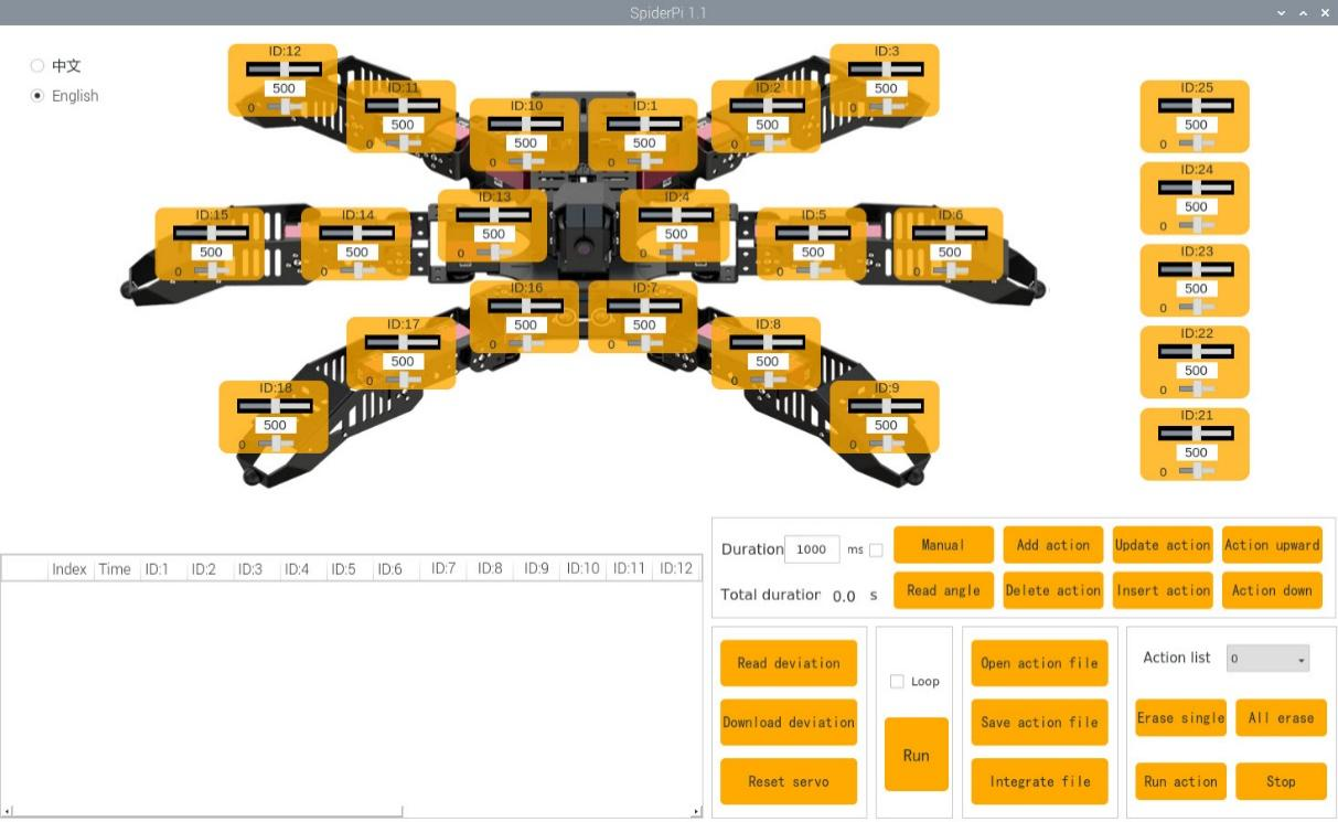

Firstly, connect to VNC remote desktop and double-click PC software “SpiderPi” to start it. If window pops up, click “Run”.
loading
The interface is divided into 5 areas.

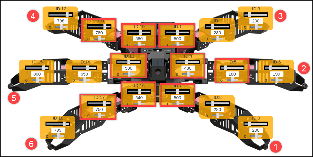

4.1.1 Body control area
You can drag the slider to control the position of the corresponding servo so as to switch the moving posture of the SpiderPi Pro.
Icon Function
loading ID number. Take NO.3 servo as example
loading Adjust servo position from 0 to 1000
loading Adjust servo deviation from -125 to 125.

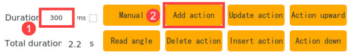

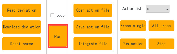

4.1.4 Action group setting
Icon Function
loading Action running duration time. Click the value to modify. Note: you need to click the "Update Action" button to make the modified settings take effect. In addition, the value range of the time is 20-9999.
loading The total running time taking for all the actions in an action group to complete running.
loading If you click this button, the joints of the robot will become loose, and you can drag the servo to form any posture.
loading Read the servo angle you have designed before. This button should be used withloading
loading Add the servo value as a action to the last line of the action list
loading Delete the action selected in the action list
loading Replace the angle value of the action selected in the action list with the servo value in the servo control area. And update the running time as the time set in "Time"
loading Insert a new action above the selected action. The running time of this new action is the time set in "Time" and angle value is the current value in servo control area.
loading Move the selected action up one line
loading Move the selected action down one line
loading Click to run all the actions on the action list once
loading If "Loop" is ticked, SpiderPi Pro will repeat the action.
loading Load the data of the saved action group to the action list
loading Save the current actions in the action list into the designated path.
loading Firstly, open one action group, then click this button, and then open other action group. And these two action groups will be integrated into one.
loading Display the saved action groups. You can select the action to run
loading Delete the currently selected action group file.
loading (Be careful!)Deleted all the action group files.
loading Run the selected action group once.
loading Stop running the action group.
4.1.5 Servo deviation setting area
Icon Function
loading Click to read the saved servo deviation.
loading Click to download the adjusted deviation to the robot.
loading Click to return all the servos to the middle position(500).

The robot body consists of 6 legs, that is 1-6 zones, as shown in the figure below.

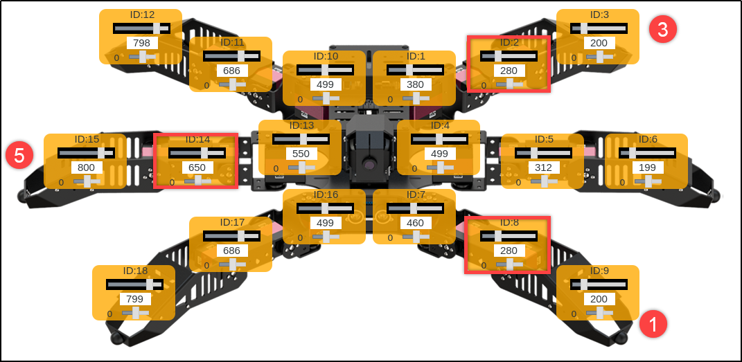

(3) Adjust the slider of ID1, ID2, ID7, ID8, ID13 and ID14 servos to make robot lift NO.1, 3 and 5 legs and tilt forward. The adjusted values are shown as follow.
loading
(4) Set the time as 300ms and click “Add Action”. Then the second action is added to the action list.

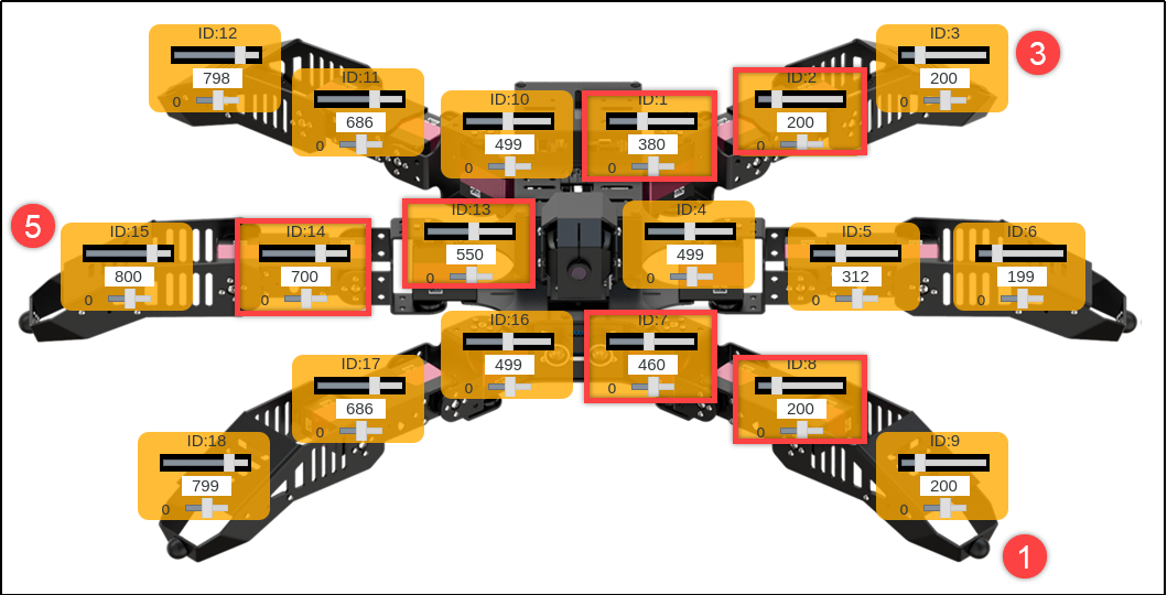

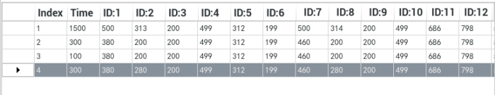

(6) Next, put down NO. 1, 3 and 5 legs. Modify the servo value of ID2, ID8 and ID14 according to the picture below.
loading
Set the time as 300ms, and click “Add Action” to add NO.4 action.
loading loading

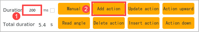

(7) Add other transitional action and set the time as 200ms, and then click “Add Action” to form NO.5 action.

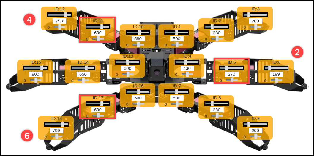

(8) Next, lift NO.2, 4 and 6 legs and make the servos on NO.1, 3 and 5 return to the mid position to make the robot move forward. Set he servo value according to the below figure

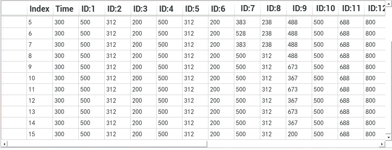

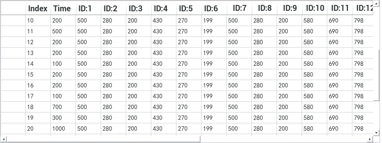

The action of moving forward is complete, which involves 8 independent actions. The servo values of each action are listed below.

(3) As before, we need to add a transitional action. Set the time as 200ms and click “Add Action”.

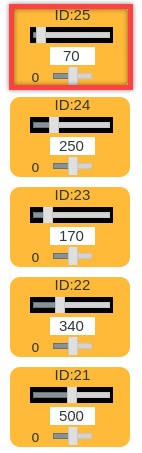

(12) Drag the slider of ID 25 to set the value as 510 making the gripper clamp the block.

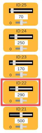

(14) Set the value of ID22 as 510 to make the robotic arm lift the block.
loading
(15) Set the time as 700ms and click “Add Action” to obtain NO.18 action.
loading

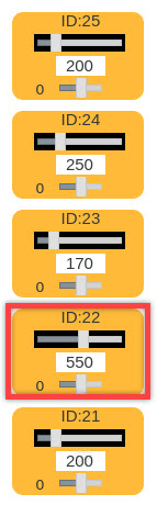

(20) Next, put down the block and drag the slider of ID22 to lower down the robotic arm.
loading
(21) Set the time as 1000ms and click “Add Action” to generate NO.22 action.

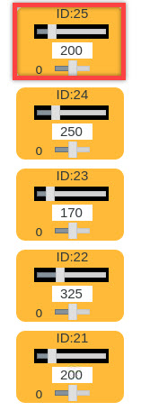

(22) Release the block. Set the value of ID25 servo as 200 to open the gripper.
loading
(23) Set the time as 800ms and click “Add Action” to add NO.23 action.

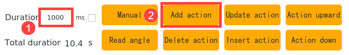

(25) Set the time as 1000ms and click “Add Action” to get NO.24 action.
loading
(26) Set the time as 1000ms and click “Add Action” to add a transitional action.
loading
(27) Lastly, make the robotic arm return to the initial posture. Move to the action list and select NO.8 action, and then click to update the value of this action to the servo controlling area.
loading
(28) Set the time as 1000ms and click “Add Action” to get NO.26 action.

The servo value of the whole action group is as follow.

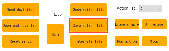

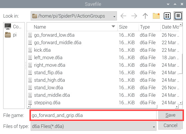

4.2.3 Save the Action
For the convenience of later debugging and management, it is recommended to save the action. Click “Save Action File” and select the path to save, /home/pi/SpiderPi/ActionGroups, and the enter the action group name “go_forward_and_grip”. Lastly, click “Save”.
when entering the action group name, please do not press “Space”, otherwise it may fail to save the action group.

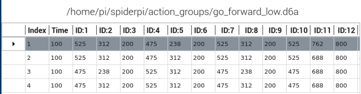

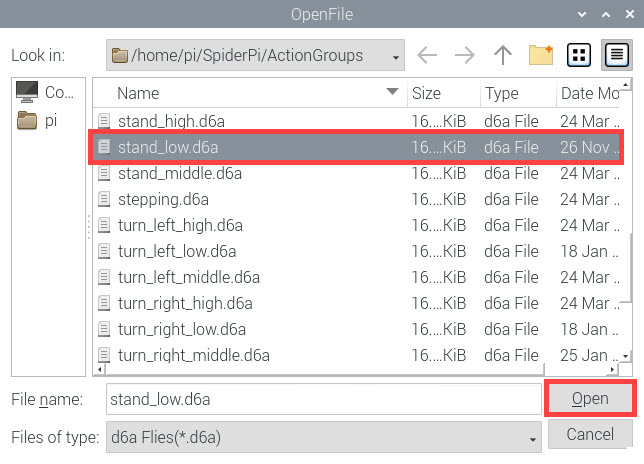

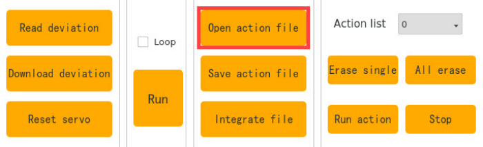

(3) Next, click “Open Action File” to select the action group to run. Then click “Open”.
(4) The file path and servo value of each action in this action group will be displayed in the action list.
(5) Click “Run” to run all the actions in the action list. If you want to make the robot repeat the action group, you can tick “Loop”.

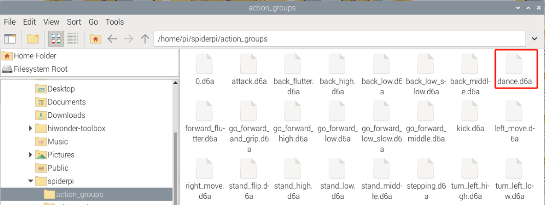

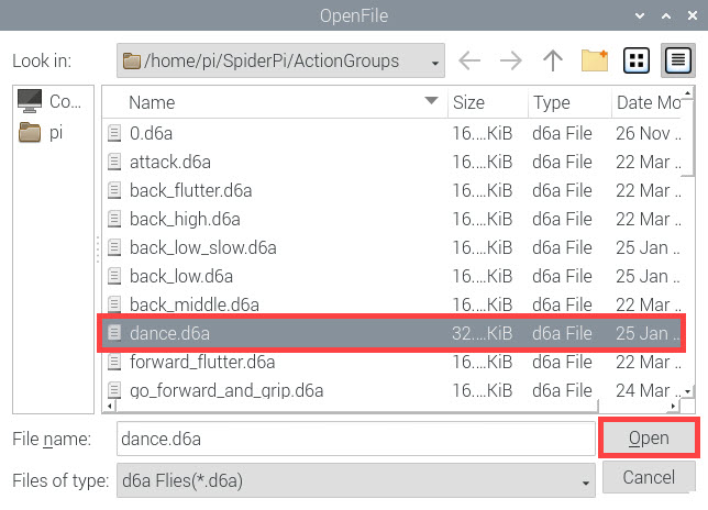

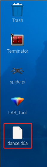

4.3.2 Import the external action group
If you want to call the external actions, you can follow these steps to operate.
Take importing “dance.d6a” action group for example.
the action group file must end with “.d6a” suffix.
(1) Insert the U disk containing the action files into any USB interface on Raspberry Pi. And copy and paste the action group files to the system desktop.
(2) Then save the action group file to this path /home/pi/spiderpi/action_groups/.

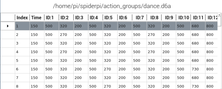

(3) Next, double click PC software icon loading and click “Run
(4) Click “Open Action File” and select the action group file to import, and then click “Open”.
(5) At this time, the servo value and the running time of the imported action group are displayed on the action list.

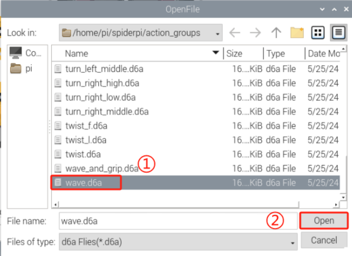

(1) Having connected to VNC, open SpiderPi PC software.
(2) Click “Open action file”and select “wave.d6a”file in the pop-up window, and click “Open”.
(3) Then the parameters of this action group are displayed on the action list.

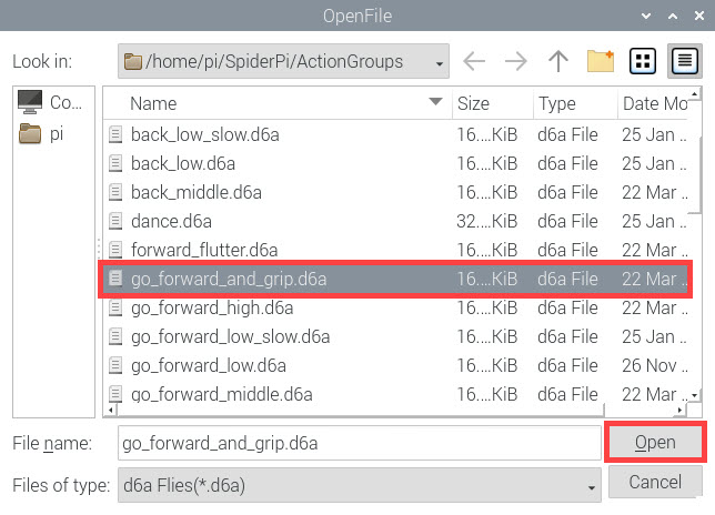

(4) Click “Integrate file” and select “go_forward_and_grip” action group, and then click “Open” again to integrate these two action groups.
loading
(5) Click “Run” to execute the new integrated actions online.

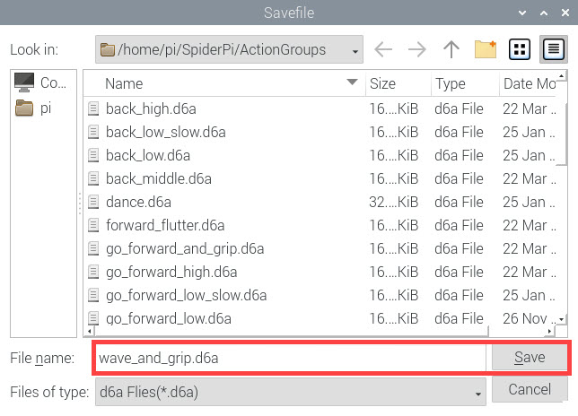

(6) Click “Save action file” button and enter new action group name (such as “wave_and_grip” ) to save the new integrated action group for the future debugging.

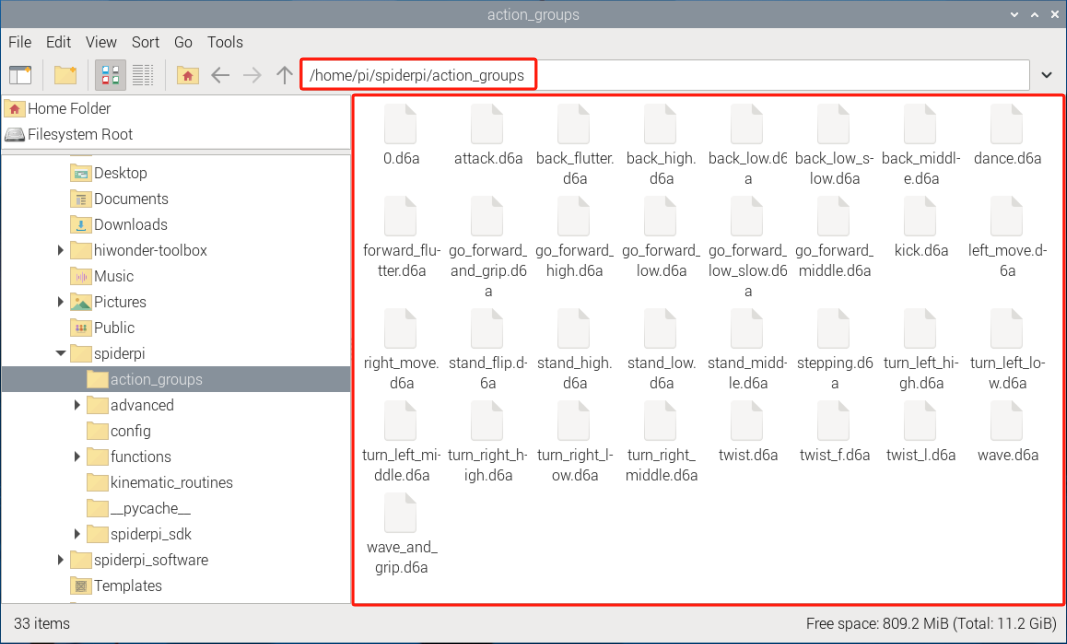

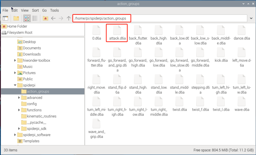

Besides importing the action groups of SpiderPi Pro using PC software, user can execute the command on the terminal to run action group.
action group files must be saved in this directory /home/pi/spiderpi/action_groups/.
Click-on and navigate to this folder /home/pi/spiderpi/action_groups/ where all action files are saved here.

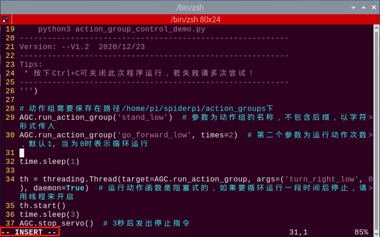

4.5.2 Call Action Group
(1) After accessing the system desktop using VNC, click-on to open the terminal.
(2) Execute the command and press Enter to navigate to the folder where game programs are saved.
cd spiderpi/functions/

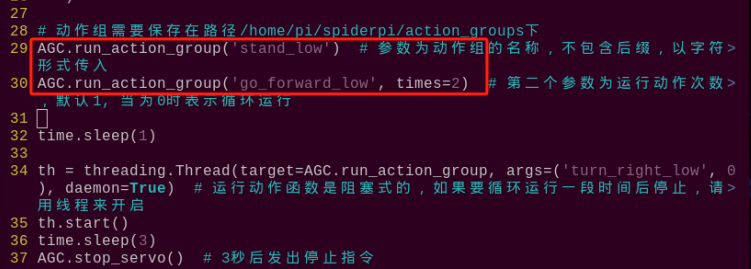

(3) Run the command and press Enter to start the game.
python3 action_group_control_demo.py
At this time, SpiderPi Pro will execute “stand” action group, then execute “go_forward” action group twice. Once SpiderPi Pro completes running the action group, the program will be terminated automatically.

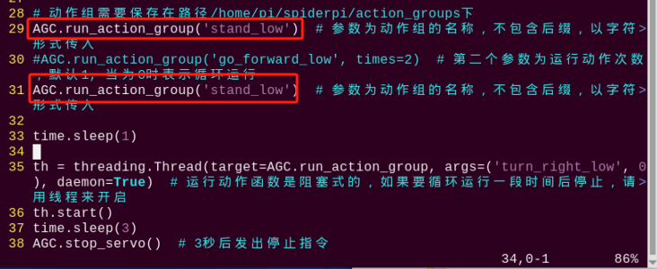

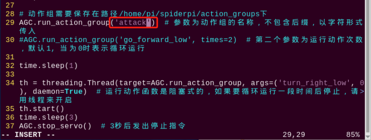

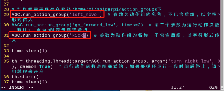

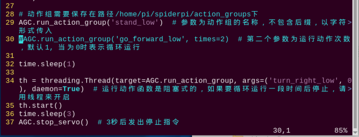

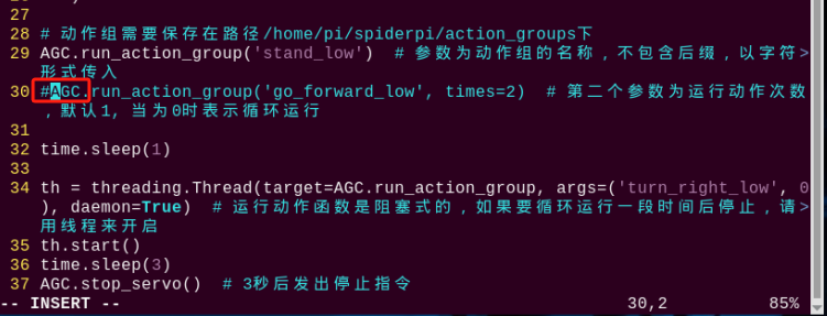

4.5.3 Change Action Group to be Called
  • Call Individual Action
User can modify the program to enable SpiderPi Pro to execute single action group. Detailed instructions are as below:
(1) After entering the robot system using VNC, click-on to open the terminal.
(2) Execute the command and press Enter to switch the directory where game programs are saved.
(3) Execute the command and press Enter to open the program file.
sudo vim action_group_control_demo.py
(4) Press “I” key to enter program editing mode.
(5) Locate the following mode.
(6) Use the function AGC.run_action_group() to call action groups saved in “/home/pi/spiderpi/action_groups/”. Enter the action group name within the single quotation mark, then save the command. After that, you can call the action group using command.
The 28th line of code introduces an extra runtime parameter ‘time=2,’ indicating that it will run twice. In this section, we’ll illustrate using the 27th line as an example, and initially, you can comment out the 28th line of code.
To do this, you can navigate the mouse cursor using the keyboard’s arrow keys and add the ‘#’ symbol at the beginning of line 28 to comment out that line of code. This will retain only the code for executing the ‘stand_low’ action group. In this configuration, the remaining 29th line of code will execute the action group once. If you wish to run the action group multiple times, you can comment out the 29th line and keep the 30th line of code.
(7) Enter the action group to be executed within the single quotation mark of the 29th line of code. Take executing “attack” action group as example.
the action group files must be saved in the directory /home/pi/spiderpi/action_groups/. If you want to call the customized action group, you need to edit the action group first according to the file saved in “4,2 Action Editing”.
(8) After modification, press Esc to exit the editing mode. Then input :wq and press Enter to save and close the program file.
:wq
(9) Execute the command python3 action_group_control_demo.py and press Enter to start the game. SpiderPi Pro will execute the action group attack once.
  • Call Multiple Action Groups
The following operation is carried out based on the preceding operation.
User can enable SpiderPi Pro to execute several action groups through copying multiple lines of codes. Take calling action groups “left_move” and “kick” as example.
(1) Repeat steps 1-3 provided in “4.5.3 Change Action Group to be Called ->Call Individual Action” to open the program file. Please note that never enter the editing mode, otherwise you will fail to copy the codes. If you find you are in editing mode, press Esc key to exit this mode.
(2) Position the cursor just before the 29th line using the arrow keys, and then press ‘yy’ on the keyboard. To copy 2 lines, use ‘2yy,’ with ‘2’ indicating the number of lines to be copied. You can specify the desired number of lines to copy; for instance, use ‘5yy’ to copy 5 lines.
(3) Them move to the end of the 30th line and press p to paste the code.
(4) Press i key to enter the editing mode, and change the number of the 29th and 31st lines respectively to “left_move” and “kick”.
action group files are saved in the directory /home/pi/spiderpi/action_groups/ The name of action group entered in the program should be consistent with the action groups saved in the “ActionGroups” folder.
(5) After modification, press Esc key to exit the editing mode. Input :wq and press Enter to save and close the program file.
:wq
(6) Execute the command python3 action_group_control_demo.py to start the game. SpiderPi Pro will execute the action groups “left_move” and “kick” in sequence.
