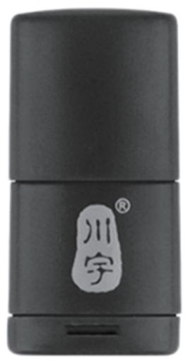

3 Card Reader 1

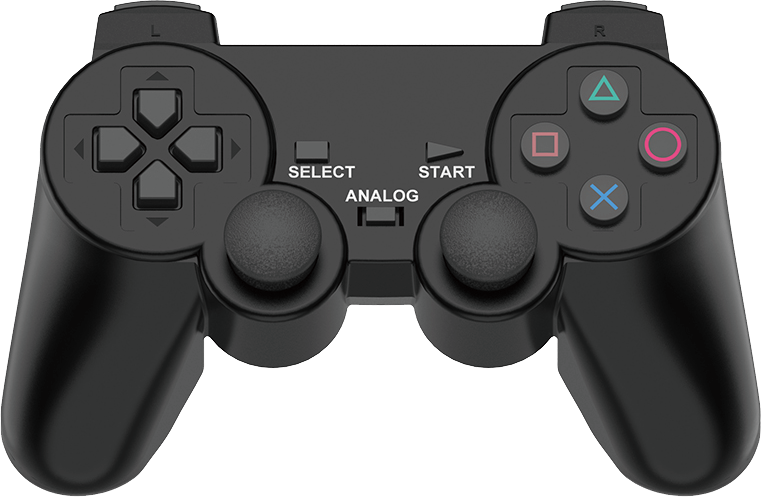

4 Wireless handle 1

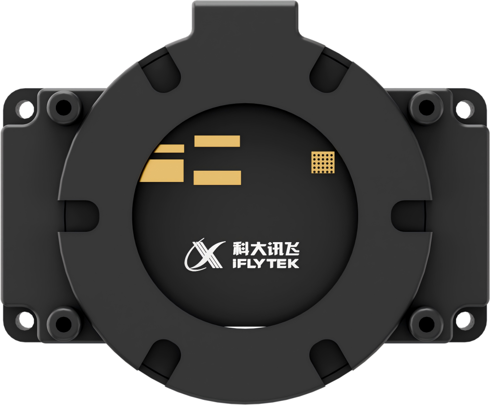

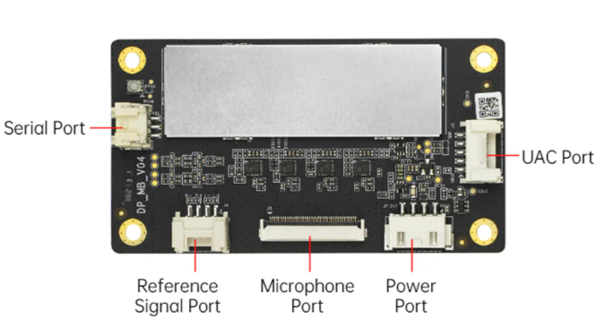

13 Circular 6-Microphone Array 1

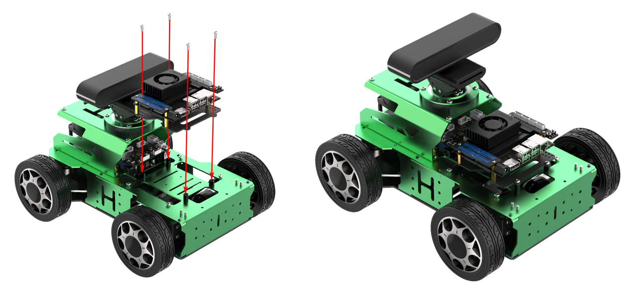

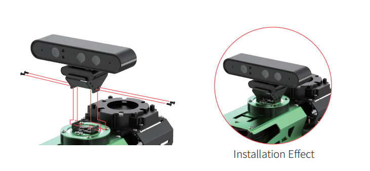

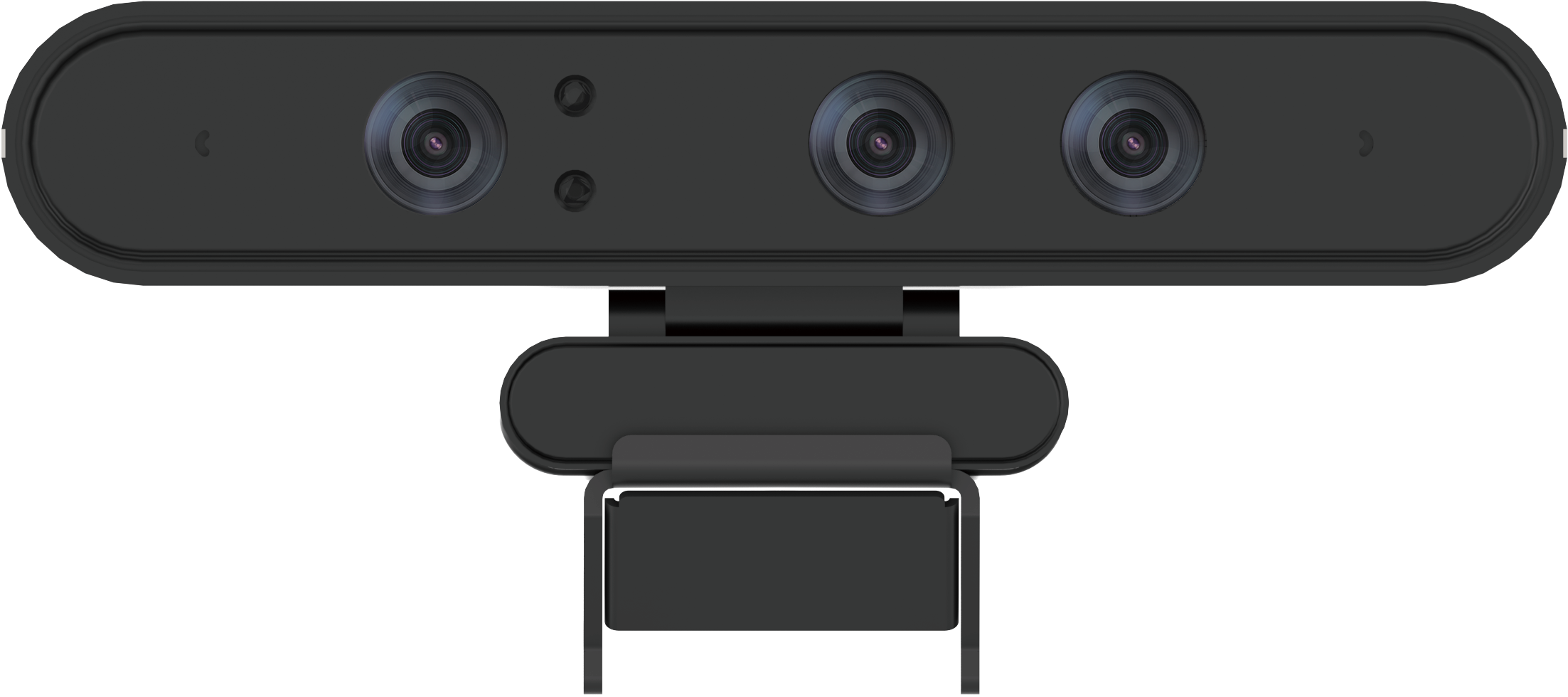

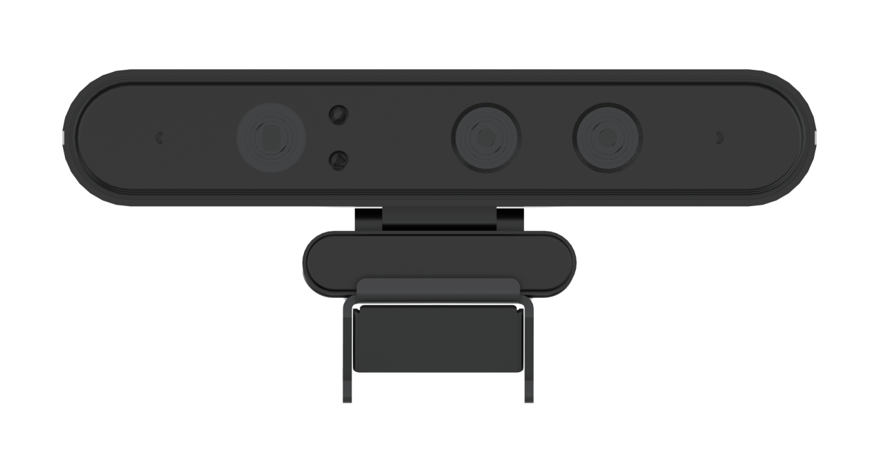

1.2.1 Install Depth Camera
Align camera bracket’s holes with those on 3D depth camera. Then secure these two components together with M3*6 flat-head machine screw.
The lens is facing the front of robot.

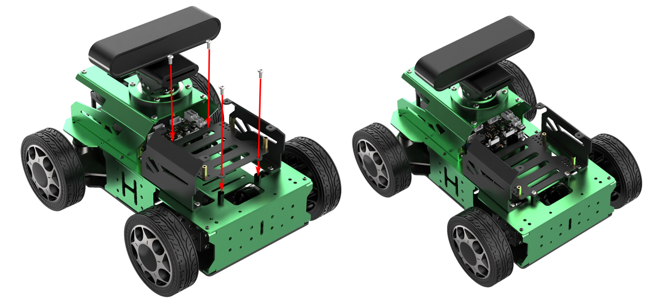

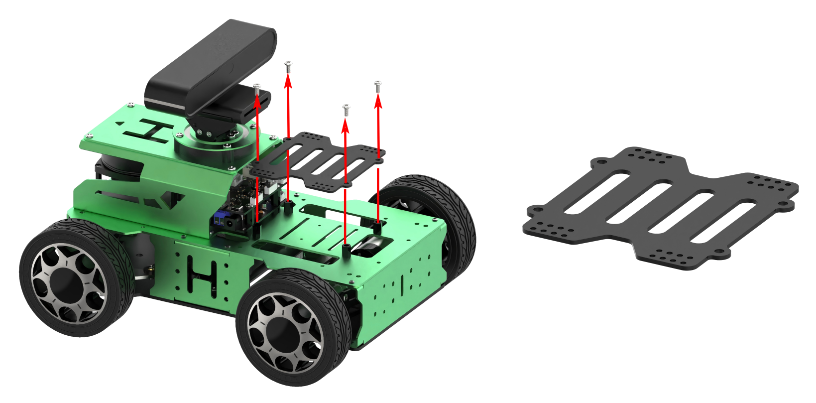

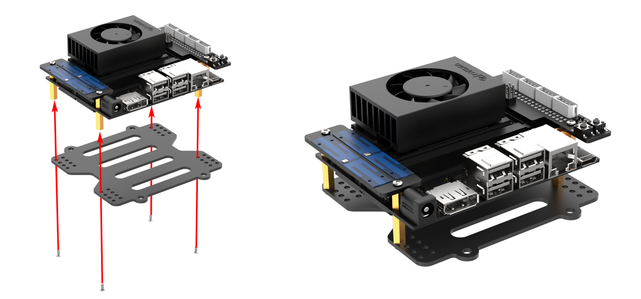

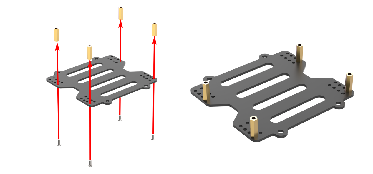

1.2.2 Install Control Board (Applicable to the robot version without Controller)

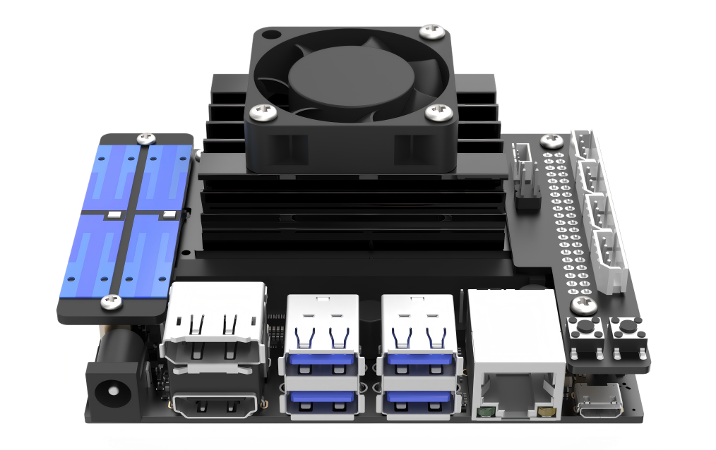

  • Jetson Nano Control Board
(1) Fix the main control board with M2.5 * 8+6 single-pass copper columns and M2.5 * 12 double-pass copper columns, then attach the antennas and expansion board to the main control board with M2.5 * 6 round head machine screws.
(2) Use a screwdriver to remove four M4 * 6 round head screws on the main control board adapter plate, as shown on the right figure below.
(3) control adapter plate, as shown on the right figure below.
(4) Attach the main control board to the adapter plate with M2.5 * 6 round head screws.
(5) Use the M4 * 6 round head screws removed in step 2) to secure the adapter plate to the single-pass nylon columns.

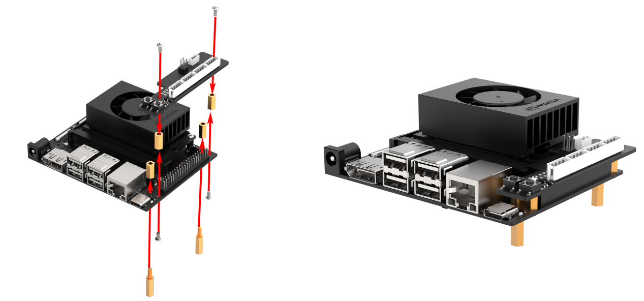

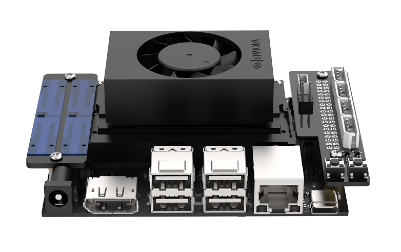

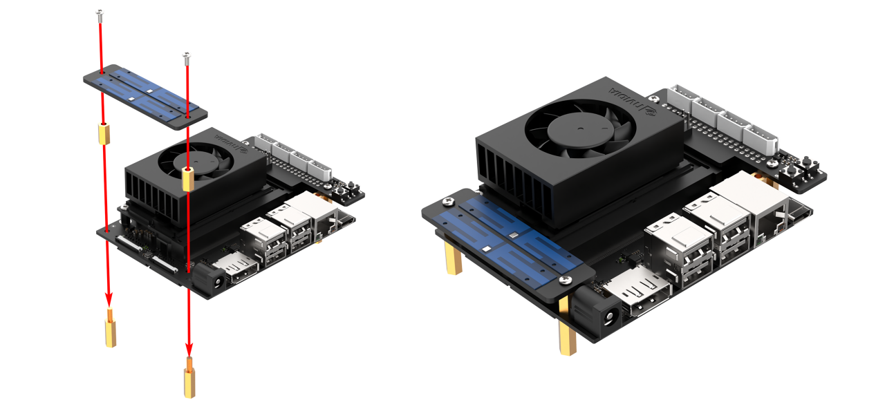

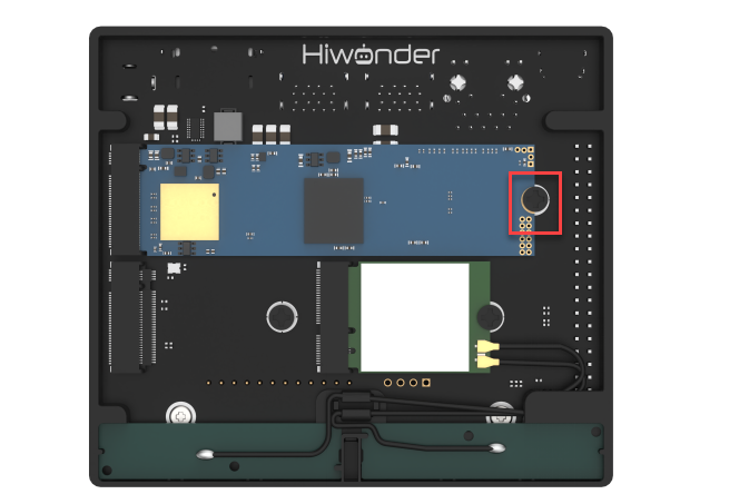

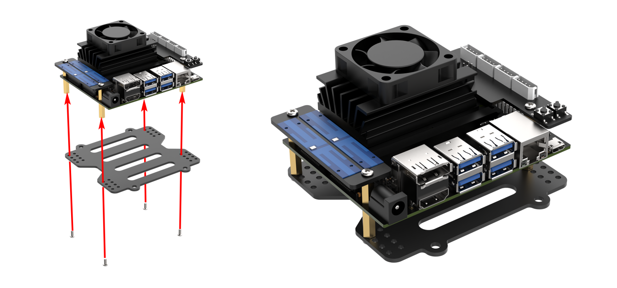

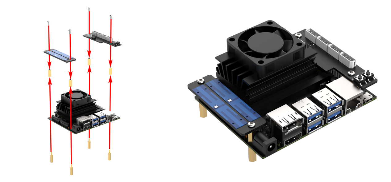

  • Jetson Orin Nano/Jetson Orin NX Control Board
(1) Attach the expansion board onto the main control board using M2.5 * 8+6 single-pass copper columns, M2.5 * 12 double-pass copper column and M2.5 * 6 round head screws.
(2) Secure the antennas with M2.5 * 8+6 single-pass copper columns, M2.5 * 12 double-pass copper columns and M2.5 * 6 round head screws.
(3) Use a screwdriver to remove the four M4 * 6 round head screws on the adapter plate.
(5) Use the M4 * 6 round head screws removed in step 3) to secure the adapter plate to the single-pass nylon columns.

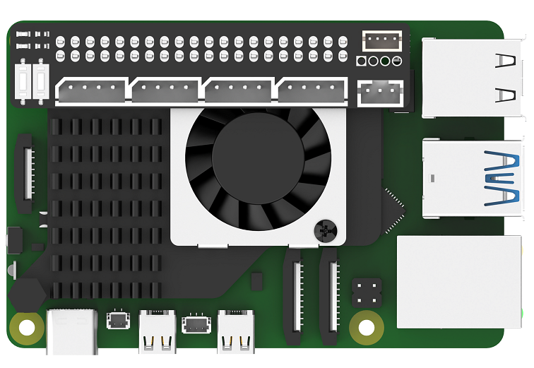

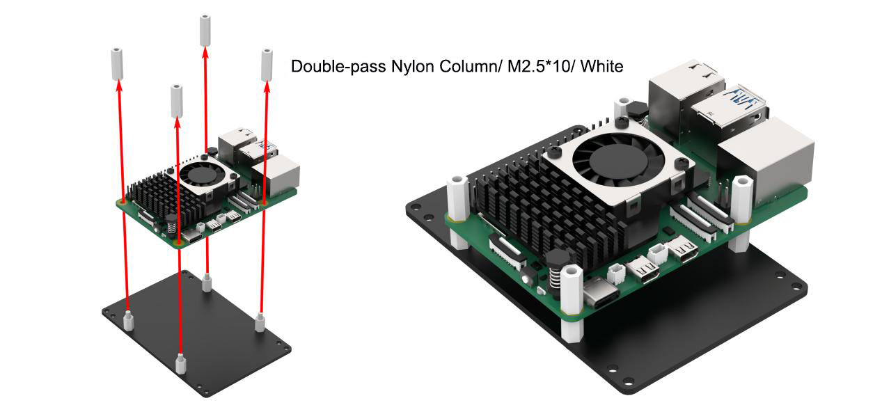

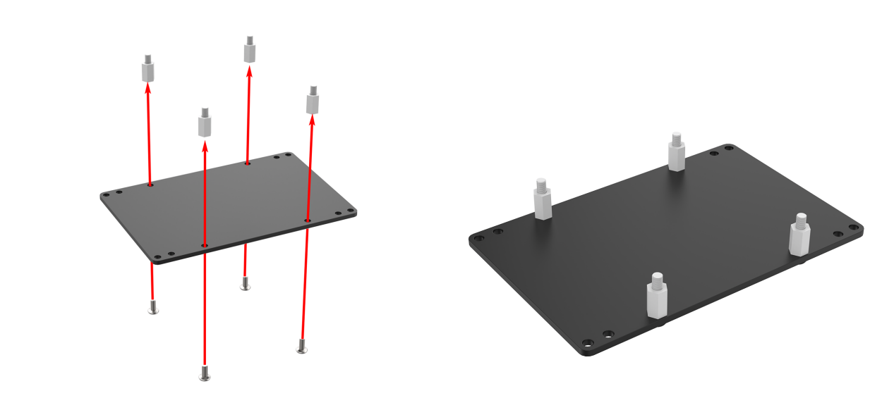

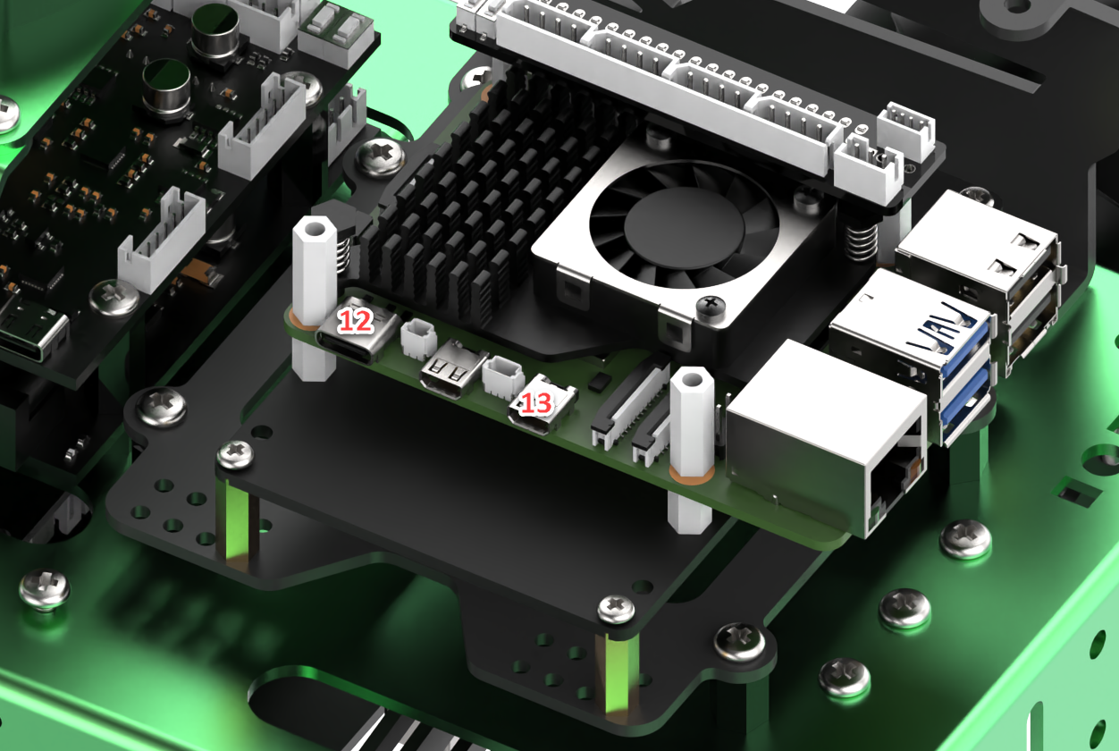

  • Raspberry Pi5 Control Board
(1) Use a screwdriver to remove the four M4 * 6 round head screws on the adapter plate.
(2) Mount the M2.5 * 12 double-pass copper columns on the adapter plate with M2.5 * 6 round head screws.
(3) Use the M4 * 6 round head screws removed in step 1) to secure the adapter plate to the single-pass nylon columns.
(4) Secure the four M2.5 * 5+6 singe-pass nylon columns to the adapter plate suing M2.5 * 6 round head screws.
(5) Press down firmly on the push-type screw of the heat sink to mount it on the main board.
(6) Attach the main board to the adapter plate using double-pass nylon columns.
(7) Insert the expansion board into the pins of Raspberry Pi 5.
(8) Attach the adapter plate to the robot with M2.5 * 6 round head screws.

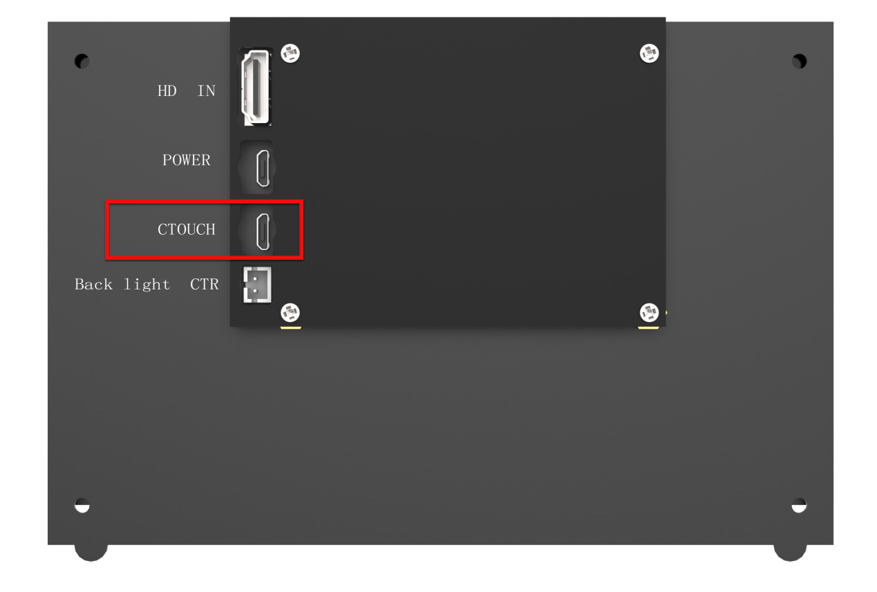

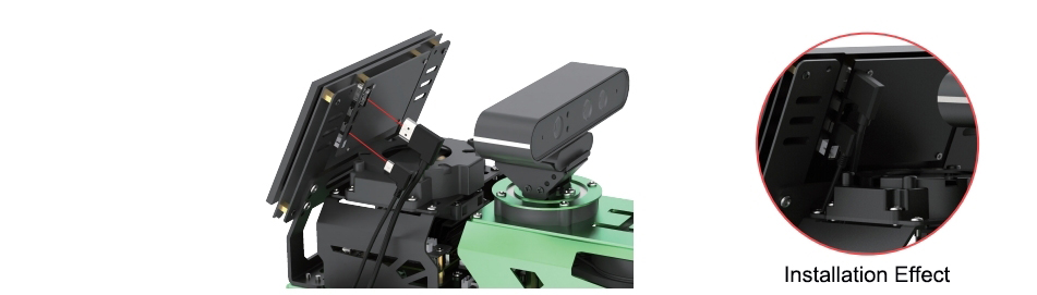

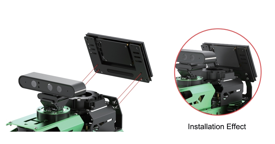

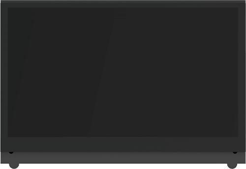

1.2.3 Install 7-inch LCD Screen
(1) Install 7-inch LCD screen to columns with M4 * 20 round machine screws.
(2) Connect HDMI cable to HDMI interface on the 7-inch LCD screen, and connect power cable to CTOUCH port.
7-inch LCD screen doesn’t support touch control if the cable is not connected to CTOUCH port.

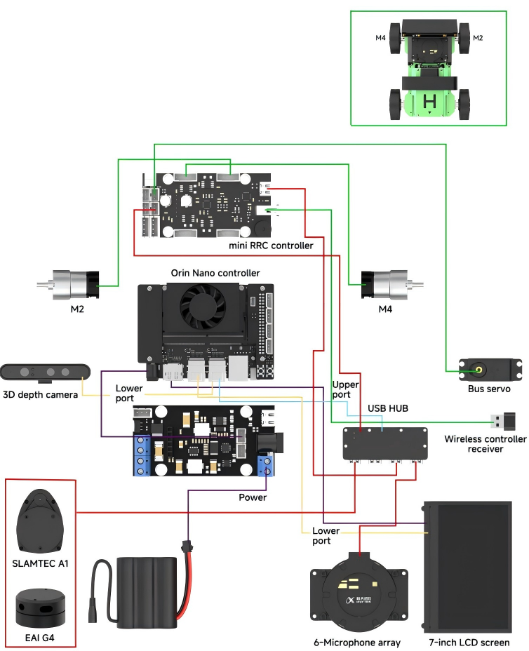

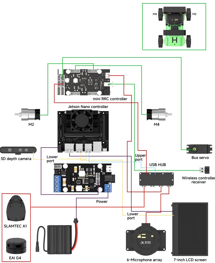

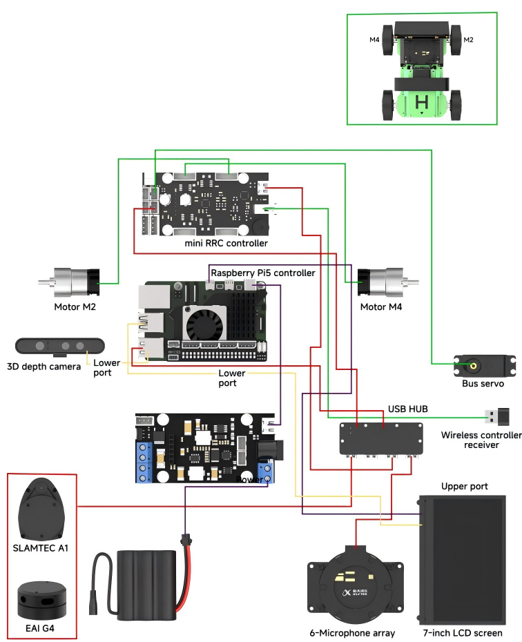

1.2.4 Wiring Instructions (Key Points)
Upon receiving the robot, it is necessary to follow the wiring tutorials below to connect the control board. Each accessory must be properly connected its corresponding port; otherwise, the robot’s functions will not work properly.

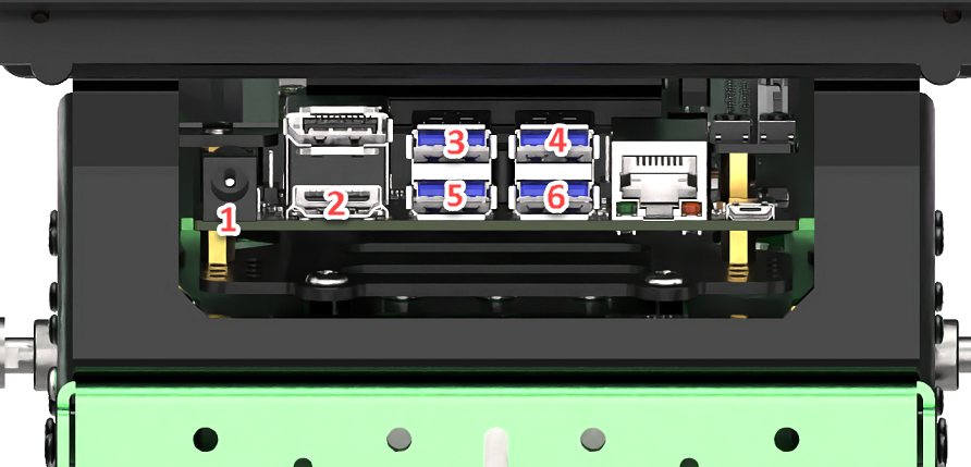

  • Wiring Instructions(Jetson Nano Controller)
Please refer to the table below and connect each accessory to its corresponding port on Jetson Nano board. If any of the listed accessories are not included in your kit, please ignore the corresponding port number.
NO. Name
1 Jetson Nano Main Controller Power Supply Interface (DC round head cable)
2 Display HDMI Interface
3 Reserved Custom Expansion Interface
4 USB Hub Communication Interface
5 Display Power Supply Interface
6 Depth Camera Interface

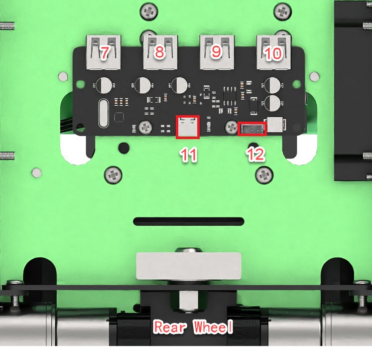

  • USB HUB
NO. Name
7 Lidar port
8 Speaker port
9 Communication port of Mini STM32 controller
10 Microphone array port
11 Jetson Nano communication port (connected to port 4)
12 USB HUB power supply port (supplied by mini STM32 controller)
  • Wiring Instructions(Jetson Orin Nano/Jetson Orin NX Control Board)
Please refer to the table below and connect each accessory to its corresponding port on Jetson Orin Nano board and USB hub. If any of the listed accessories are not included in your kit, please ignore the corresponding port number.
NO. Name
1 Jetson Orin Nano/ Jetson Orin NX Main Controller Power Supply Interface (DC round head cable)
2 Display HDMI (convert to DP) Interface
NO. Name
7 Lidar port
8 Speaker port
11 Jetson Orin Nano communication port (connected to port 4)
12 USB HUB power supply port (powered by mini STM32 controller)

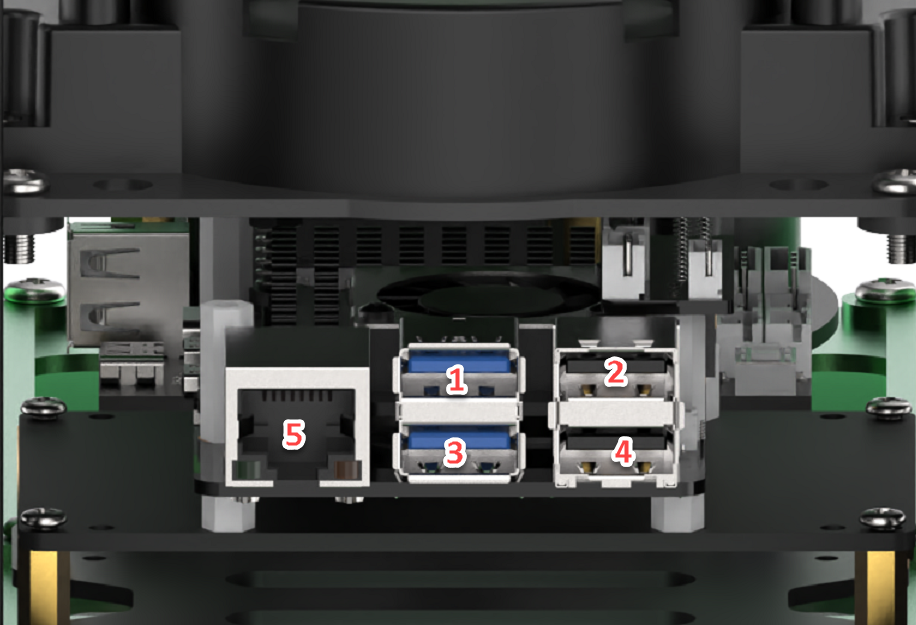

  • Wiring Instructions(Raspberry Pi 5 Control Board)
Please refer to the table below and connect each accessory to its corresponding port on Raspberry Pi 5 board and USB hub. If any of the listed accessories are not included in your kit, please ignore the corresponding port number.
NO. Name
1 Reserved Custom Expansion Interface
2 USB Hub Communication Interface
3 Display Power Supply Interface
4 Depth Camera Interface
5 Ethernet Interface
NO. Name
6 Lidar port
7 Speaker port
8 Communication port of mini STM32 controller
9 Microphone array port
10 Raspberry Pi 5 communication port (connected to port 2)
11 USB HUB power supply port (supplied by mini STM32 controller)
NO. Name
12 Power supply for ROS main controller (Raspberry Pi)
13 Micro HDMI interface (connect to the HDMI interface of the 7-inch LCD display)

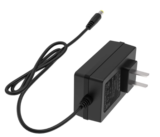

1.3.1 Charging Instructions

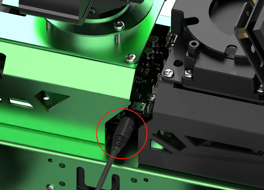

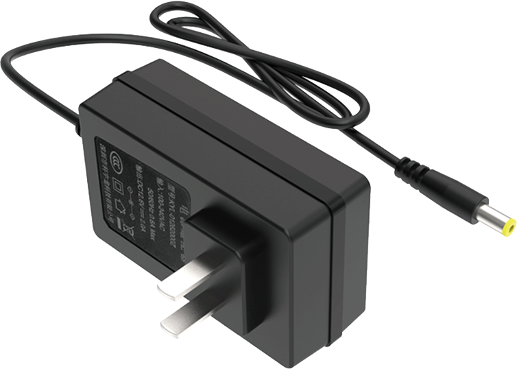

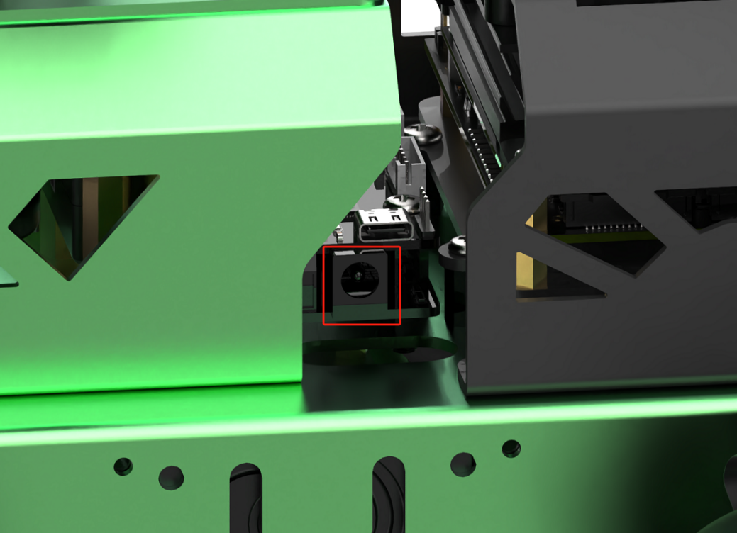

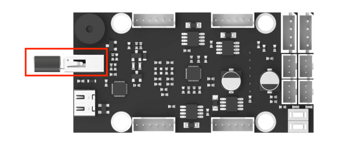

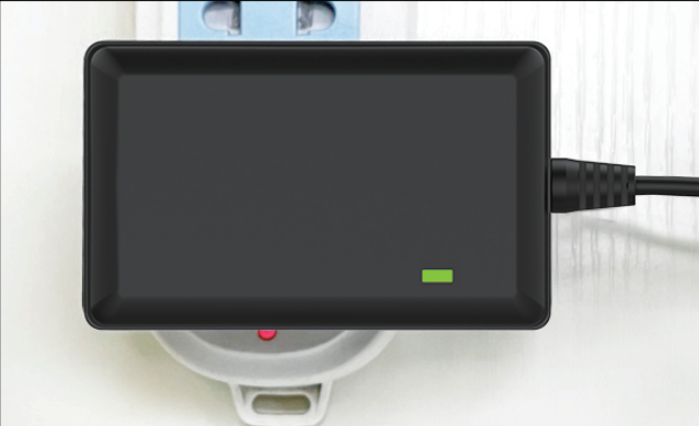

(1) Charge battery with the provided charger. Turn off the switch on the power supply board and never use it while charging
(2) Indicator on charger changes green when it connects to battery but not plugged into a power outlet. Indicator turns red
(3) Do not directly connect the charger to DC power port of Jetson Nano board, otherwise the board will be burned.
(4) Unplug charger in time to avoid overcharging.
(5) If battery voltage drops below 10V, the buzzer will sound an alarm. Please charge the battery promptly.
(6) In case robot won’t be used in a long period of time, please fully charge battery first, then disconnect battery wires.
(7) Always keep battery in cool and dry environment, otherwise battery lifespan gets shortened. Never intentionally hit, throw or step on your Lipo battery.
(8) Avoid using the battery in environments with strong static electricity or a strong magnetic field, as this may damage the safety protection device of the battery.
(9) Do not plug the battery into a power outlet, and do not use metal objects to connect the positive and negative poles of the battery.
(10) If robot won’t be used in a long period of time, please fully charge battery.
(11) It is strictly prohibited to modify, weld, or convert battery charger or Lipo battery.
(12) Keep battery away from high temperature and liquid to prevent overheating, fire and damp, which result in function decline.
Warning tip: please strictly follow the guide. Our company is not responsible for any product damage, economic losses and accident caused by improper use.
1.3.2 Charging Operation
(1) Make sure the switch is in the closed position.
(2) Connect the battery wires ensuring that each wire matches its corresponding color.
(3) Connect the special charger to DC port of the power supply board.
(4) Red indicator means robot is being charged. It will turn green after robot is fully charged. It takes about 4 hours to fully charge the battery.
Please unplug the charger in time once battery is fully charged to avoid overcharging

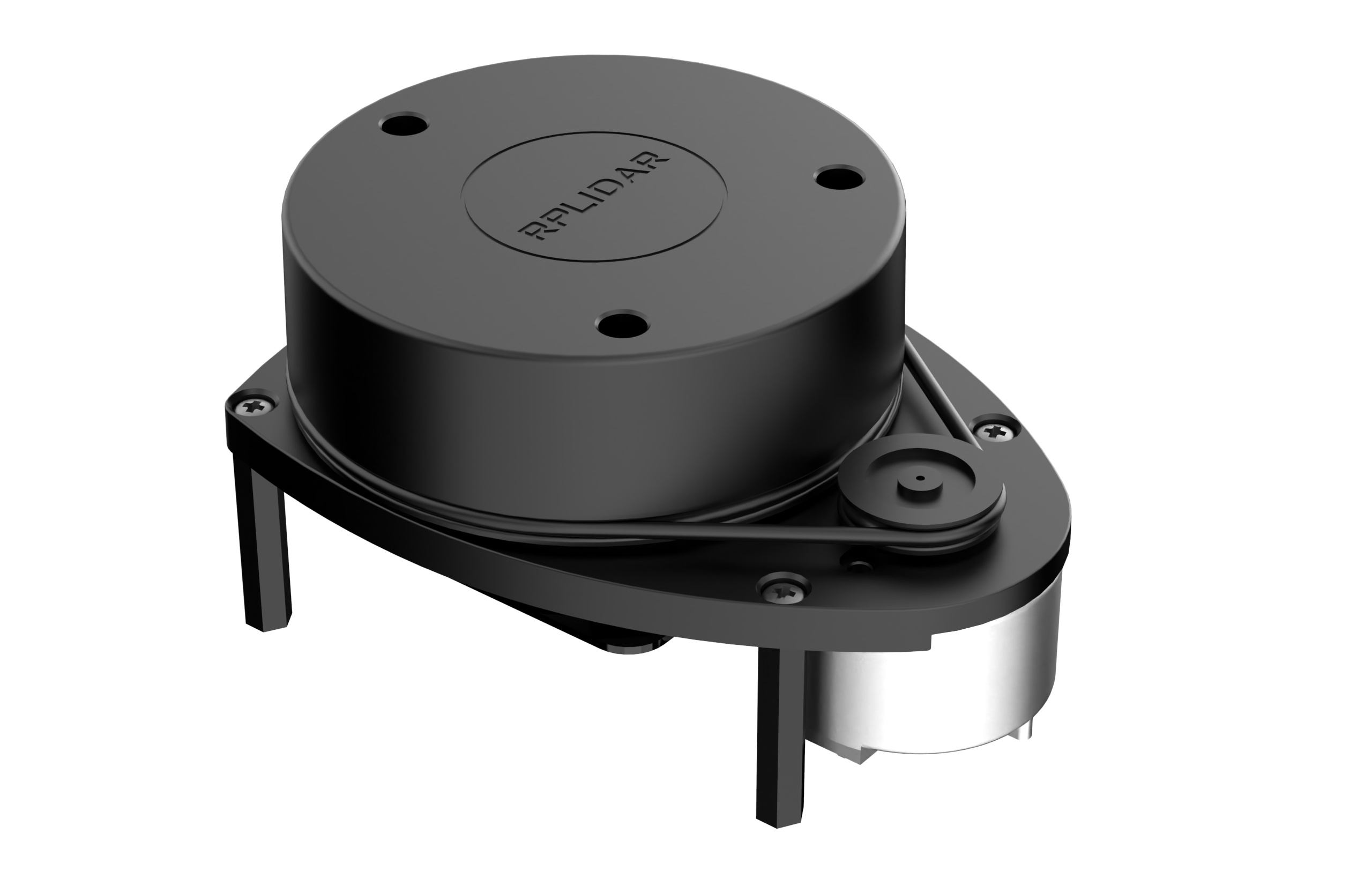

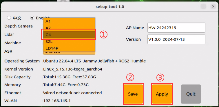

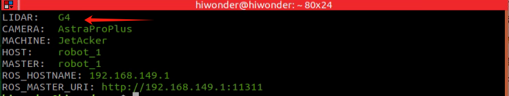

(7) In terms of Lidar, different Lidar models also have different performances when starting up. The left image below is A1 Lidar and the right is the G4 Lidar:

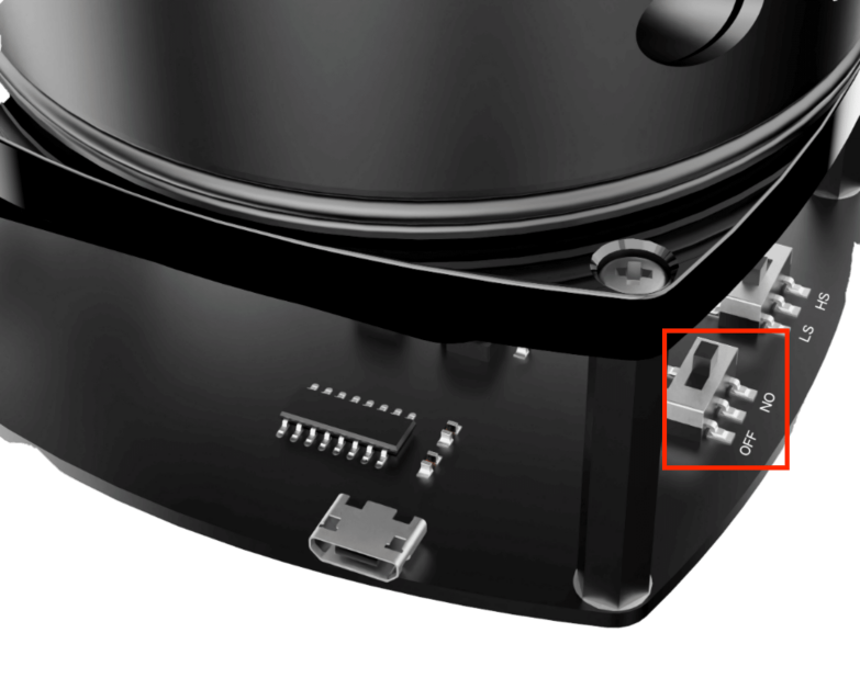

If you choose the ultimate kit with Lidar G4, the Lidar will spin for a few round, then stop until the robot boots up successfully.
For other robot kits with Lidar A1, you need to push the switch to the “ON” side. The Lidar will continue to rotating after a short period of time after being turned on.

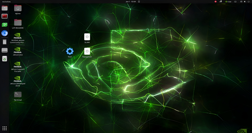

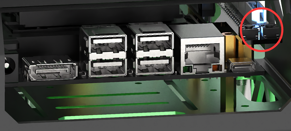

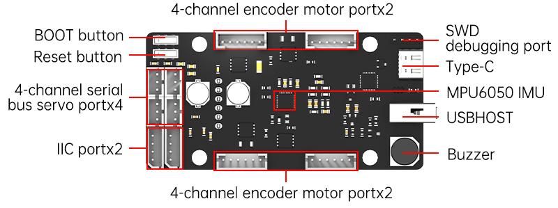

(2) The LED1 on expansion board flashes blue. When buzzer emits a beep, this means both ROS configuration and device are ready for use.
  • The LED indicator for Jetson Nano and Jetson Orin Nano versions is as pictured:
  • The LED indicator for Raspberry Pi5 version is as pictured:

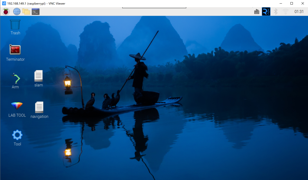

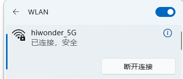

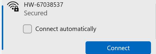

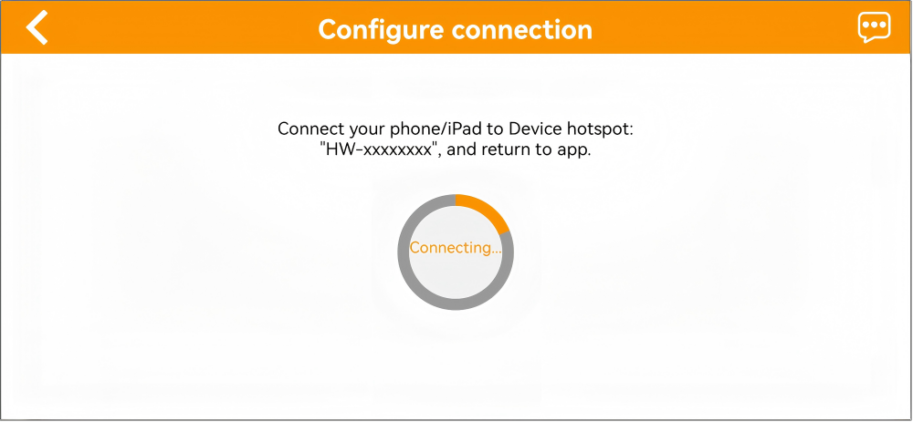

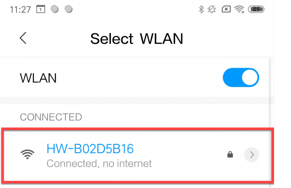

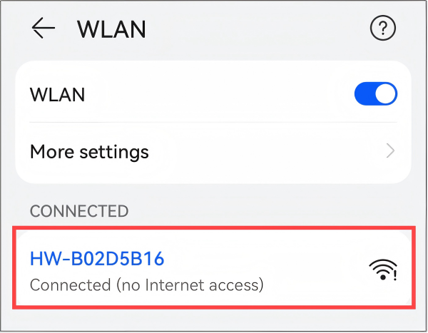

(3) After robot boots up successfully, robot is default to AP direct connection mode and generates a WiFi starting with “HW”. The initial WiFi password is “hiwonder”.
If you can not find the generated WIFI, please troubleshoot from the following:
  • Follow above three steps in “Robot Startup State Instructions” for troubleshooting.
  • If the LED1 on expansion board is flashing blue and keeps on, it may be set to LAN mode. In this case, please press and hold the Key1 button for 5-10 seconds. If LED1 starts flashing, indicating that a WI-Fi starting with “HW” is generate

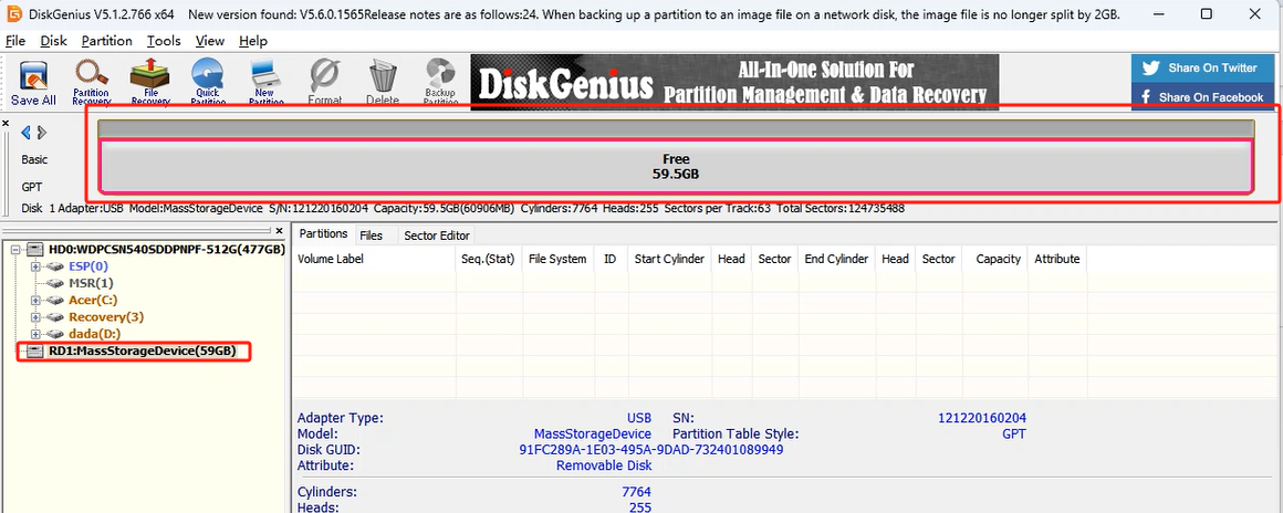

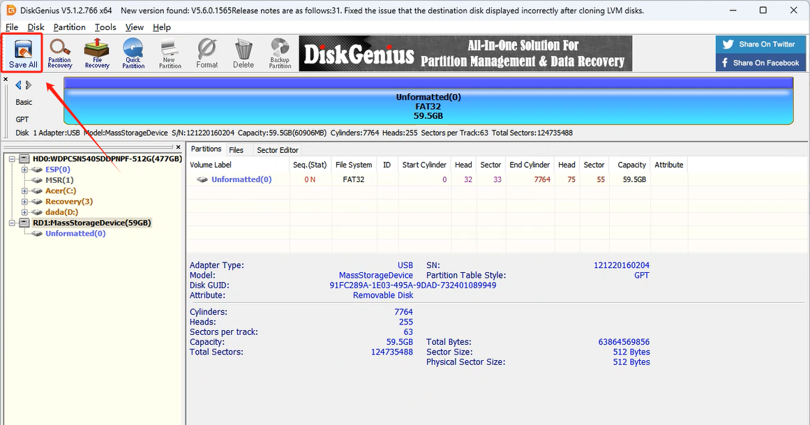

  • If the KEY1 button doesn’t start flashing after the above operation, SD card or SSD may not be detected, try re-inserting the SD card or SSD.
  • he LED1 on expansion board always remains on after re-inserting the SD card or SSD, it may indicate an issue with the SD card or SSD.
  • If you have completed all five steps above and the issue persists, it may lie with Raspberry Pi board or Jetson board. Please reach out to our support team via email at support@hiwonder.com for further assistance.
(4) After the 7-inch display is installed, it will display the system image after the robot starts up. If you’re the user of advanced kit or ultimate kit, you will also hear a “I’m ready” broadcast.

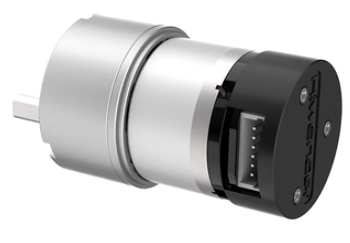

STM32 controller + DC encoder geared motor After robot powers on, perform the "Robot control" function on app using the wireless handle or mobile phone Robot is able to operate normally.

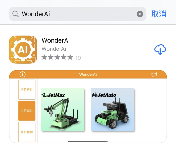

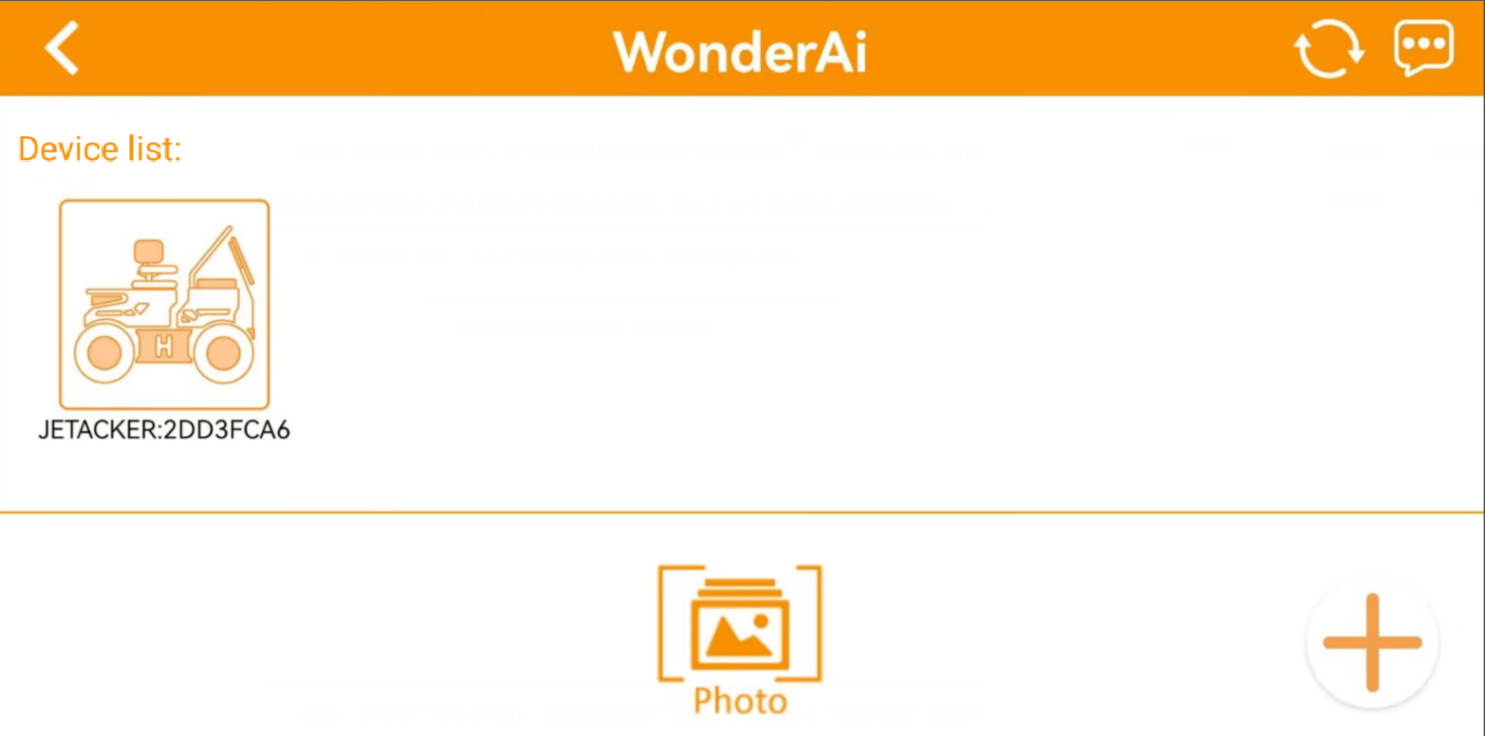

1.5 APP Control
Users can control robot using the WonderAi mobile app. This chapter will elaborate the app operations.

  • APP Installation
  • Please ensure all permissions are granted for the APP, otherwise certain app functions may be affected or unavailable.
  • Turn on location and Wi-Fi before using the APP.
(1) APP Installation Pack (Android): WonderAi
(2) APP Installation Pack (iOS): WonderAi

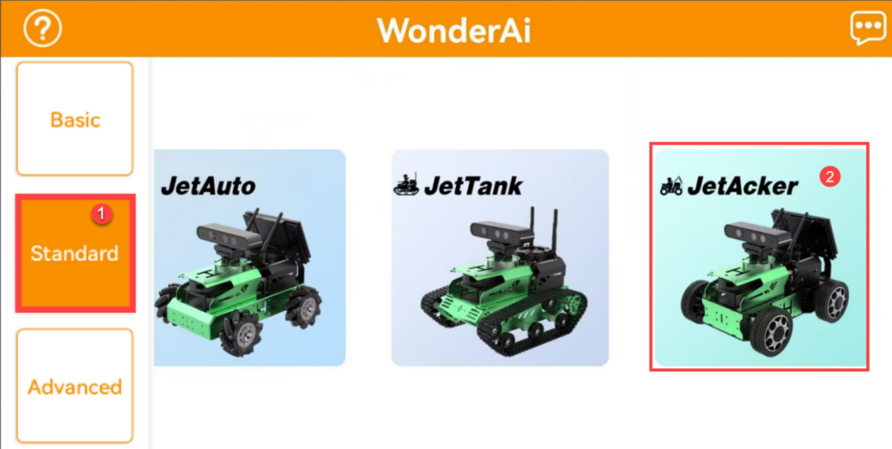

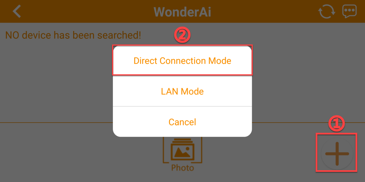

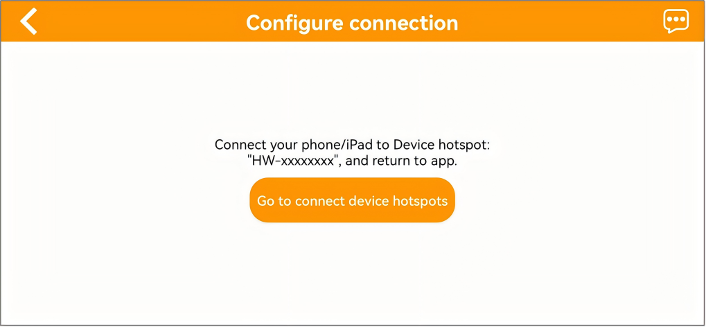

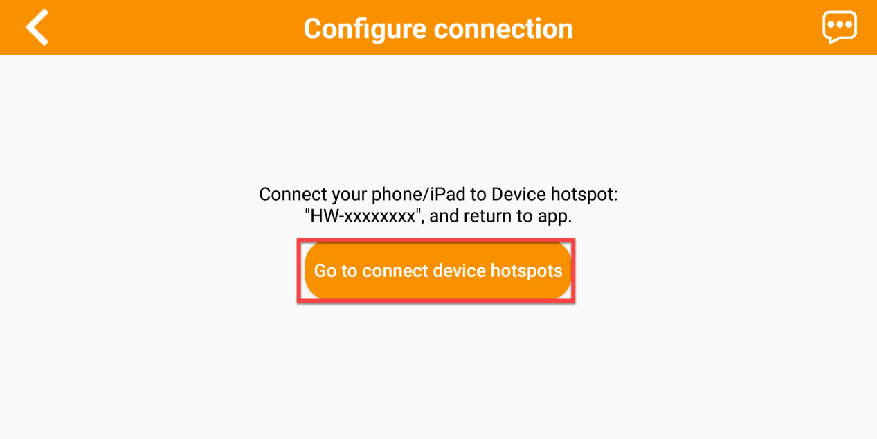

(1) Open “WonderAi” APP, then tap “Advanced->JetAcker” in sequence
(2) Click “+” button, and select “Direct Connection Mode”.
(3) Next, click “Go to connect device hotspots” to join the WiFi generated by JetAcker.
(4) The device WiFi starts with “HW” and the password is “hiwonder”.
For iOS user, please do not return back to the APP until the WiFi icon appears above, otherwise JetAuto cannot be searched. If JetAcker cannot be searched, please click to refresh.
(5) Return to the APP, and click the robotic icon to enter home interface.
If you are informed of “No Internet Connection. Whether to keep connection”, just select “Keep Connection”.
(6) When the following window pops up, it means that you have selected the wrong version. Click “Confirm”, then the APP will automatically switch to the home interface of the right version.
(7) The mode selection interface is as pictured:

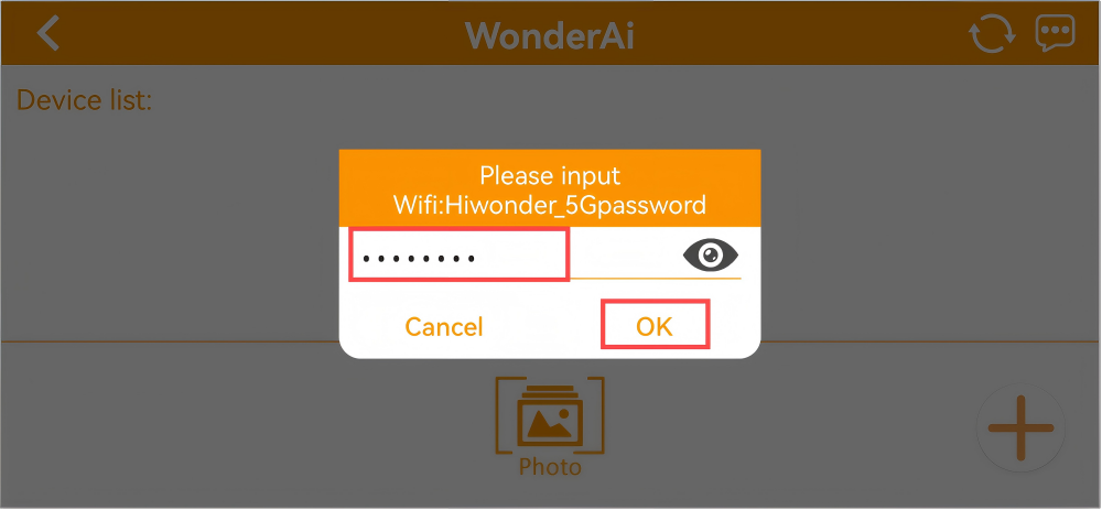

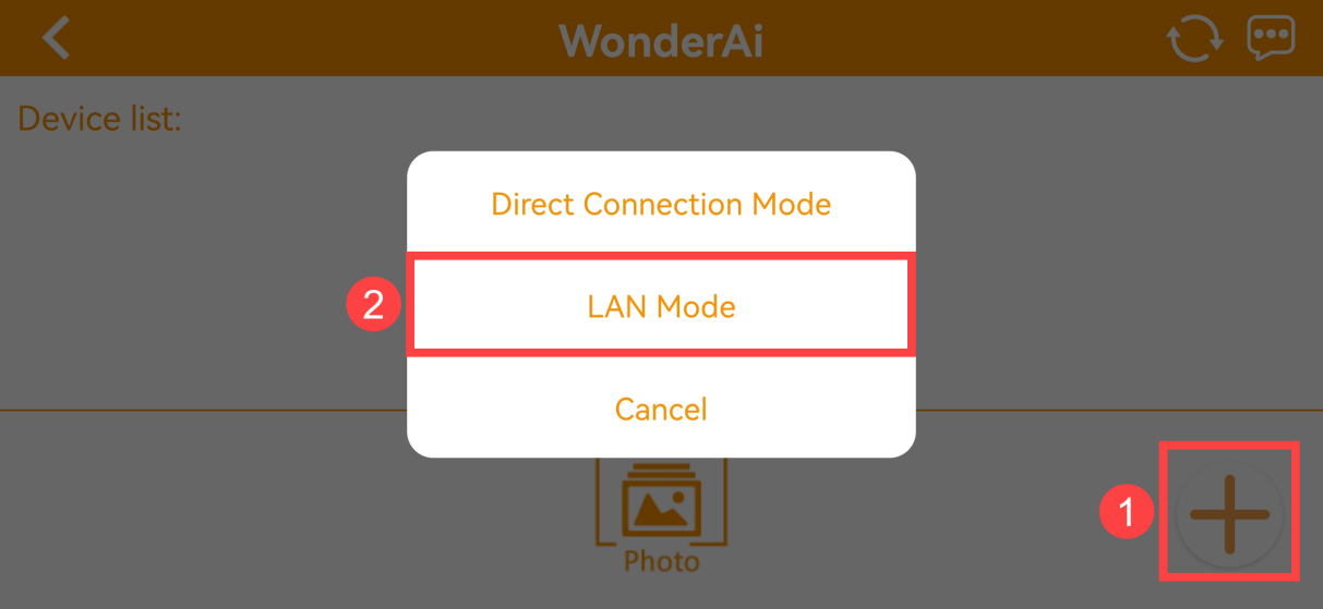

  • LAN Mode Connection (Optional)
(1) Firstly, join 5G network, for example “Hiwonder_5G”. (The router supporting dual-frequency will distinguish the Wi-Fi name by default under the situation that 2.4 G and 5G are separated. For example, Wi-Fi “Hiwonder” is 2.4 frequency band while “Hiwonder_5G” is 5G frequency band)
Open WonderAi, then click “Advanced->JetAcker” in sequence.
(2) Click “+” button at the lower right corner, then select LAN Mode.
(3) Continue, enter the Wi-Fi password. Having entered the password, click “OK”. Please ensure the password you enter is correct.
(4) Click “Go to connect device hotspots”.
(5) Join the WiFi starting with HW, and input the password “hiwonder”. After connection, return back to the APP interface.
(6) In this point, WonderAi APP is connecting to the robot.

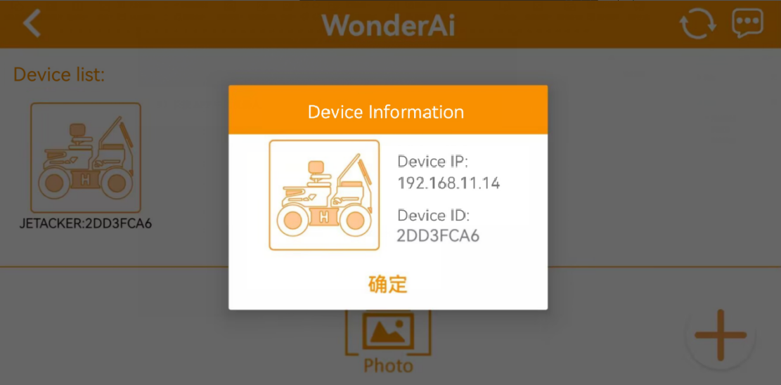

(7) After a while, the robotic icon will show up. And at the same time, LED1 on the expansion board will light up.
(8) By long pressing the robotic icon, you can check the IP address and ID.
(9) You can search for its IP address through the remote connection tool and establish a connection. For detailed instructions, please refer to “1.6 Development Environment Setup”.

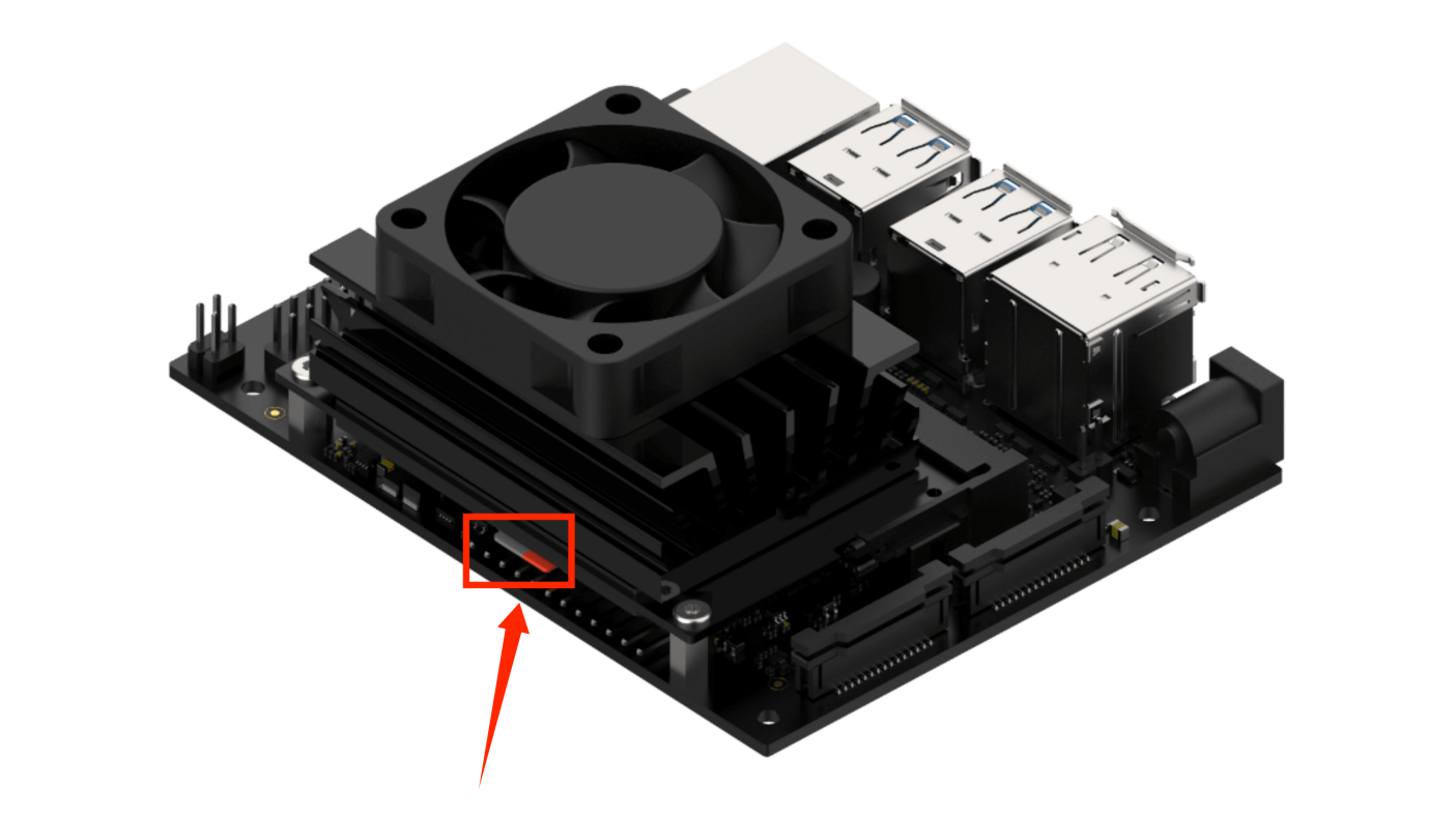

(10) To switch from LAN mode back to direct connection mode, press and hold the KEY1 button on the expansion board until the blue light flashes, indicating the switch is complete.

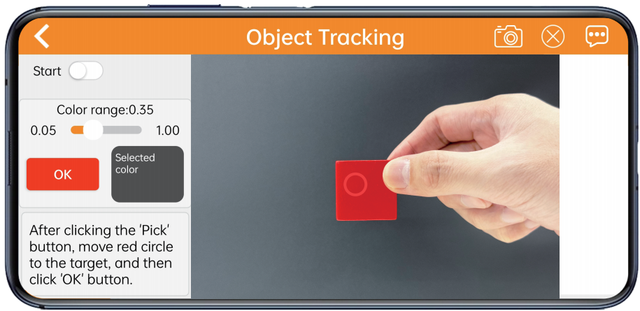

1.5.5 Target Tracking
  • Lower the camera and position both the robot and the target on the same surface. Then, move the object around to enable the robot to track it effectively.
  • Make sure there are no other obstacles within the camera’s field of view to prevent any interference with the game’s effectiveness.
(1) Click “Target Tracking” on the mode selection screen to enter the operation interface for this activity.
(2) Firstly, click “pick”, then drag the red circle on the camera returned image to the target to pick the color.
(3) Then click “ok” button. The color you pick will display at the right box.
(4) Click “Start” button. Then you can move the object, and JetAcker will move with it.

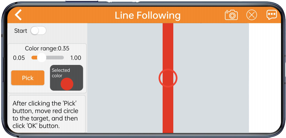

(1) Click “Line Following” on the mode selection screen to enter the operation interface for this activity.
(2) In this case, red tape will be used an example for demonstration. Click “pick color”, then drag the red circle on the camera returned image to the path to pick the color.
(3) Next click “confirm” button. The color you pick will display at the right box.
(4) Lastly, click “Start” button, then the robot will move along the path.

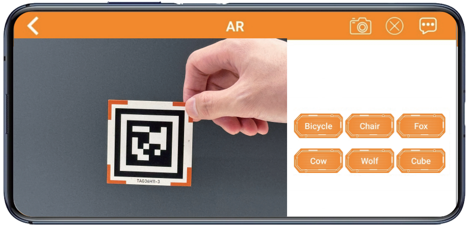

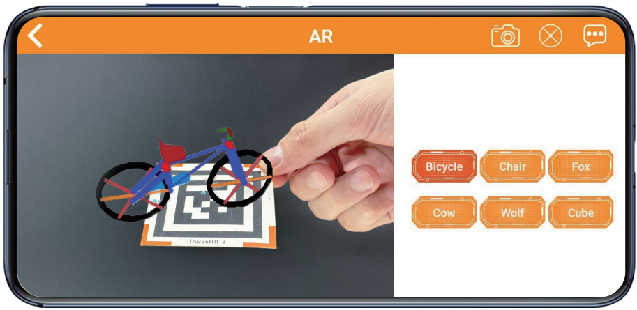

1.5.7 AR
Click “AR” on the mode selection screen to enter the operation interface for this activity. Place the tag within the field of view, and click the 3D pattern you want, for example “bicycle”. Then the 3D bicycle will be overlaid on the April Tag.

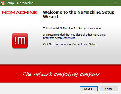

  • NoMachine Installation
This tool is applicable to Jetson controller versions.

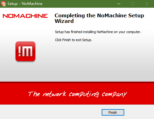

(1) Enter the same directory as this document to open the installation package nomachine_8.4.2_10_x64.
(2) Click “Next”.
(3) Then click “I accept the agreement” in the prompt box, and set the “Language” as “English”, then click “Next”.
(4) Remain the default installation path. Click “Next”.
(5) Click “Yes” to restart the computer (Please do not skip this step).

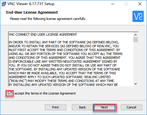

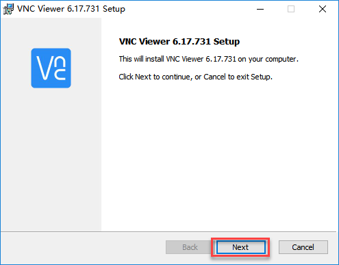

  • VNC Installation
This tool is applicable to Raspberry Pi 5 version.
(1) Enter the same directory as this document to open the installation package VNC-Viewer-6.17.731-Windows . In the pop-up dialog box, select ‘English’ as the installation language and click the ‘OK’ button.
(2) Click “Next”.
(3) Then click “I accept the agreement” in the prompt box, and continue.
(4) Click “Install”.
(5) Click “Finish” to complete the installation.
(6) Once VNC is connected, simply click-on to access it.

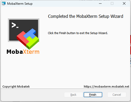

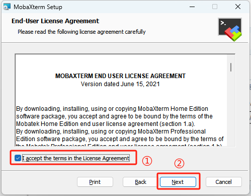

  • MobaXterm Installation
This tool is applicable to any robot version.
(1) Locate the MobaXterm installation package .
(2) Click “Next”.
(3) Then click “I accept the agreement” in the prompt box, and click “Next”.
(4) Keep the default installation position,and click “Next”.
(5) Click “Install”.

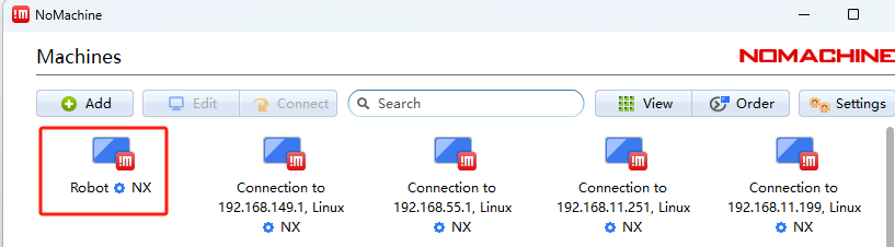

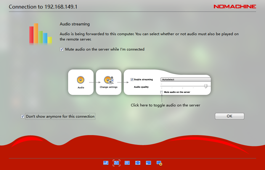

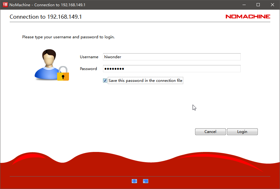

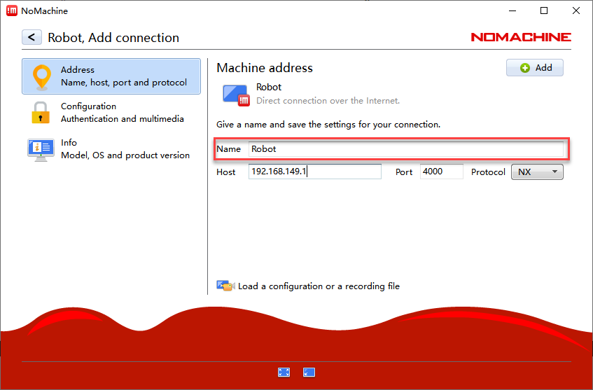

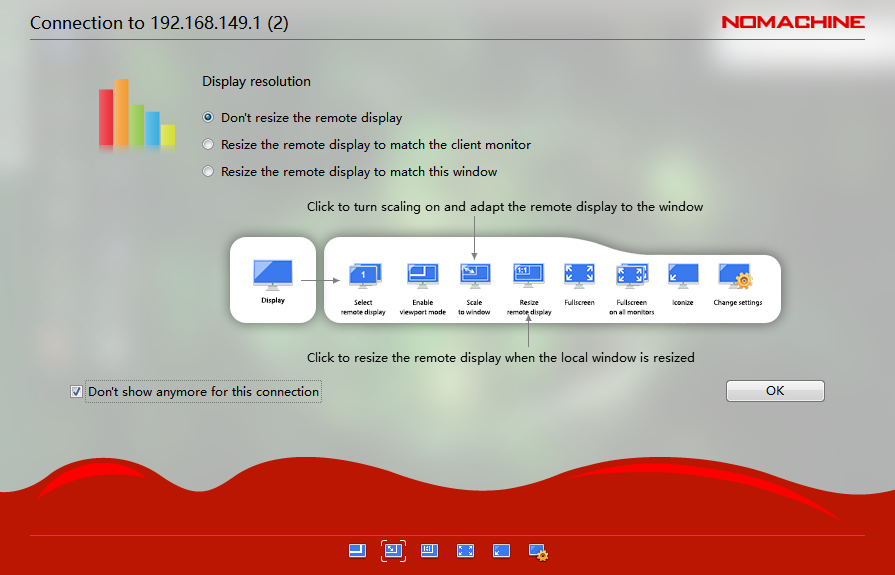

  • Establish Connection via NoMachine
(1) The robot is set to AP direct connection mode by default. After booting up successfully, it will create a hotspot starting with “HW”. As the picture shown below, the connection password is “hiwonder”.
(2) Open NoMachine, input the IP address “192.168.149.1” in the search bar in AP mode, and click “Configure connection to new host 192.168.149.1”.
(3) After opening, follow these steps: click on Address -> Name, enter “robot” -> Host, enter “192.168.149.1” -> click Add.
(4) Fill in the provided username and password based on the control board version:
  • Initial configuration for Jetson Nano board:
username: hiwonder, password:hiwonder
  • Initial configuration for Jetson Orin Nano board:
username: ubuntu, password:ubuntu
  • Initial configuration for Jetson Orin NX board:
username: ubuntu, password: ubuntu
(5) Check the “Save this password” box, then click the Login button. Below will take “Jetson Nano” version as an example:

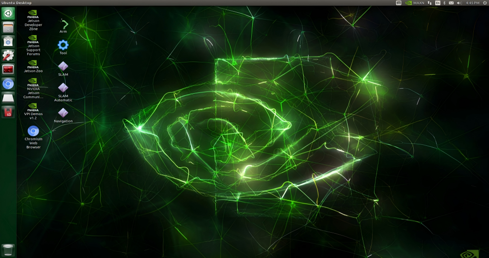

(6) Afterwards, you will see the remote desktop of the Jetson Nano open up.
  • Establish Connection via VNC
(1) Search for and connect to the hotspot starting with “HW”, as shown in the following figure. The password for the connection is hiwonder.

(4) Once connected, the Raspberry Pi’s remote desktop will appear as shown in the image below.

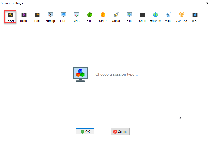

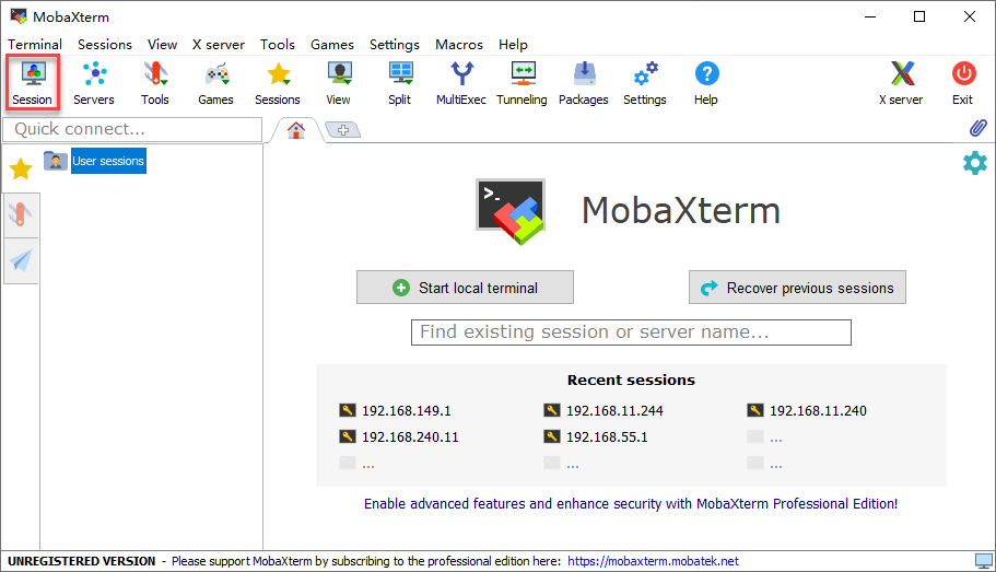

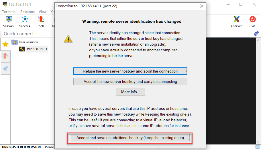

  • Establish Connection via MobaXterm
This section takes “AP Direct Connection” as an example to illustrate. The same operation method is applicable to LAN mode. You just need to change the IP address.

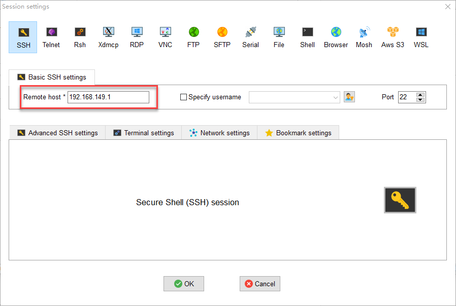

(1) In the main interface, click “Session” on the top right corner to create a session. In the session interface, enter the recorded Raspberry Pi 5 IP address “192.168.149.1”, and then click “OK”.
(2) Choose SSH.
(3) Enter the fixed IP address in AP direction connection mode:
192.168.149.1
(4) As pictured, you need to select the third option.
(5) The interface will prompt users to enter the login as and password. It is necessary to fill in the username and password based on the control board version (Below will take Jetson Nano version as an example):
  • Initial configuration for Raspberry Pi 5 board:
username: pi, password: raspberrypi
  • The username must be entered in lowercase mode. Even if the username includes uppercase letters during setup, it must be entered in lowercase when logging in.
  • The username will be visually displayed. After entering it, press Enter to proceed to the password input.
  • The password will not be visually displayed. After entering the password, press Enter to log in.
(6) When the input password is correct, you will get access to the system. The system interface is as pictured:

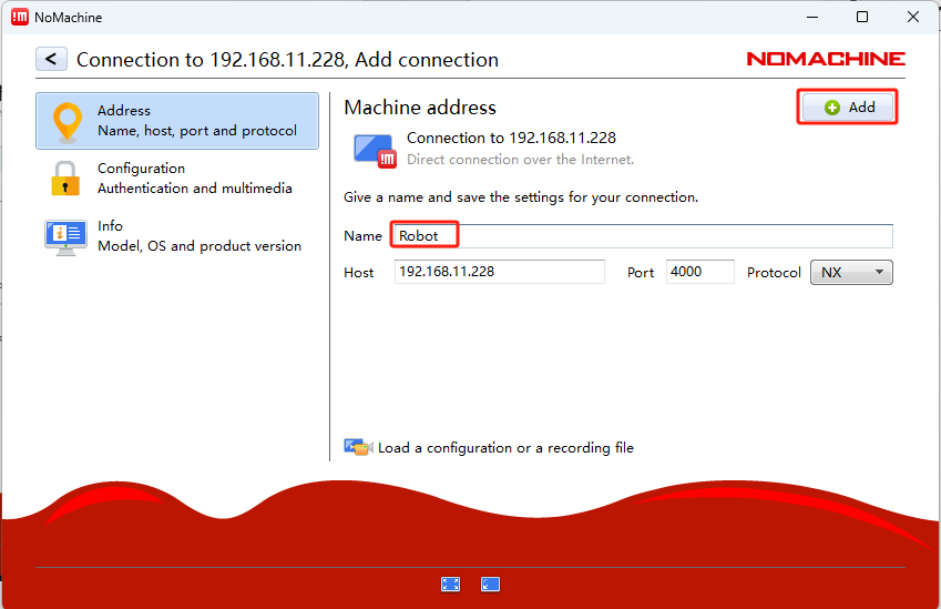

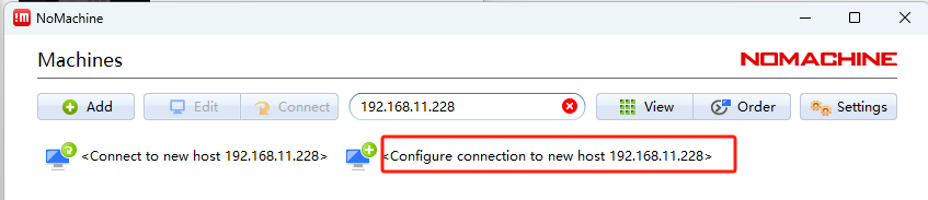

  • Establish Connection via Nomachine
(1) In LAN mode, search for and connect to the Wi-Fi you have set up on the computer, as shown in the image below.
(2) Open NoMachine, input the IP address “192.168.11.228” in the search bar in AP mode, and click “Configure connection to new host 192.168.11.228”.
If you are unsure the IP address, please refer to1.5.1 Preparation/LAN Mode Connection (Optional) .
(3) After opening NoMachine, change Name to “Robot” and click “Add”.
(4) Then double the name “Robot”.
(5) Fill in the provided username and password based on the control board version:
(6) Check the “Save this password” box, then click the Login button.
(7) Afterwards, you will see the remote desktop of the Jetson Nano open up.

(8) First, connect your phone to the 5G network. In this case, we will use the “Hiwonder_5G” Wi-Fi as an example.
(9) Open “WonderAi”. Choose “Advanced-> JetAcker” in sequence.
(10) Wait for a moment. The main interface will display the corresponding robot icon and name.
(11) Long and hold the robot icon in app to view the IP address and device ID assigned to the robot.
(12) Enter the obtained IP address into NoMachine to establish a remote connection. For detailed instructions, please refer to the tutorial 1.6.2 AP Direct Connection Mode Operations
(13) To switch to direct connection mode, re-edit the configuration file, comment out all the lines, then save and restart the robot.

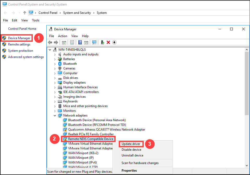

The robot can improve the remote operation smoothness through enabling remote NDIS compatible device, using the fixed IP “192.168.55.1”. This method does not require connecting to the robot’s hotspot or WiFi in the local network. The specific operation steps are as follows:

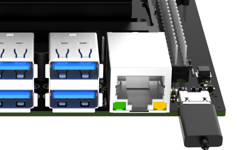

(1) Connect the Jetson Nano board to your computer using Micro-USB cable.
(2) For Jetson Orin Nano board, connect it to the computer using a Type-C cable.

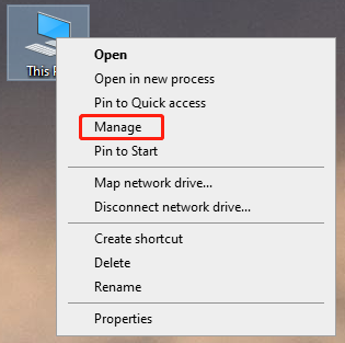

(3) Right click “This computer” to select “Manage”.
(4) Click on “Device Manager”. In the “Network Adapters” section, locate the NDIS driver. Right-click to select “Update Driver”.
(5) After the driver is installed, you need to refer to either 1.6.2 AP Direct Connection Mode Operations to log in the system. You only need to modify the address bar to “192.168.55.1”.

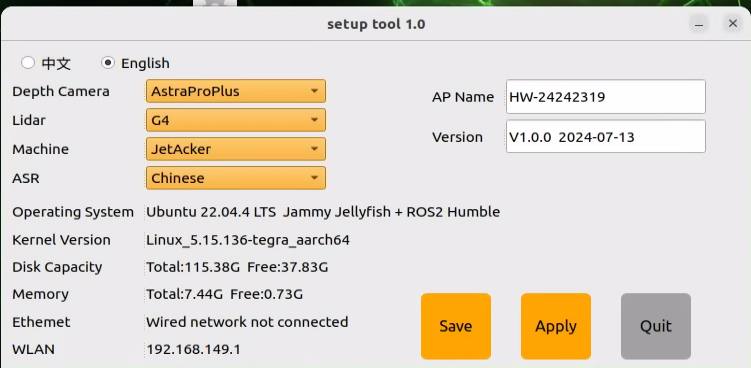

1.6.7 Robot Version Configuration Tool Instruction
This section will introduce the robot system’s built-in version configuration tool, which allows switching between different chassis configurations, Lidar types, camera models, and Chinese/English voice settings.
It is applicable to the following users:
(1) Users who have purchased a robot kit without control board.
(2) Users who have re-flashed the system image.
(3) Users who have replaced other accessories supported by the system, such as switching from a Mecanum wheel chassis to a tracked chassis.
For users who have purchased a complete robot kit with control board, they only need to be aware of the content and do not need to take action. Before learning how to use the tool, you can first confirm the system version configuration based on the control board model you purchased.
  • Tool Introduction and Usage
(1) Use the Nomachine remote desktop connection tool to connect to the robot. For specific connection methods, refer to section Remote Device Connection.
(2) Once connected to the remote desktop, double-click on or for robot system configuration.
(3) In the interface, select the desired robot type options, as shown in the red-boxed area in the following image.
(4) Users can check your order information to obtain the hardware version. It typically needs to configure the following ares in the tool: Depth Camera, Lidar, Machine, ASR. Please refer to the table below. Keep the other options at their default settings and avoid incorrect operation to prevent issues!
Option Configuration
Depth camera AstraPro/AstraProPlus/None
Lidr A1/A2/G4/S2L/LD14P
Machine JetAuto/JetAutoPro
ASR Chinese/English
(5) For instance, you need to switch the Lidar type from A1 to G4.
(6) After selecting, click Save -> Apply -> Quit in sequence. It is crucial to follow this order to successfully switch the chassis type.
(7) Wait for the robot body to emit a “beep” sound, indicating that the chassis type switch was successful.

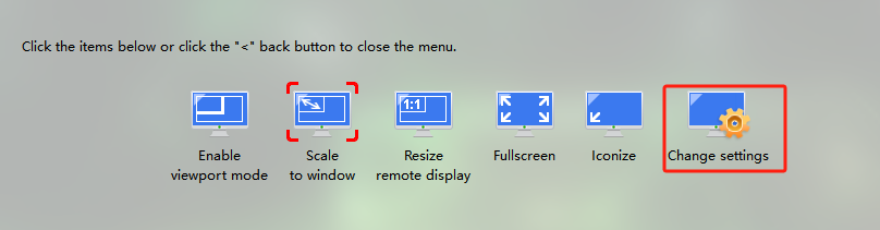

After establishing remote connection via NoMachine, it’s necessary to configure the settings by following the steps below (Repeat these steps are required for Nomachinere re-connection each time).

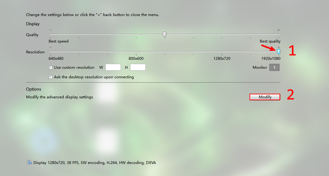

(1) Move the mouse cursor to the upper right corner of the remote connection tool and wait for the fold-out tab to appear, as shown by the red arrow in the image below:
(2) Then left-click with the mouse, and in the pop-up menu, select “Display”.
(3) Click on “Change settings”.
(4) Then drag the Resolution slider to 1920x1080 (or adjust it to match your computer’s native resolution), and click “Modify” to apply the changes.
(5) Continuously click the back button to return to the desktop, and you will notice that the remote desktop resolution has been changed (the screen settings will also be synchronized, but this will reset after a restart, requiring you to follow the steps above to reconfigure the resolution).

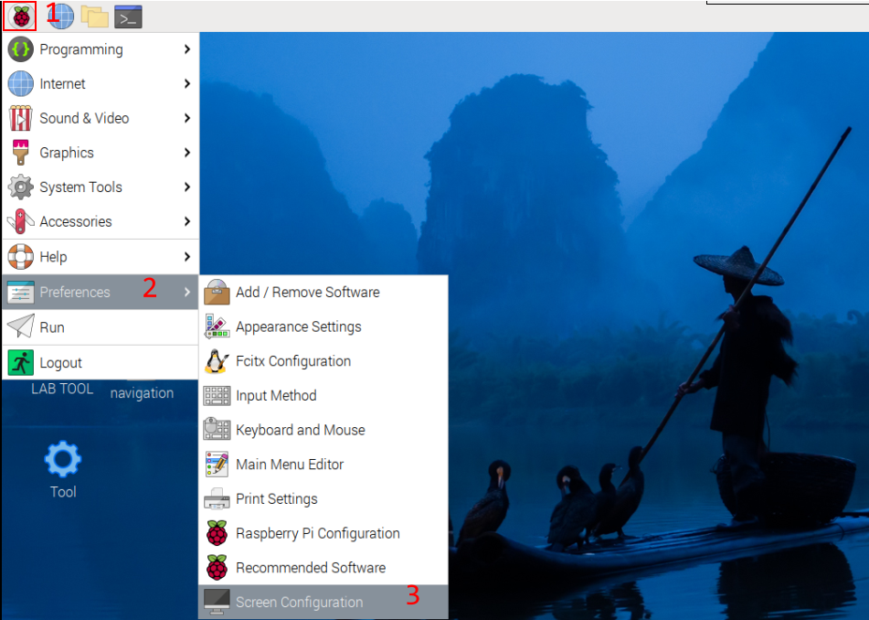

  • Raspberry Pi 5 Version
(1) Locate the Raspberry Pi icon on the upper-left corner, and select “Preferences -> Screen Configuration” in sequence.
(2) In the pop-up interface, hit “ Layout -> Screens -> HDMI-1 -> Resolution -> 1920x1080” in sequence.
(3) This will set the remote desktop resolution to 1920x1080.

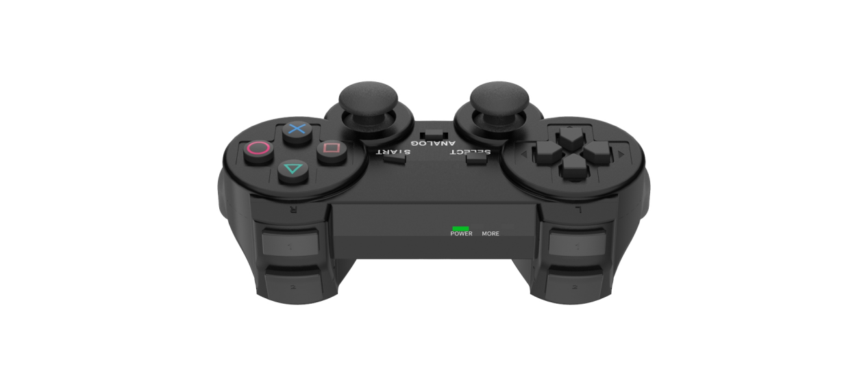

1.7 Wireless Handle Control
1.7.1 Usage Guideline

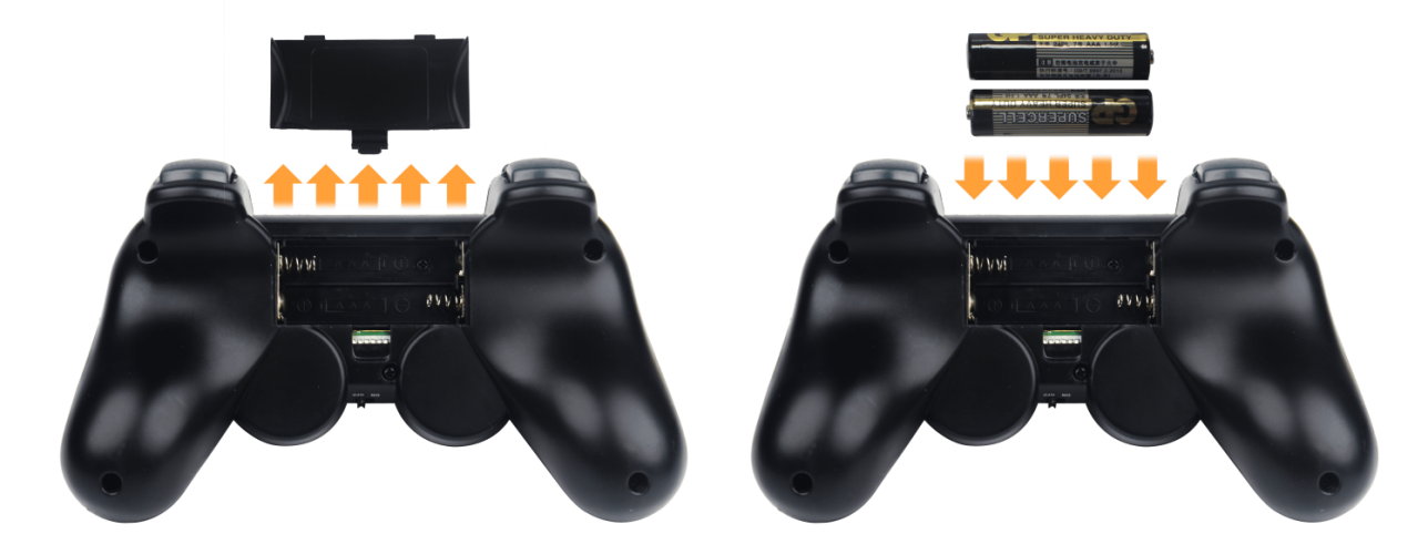

(1) Please first confirm if the handle receiver is already plugged in before starting the robot. Ignore this step if it is already plugged in. (the USB handle receiver has already been inserted into the robot during installing )
(2) When installing the batteries, please distinguish the positive and negative poles of the battery.
(3) After powering on the robot, the app auto-start service will be automatically enabled (app service includes handle control service). If this service is not disabled, no more operations require for it, the robot is allowed to be controlled directly after connecting the wireless handle.
(4) Due to the interactivity of the handle control, when multiple robots are in the same field, it’s not recommended to use this function to avoid accidental connection and control errors.
(5) After turning on the wireless handle, if it does not connect the robot within 30 seconds, or no operations with the handle within 5 minutes after connecting to the robot, it will automatically enter sleep mode. If you need to wake up the handle, please press “START” button to exit the sleep mode.
1.7.2 Device Connection
(1) After the robot is powered on, turn on the switch of the handle. At this point, two LED lights (red and green lights) on the handle will blink simultaneously.
(2) Wait for a few seconds, and the robot and handle will be paired automatically. When pairing is successful, the green LED light will remain on, and the red LED light will turn off.
1.7.3 Button Instructions
The below table will introduce the functions of the buttons and joysticks (take robot as the first person view):
Gently pushing the joystick in any direction enables low-speed movement.
Button Function Description
START Stop and reset the device Click
Left stick up Move forward Push
Left stick down Move backward Push
Right stick left Turn left Push
Right stick right Turn right Push

Next, you need to confirm whether the handle receiver is securely plugged into the USB port of the robot.
The handle received is already plugged in the USB hub upon receiving the robot.

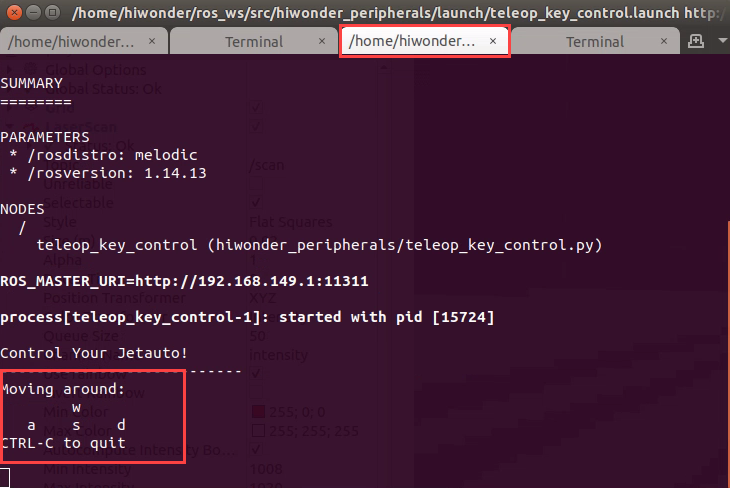

The button instruction for keyboard control is as follow:
Buttons Function Instruction
W Move forward Short press to this button to forward status. Robot will keep moving forward.
S Move backward Short press to this button to backward status. Robot will keep moving backward.
A Turn left Long press to interrupt moving forward or backward and make a counter-clockwise turn to the left in place
D Turn right Long press to interrupt moving forward or backward and make a right turn.
When the “W” or “S” key is pressed, the robot will continue moving forward or backward respectively. When the “A” or “D” key is pressed, the robot will interrupt the forward or backward motion and rotate counterclockwise or clockwise in place respectively. When the “A” or “D” key is released, the rotation will stop, and the robot will remain stationary.

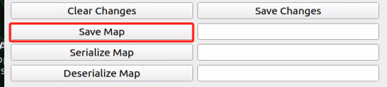

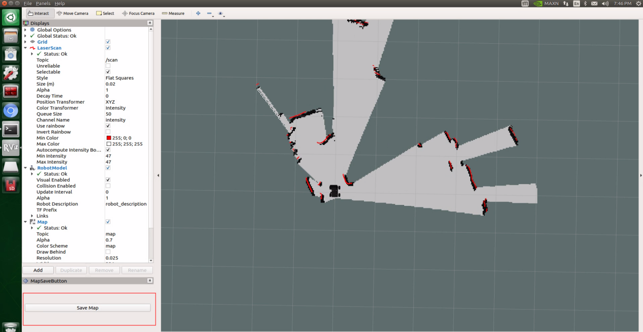

(6) After the movement is complete, press the save button in the bottom left corner, and the robot will save the completed map.
The standard for a completed map is as follow:
(7) After the mapping is complete, if you want to close this function, click interface and tap.

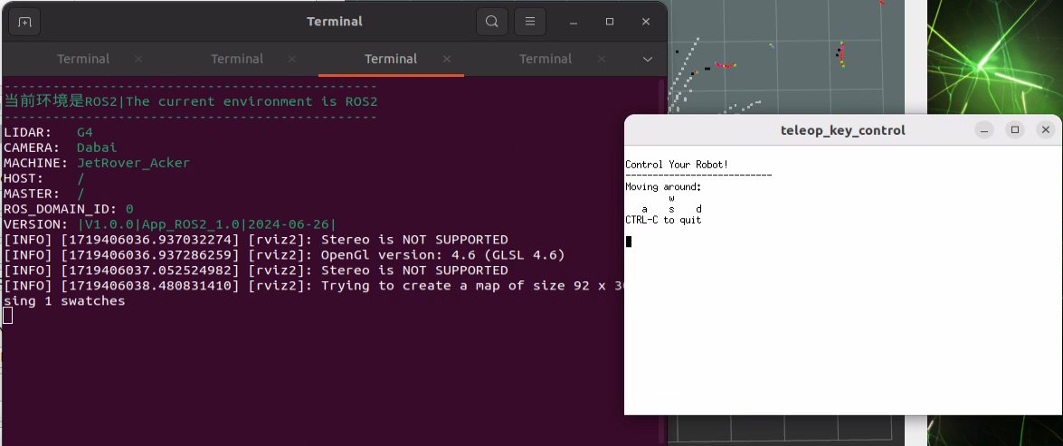

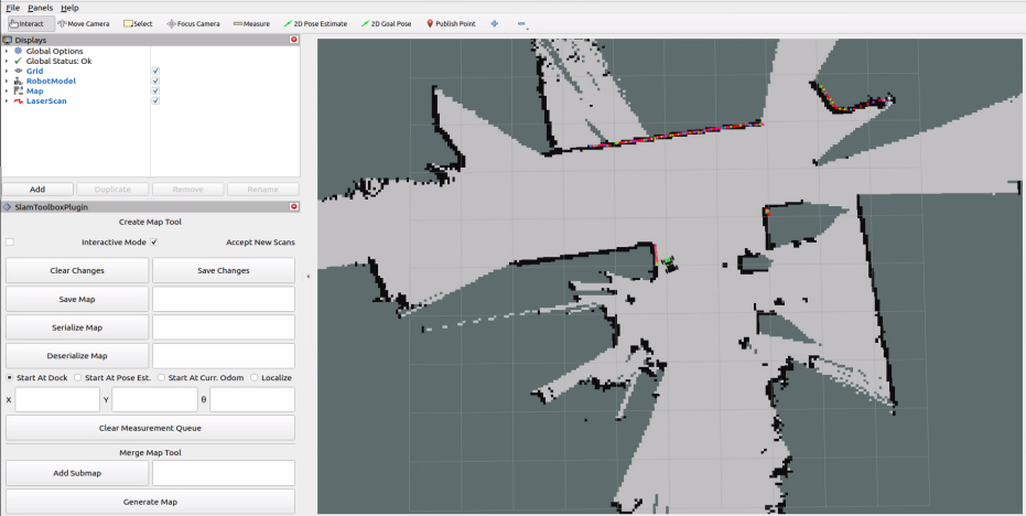

(2) Click on the screen desktop. Open the SLAM icon.

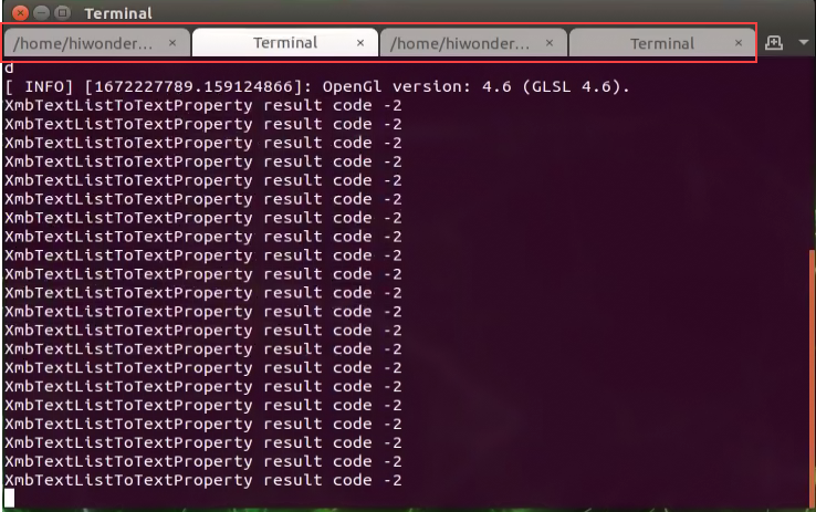

(3) At this time, Several terminals will be opened to run the program simultaneously. Wait for a while at this point.
(4) When you see the below interface, it indicated that the function is enabled successfully.
(5) Now, let’s use control the robot to map using the wireless handle. The function instruction for each button is as follow:
When using the handling, keep the distance from the robot not too far to avoid disconnection.
Button/Joystick Operation Function
START Short press Exit sleep mode
Left joystick Push forward/backward Control robot to move forward and backward
Left joystick Push to left/right Turn left/right
Right joystick Push to left Control robot to turn left

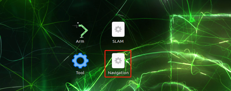

1.10 Autonomous Navigation
  • Autonomous navigation will read the most recently created map, whether manually and autonomously built. If both methods are used simultaneously, it will save the last map created.
  • If you want to learn about how to save multiple maps, please delve into the content in “5. Mapping and Navigation Courses” .
1.10.1 ROS1 Autonomous Navigation
Reminder: This section is only applicable to the Jetson Nano controller.

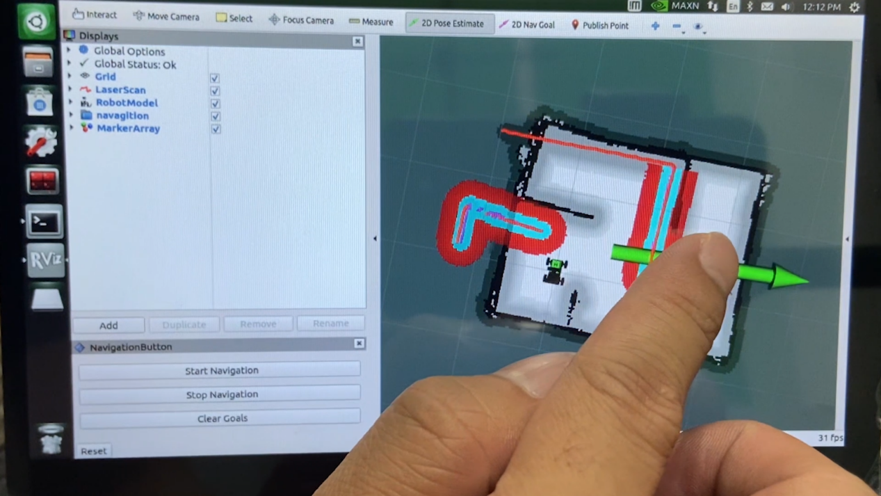

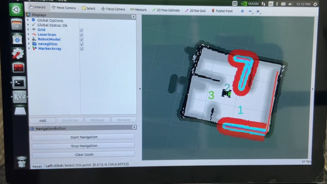

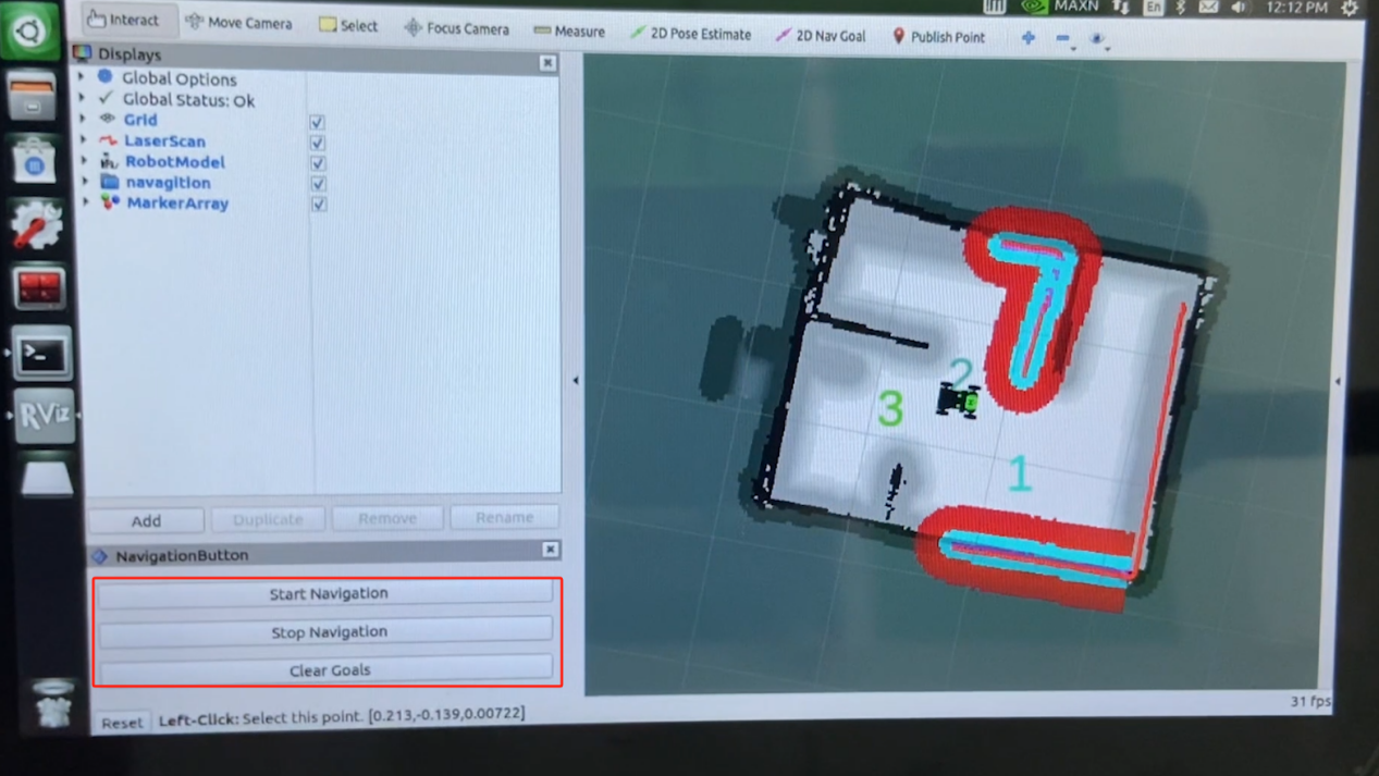

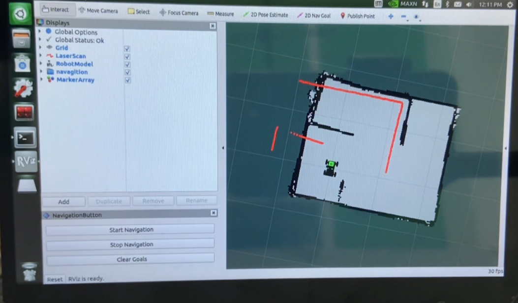

(1) Start the robot. Click the Navigation icon to experience the quick navigation function.
(2) After opening, the terminal will run the program. When you see the following interface, it indicates that the opening was successful.
(3) In the manual bar, “2D Pose Estimate” is used to set the initial position of JetAuto, “2D Nav Goal” is used to set a target point and “Publish Point” is used to set multiple target points.
(4) Click on to select one point by clicking the map interface as the target destination. If you press and drag with the mouse, you can also select the orientation of the robot after it reaches the target point. After the selection is complete, the robot will automatically generate a route and move to the target point. (Note: changes the initial position of the robot on the map and is the target point for single-point navigation).
(5) Click and press the left mouse at a certain point on the map to set it as the destination point. If you need to perform multi-point navigation, please follow the same operation steps to set multiple destination points.
You need to click “Publish Point” once before setting each destination point.
(6) After setting the destination point, click “Start Navigation” in the bottom left corner to start navigation. During navigation, the robot will automatically avoid obstacles. If need to stop navigation, click “Stop Navigation”, and then robot will stop after reaching the destination point.
For example, in the multi-point navigation shown in the above figure, marked as 1, 2 and 3 on the map (take three marks as example). If the robot is traveling between marks 1 and 2, and when you press “Stop Navigation”, it will stop moving after reaching mark 2.
If clicking “Clear Goals”, all marks will be cleared.

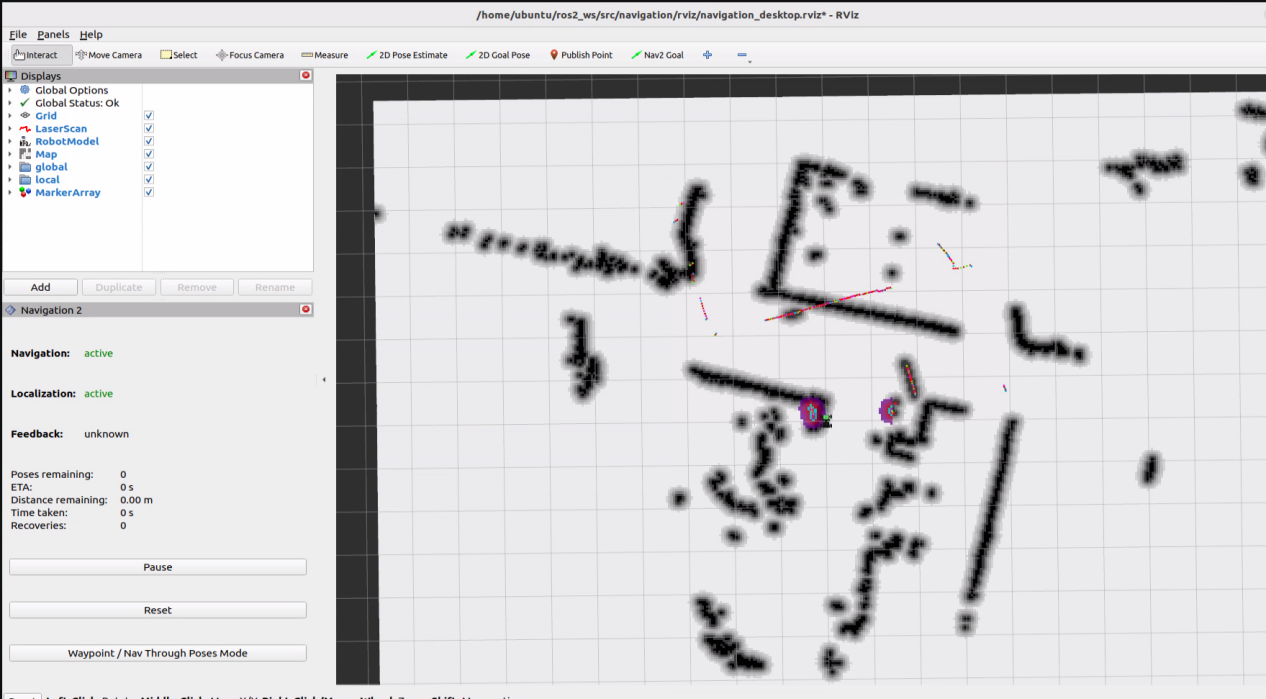

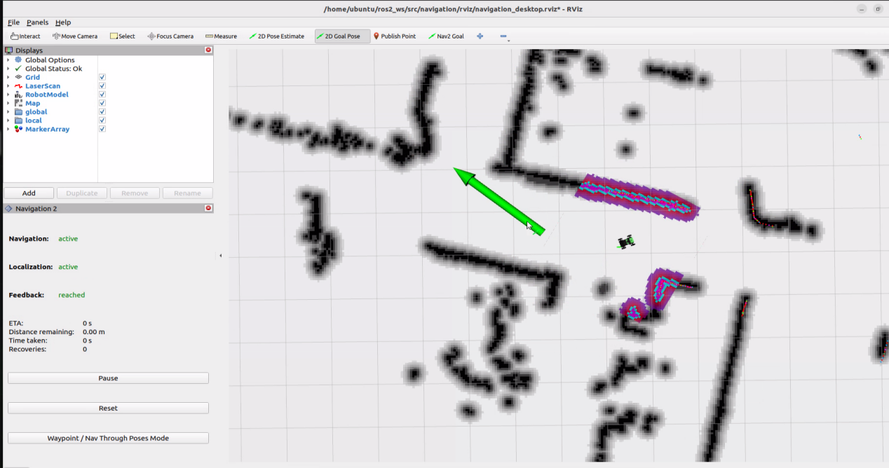

1.10.2 ROS2 Autonomous Navigation
Reminder: This section is only applicable to Jetson Orin Nano, Jetson Orin NX and Raspberry Pi controllers.

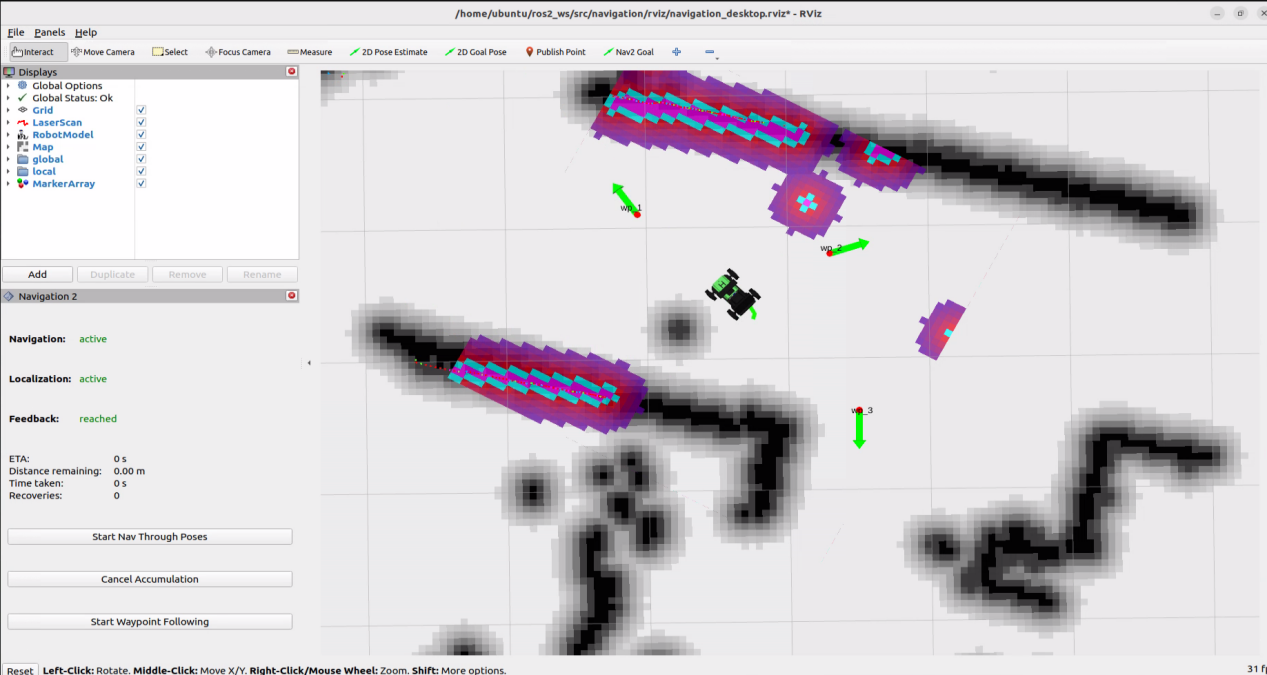

(3) In the manual bar, “2D Pose Estimate” is used to set the initial position of the robot, “2D Nav Goal” is used to set a target point and “Publish Point” is used to set multiple target points, “Nav2 Gaol” is used to set more complex navigation targets, such as specifying a target point, a target pose or a target field.
(4) changes the initial position of the robot on the map and mark the robot’s actual position.
(5) Click on to select one point by clicking the map interface as the target destination. If you press and drag with the mouse, you can also select the orientation of the robot after it reaches the target point.
(6) Click in the bottom left corner to enable multiple-point navigation. Then click to set a target point. Hold and drag that point to select the target point direction.
You need to click “Nav2 Goal” once before setting each destination point.
(7) After setting the destination point, click “Start Nav Through Navigation” in the bottom left corner to start navigation. During navigation, the robot will automatically avoid obstacles.
1.11 Hardware Introduction
This chapter focuses on the hardware components of ROS robots, including electronic control system, ROS controller, Lidar and depth camera, etc.

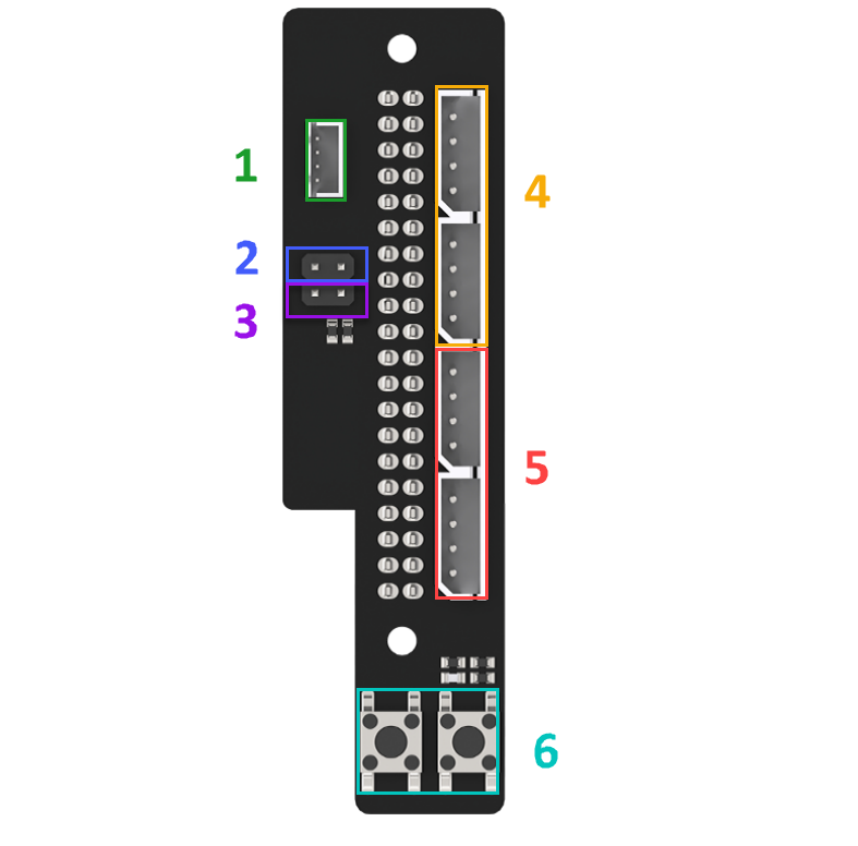

1.11.1 ROS Controller
The JetAcker robot offers comprehensive ROS main controller support, with similar usage methods across the different controllers. The Raspberry Pi 5 uses the Debian 12 system, while the Jetson series uses the Ubuntu system.
  • Jetson Nano Version:
The robot utilizes Jetson Nano as its ROS controller, consisting of the Jetson Nano board and Jetson expansion board. The motherboard is a compact yet powerful computer capable of running the mainstream deep learning frameworks, providing the computational power required for most artificial intelligence projects.
The expansion board features connections for LEDs and buttons, enabling users to monitor network status through LED flashes and switch network modes using the button. It also includes reserved GPIO and I2C interfaces.
The mainboard is installed with the Ubuntu18.04 system, and establishes the ROS Melodic environment for robot operations. Additionally, the ROS2 Humble environment is deployed within a Docker container.
  • Jetson Orin Nano Version
The robot is equipped with the Jetson Orin Nano main controller, which comprises a Jetson Orin Nano motherboard and a Jetson expansion board. The motherboard is a compact yet powerful computer that can run mainstream deep learning frameworks, providing the computational power necessary for most artificial intelligence projects.
The expansion board features connections for LEDs and buttons, enabling users to monitor network status through LED flashes and switch network modes using the button. It also includes reserved GPIO and I2C interfaces. The controller is installed with Ubuntu 22.04 and features the ROS2 Humble environment for robotic operating systems.
The Jetson Nano and Jetson Orin Nano controller board with a mini expansion board offers stable performance, low power consumption, and strong expandability. It can run mainstream deep learning frameworks and meets the computational requirements of most artificial intelligence projects.
Jetson Nano and Jteson Orin Nano controller
Reserved interfaces include 2 USB ports, 2 GPIO ports (4-Pin), 2 IIC ports (4-Pin), and 1 UART port. The board is equipped with 5V/3.3V power interfaces, LED indicators, and 2 programmable buttons.

  • Raspberry Pi5 Version
The robot uses a Raspberry Pi 5 as its ROS main controller, which includes the Raspberry Pi 5 controller and a mini expansion board. The controller is a compact yet powerful computer capable of running major deep learning frameworks, providing the computational power needed for most AI projects.
The mini expansion board adds functionality with LEDs and buttons, allowing users to monitor network status via LED indicators and switch network modes using a mobile phone. It also features reserved GPIO and I2C interfaces for additional expansion.
The controller operates with the Raspberry Pi Debian12 official system and has a ROS2 environment set up in Docker.
Overall, the mini expansion board for the Raspberry Pi 5 is stable, energy-efficient, and highly expandable, capable of supporting mainstream deep learning frameworks and meeting the computational needs of most AI applications.

The 11.1V 6000mAh Lithium battery is tailored for the robot, with a charging voltage of 12.6V. It features overcharge protection, overcurrent protection, over-discharge protection, and short-circuit protection.
Please use the special charged provided in the kit to charge the robot. Users can view the charging status by observing the indicator on the charger. The red light indicates that the battery is charging, while the green indicates that the charging is complete. (Green light when idle, red light when charging, and green light when fully charged)
1.11.3 Hardware System Wiring Diagram
The hardware connection system diagram of the robot based in the mini STM32 controller is shown below. The specific model and ROS controller may var, and the detailed instructions will be provided in the following content.
  • Jetson Nano Controller Version:
  • Jetson Orin Nano/Jetson Orin NX Controller Version:
  • Raspberry Pi 5 Controller Version:

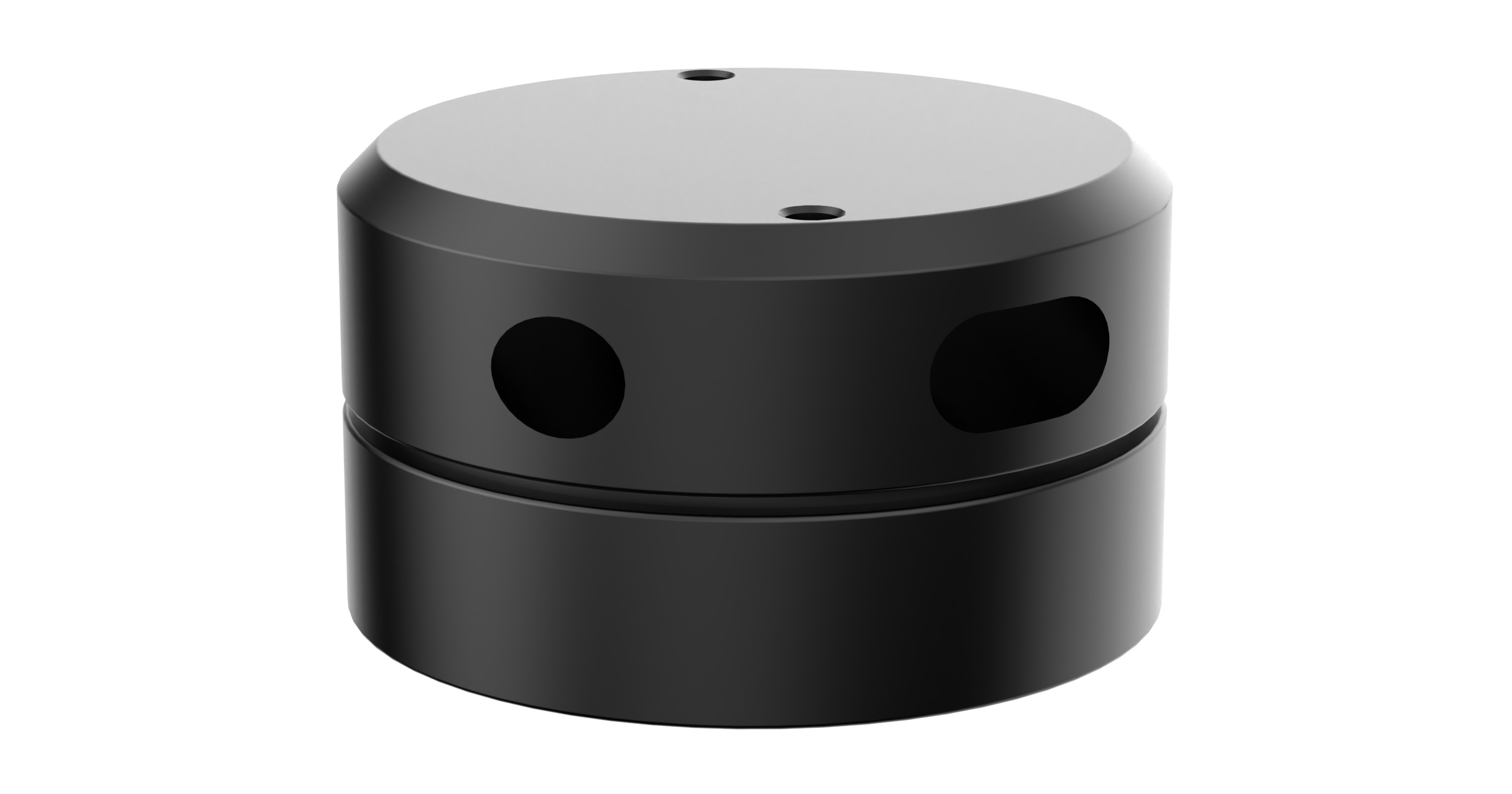

1.11.7 Lidar
Lidar utilizes laser technology to accurately pinpoint the locations. Its applications extend to various scenarios, including the field of robotics, enabling functions such as Lidar obstacle avoidance, following, SLAM mapping, and navigation.
This robot is compatible with different Lidar models, including A1 Lidar and G4 Lidar. Users can choose Lidar versions according to your requirement. Below are listed two types of Lidar:

  • Microphone Array Module
This module is optional in robot kit. It can allow robot to realize voice wake-up and voice control capabilities.
This robot uses the R818 noise reduction board and a ring-shaped six-way microphone array, which features a planar distribution structure composed of six microphones. It is a system that samples and processes the spatial characteristics of the sound field. It can perform sound source localization, suppress background noise, interference, reverberation, and echo, and achieve 360° equivalent sound reception.
The noise reduction board can suppress background noise, interference, reverberation, and echoes, as shown in the image below:

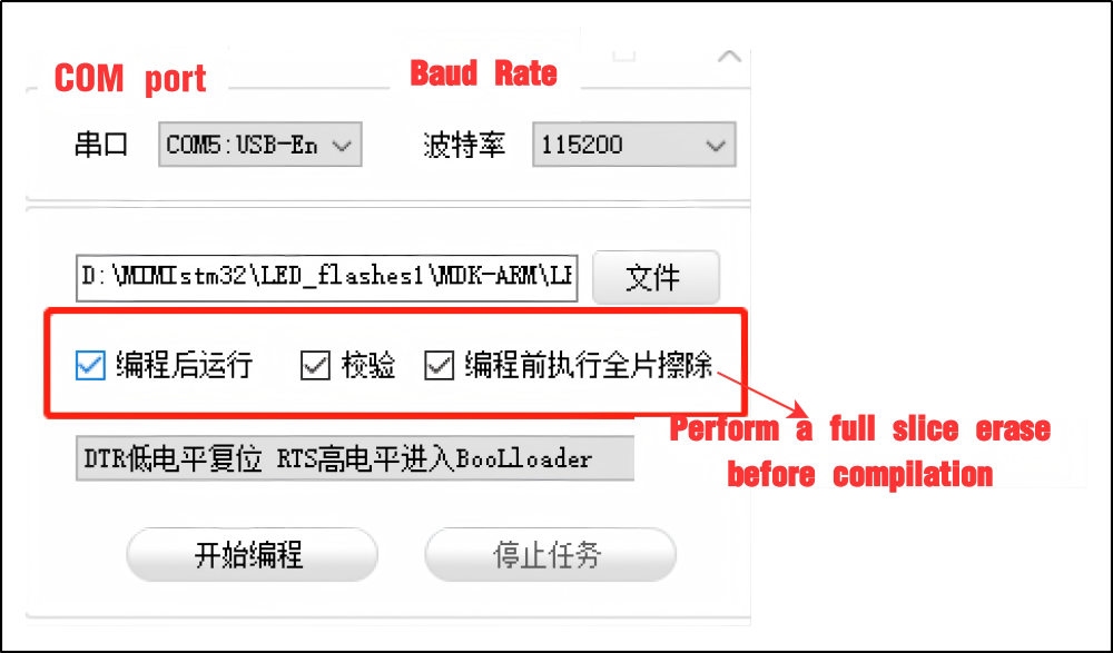

The STM32 controller is used as the robot underlying motion controller for running STM32 code. The robot chassis has already been burned with corresponding code for direct usage.
It supports ISP code updates through the USB serial port and can also be updated or debugged through the SWD interface. As the underlying chassis driver board for the robot, it is primarily responsible for the tasks such as motor PID control, encoder and IMU data acquisition, RGB light control, etc. Various control methods are supported, including PS2 wireless control, app control, and remote control via an RC transmitter. Additionally, it communicates through a serial port with the ROS base layer’s chassis control node, receiving target vector velocities from the basic layer and sending the real-time speed, IMU data, and battery voltage data calculated by the odometry. To enhance these functionalities, STM32 controller utilizes the FreeRTOS embedded operating system for software design.
