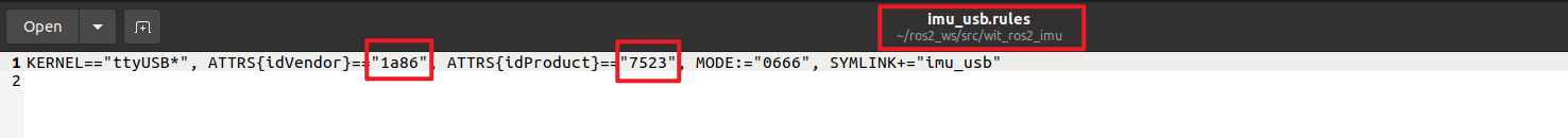

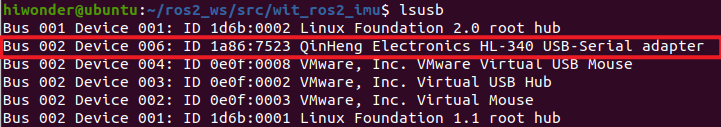

If the previous operation does not display the bound port number, try the following steps:
  • Plug and unplug the USB connector of the IMU module.
  • Run the command lsusb twice.
  • Check whether the Manufacturer ID and Product ID of the device are correct.
  • Make the necessary adjustments in the /home/hiwonder/wit_ros_imu/imu_usb.rules file.
After modification, execute the command:
sudo bash bind_usb.sh

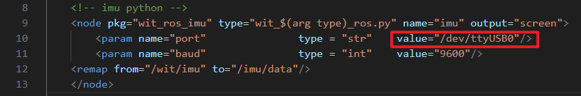

(2) Change the parameter configuration, including USB port number.
cd ~/wit_ros_imu/launch
vim rviz_and_imu.launch
Navigate to the script directory src/launch and open the configuration parameters Locate the parameter for the device number, typically labeled as /dev/ttyUSB0 (used by default in the script). If the number recognized by your computer differs from USB0, update it accordingly in the file.
If multiple USB serial devices are connected, you might need to manually verify and modify the corresponding serial number each time you reboot the computer.
Save the modification and close the file.

  • Change Parameter Configuration
Navigate to the directory ~/ros1Imu_ws/src/wit_ros_imu/launch/ and modify the relevant parameters in the file “rviz_and_imu.launch”. By default, the baud rate is set to 9600. If you have modified the baud rate through the host computer, ensure to update it in the launch file accordingly. Use the following commands to navigate to the directory and edit the file:
cd ~/ros1Imu_ws/src/wit_ros_imu/launch
Go to the src/launch directory and open the rviz_and_imu.launch file to configure the parameters.

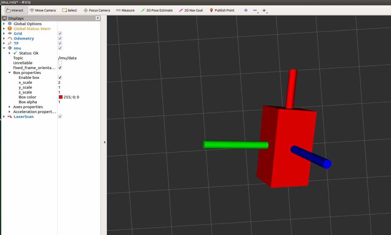

(1) Terminate the app service by executing the command. In the provided robot image, it’s necessary to disable the mobile app service. (If the virtual machine image does not have any auto-starting services, you can skip this command.)
(2) Open the terminal and execute the launch file. It’s important to note that this action must be performed on the actual desktop or via VNC remote desktop. Running the launch file is not possible through an SSH remote terminal.
roslaunch wit_ros_imu rviz_and_imu.launch
(3) Select the /imu/data topic and observe the model’s motion response.

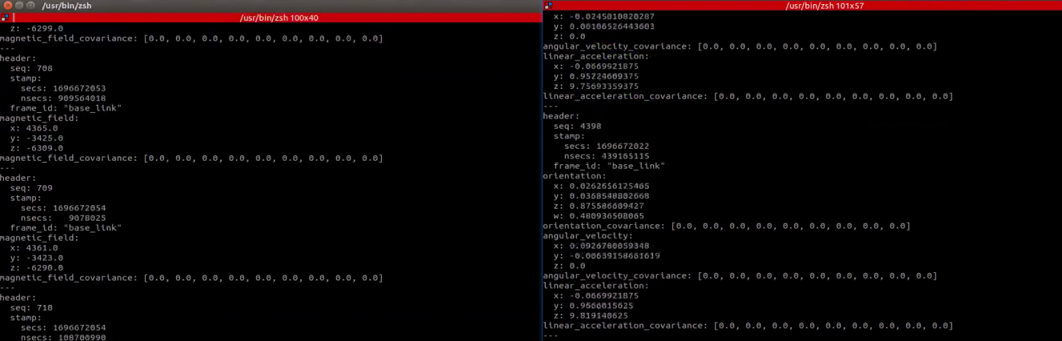

Open two new terminals, then respectively execute the following commands to check the data with rostopic echo:
rostopic echo /wit/mag
rostopic echo /imu/data
If the driver runs successfully, the terminal will output the message below:

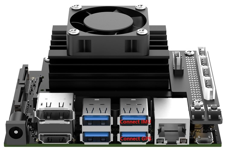

3.3.1 Module Connection
This example uses the Jetson Nano as the controller. If you are using a PC virtual machine or a Raspberry Pi, you will need to check and adjust the corresponding device identifier numbers accordingly.

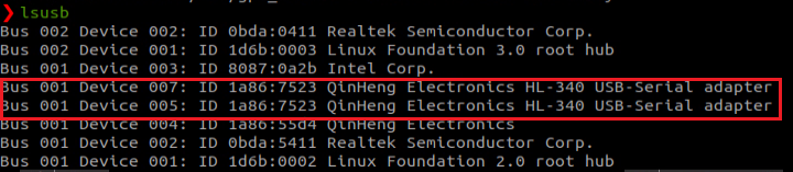

(2) Open the terminal and enter the command lsusb to list connected USB devices and find the GPS and IMU modules’ device IDs.

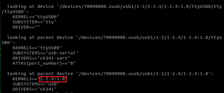

(3) As shown in the figure below, you may see that both modules share the same device ID. To distinguish them, you will use the USB bus address of each device. Start by connecting only the IMU module, then run command “udevadm info -a -n /dev/ttyUSB*”. You will see a unique identifier for the IMU module, “1-2.3:1.0” in this example.
You can observe that the unique identifier of the device at this moment is “1-2.4:1.0”.

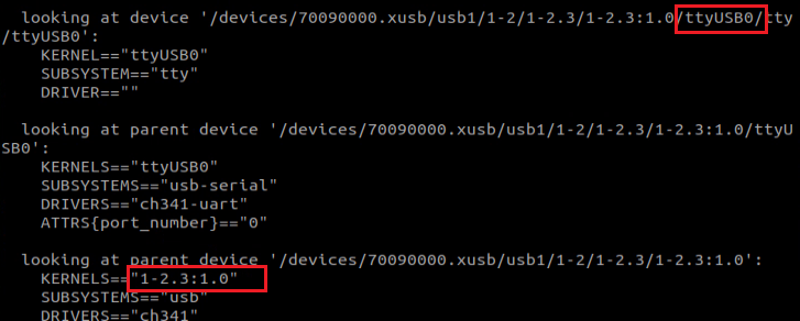

(4) Next, disconnect the IMU and connect the GPS module. Run the same command again: udevadm info -a -n /dev/ttyUSB*
You should now see a different unique identifier, such as “1-2.4:1.0”.
(5) Add device identification rules in the imu_usb.rules file. Enter the command “sudo vim /etc/udev/rules.d/imu_usb.rules” to edit the file. Then, enter the following content into the file:
SUBSYSTEM=="tty", KERNELS=="1-2.3:1.0", MODE:="0666",
SYMLINK+="imu_usb"
(6) Add device identification rules in the gps.rules file. Enter the command “sudo vim /etc/udev/rules.d/gps.rules” to edit the file. Then, enter the following content into the file:
SUBSYSTEM=="tty", KERNELS=="1-2.4:1.0", MODE:="0666",
SYMLINK+="gps_serial"

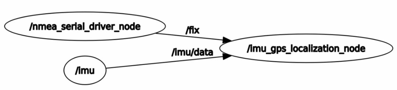

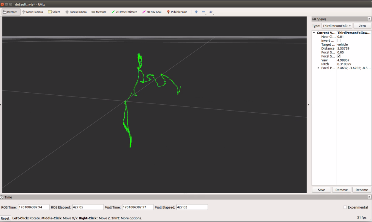

3.3.4 IMU and GPS Data Fusion
This section demonstrates how to fuse IMU and GPS data, and visualize the result in RViz. Important Notes:
(1) Make sure both the IMU and GPS modules are connected to the controller via two separate data cables.
(2) Two separate workspaces are required: gps_ws and imu_ws. Their source folders (gps_src and imu_src) are located in the current directory. After extracting gps_src, copy the contents inside its src folder into the src folder of gps_ws, then run catkin_make to compile. Similarly, after extracting imu_src, copy its src contents into the src folder of imu_ws, and compile it using catkin_make. You can refer to the gps_ws and imu_ws workspaces provided in the virtual machine for reference.
(3) The default baud rate for both IMU and GPS modules is 9600.
Data fusion requires data from two topics: /imu/data and /fix. These topics can be obtained by launching the IMU and GPS modules. To start the fusion process, run the following command: roslaunch imu_gps_localization imu_gps_test.launch
(4) After launching, you may initially see a warning indicating that there’s not enough IMU data. Just wait a few moments — the warning will disappear, and soon you’ll see the fused path being printed. An example of the output is shown below:
(5) The launch file includes the following components:
nmea_serial_driver.launch: Retrieves GPS data and publishes it to the /fix topic. rviz_and_imu.launch: Retrieves IMU data and publishes it to the /imu/data topic. imu_gps_localization_node: Subscribes to both /fix and /imu/data, performs the fusion process, and publishes the result to the /fused_path topic. You can check the list of active topics with rostopic list, or visualize the node connections using rosrun rqt_graph rqt_graph. A diagram of the topic relationships is shown below:
