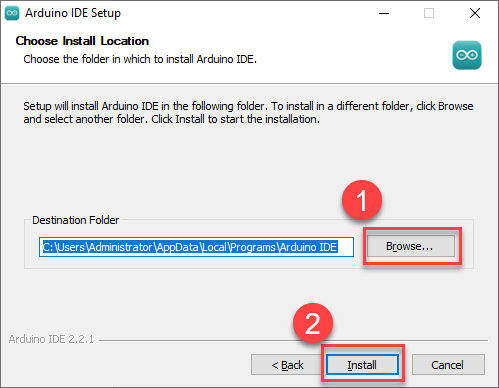

(4) Click “Browse” to choose the installation path, and then click “Install”.

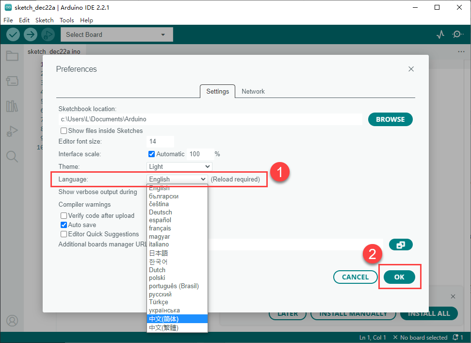

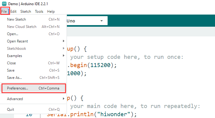

(1) Modify the Chinese interface: select “File” → “Preferences” on the “Arduino IDE” interface. Then, choose Chinese from the “Language”, and click “OK”.
(2) You can modify the project file path, editor text size, color themes, etc by selecting “File” → “Preferences” in the pop-up window.

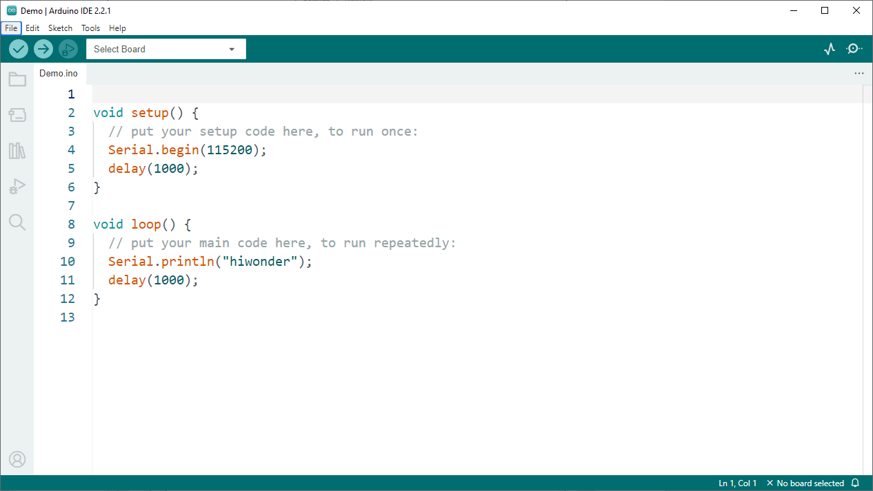

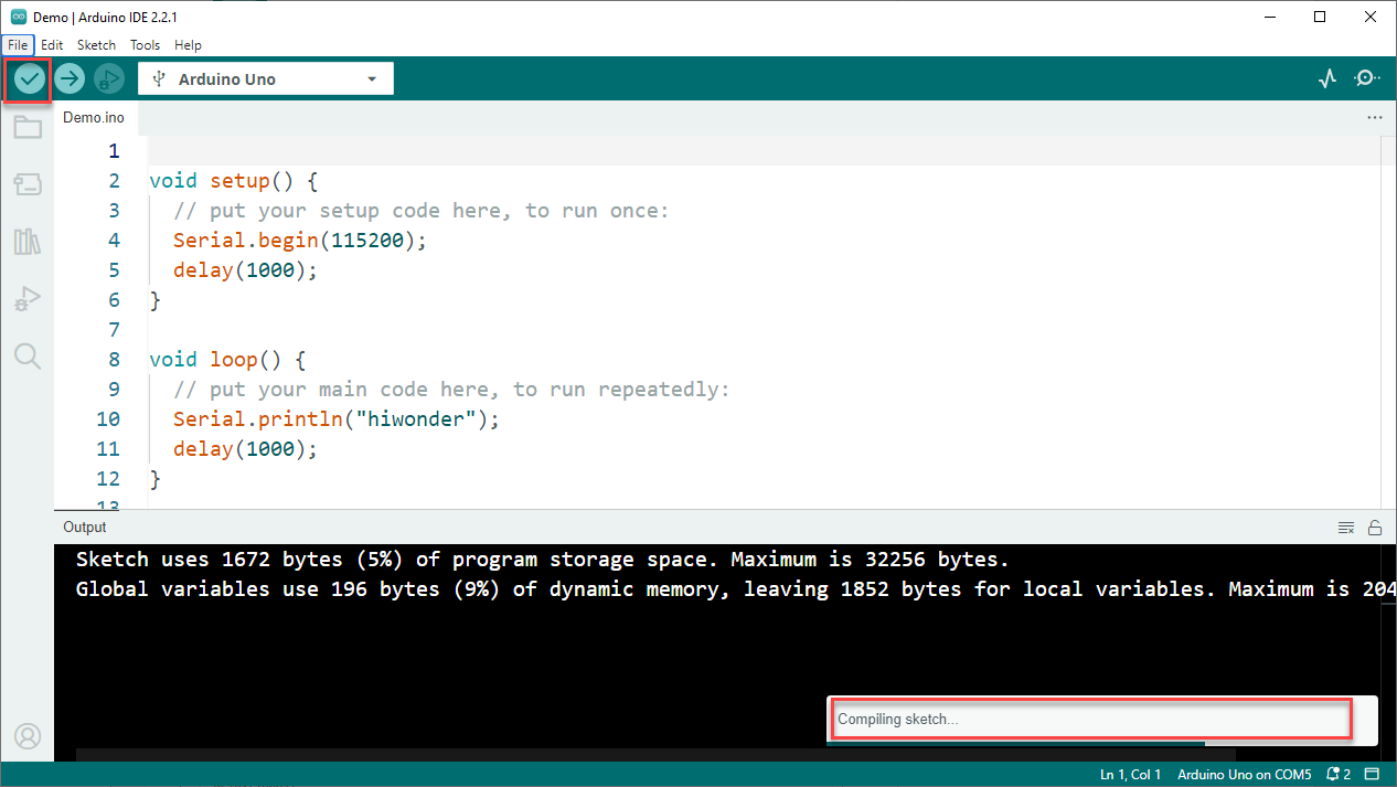

(1) In this case, we will use an example that prints “Hiwonder” to illustrate. Open the example program “Demo.ino” in the Demo folder at the same folder as this document.

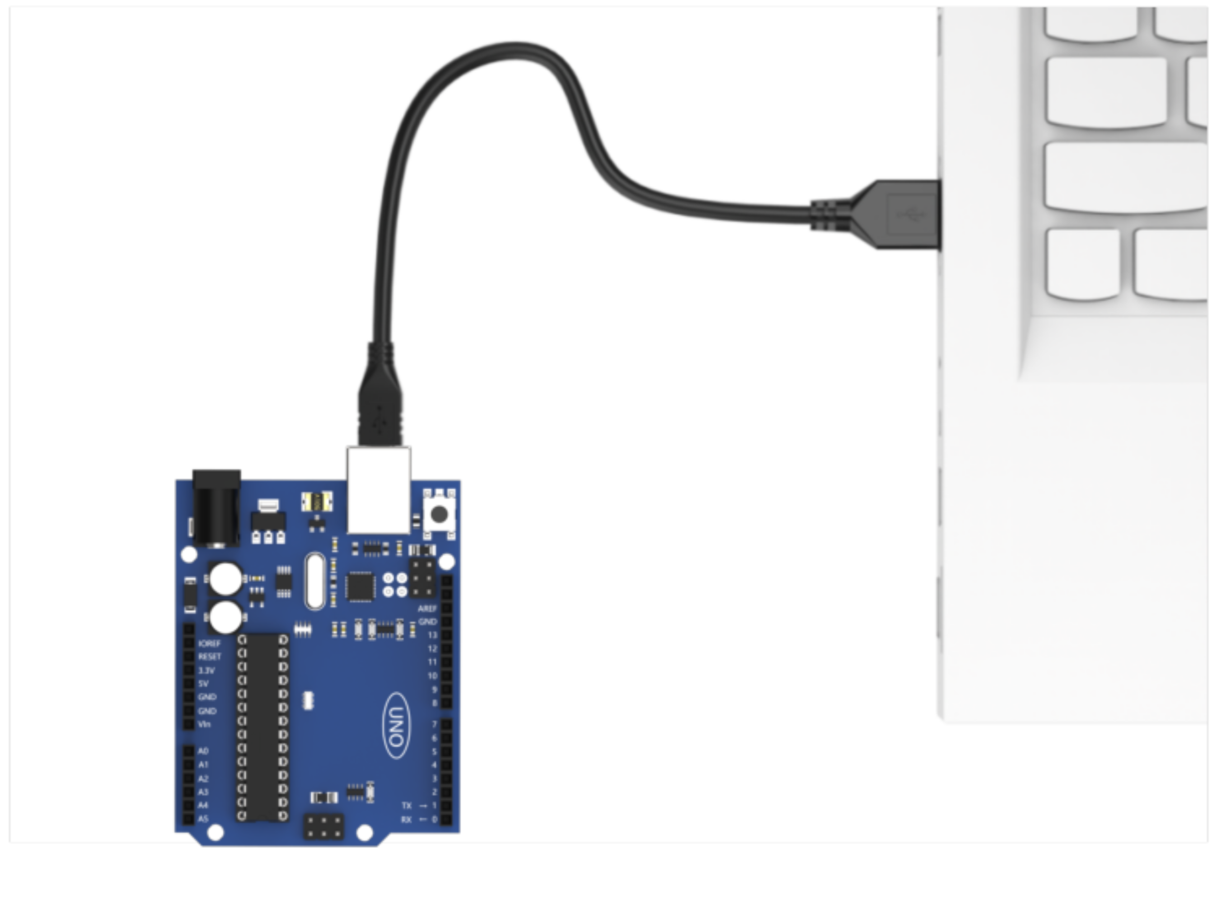

(2) Connect Arduino board to the computer using Type-B cable.

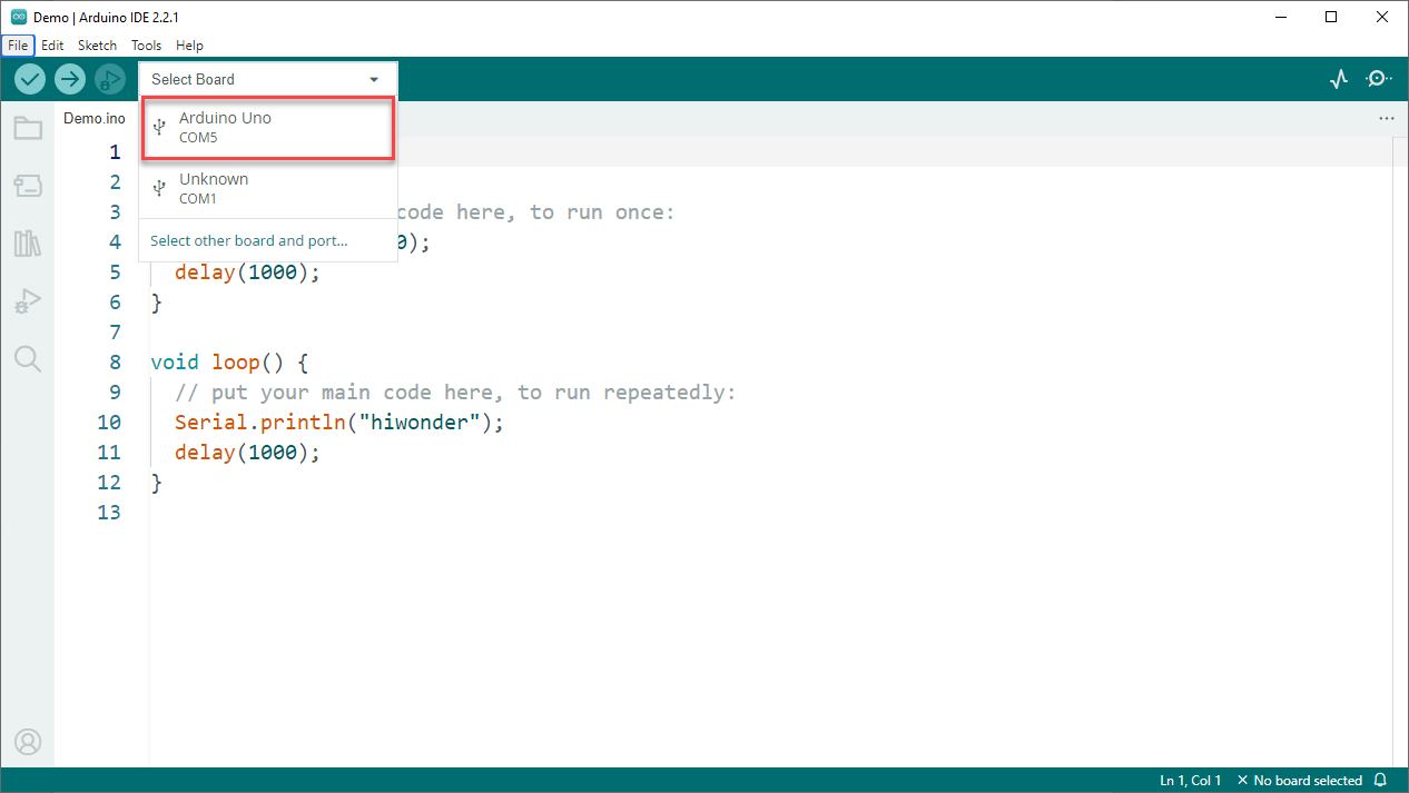

(3) In the “Select board” option, find the corresponding Arduino development board. (Take “Arduino Uno” and “COM6” as en example to demonstrate. The “COM” port is not unique. You can can check the “COM” port number in the computer’s device manager.)
(4) Click

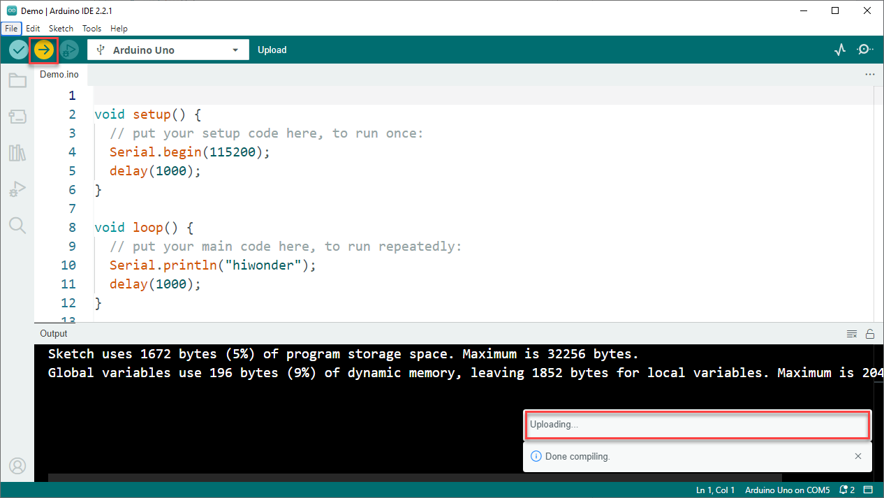

button to compile the program, which can check if the program has syntax errors and other issues.
(5) After the compilation is complete, click
to upload the program into the Arduino development board.

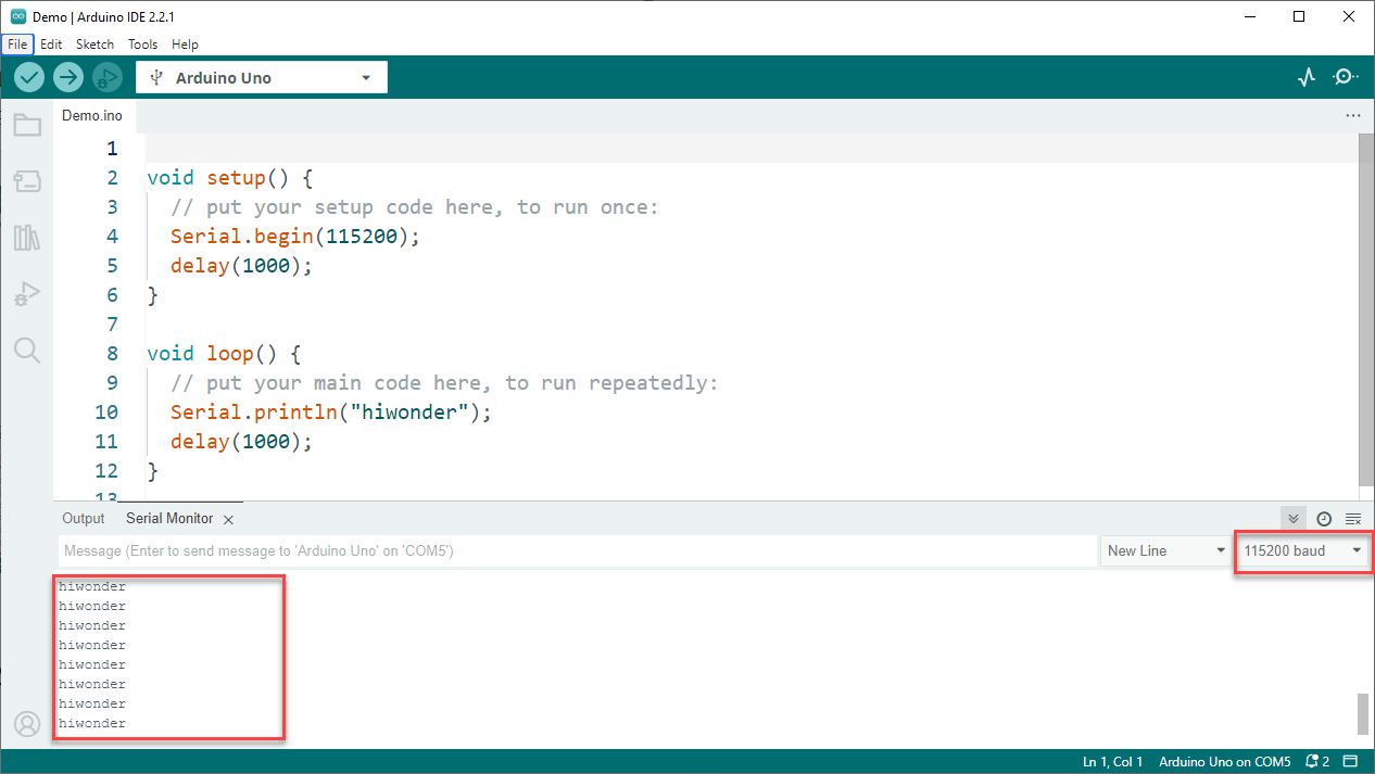

(6) When the upload is done, click
to open the serial monitor. The word “hiwonder” is printed on the serial monitor.

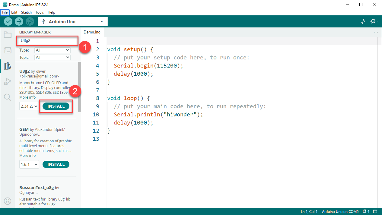

(1) Click
at the sidebar of Arduino IDE interface.

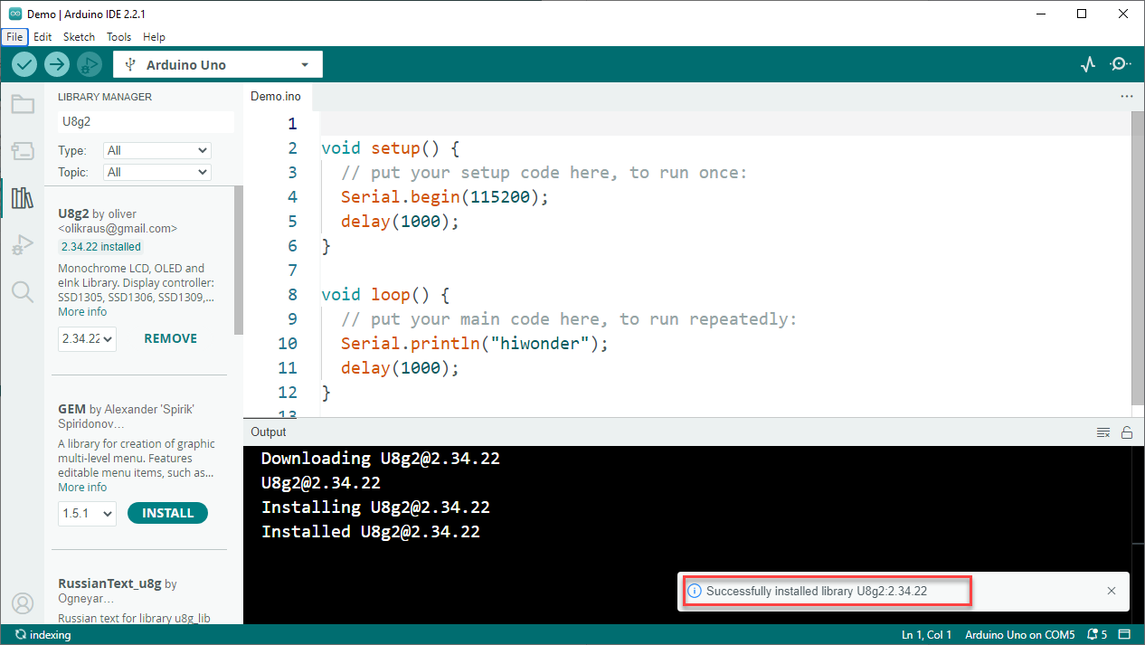

(2) In the pop-up library management bar, enter “U8g2” to automatically search for the library files, then click “install”.
(3) The prompt shown in the red box indicates the successful installation.

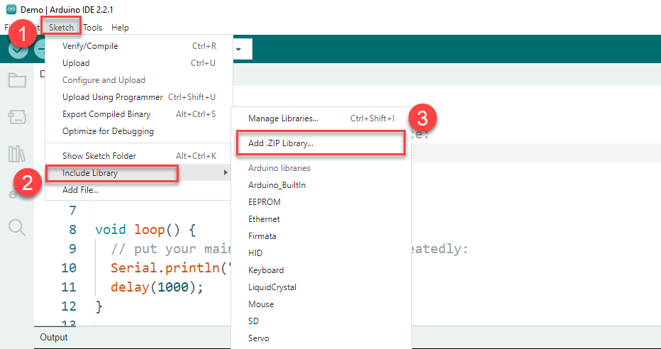

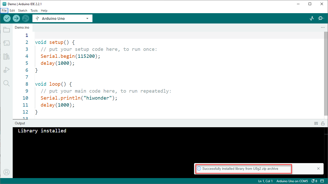

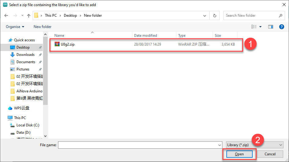

(1) Select “Sketch” → “Include Library” → “Add .ZIP Library”.
(2) Search for the U2g2.zip and open it.
(3) The prompt shown in the below red box indicates that the library file has been installed already.

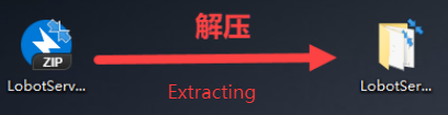

(1) At first, extract the library file “LobotServoController”.

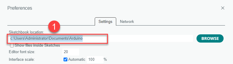

(2) Click “File”→”Preferences” in sequence.
(3) In the opening preferences, copy the path.

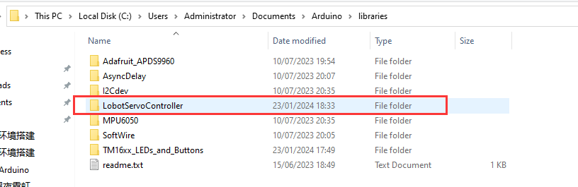

(5) Place the previously extracted library file into the “libraries” folder.
(6) Restart “Arduino IDE”. The library file has been located in the library of “Arduino IDE”.

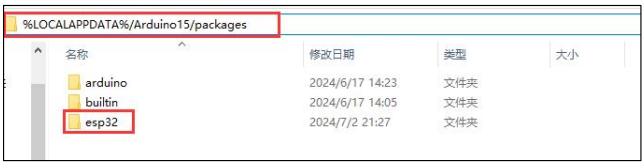

(1) If you installed other versions of ESP32 Package, please delete it before proceeding.

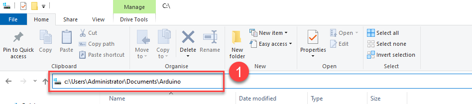

(2) Deletion method: enter the command in the file manager’s address bar, and then press “Enter” to navigate the package, and delete the “esp32” folder inside.
%LOCALAPPDATA%/Arduino15/packages
