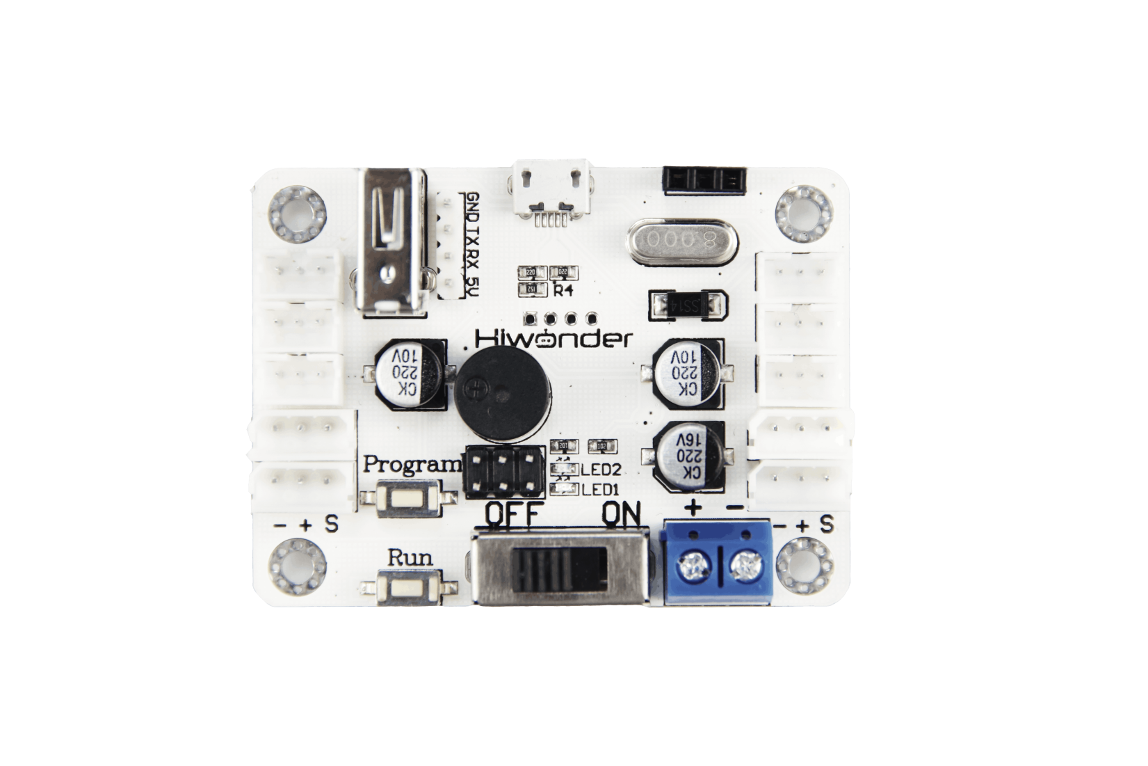

2. Bus Servo Controller Secondary Development
2.1 Bus Servo Controller Communication Protocol
Serial communication, baud rate: 9600
Command packet data type: Hexadecimal

2.2 Arduino Development
2.2.1 Getting Started

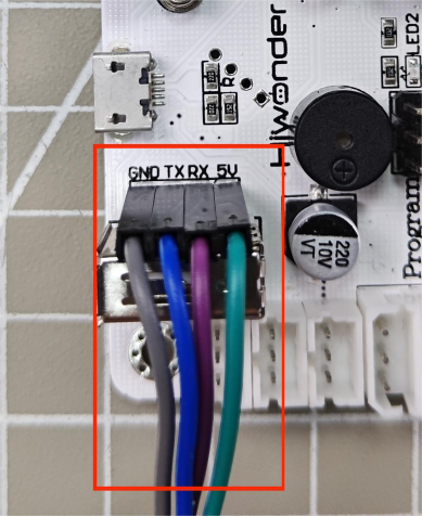

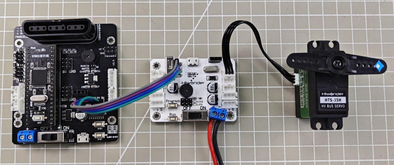

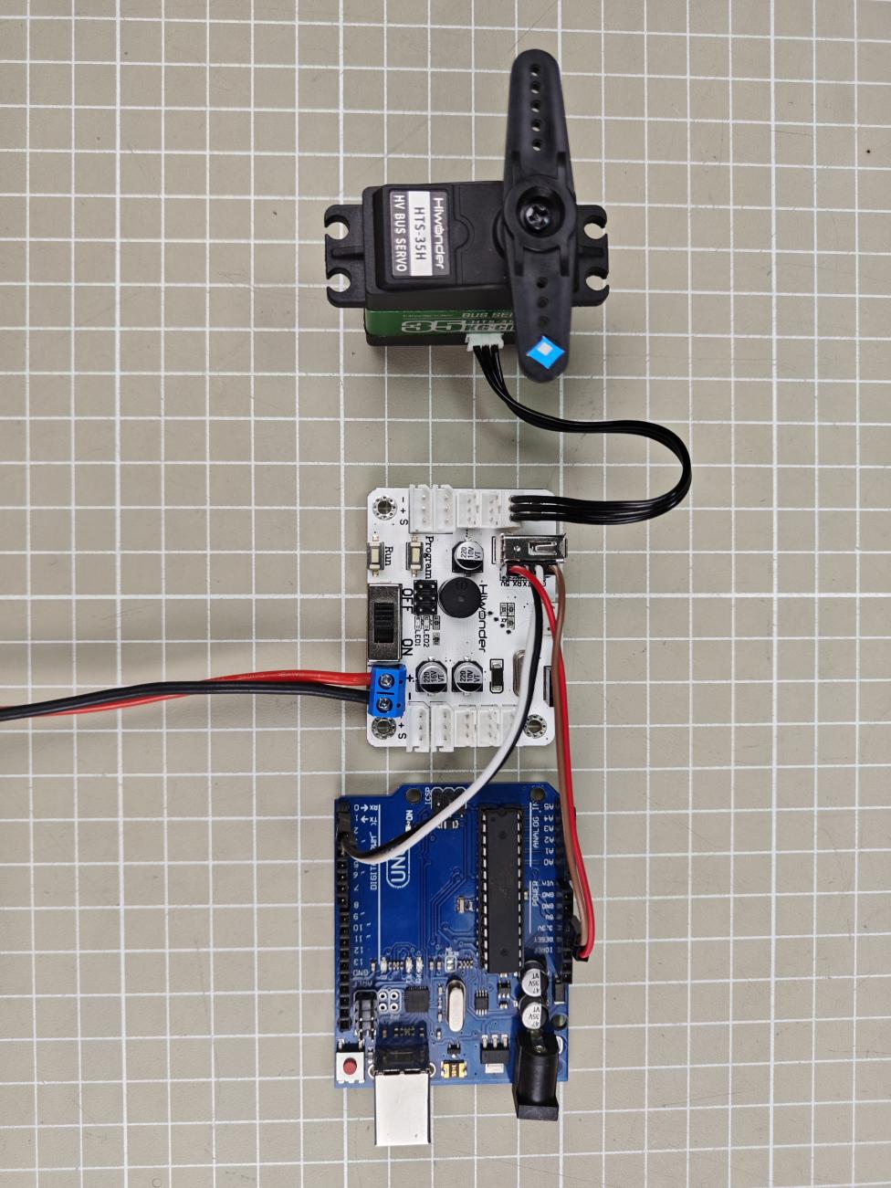

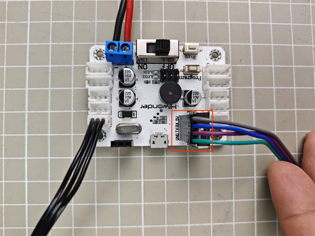

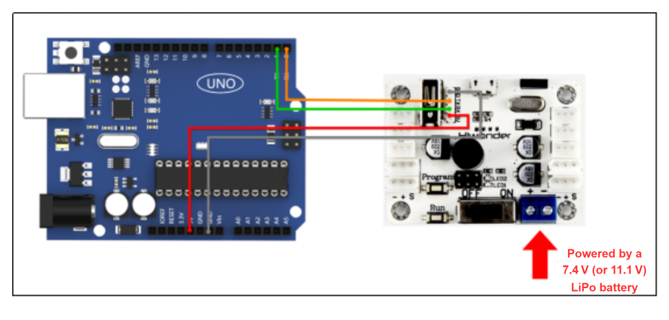

  • Wiring Instruction
This example uses an Arduino development board and a bus servo controller, powered by a 7.4V 6000mAh lithium battery, or an 11.1V battery for high-voltage servos. Connect the serial port of the bus servo controller to the serial port of the open-source servo controller.
  • When connecting the serial ports, make sure to cross the RX and TX pins. As shown in the two diagrams above.
  • Environment Configuration
Install Arduino software on PC. The software package and installation instruction are stored in Appendix -> Arduino Installation Package.

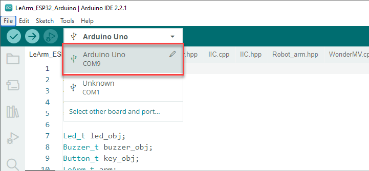

The port number is not fixed. The Arduino IDE will display the board model next to the corresponding port number.
(4) After connecting, click the icon to upload. Once the upload is complete, turn on the bus servo controller’s power switch, and Servo ID 1 will start moving.

Case 3 Control Multiple Servos\LobotServoController.
(2) After opening the program, go to Sketch → Include Library → Add .ZIP Library, and select the LobotServoController.zip file located in the same path to add it. If adding the library fails, please refer to the Arduino IDE user manual.
(3) Connect the Arduino controller to your computer via a USB cable.
In the toolbar, set the board type to Arduino UNO, and select the correct port.
If you see an upload failure message, try disconnecting the bus servo controller from the Arduino board before uploading. After the upload completes, reconnect it to the Arduino.
  • Project Outcome

In this example, the serial port is used to send instructions to the bus servo controller, which then controls the servo to move to central position and adjusts its deviation.
The central position is considered the initial position of the servo and serves as the zero point for rotating in both positive and negative directions. Therefore, the servo should be adjusted to its central position before attaching the servo horn.
Servo deviation is caused by the spacing of the splines on the servo arm—a mechanical limitation that can be corrected through software. In robotics, if this deviation is not addressed, it may restrict the movement of the robot and negatively impact certain motion behaviors.
  • Run Program
Source Code
(1) Open the LobotServoController.ino program located at:
Case 4 Central Position & Deviation Adjustment\LobotServoController.
  • Project Outcome

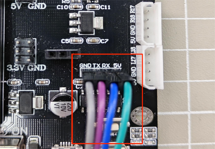

This section employs an open-source servo controller, STC15W4K32S4 microcontroller, and a bus servo controller for development, powered by a 7.4V 6000mAh lithium battery, or an 11.1V battery for high-voltage servos. Connect the serial port of the bus servo controller to the serial port of the open-source servo controller.

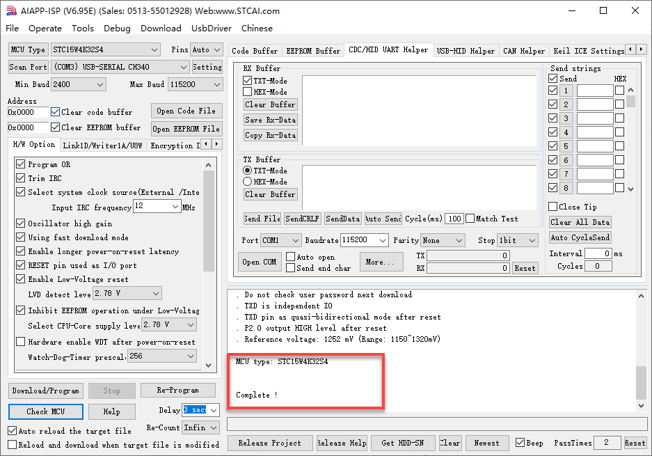

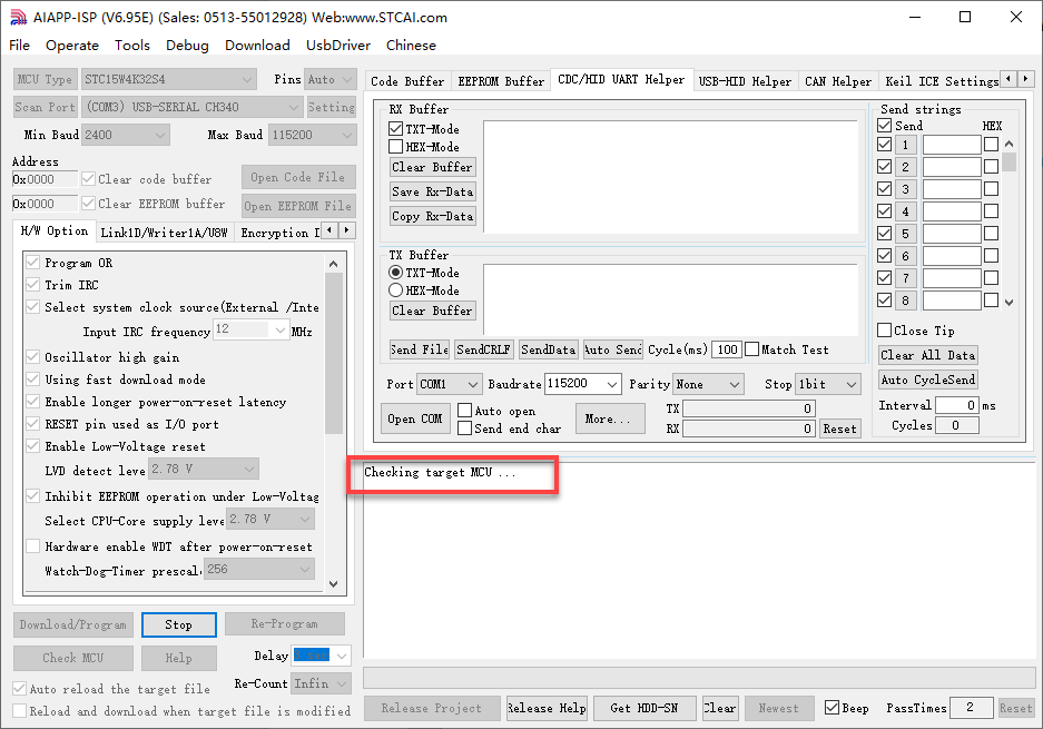

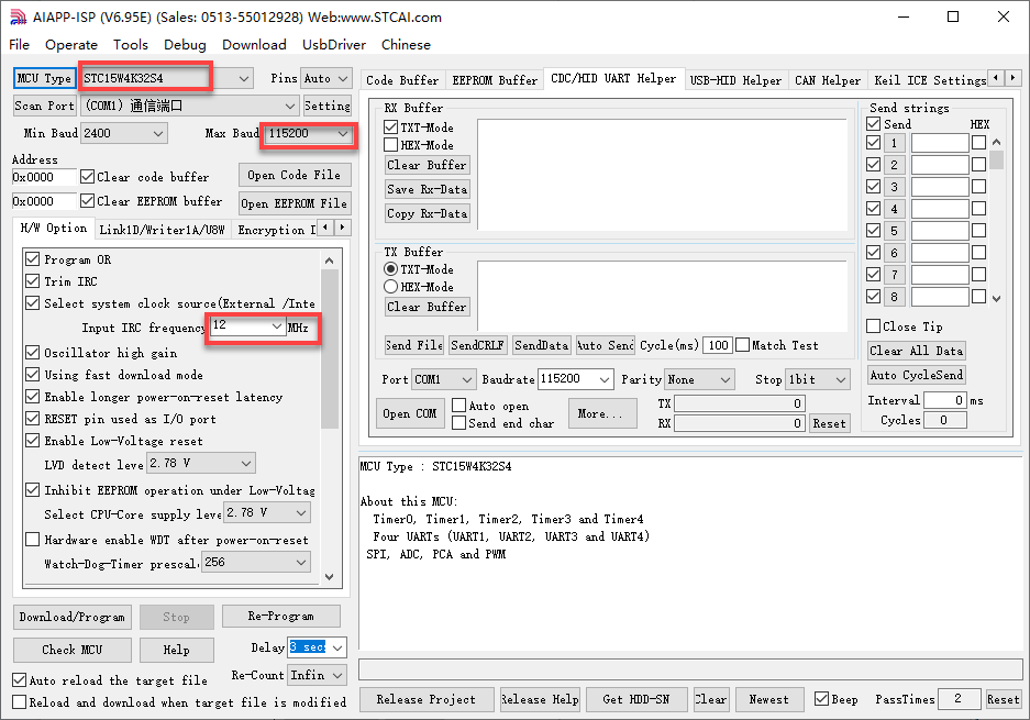

(1) Open the AIapp-ISP-v6.95E in Appendix->C51 Software.
The AIapp-ISP-v6.95E configuration is shown as follow:
NO. Actions NO. Actions
1 Stand: stand() 10 Sit:sit()
2 Move a step forward: forward() 11 Left/ right foot kick: kick_ball_left/right()
3 Step backwards: back() 12 Dance: moonwalk()
4 Turn left: turn_left() 13 Lie down: lie_down()
5 Turn right: turn_right() 14 Have a good stretch: temp()
6 Box: boxing() 15 Bow: bow()
7 Push up: push_up() 16 Kick red ball: kick_ball('red')
8 Handshake: shake_hands() 17 Trace red line: visual_patrol('red')
9 Nod: nod() 18

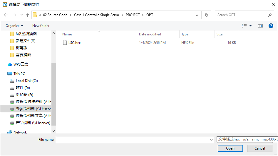

(2) Click “Open Code File” and find the hex file in Case 1 Control a Single Servo/OBJ/LobotServoTurn_C51.
(3) After opening the program file, click “Download/Program” to upload the code to the 51 microcontroller.
Before uploading, remove the jumper cap from the 51 microcontroller. Once the AIapp-ISP-v6.95E tool in the lower-right corner shows that it is detecting the target device, reinsert the jumper cap. The upload process will begin automatically.

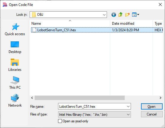

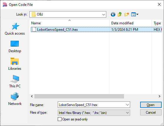

(2) Click “Open Code File” and find the hex file in Case 2 Control a Single Servo’s Speed/LobotServoSpeed_C51/OBJ.

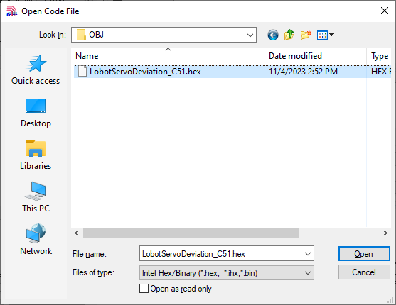

(2) Click “Open Code File” and find the hex file in Case 4 Central Position & Deviation Adjustment/LobotServosDeviation_C51/OBJ.

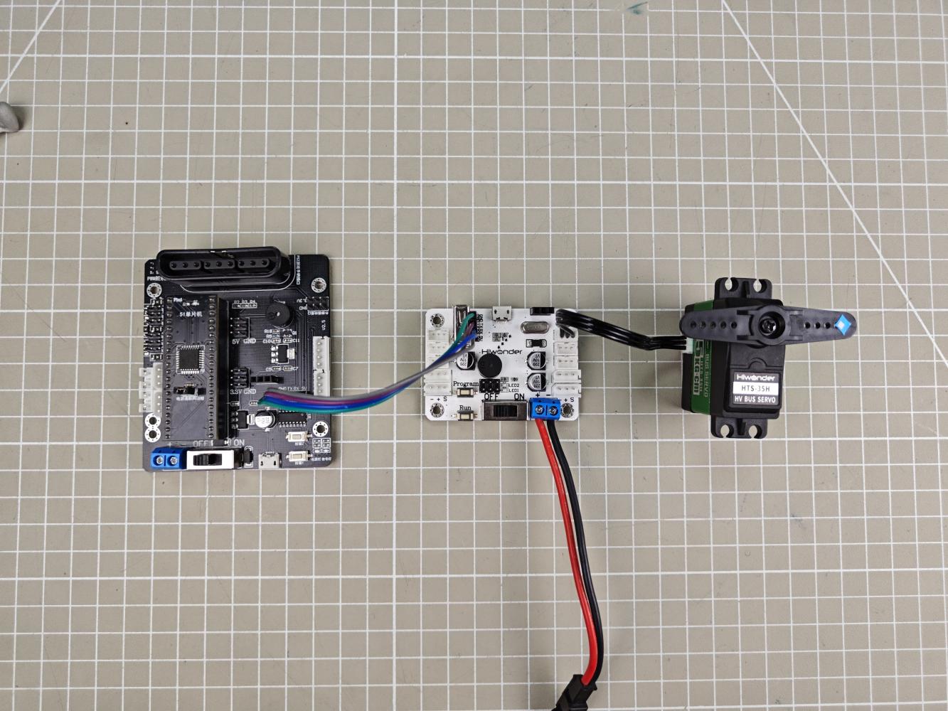

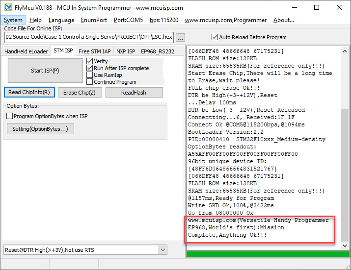

(1) Open the mcuisp download tool in Appendix->STM32 Software:
The mcuisp configuration is shown as follow:
(2) Click , then find the hex file in the following folder:
Case 1 Control a Single Servo\PROJECT\OPT
(3) After opening the program file, click Start ISP(P) to download the program to the STM32 microcontroller.
Before downloading, remove the jumper cap from the STM32 microcontroller and press the reset button. When “Mission Completed, Anything Ok!!!” appears in the bottom-right corner of mcuisp, the download is complete. Finally, reinsert the jumper cap back onto the STM32 microcontroller.
Once the upload is complete, turn on the bus servo controller’s power switch, then press the reset button on the STM32 microcontroller, and Servo ID 1 will start moving.
  • Project Outcome
After running the program, the servo will continuously swing back and forth between position 0 and position 1000, with a 1.5-second interval.
Case 2 Control a Single Servo’s Speed\PROJECT\OPT

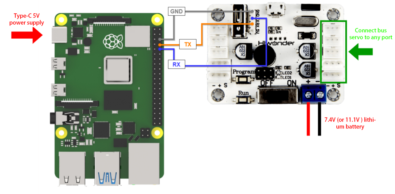

This example uses an Raspberry Pi controller and a bus servo controller, powered by a 11.1V 6000mAh lithium battery, or an 7.4V battery for low-voltage servos. Connect the serial port of the bus servo controller to the serial port of the open-source servo controller.
Install NoMachine software on PC. The software package is stored in Appendix-> Remote Connection Software. For the detailed operations of NoMachine, please refer to the relevant tutorials.
Drag the program and SDK library files into the Raspberry Pi system image, using the desktop as an example.
Make sure the library files are placed in the same directory as the program.
Open the command-line terminal and enter the following command to add execution permissions:
sudo chmod a+x Raspberry_BusServoControl_demo/
This example uses an Jetson Nano controller and a bus servo controller, powered by a 11.1V 6000mAh lithium battery, or an 7.4V battery for low-voltage servos. Connect the serial port of the bus servo controller to the serial port of the open-source servo controller.
